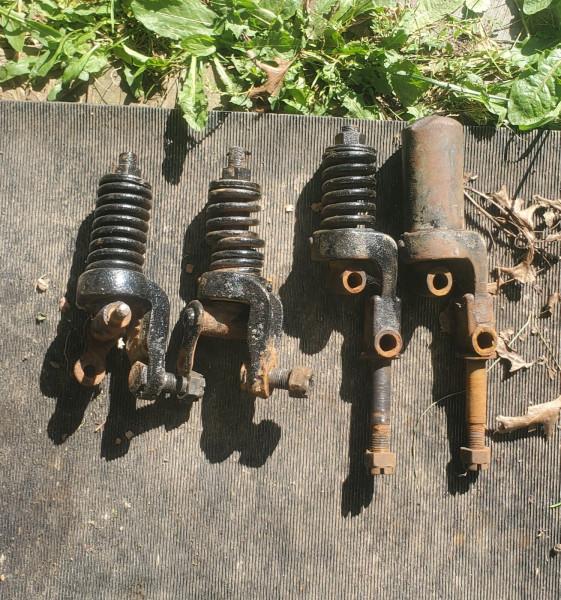

FS accessory spring for early cars
Karl Von Neumann
Posts: 717
First Name: Karl
Last Name: VonNeumann
Board Member Since: 2022
Post by Karl Von Neumann » Mon Aug 25, 2025 11:42 am
No idea on brand on spring is busted and missing 3 caps $80 shipped

Follow up to Jerry's comment on this brand of shock absorber, haven't been able to determine mfg.
These are pics I took of the subject shocks, during a presentation after investigation, as with any accident there were multiple contributing factors identified.
IMO the design of a two-piece front shock/perch is questionable, un-like any other commercial accessory Ford front shock absorber placed on the market.
The shaft of the perch is riveted between the upper yoke of the shock body, and with probable movement or toggle of the pieces, from torsion, over-stress could develop.
Two piece rivet perch.jpg (81.07 KiB) Viewed 789 times
In the accident, one perch shaft did part at the top of the axle.
fractured perch shaft.jpg (74.33 KiB) Viewed 789 times
