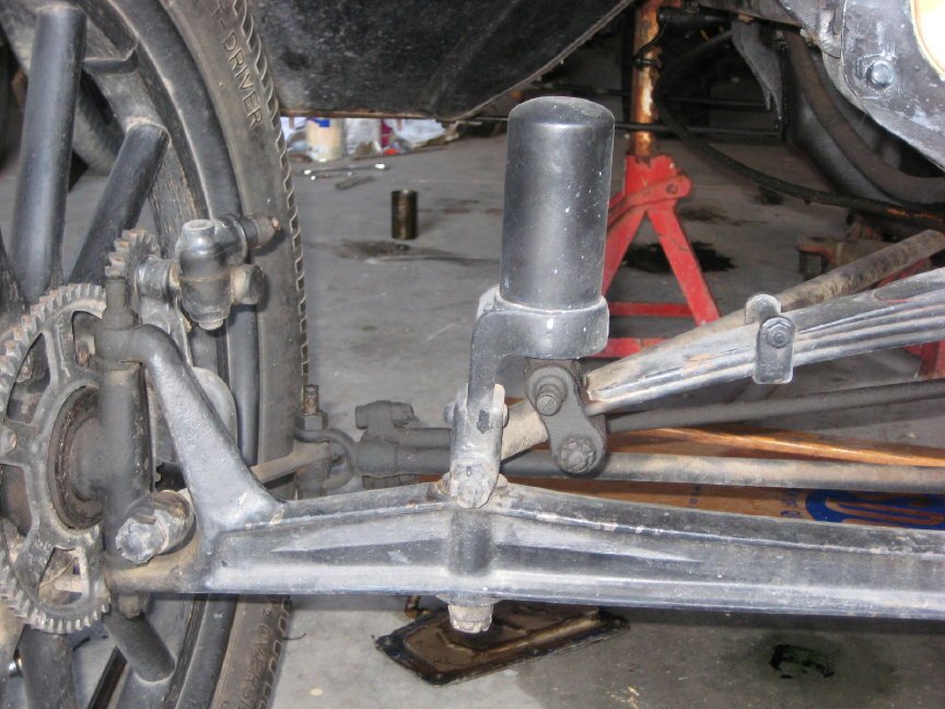

Follow up to Jerry's comment on this brand of shock absorber, haven't been able to determine mfg.
These are pics I took of the subject shocks, during a presentation after investigation, as with any accident there were multiple contributing factors identified.
IMO the design of a two-piece front shock/perch is questionable, un-like any other commercial accessory Ford front shock absorber placed on the market.
The shaft of the perch is riveted between the upper yoke of the shock body, and with probable movement or toggle of the pieces, from torsion, over-stress could develop.
In the accident, one perch shaft did part at the top of the axle.

There isn't a brief explanation but some assumptions. The fact is that the one shock had its perch bolt snapped. No evidence if this caused the wheels to lock or it snapped as a result of the crash. The shock itself shows many issues from shackle wear

As I understand when the shock broke the axle twisted causing the car to turn uncontrollably. just for the sake of conversation would a double
wishbone have prevented the disaster? Some of the accessories made for model T's had some questionable unintended consequences. just for
instance how many people where killed before someone figured out that when a Aux. trans came out of gear you had no brakes? I'm thinking the
first 100 or so didn't live to relay that information!

An added under axle wishbone would have helped stabilize the front axle somewhat. Would it have been enough? One of the heavier duty ones (like many of the modern versions) probably would have prevented at least the worst of the accident. One of the original era light duty angle iron ones might have folded up only one second slower, and had the same result as being without it.
The real dangers in this type of shock absorber on the front end have several sides. One is simple dynamics of mechanical motion. Push a wheelbarrow usual forward, and the lone front wheel "pushes" into the ground. Back up "pulling" the wheelbarrow, and that same lone wheel pulls up. Ever try to move a way overloaded wheelbarrow? A typical common single wheel wheelbarrow with six to eight hundred pounds carefully balanced on it over rough ground? Much easier to back up pulling it!
But the biggest problem with those style (made in numerous versions by numerous companies) is the stability of the front axle. That long high arch running up and over hanging off the tall springs (most versions have hanger bushings that wear loose) is about fifty times more unstable than the short arch and even worn bushings of the Ford factory design. An under axle wishbone might help, but not enough. One of the big issues is the side to side stability. The crossways spring Ford was famous for has some inherent side to side play. That coupled with these accessory shock absorbers can allow the axle to shift sideways too much. The under axle wishbone may help slightly with side to side shifting, but it will NOT prevent it.
Added into all that and more is that modern roads and higher speeds make mechanical oscillation a much bigger problem that what these cars were designed for.
I would bet that mechanical oscillation "contributed" to the seriousness of his and a few other similar accidents with cars so equipped. It may not have initially caused it, but it likely made the issue and seriousness worse.
All in all, there is too much wrong with that design to risk using them on a car to be driven (even rarely and for short distances) on the front axle. Even with an under axle wishbone.
Used on the rear axle "arguably" might be safer enough? But I would not recommend even there.
