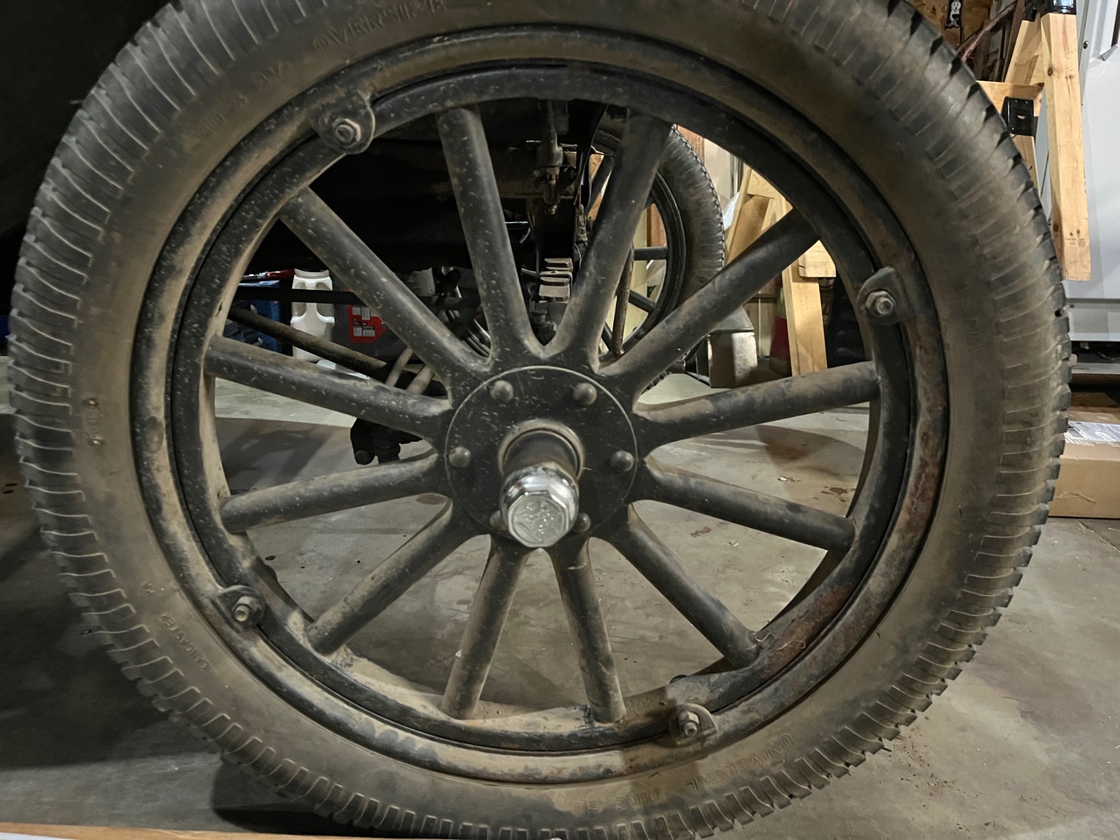

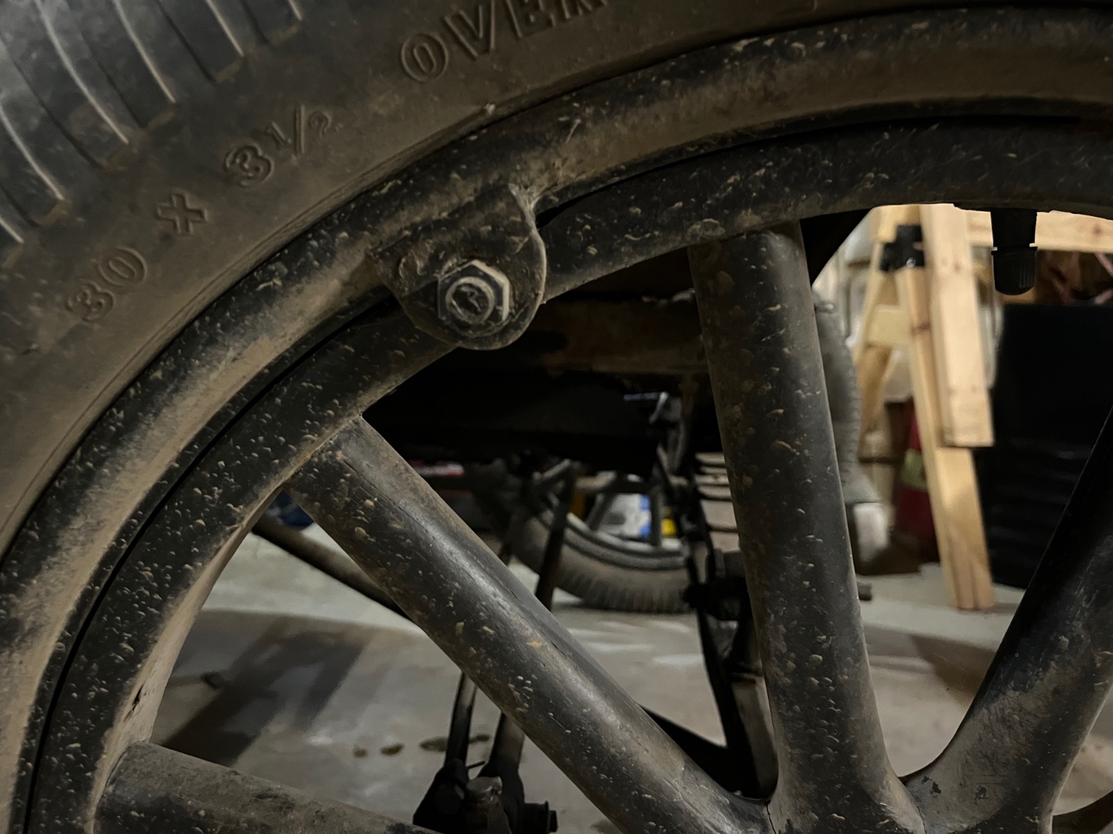

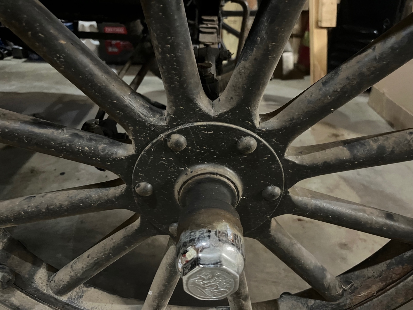

Hello all,
I added pictures of the style of demountable wheels I’m looking for. These are the fronts, and I need 2 rear wheels with the small brake drums.
Thanks!!!
Thanks!!!
- Posts: 7120
Re: WTB De-Mountable Wheels
Way to go Rob. That is the most common style, so you should have more luck.

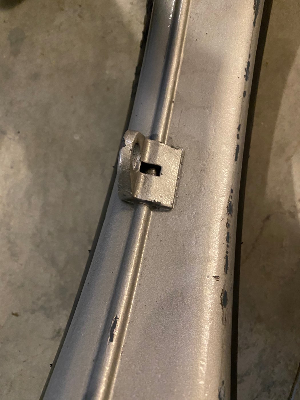

If the lug has a foot, it is likely a Hayes - no foot, a Ford. Pictured is a Hayes - the wheel felloe requires a small cutout to accommodate the foot. Generally, a Ford rim will fit either a Ford or a Hayes felloe.
- Posts: 7120
Looking closely at your photos, your wheels look to have the outer edge of the felloe rolled inwards, which is most common. Those wheels should accept any lugged rim, other than Hayes rims with the foot on the lug, as Tim points out.
Hayes felloes do need a relief in the outer edge of the felloe to accommodate the lug foot. However, every Hayes wire wheel I have seen has depressions in the rolled in edge for the lug foot to go over. Wheels with a straight-up edge on the outside do have notches cut in them for the foot, but these may be other manufacturers way to make all the lugged rims interchangeable on their wheels. This may well have been driven by Ford so that wheels from multiple suppliers could be used.
Tim's photo of a Hayes rim shows a rolled in groove around the rim, just like all the Hayes rims I have. Other rims look like yours, having an added ridge around rim. Both the groove and the ridge play a part in correctly mounting the rims on loose lug felloes. When the lug bolts are done up, that groove/ridge wedges on the outer rolled edge of the felloe to make a solid unit. The lug bolts are there just to maintain that wedge effect.
When fixed lug rims were introduced the outward rolled inner edge of the felloe was widened. Rims then wedged on this wider land rather than the narrower outer land. Again all the wheel bolts do is maintain the wedge. They do not take load like modern wheel studs. Which begs the question, why do fixed lug rims retain a rolled-in groove or added ridge? It may just be so that they can still be interchanged on earlier wheels.
