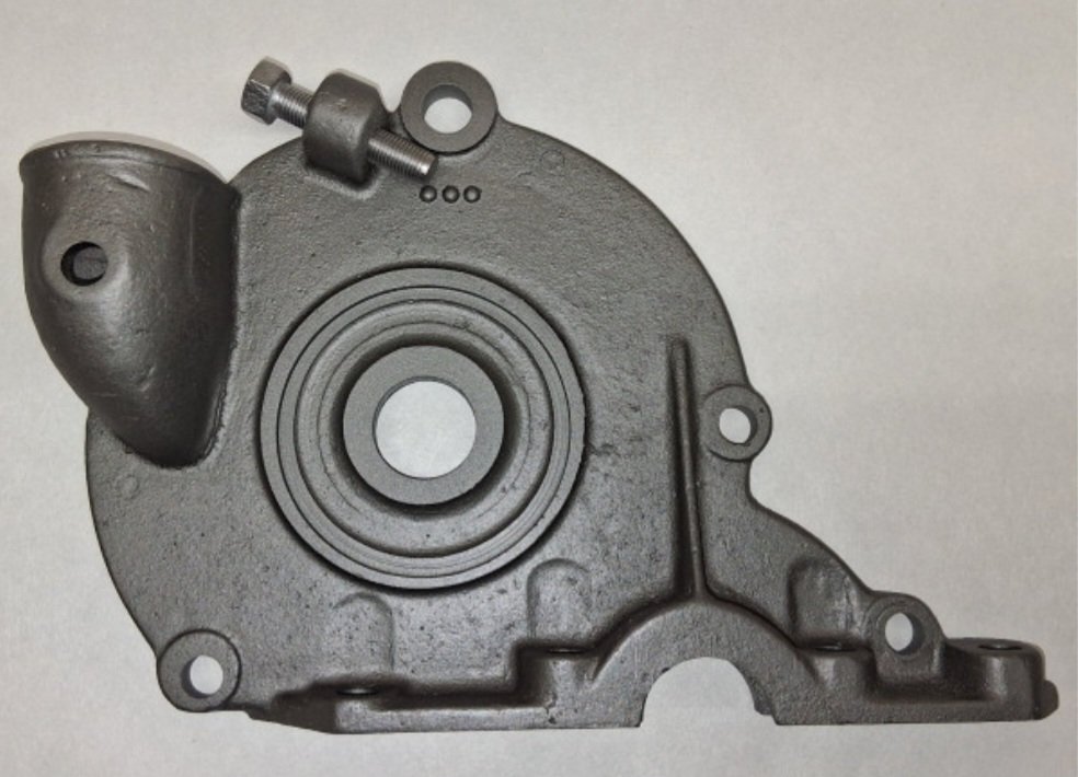

This one is correct for year and available. It can be modified for a modern seal as Allan mentioned above. $40 plus $8.50 domestic shipping. Mark Chaffin (951)805-0928
