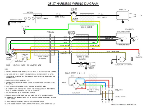

I am working on wiring the bake lights today and the diagrams I see say to wire the switch to the battery post on the wiring block . This will undoubtedly provide power to the switch but won’t that mean that whenever I have the parking brake on, the brake lights are on? This seems like a good way to drain the battery. Is there a different way to wire it that will avoid this issue or should I just get used to not using the parking brake for parking?

Another option might be to connect it to the taillight post, #4 on the wiring block. Note: Power will only be supplied to the brake light switch when you turn the ignition switch to DIM or ON. Running with the headlights & taillight on is a good safety practice (daytime running lights)

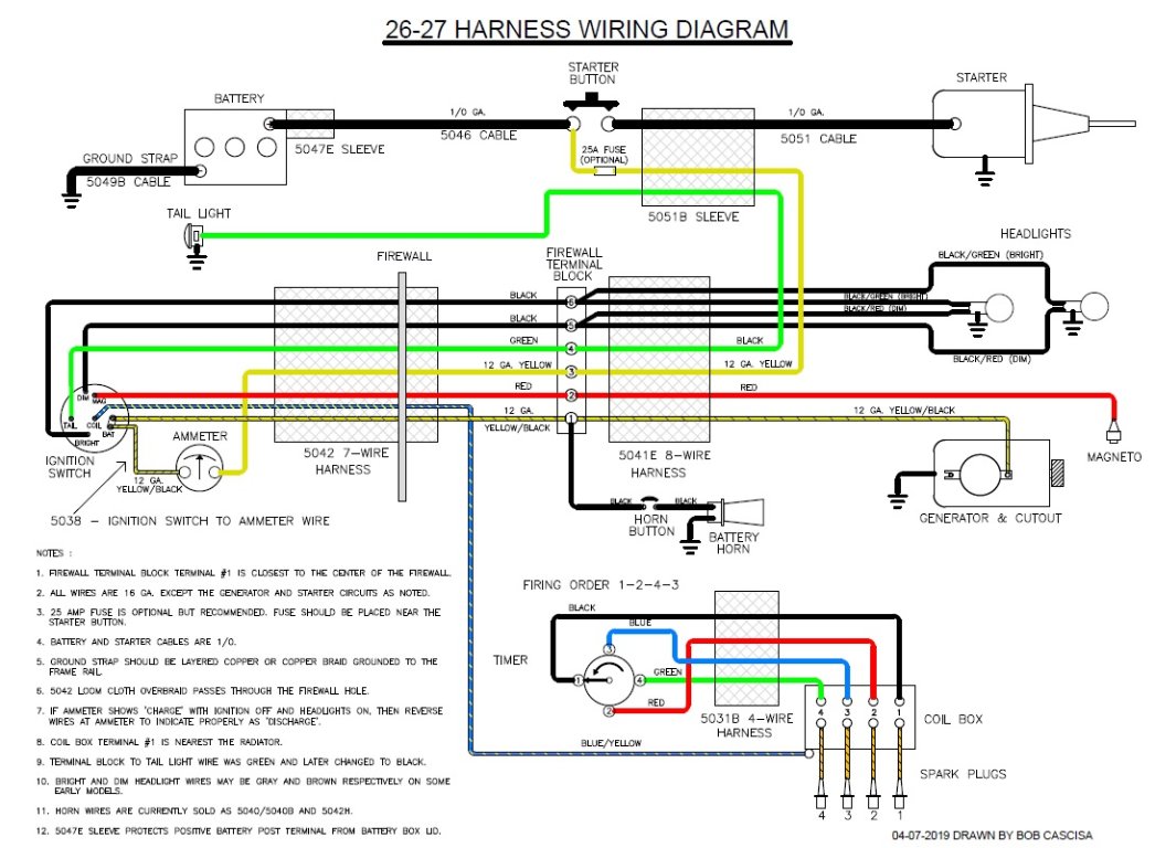

Your initial concern was about wiring it to the battery post on the terminal block and the battery going dead. If you follow the wiring diagram from the post were the ammeter & generator are you'll see it goes to same post #3 then to the battery. Now if your battery isn't going dead, perhaps the brake pedal isn't making contact with the brake switch. Pretty much wiring diagrams are the same except for headlights

Yeah, I saw that and tested it it with a test light. I picked the generator terminal as it had a bit more space for the new wire. At the moment, I am leaving the parking brake off.

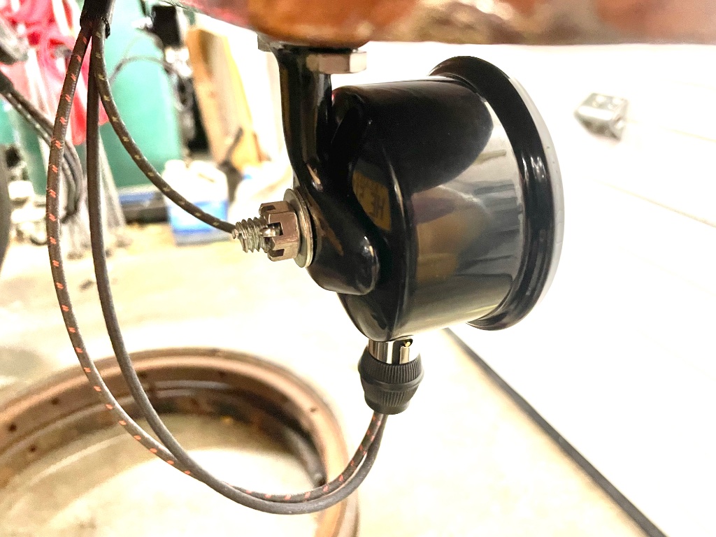

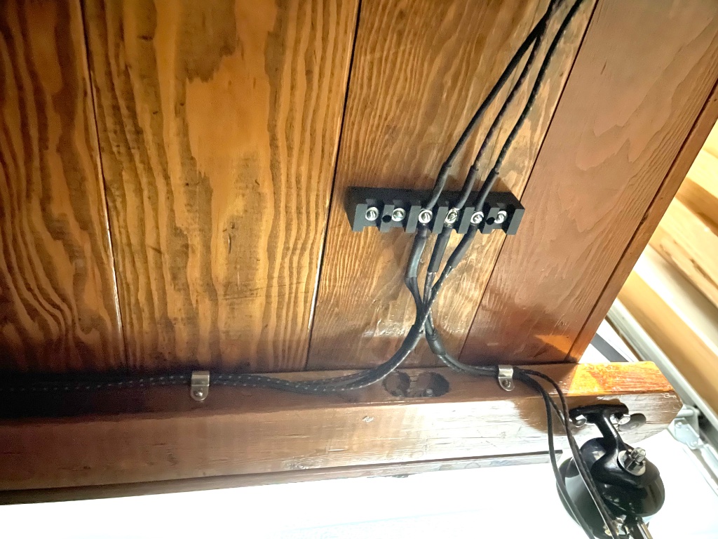

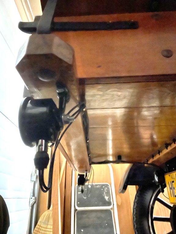

Here are some shots of the brake lights installed. I made the mounts and installed a wiring block under the bed of the truck bed to make the wiring nest and simple. I used some stainless steel clips and screws to hold the wiring in place on the bed. I made wire holders from rubber grommets and safety wire to hold the wires running up to the brake switch, the ground, and wiring block on the dash. Installing the block under the bed means I have some spare connections if I ever decide to install turn signals.

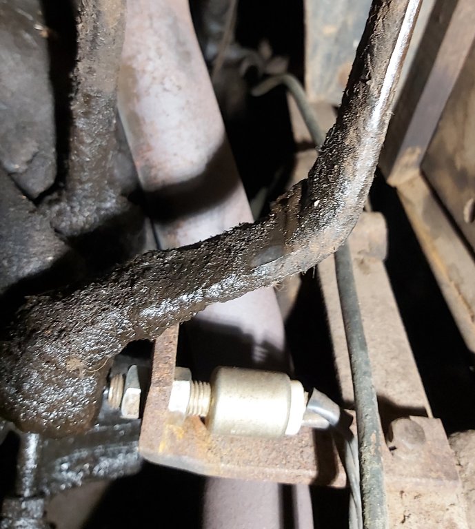

This is about as simple as it gets. Fused power comes from the adjacent starter switch. This brake light switch comes on when the pedal is pushed just like modern cars. This switch was from an 80's Japanese car. The whole switch is adjustable in the bracket to set it got operation.

The vendors sell a version of switch that clamps on the starter solenoid cover and works well. I had to shorten the plunger end to get everything to line up.
