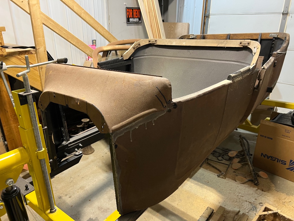

Post by Musketdoc » Sun Nov 20, 2022 10:19 am
I think there was a body style change in 1923. Is your project the earlier, i,e, ‘17-‘22 style or the later ‘24-‘25 high cowl type?

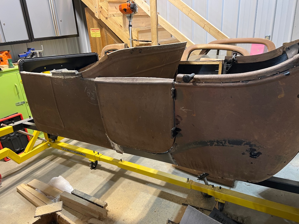

Post by John kuehn » Sun Nov 20, 2022 4:16 pm
Looks like it has the 3 piece back. The earlier style was a 5 piece back. Also the earlier style has the rear top bow support over the top of the body. The later style came through the body as this one. It doesn’t have the later straight door hinge so it’s not a 25. My opinion it’s a late 23 or 24. It looks like to me its a high cowl car and if it is it would be a 24. But that’s without actually measuring the height of the firewall opening.

Post by George House » Sun Nov 20, 2022 4:23 pm
Its a low cowl. My ‘23 touring had top bow saddle brackets extending thru rear quarter panels like this picture.

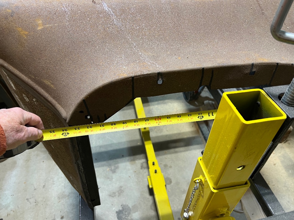

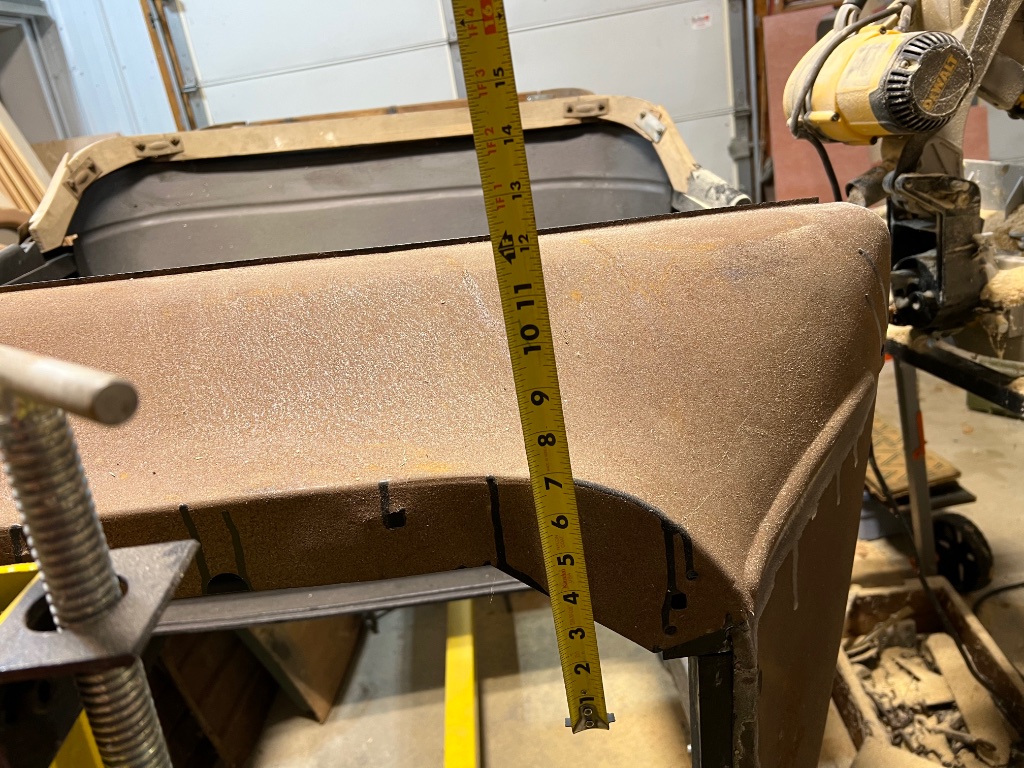

Post by 2manyprojects » Sat Nov 26, 2022 9:49 am
I was asked yesterday to measure the cowl height. I will do that Monday, Nov 28 and respond

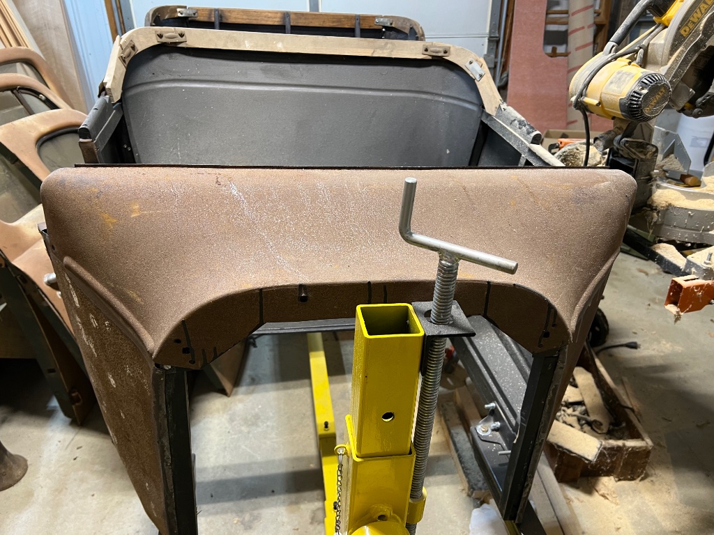

Post by Scott_Conger » Sat Nov 26, 2022 9:59 am
you'll find it's a low cowl...
high vs low are very very different in the number of holes punched in the front, the location of those holes, and the shape of the front apron. Additionally, the high cowl is 28" across where the firewall attaches and the low cowl is 24 3/8" across.
Once you know the differences it is all but impossible to mix them up...and in the end, no ruler is needed.

Post by 2manyprojects » Mon Nov 28, 2022 6:50 pm
I added two photos with a rule and one without. I believe the cowl height question was resolved by a couple of posters.
