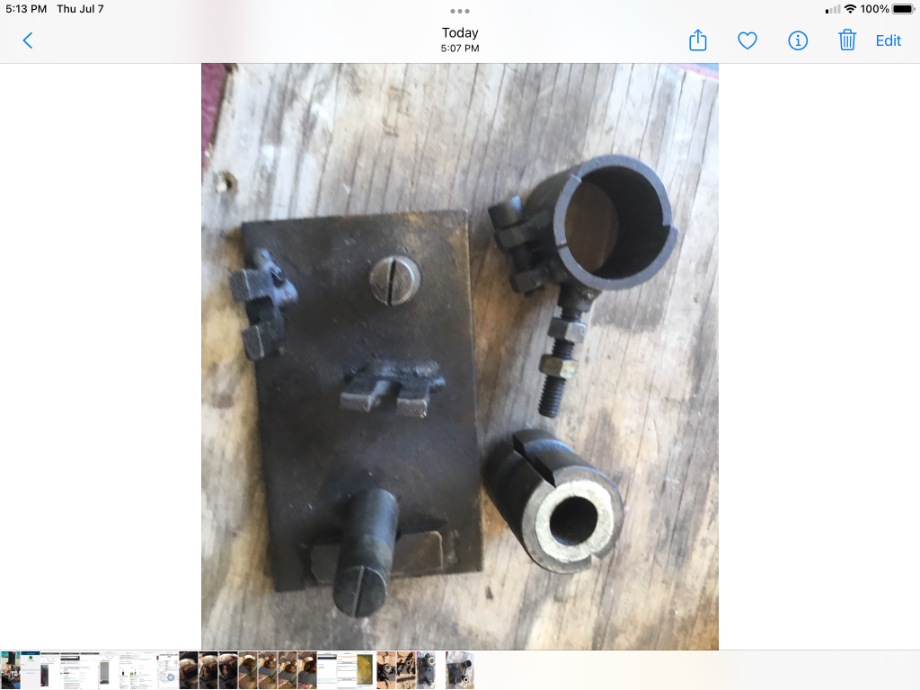

Take a hose clamp and tighten old shell, fill it with babbitt, set it in the lathe and bore to size, it is no rocket science on them.

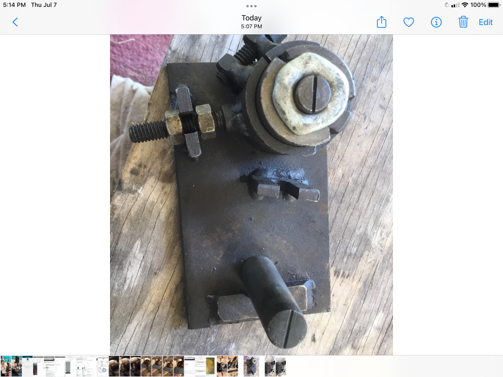

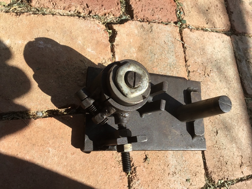

Make sure the break in the iron shell looks like a fresh break and is not worn smooth. The little jig is not hard to build.
