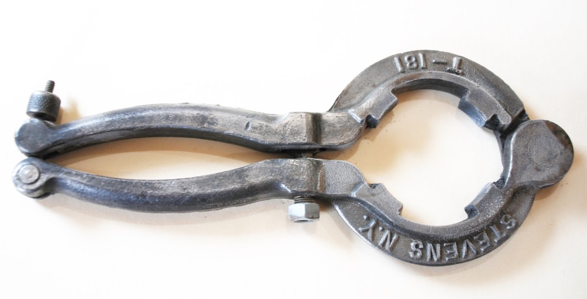

STEVENS T-181 THREAD CHASING TOOL, MODEL T HUB, RARE $1,000.00

I would pay a fair and reasonable price of $400 for it but I don't know how anybody could justify that price for fixing a few wheels or the pride of ownership of a wall ornament. I need one of those to go through about 100 wheels and that is exactly what I need to do it.

Has anyone made a new tool that does what this tool does? While it is great to have an original, it is what the tool does that is important.

I believe Jack Putnam had a "run" of these reproduced a while back !

Work well for me, saved me 2 hubs.

Glad I got one of Jack’s when he made them. Only did one run he said too much work. But for what they are listing for now maybe he will reconsider.

that tool you linked to is only good if you can manage to get it onto the hub and that is usually the very place it is damaged...the utility of the tool advertised is that it goes OVER the bad spot and clamps onto good threads and then is unscrewed, uprighting and reworking the existing threads such that they reattain their original or nearly-original set.

THIS TOOL WORKS PERFECTLY, NO PROBLEMS. I USE MINE ALL THE TIME TO CLEAN UP OR RESTORE THREADS
