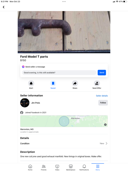

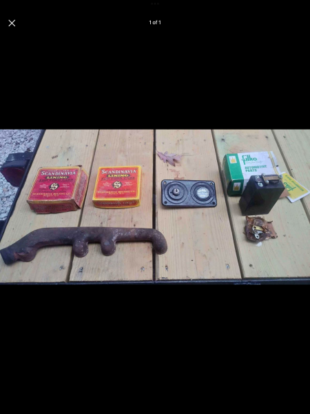

I have no connection to this seller. They have two sets plus other parts for $150 obo

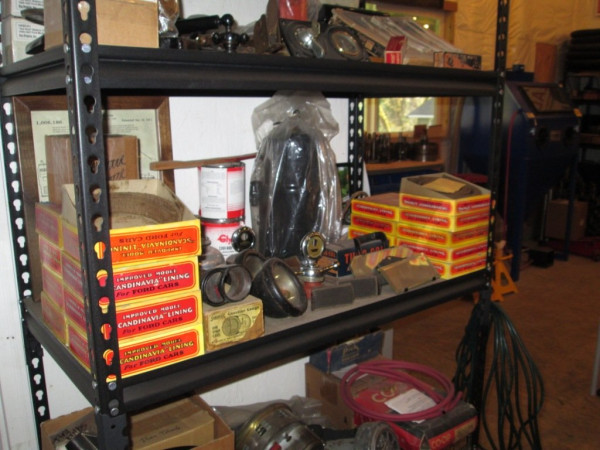

Posts: 5362
Re: WTB: Scandinavia Linings Pre 26 ;Brake Lining Failure Fall Tour Put Me on the Vulture Wagon
Post by RajoRacer » Tue Oct 24, 2023 1:04 pm
Addendum: I would be happy to send you a couple wide brake linings - original Scandis ! Drop me a note through the Forum.
My apologies - I misread the header - let me look & if John can't supply, I most likely can.

Unprr wrote:
Mon Oct 23, 2023 10:24 pm
George Schmidt
Elkhorn, Nebraska
Thank you for sending this over! I decided to go with this seller because they are local. Very much appreciated!
