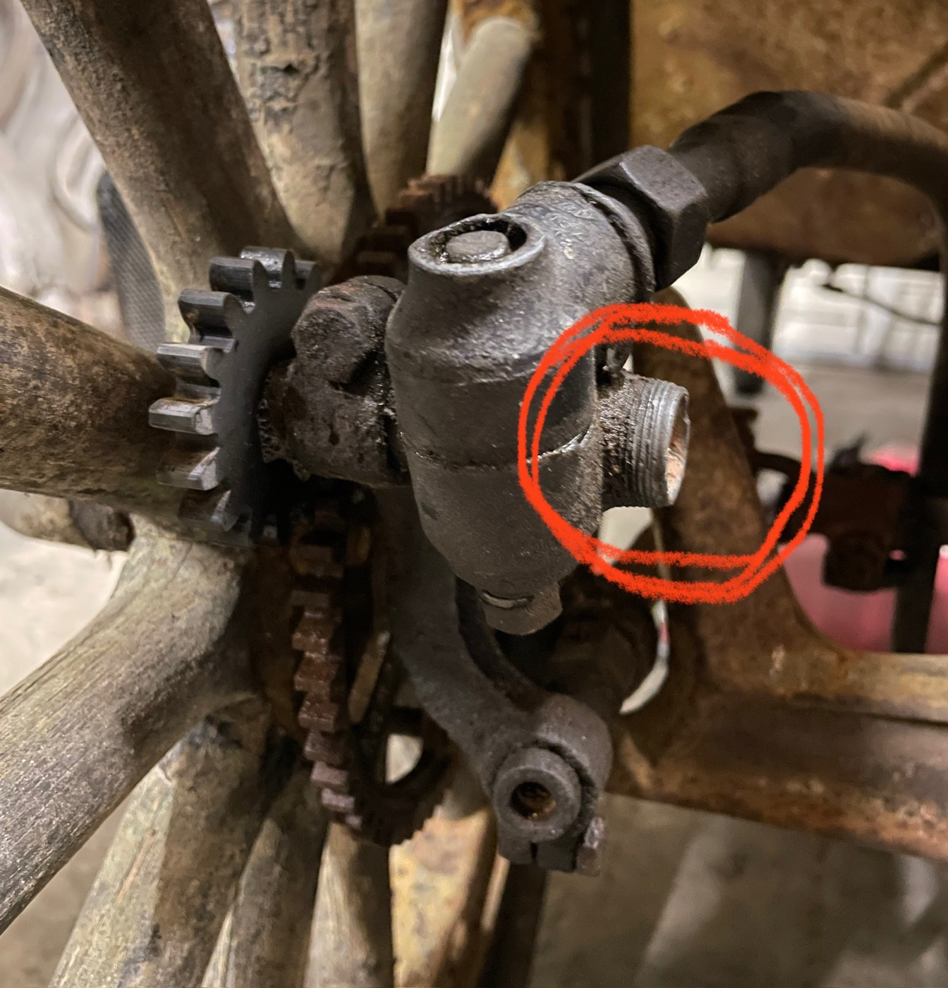

I also need the threaded cap that fits the swivel. See picture…
Thanks!
