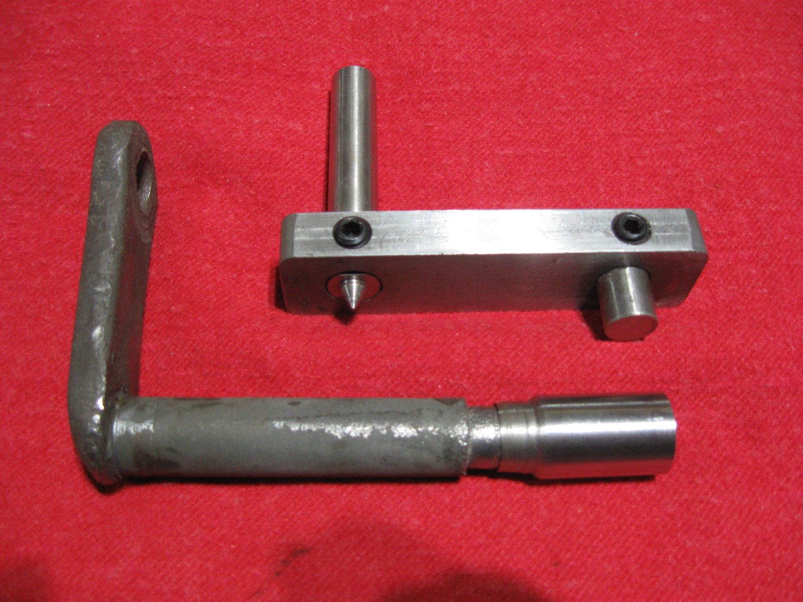

Don't throw away those worn or pitted TT Shackles. The attached photo illustrates a means to rejuvenate your old shackles. Weld or splatter weld the worn or pitted surface of the shackle, then, assemble the Machining Fixture to the shackle. Chuck the assembly to your lathe and turn down the built up surface. $90.00 plus shipping for fixture only.

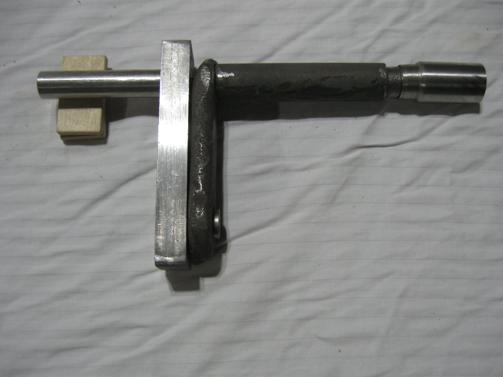

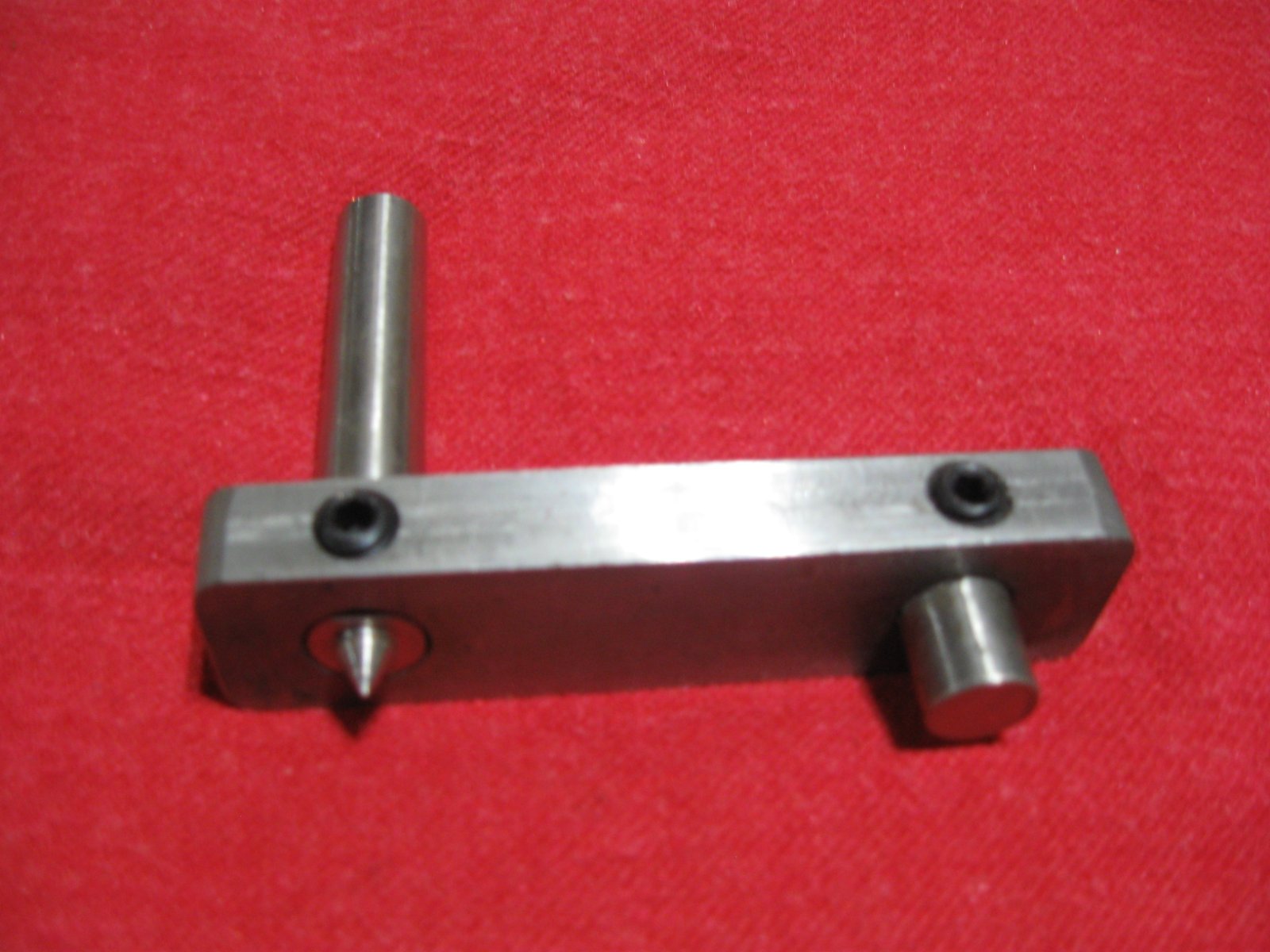

A picture of it together would help.

See additional photo
