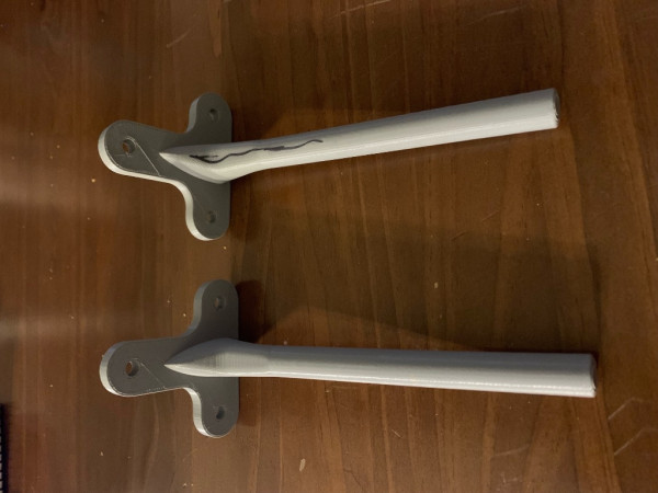

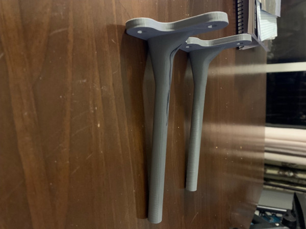

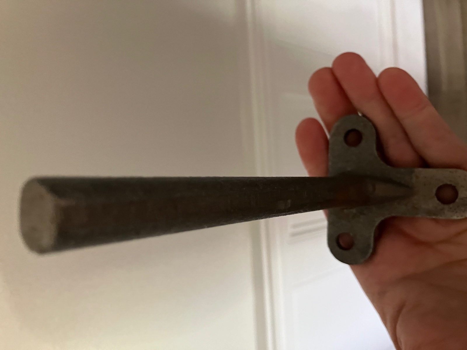

I've been researching and planning and making the necessary pieces for my delivery car. One item was the fender irons. I have drawn these unique fender irons up and 3D printed them to exact dimensions. I have now finally secured a foundry that will cast these for me. I was only going to have one set cast, but a forum member had contacted me and asked me about rear fender irons because he too is doing a delivery car, I told him where I was in the project. The foundry I'm working with is willing to do a small run. If anyone else would like a pair please contact me via email or call to discuss. The run is queued in December so I will need to know really soon if interested.

I’m sure perhaps if someone had the energy and time maybe they could fashion a set, they would probably need some finishing work though to get them looking right. On the pad section where the bolt holes are there is a bend to follow the curvature of the body. Before I had pursued this route if making my own I purchased some 13 rear fender irons and set out to bend but decided to just have them cast then I would know the measurements would be right on and not waste time in trying to straighten and bend old ones.

Yes that's true if you don't adjust for shrinkage. I 3D printed several molds to adjust for the right shrinkage for the castings as per the foundry.Craig E. Luton wrote: ↑Wed Nov 17, 2021 12:00 amNote that your cast fender irons will not be the same size when you get them back as the ones you send to the foundry for casting.

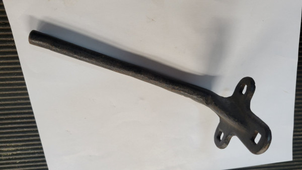

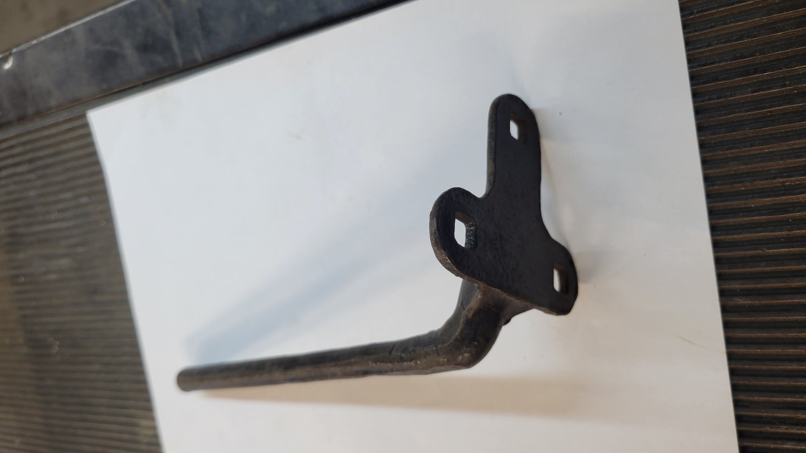

Is this a delivery car rear fender bracket?
Keith
Keith
Tbird
Topic author - Posts: 1333
- First Name: Mike
- Last Name: Bird
- Location: Goshen IN
Re: Delivery Car Fender Irons
Keith, unfortunately it is not. Those are the standard 13 fender irons that someone has bent the mounting pad up. On the delivery car irons the iron towards the bottom of the pad. Before making my own I thought of modifying 13 irons, but just too much work.

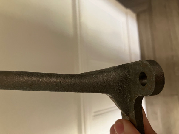

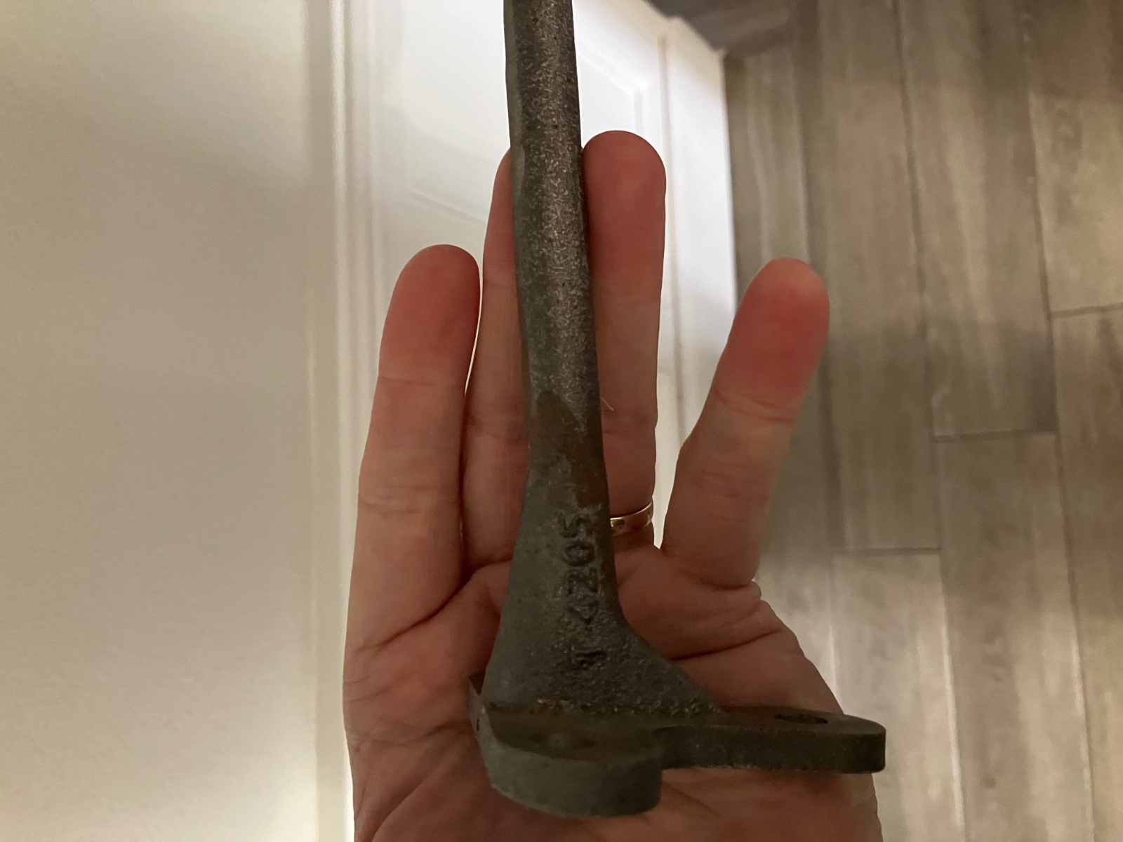

Here are the ones I had casted.
