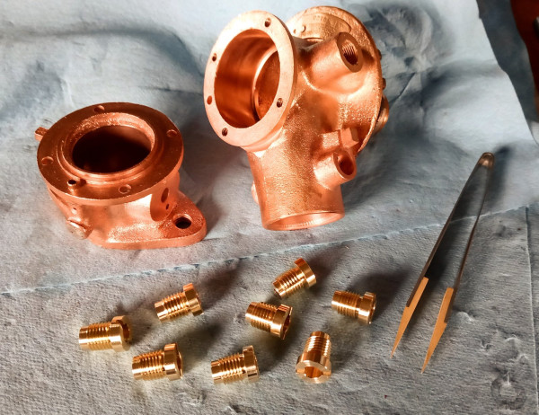

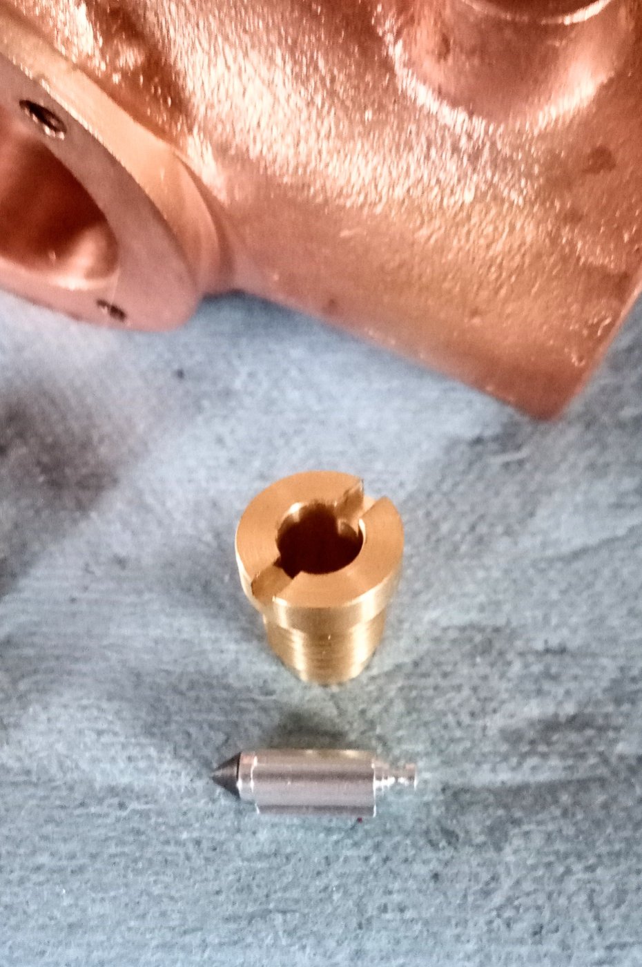

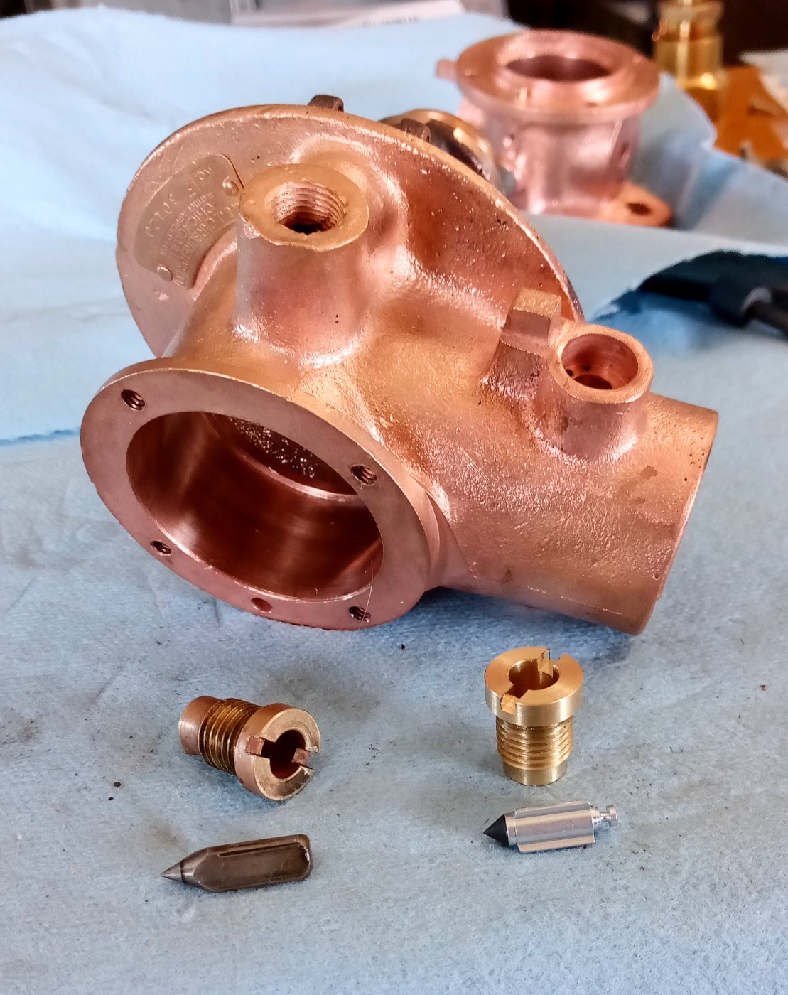

I am in the process of resurrecting a small pile of U & J carbs and am making new Viton-tipped float valves for them
If there is any real interest in having more made, I might make more
They will have a hook which will force the valve open (won't stick) and must be mated with a float that has either an early Holley hinge or Kingston L-2 hinge (lift tab is long enough for hook to fasten to)

Original vs New
