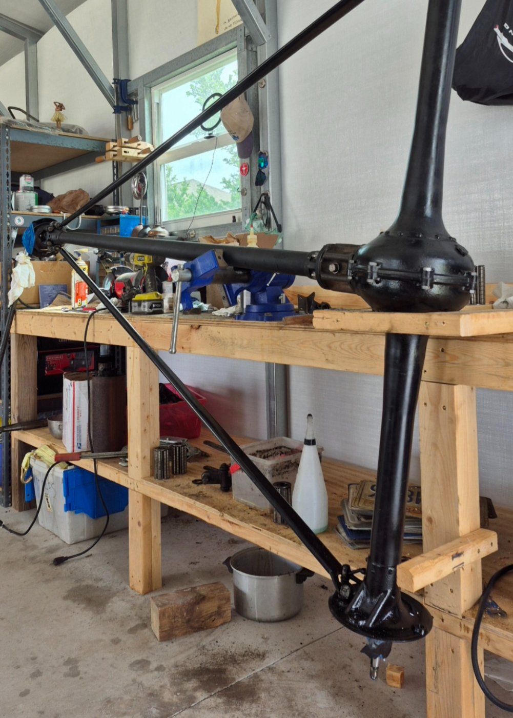

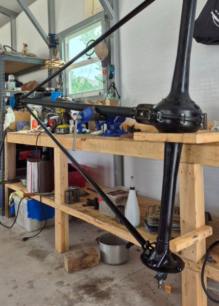

I just bolted two 2x4's to my bench extending out far enough to cradle the housing, and screwed in cross boards between the two to keep the housing secure and resting on 4 points.
$5 vs $100, worked fine for me anyway.

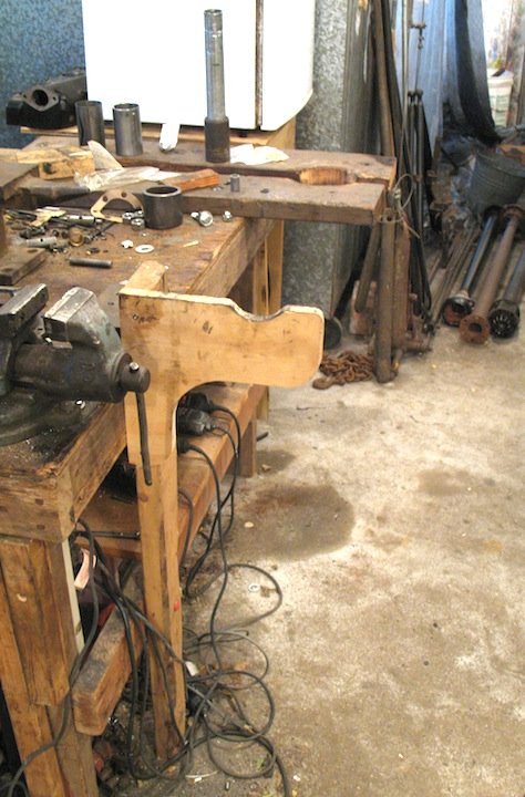

I have a friend who cut his out of a steel plate.
A sliced hose edging keeps from scratching the paint for him.

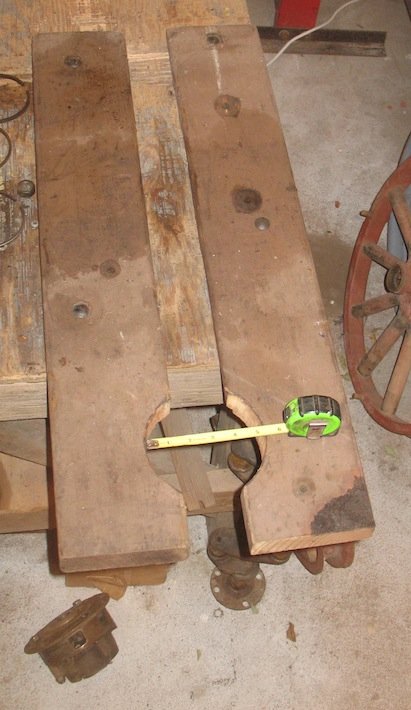

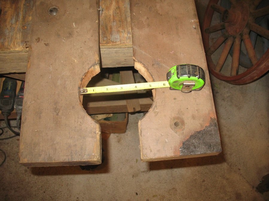

Scott, I think your answer starts by knowing if this is for a one-time project -or a tool that will be used multiple times. If multiple times, -and if you are handy with wood, a 4'x4' sheet of ¾" Plywood from your local big box store is your friend. Rip into 3 equal widths (approx 16" ea) and glue together to make a true 2" thick board. Duplicate the shape of the one in your pictures and paint it to preserve. You will have a tool that you can bolt to your workbench that will be robust enough and last forever.

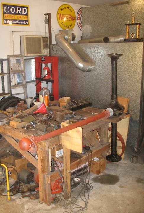

I believe our friend mr. Steve Jelf made this one

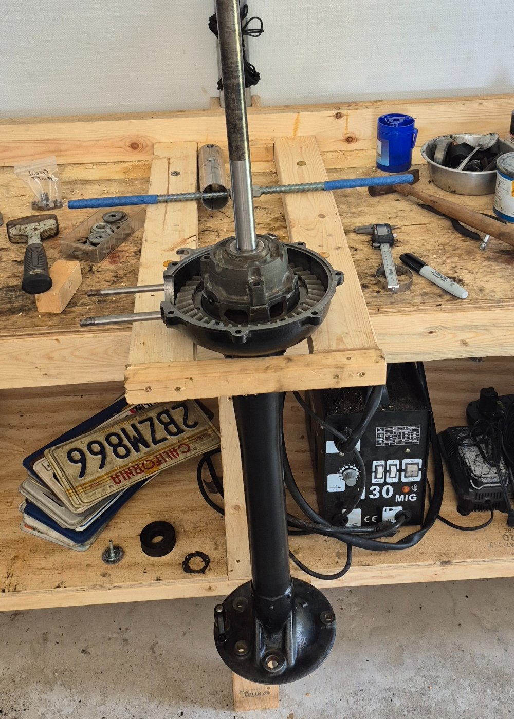

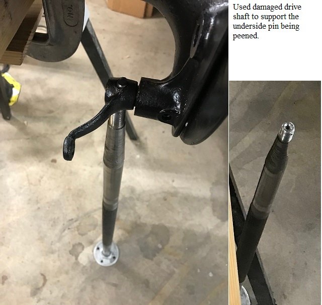

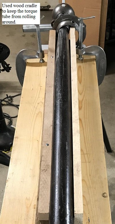

Biscuit joined to 2"x6" & cut out the end like Steve Jelf's above. Then just clamped onto my power miter-box stand. Easy set up and take apart when not in use

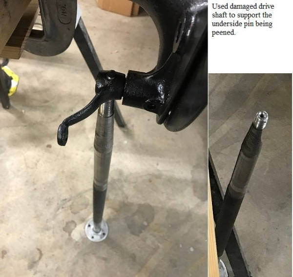

had a damaged axle (key chipped out) and used to peen brake cam
