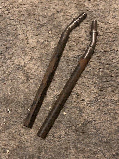

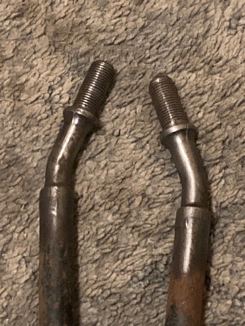

Craig Leach
Posts: 2040
First Name: craig
Last Name: leach
Location: Laveen Az
Re: Wanted - Radius Rods for a 1925
Post by Craig Leach » Tue May 20, 2025 8:16 pm
Hi Scott,
I don't know if these are the correct style? They came off a set that had the other end cut off & I used the middle to repair some broken top bows.
Craig.
Posts: 5631
Post by RajoRacer » Tue May 20, 2025 8:25 pm
Those are later '26 & '27 with the "fixed" collars - early '26 used 2 nuts & a lock washer. The fork end is also different.
kmatt2
Posts: 678
First Name: Kevin
Last Name: Matthiesen
Location: Madera CA 93636
Post by kmatt2 » Tue May 20, 2025 8:41 pm
Those cut off rods are for a late 1926-27 car and have the fixed collar. They would have to be welded to the old rods at exactly the correct length. I am sure that you could turn the collar off , weld threads up and rethread the entire length to use the two nuts like the stock 1925 rods using you stock 1925 rods with bad ends cut off and replaced with these ends. This will allow for some small adjustment in length because of the lock nuts.
