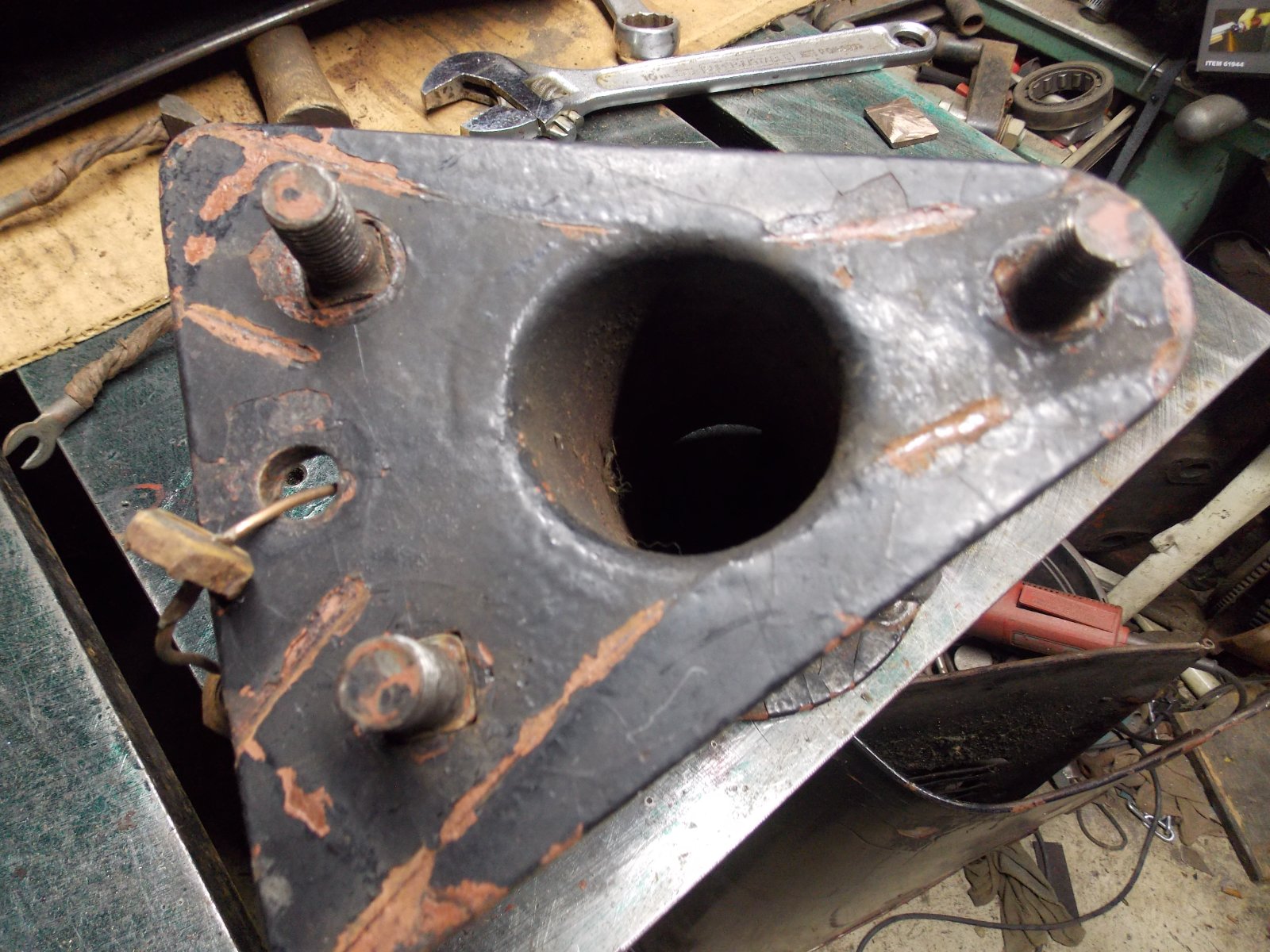

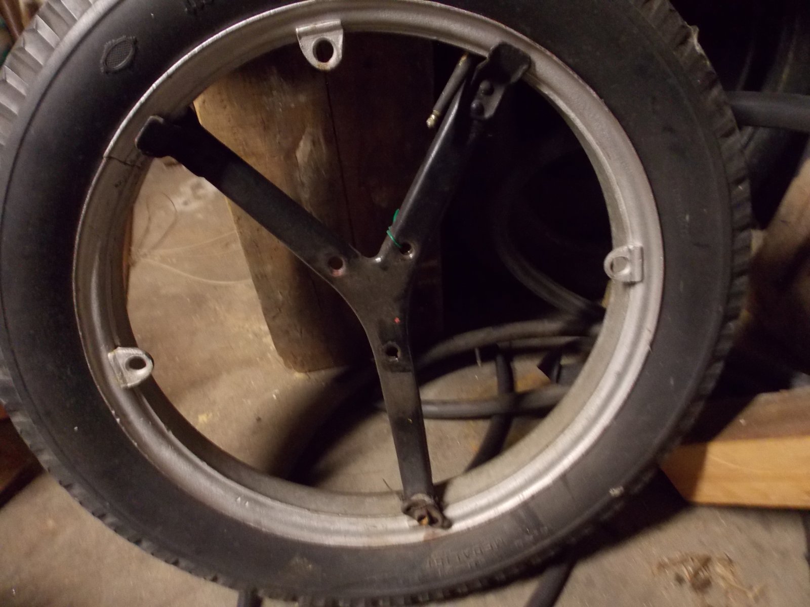

If you already have a Ford spare carrier all you should have to do is unbolt the "Y" and the wires should be able to bolt onto the triangle part that is hidden beneath. Hope I explained it clearly. Jim
Ps. I added a couple pics of the one from my roadster the stock ones I would think are about the same as far as the 'Y'.
