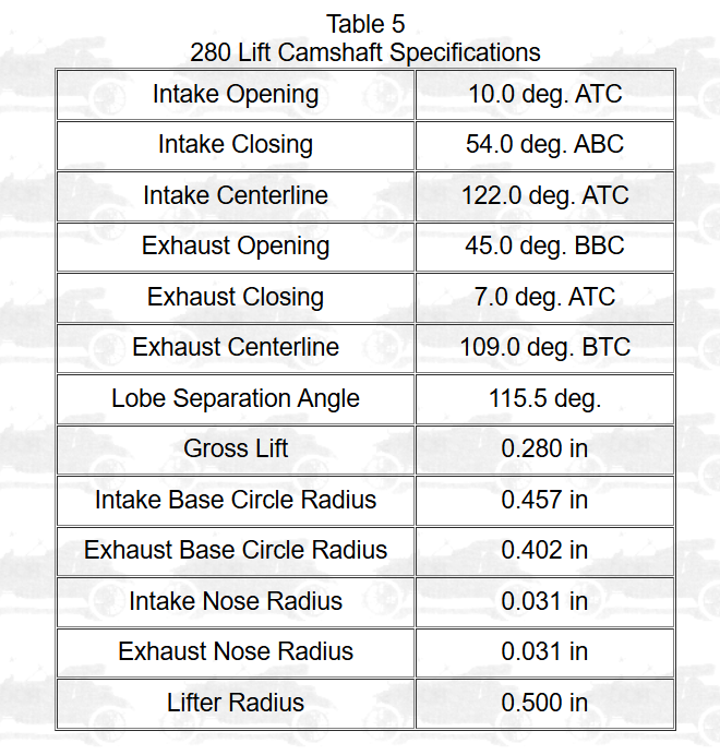

Nope. Here is the same info in a more readable table format, from the "Model T Cam Project" on the Model T Ford Club of Tulsa webpage.
https://mtfctulsa.com/Cams/design_280.html
Keep crankin',
Eric

While the 10 related to the intake opening looks to be BTDC in the data graphic, you can see in the specs that the intake opening is indeed 10 ATDC, the image is wrong for this cam. But I believe that the blank format graphic for these figures is more commonly used for cams in modern, higher speed engines that do have exhaust overlap with the intake opening BTDC and the exhaust closing ATDC. The figures added to the graphic for this cam do match the .280 lift cam data provided above, even though the graphic doesn't quite fit.
Keep crankin',
Eric
