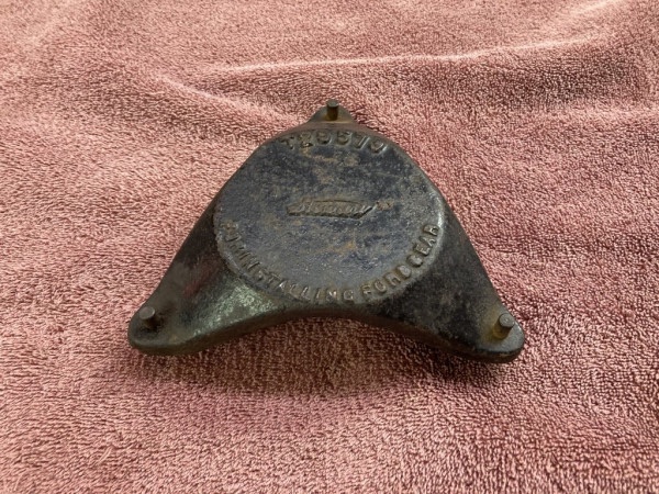

Folks, I would like to find a Stewart Warner Speedometer Gear centering Tool. This is the tool that aligns the gear on the wheel.
Here is a picture that I found on the forum.

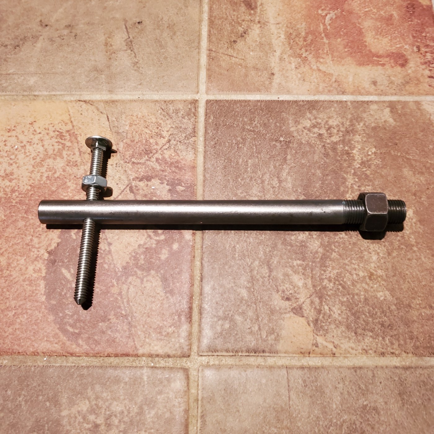

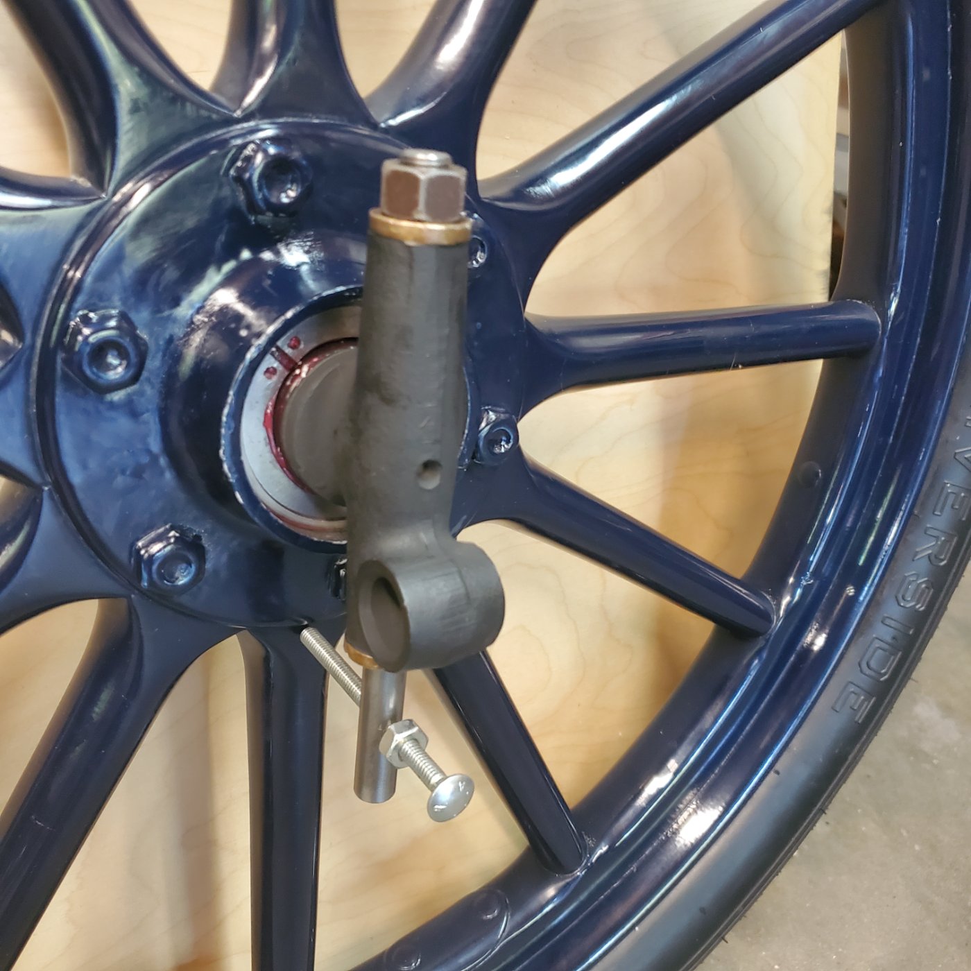

Ray those are near impossible to find If. You need to get the job done as opposed to being a tool collector, here are photos of a simple tool I made using a front spindle.

Richard, What a great tool. You are correct that the Stewart Warner tool is very rare, but anyone could make your tool and mount the gear perfectly! GOOD JOB! Russ Furstnow
