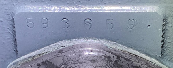

My engine block has the number 50 36 59. This seems to be 1914 or 1915? I am less interested in whether my car is a 1913, but more so as to what year parts fit it. There does seem to be a range from '08 to '27. But where and what.
