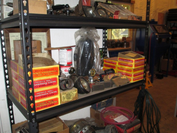

Original, for sure ! Originals are 23 & 1/2" in length & stenciled. Same here - if they don't smell "musty", they're most likely fine for use - I prefer Scandinavia linings myself in my 4 Model Ts !
