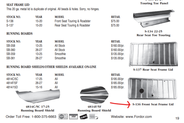

Was the gas tank cover in 1918 stamped metal part? Any body have one available or at least a picture of one in their car. Mine has a piece of plywood, not correct.

The cover on my 1917 tourer is sheet metal and hinged at the rear with about a 1" finger hole to lift it up in the middle as well as a hole over the gas cap
- Posts: 4282
Re: Gas tank cover for 1918
They look like this...
From Howell's Sheet Metal

I often have wondered about those covers, and the timelines when wooden slat or stamped steel covers were used. I suspect which covers were used depended upon what body supplier built or finished the bodies to order. I know some of the body suppliers went back and forth between the wooden and steel covers. One article on the subject that I read some years ago speculated that the materials shortages due to the Great War forced the body builders to go back to wooden seat frames and covers after Ford had switched from wood to steel. I have always doubted that idea as the seat frame and cover wasn't very much material relative to the entire automobile, and although the cover itself was a significantly large piece, the seat frame pieces were made from scraps of larger items, riveted together.
I also wonder when the last of the wooden slat covers were used on the model Ts? Pretty sure I have seen some at least into the early 1920s. Steel seat frames and covers are fairly well established as being used early in 1915 on many open body cars.
