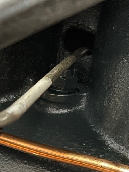

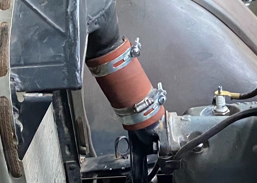

So I discovered some more.
The rod that goes between the top of the radiator and the firewall is too long and is pushing the radiator forward. I also saw that the rod is too small in diameter at the tank. So I have the wrong rod or someone brazed the wrong size receptacle on the tank. I cut the rod so it won't push the tank forward and tried the clamps again. Nope did't work.
Next up I'm off to the parts store to get two hose clamps. I looked in my stash of clamps but had non that would fit. I also saw that I need to get the clamp close to the tank to make it over the bulge in the neck.
It's going to go we didn't get this far to be stopped by a leak. Ha!!!

I think I solved it for now. I got some modern hose clamps and will use them to get it running. So far only a small drip. Before it was really dripping a lot.
Mopar_man
Topic author - Posts: 1164
- First Name: Robert
- Last Name: Govoni
Re: Getting Rattles Back On The Road

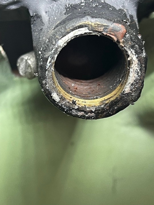

I think the issue is the neck of the outlet had corrosion on it and trying to seal the hose to it is difficult. I like the idea of using some RTV to fill in the holes and make the seal. For now the leak is very small. It could seal itself after the car get hot. Time will tell.

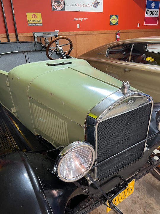

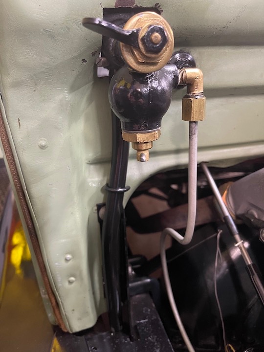

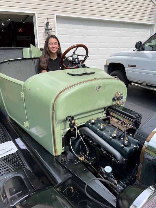

Well it was bound to happen. It was inevitable. I just didn't think it could happen so quick. We started the car!!
This is what we did.
I pushed the car out of the garage. I had Angie step on the break to see it it worked. It did. Then I had her put the parking break on it didn't work. Angie put a wheel chuck in the front and jacked up the back of the car to put it on jack stands. I placed a big drain pan under the car and placed a fire extinguisher next to the car (for luck). Then I put some gas in and checked for leaks. None.
Then I opened up the sediment bowl and then the gas shutoff at the carb. still no leaks. Now I'm thinking this is too good to be true.

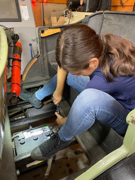

I had already loosened the third brush and moved it counter clockwise and had my wrench at the ready.
We connected the battery and looked at the Amperes meter it didn't move (good sign).
So first I primed the engine.
https://www.youtube.com/watch?v=f-4Ugp7Mb_8
Then I started it. Got a bit excited and forgot to get the coils going.
https://www.youtube.com/watch?v=iyd9xJdXLys
Then it was time to see if it would move. It did but I have a lot of band adjustment to make.
https://www.youtube.com/watch?v=ejfklinNOCo
Of course Angie had to try it.
https://www.youtube.com/watch?v=LrZBCD3TUvE
I know it's running rich and my throttle and spark levers are not smooth yet but it ran!!!!!!!
I adjusted the third brush.
First time for me in 5 years. Now I just need to fiddle around with it.
Oh I checked it again tonight no leaks!!! battery disconnected. It was a great day!!

Congratulations! The smile on her face in the picture says it all! Like you said in the video a few adjustments and Rattles will be humming right along.

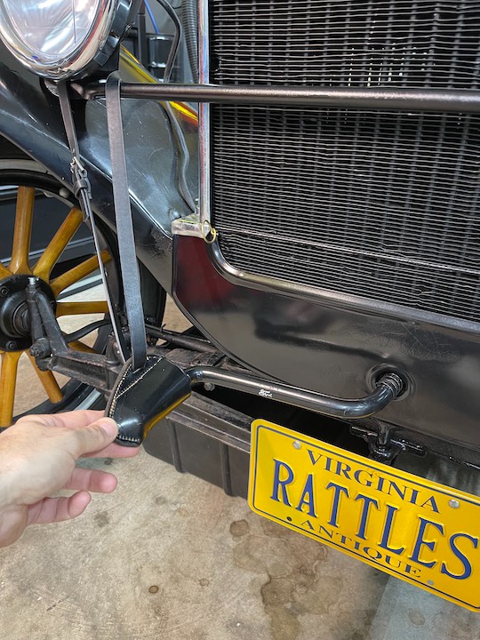

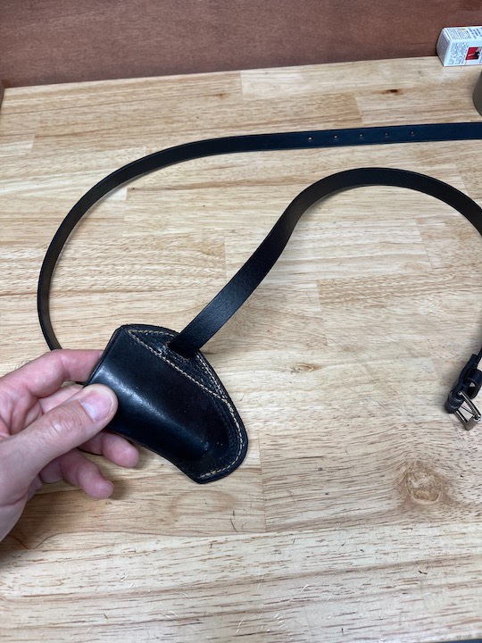

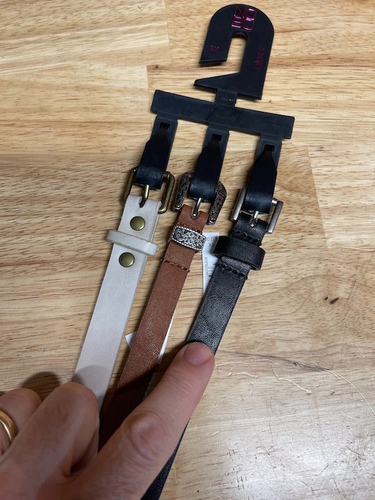

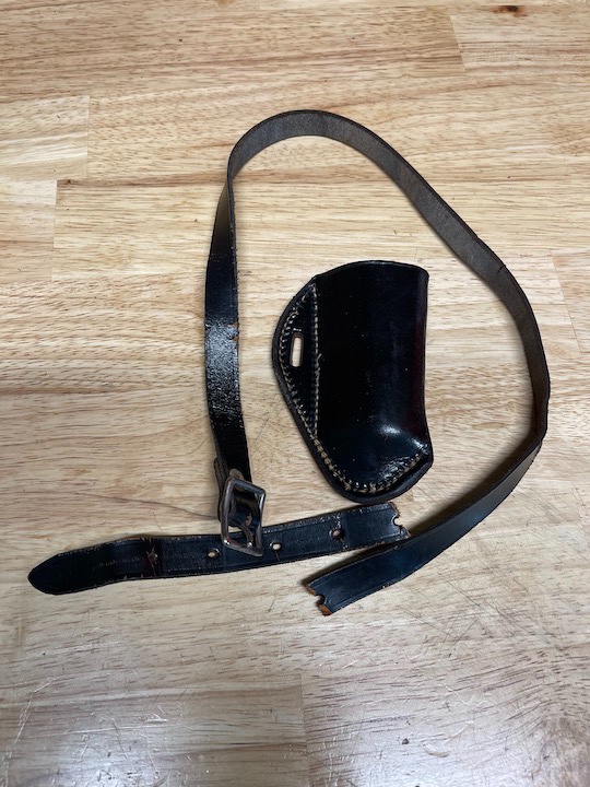

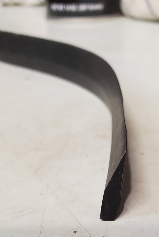

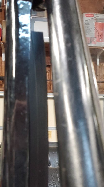

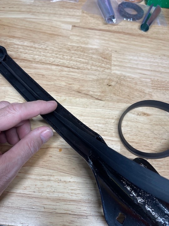

Like most model T mine came with a bunch of parts and stuff. In one of the boxes was a crank holder. When I went to use it the strap broke.
Well Walmart to the rescue. My wife went to the woman's section and found this three belt accessory for 3.00!
Guess what fit just fine. I have to cut it but that's ok.
It worked like a charm.

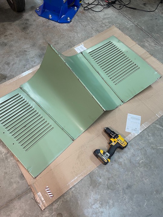

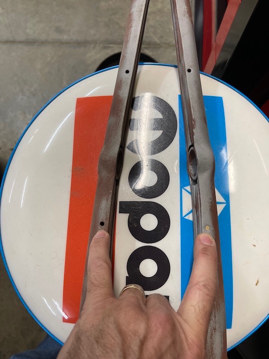

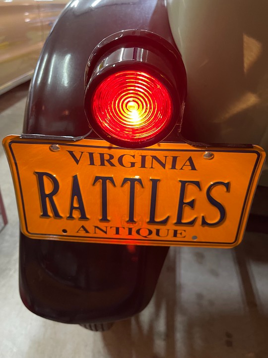

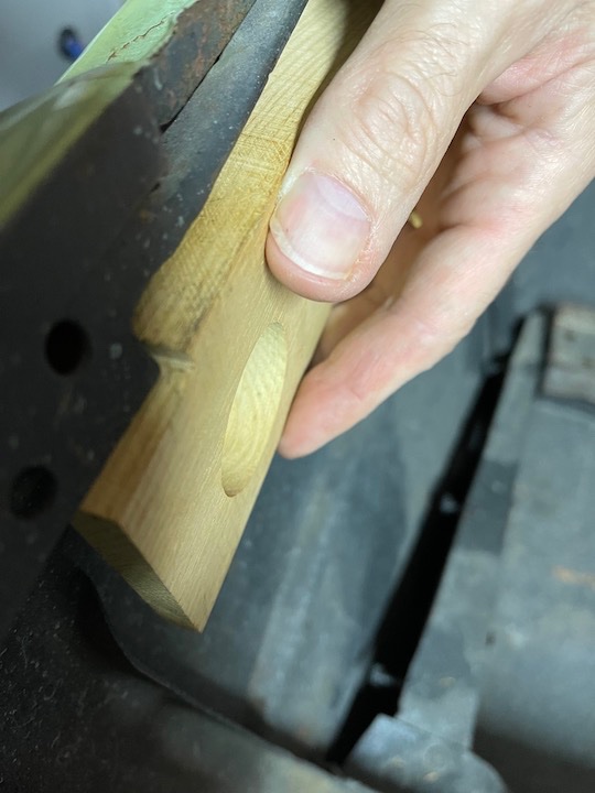

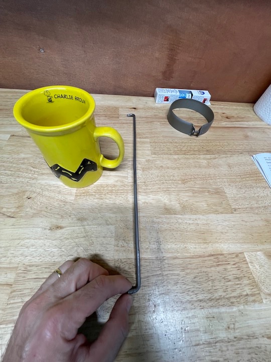

So tonight I had some more progress on Rattles. First I got the hood rod out and cut it to fit. I used the drill to get it out and back in the holes.
Then I fitted the hood. Sort of???? I was also able to get the back light grounded. It's still intermittent so I need to get some more of the washers that bite into the paint.

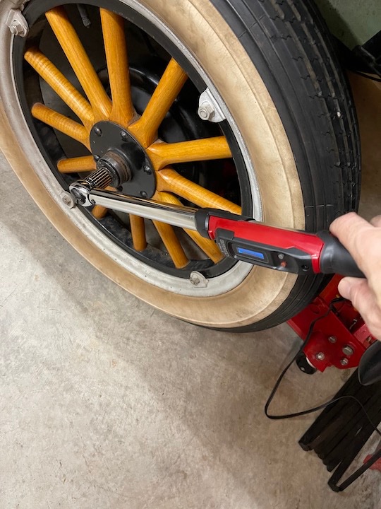

Well I re-torqued the head bolts. I know that's a small step but one that's needed. I also discovered a gas leak where the sediment bulb sheds into the gas tank. It's so small that I don'e smell any gas and it just made a small stain on the hood shelf. I used thread sealer ( I know it's a pipe thread). I'm going to try to take it on a run in the neighborhood tomorrow.

Re: "... it was running rich and bad..." It could be that the choke is not staying open when it should due to a weak choke shaft spring, or it may have just got something stuck under the float needle, or the float may be dragging. It's not much, or it would not have started running better.
Mopar_man
- Last Name: Govoni
Thanks Pat I'm going to check a bunch of things.

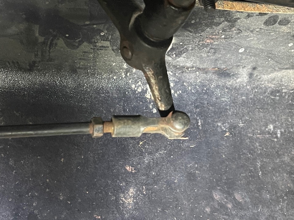

OK so today I got some of the bugs out. My throttle rod was short (because I bent it) and was also in backwards. So I started out with a new one and was able to hook it up without bending it at all.
The first thing I did was checked how the throttle lever moved without the rod hooked up. It was nice and smooth. I hooked up the rod and saw that it was rubbing the block a bit from where someone made the hole for it to pass through. It's not that bad but I wish i would have filed it down a bit when I had the motor apart. Not sure if you can see it here.
Next I'm going to do the same with the timing rod. The timer seems to rub on something when it's fully retarded.

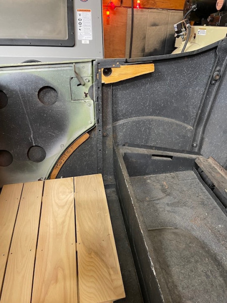

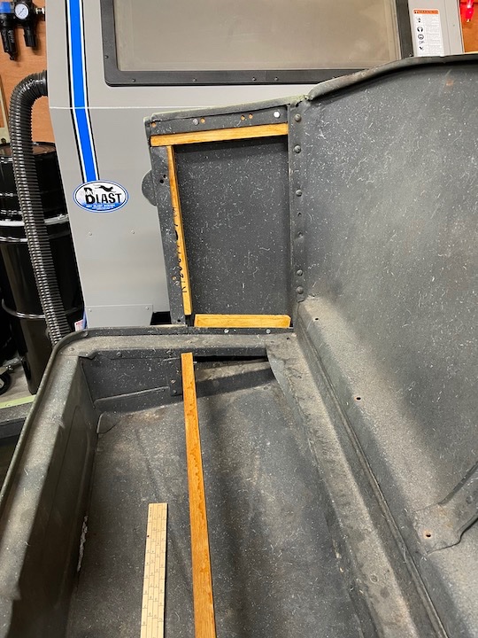

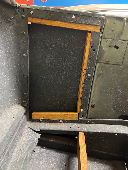

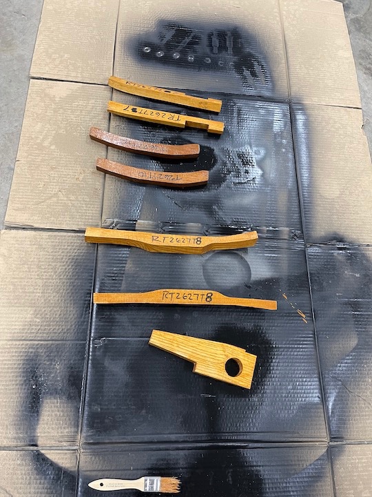

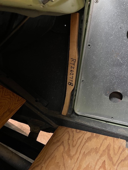

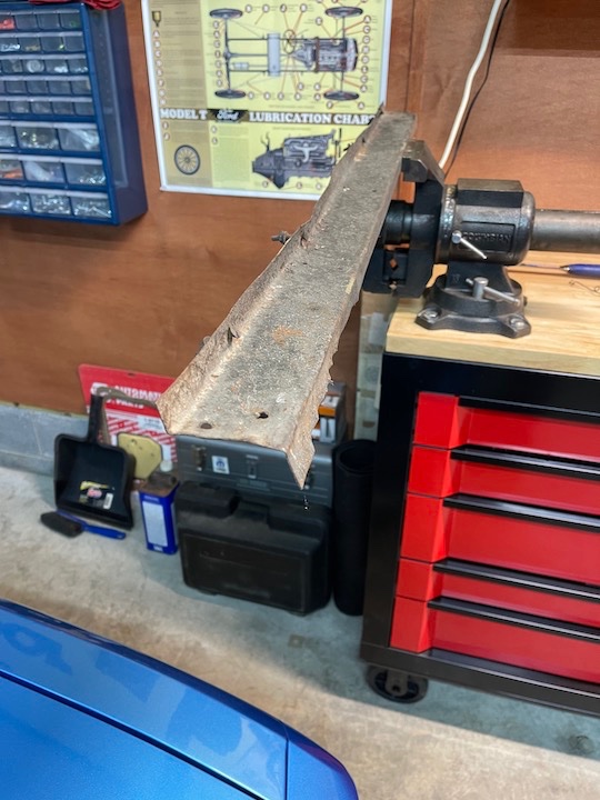

Next up my carpentry skills or lack there of. I know it's a 26/7 so it only has a few pieces of wood but I'm sure I'll mess something up. There are only a few wood parts that are labeled so I may have some questions in the future. This is the first part I'm going to tackle.
Step one was to get this off Then I sand blasted and painted these.
Now I have to fit this in. So I got a sanding machine and I think I've got a lot to sand to get it to fit.

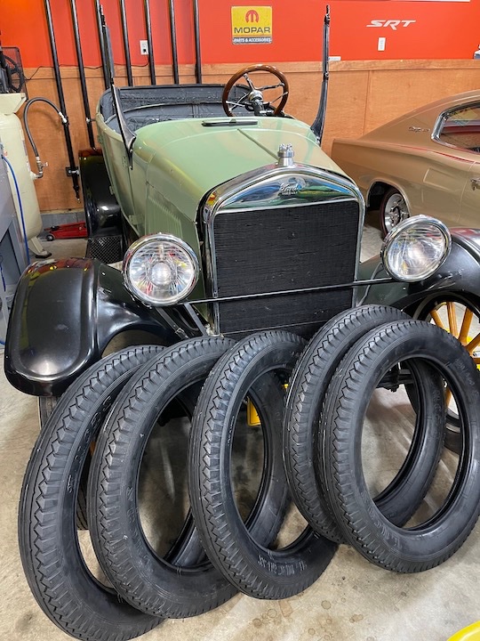

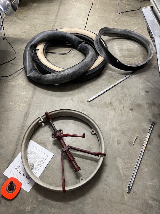

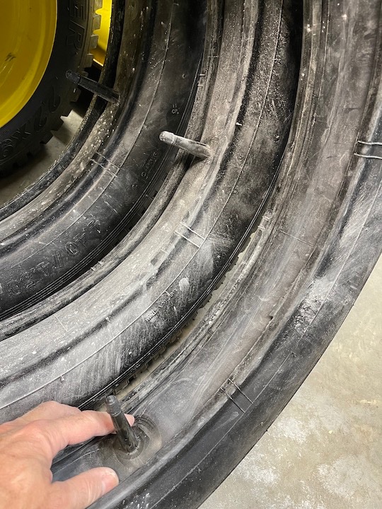

I also got my 5 tires in. These will replace the ones on the car that were put on in 1974.

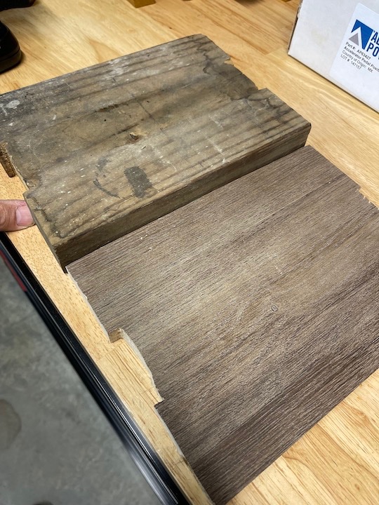

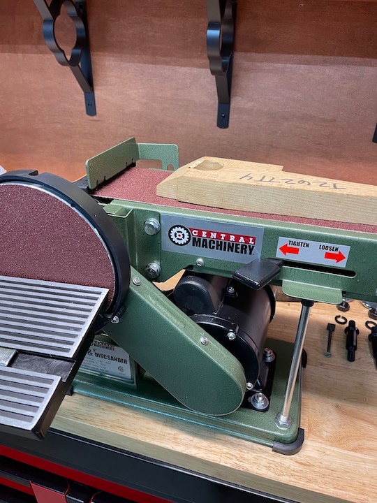

Got the sanding machine set up. I know it's a HF special that may fall apart. I just need it to hold together for a little bit.

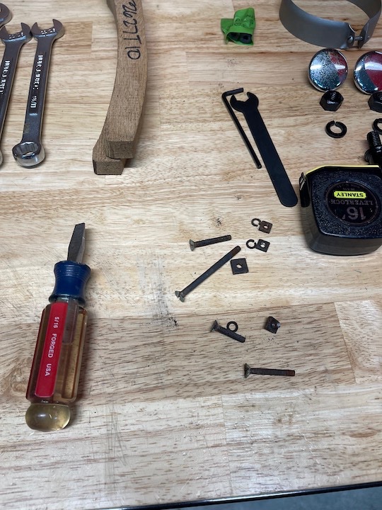

Now I'm trying to get all the bolts that hold the wood in unscrewed. This is my second night with hitting them with PB Blaster. I got one out. Not only are they rusted they were painted when the guy before me sent the car out. I'll get them eventually.
You can see the wood is a bit thick. I'm not sure who made the body kit (It's older maybe 1980's).

This part was in a box that came with the car and I didn't know where it went. I figured it out and started to make it fit.

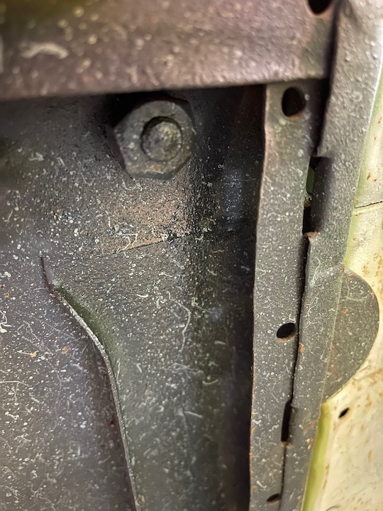

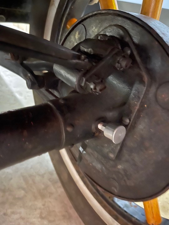

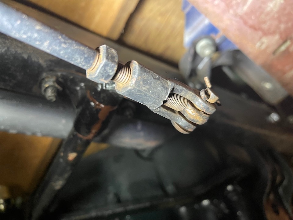

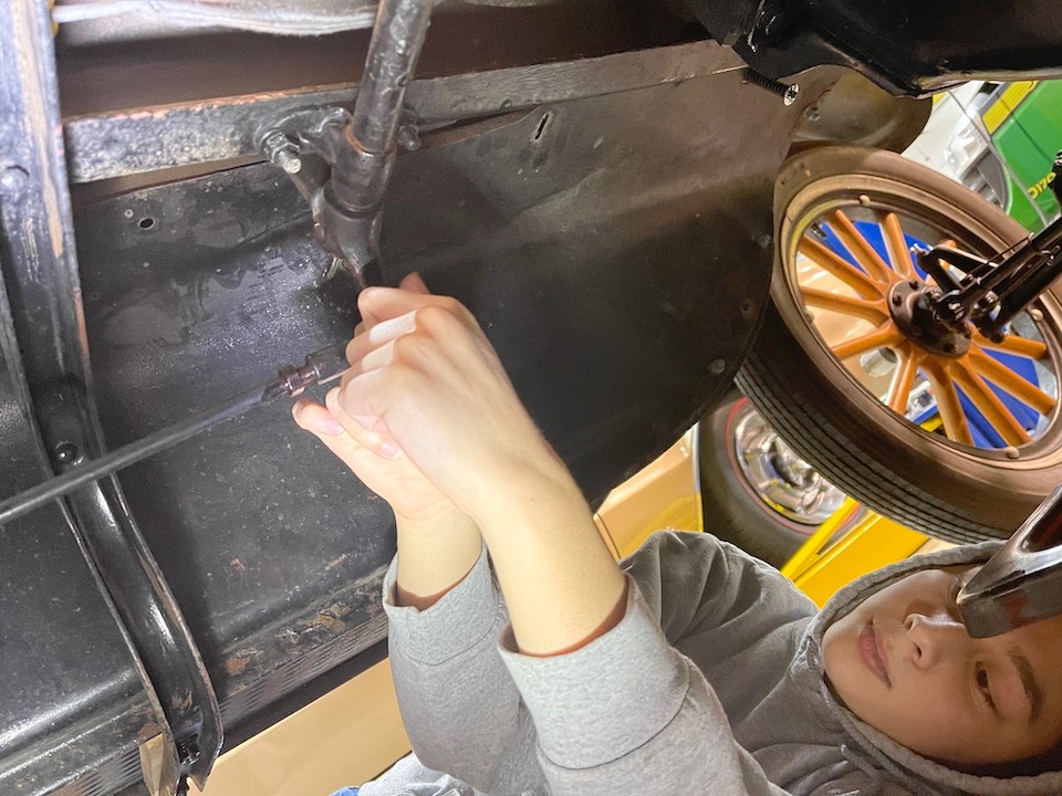

So today we decided to adjust the parking break. We first jacked up the rear and put it on jack stands.
When we go under this car, this is what we found. You can see that the nut was not tightened.
Once we took the pin out we made an adjustment.
Unfortunately that didn't seem to make a difference. We adjusted them as far as they would go and the wheels still turned. I found a set of break shoes that came with the car. I'm guessing that they are the ones that supposed to be in there. When I take the tires off to change them I pull the wheel as well and see for sure. We started out thinking we were going to get something done. Ha!! If everything worked well it wouldn't be as fun.

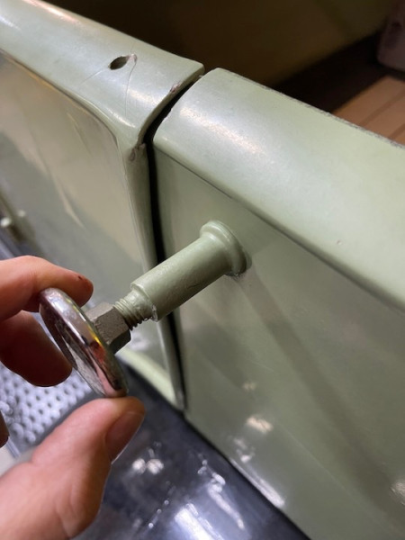

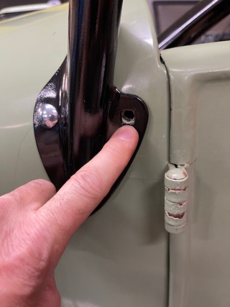

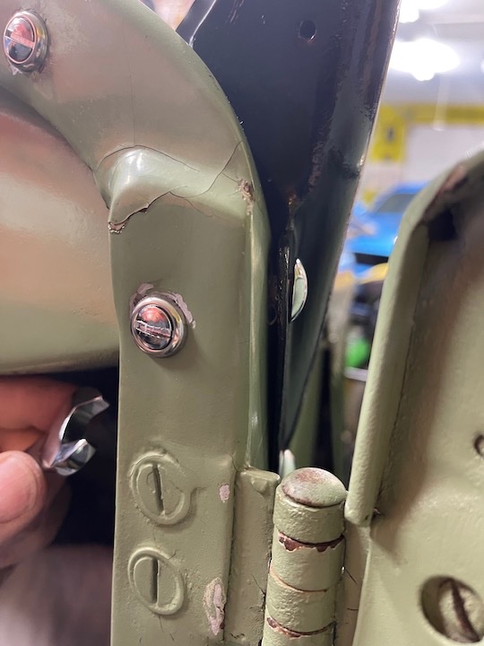

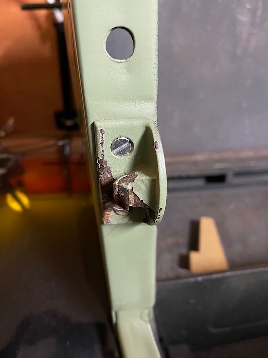

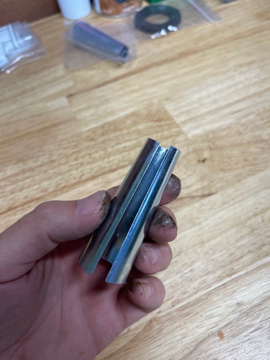

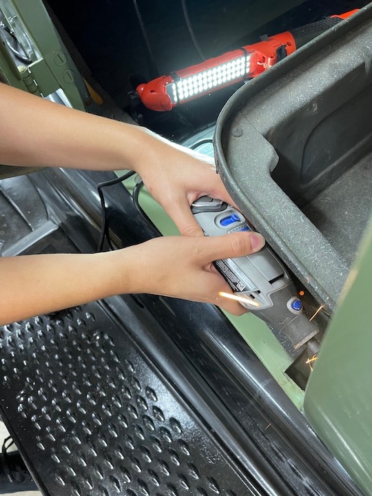

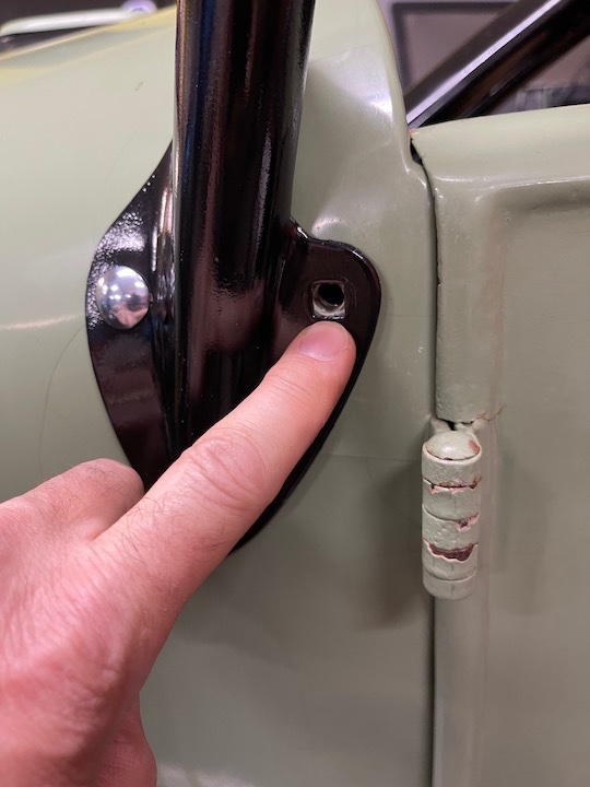

So sorry I haven't posted in a while. I got Covid. Not that bad just a bit of a cough and a runny nose. So I had to put the T on the back burner for a bit. I did start to work on the wood. Big thanks to Tom Miller for answering my questions. The diagram for a 26/7 touring is not that clear and my wood kit that came with the car doesn't have matching numbers. Tom has been very helpful.

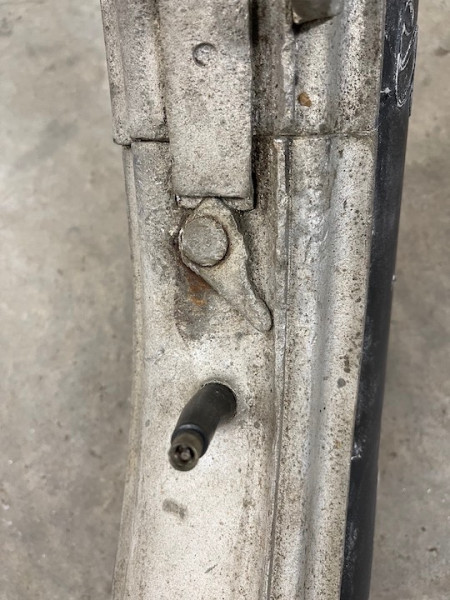

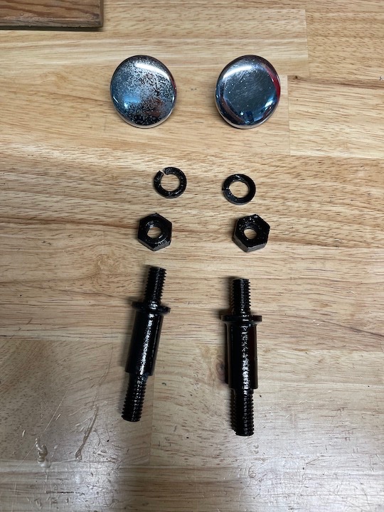

I was able to shave down a machine screw and tap the hole to attach a door latch. Tom asked me to seal the wood so I make it easier for the next guy. Ha!! I'm drilling some holes in the wood to put them on. Test fitting

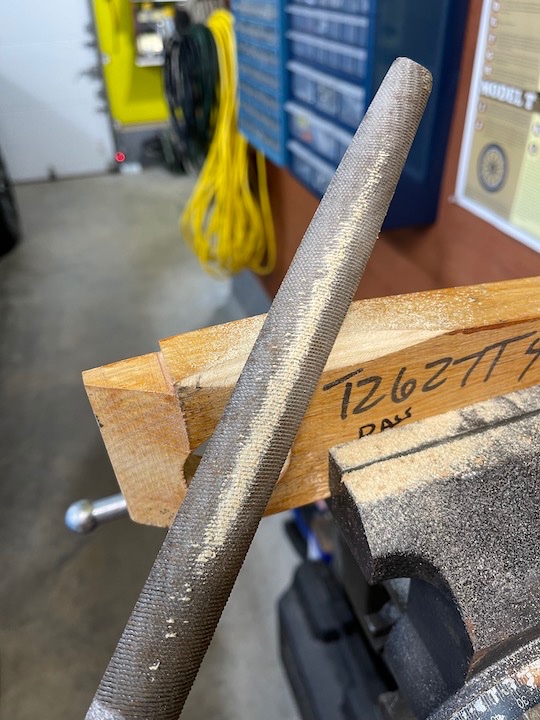

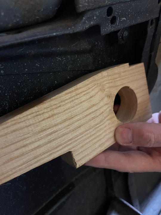

Got some more done tonight. These went in a little more easily.
Had to file this one down a bit to fit it.

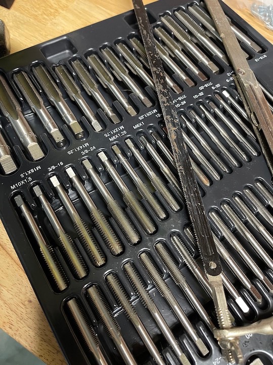

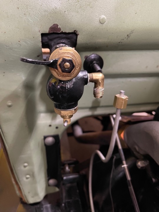

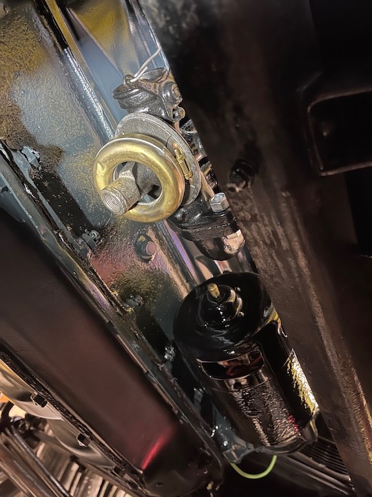

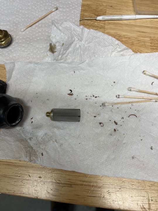

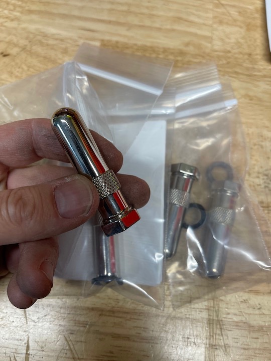

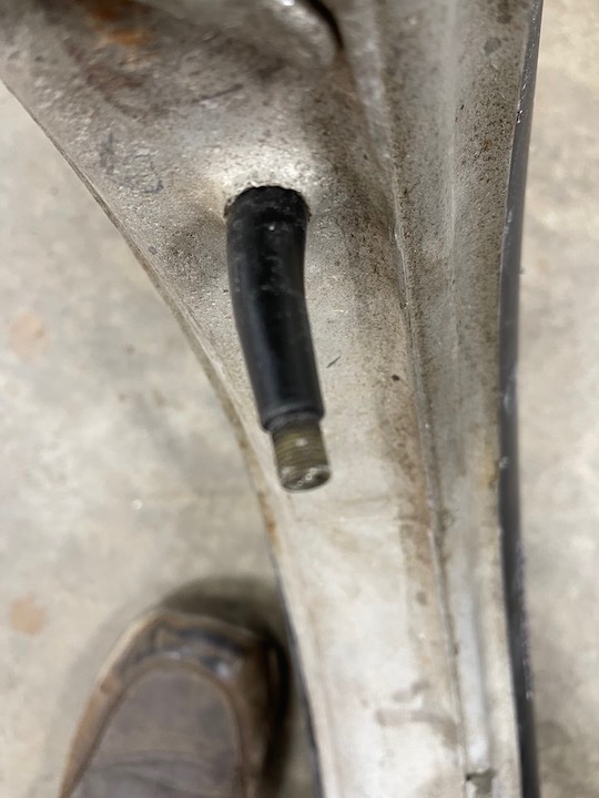

Tonight I took a look at a very small gas leak that I had. I had asked about tapping the threads on the tank but decided to take a look first. After taking off the sediment bowl I found what I suspected. some of the tank sealer had got into the threads and could have contributed to the leak.
After cleaning out the threads with a pick and vacuuming out the junk, I then took the bowl apart. This is all the stuff that was in the threads and bowl.
I then used some of this to seal the threads.
And put the bowl back on. I also ordered a few of the seals for the fuel line and an overflow pipe for the tank from Lang's
- Posts: 1678
- First Name: Dennis
- Last Name: Seth
- Location: Jefferson Ohio
Robert,
I'm sorry to say but that still is going to leak!
The fuel line needs to be connected to the sediment bowl not next to it!
The fuel will not jump across the gap and to the carburetor!
Perry,
Ha! I'll get it connected once I get some of the neoprene seals. Soon.........

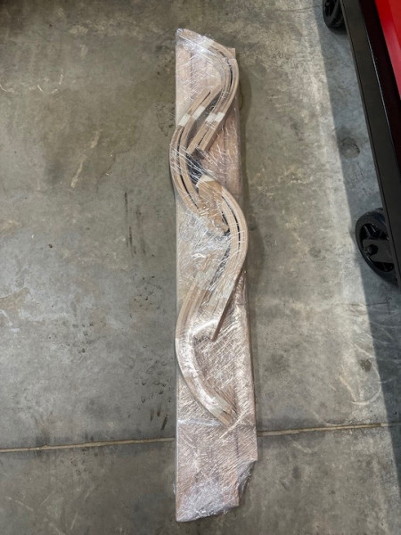

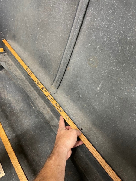

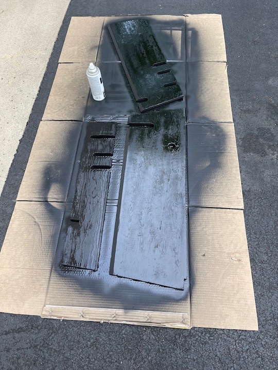

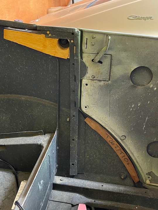

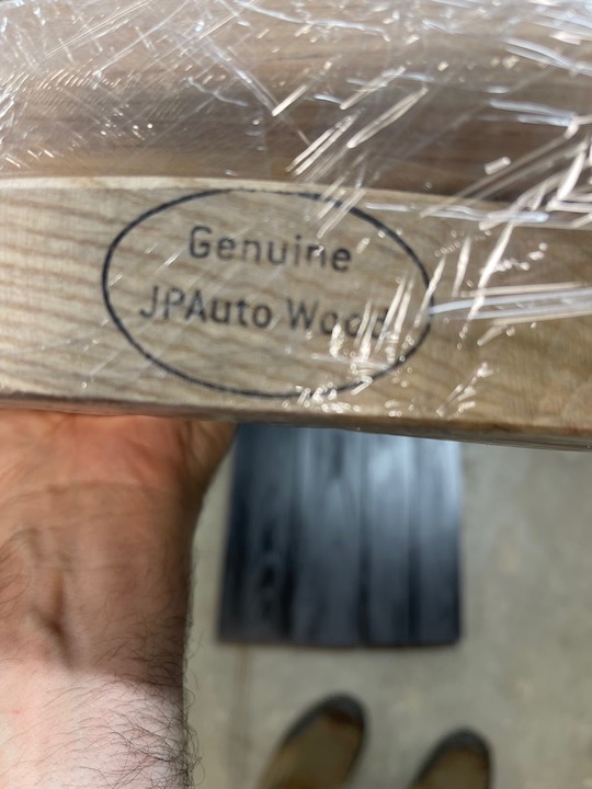

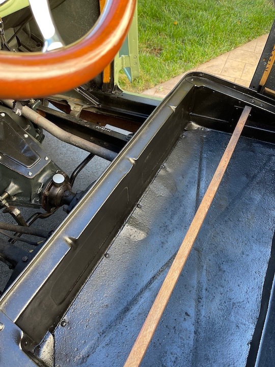

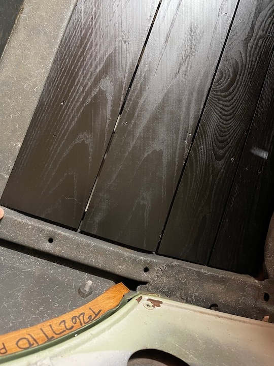

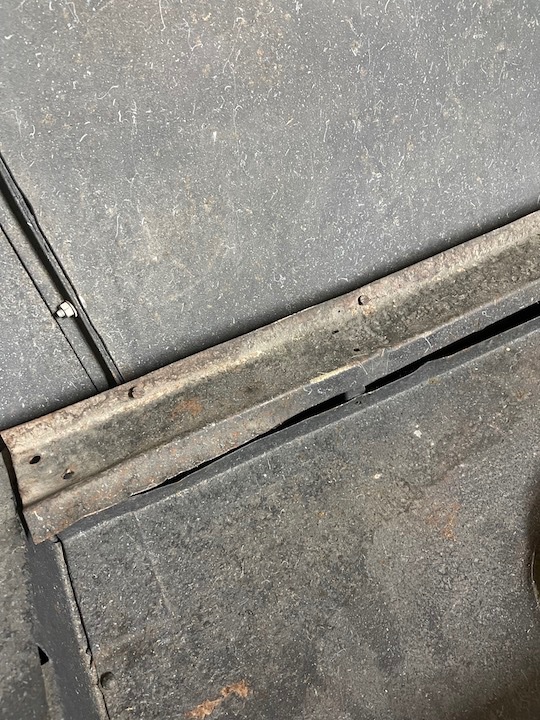

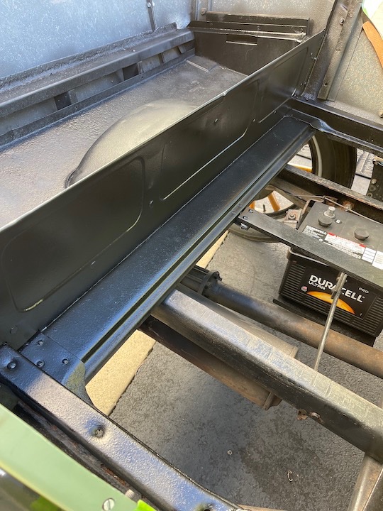

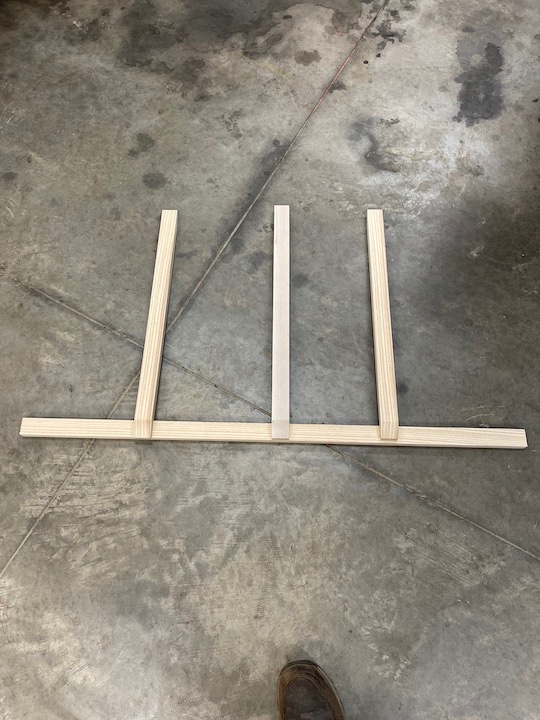

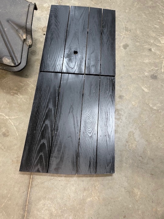

Got some work done yesterday. The first thing I did is fit the floor. I found two issues. First there was a piece of wood under the battery that was too thick and made the battery too high so the floor wouldn't fit. Solved that issue with a thinner piece of wood.
Then I painted the front and rear floors.

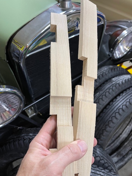

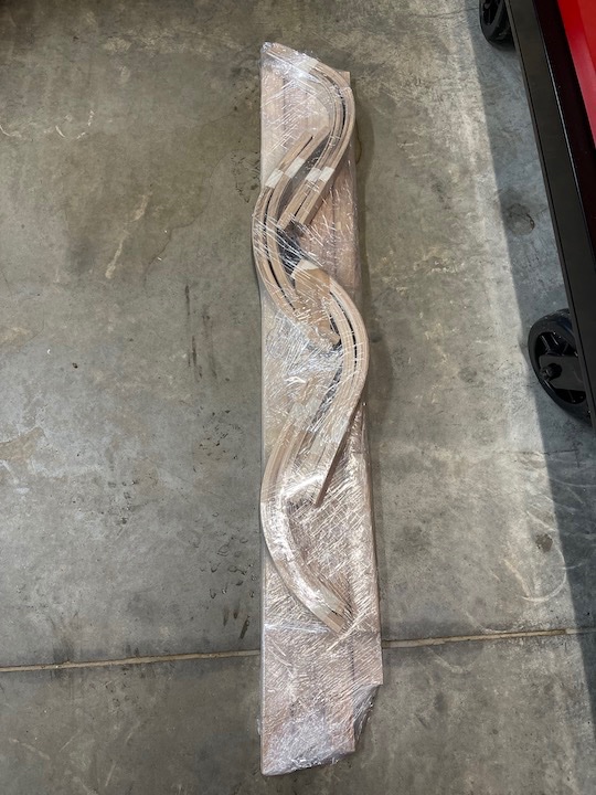

I also picked up some top bows at Luray. Came with the rivets.
They came from JP Auto Wood I got my floors from him as well a few years ago. He makes great stuff and is very helpful.

Well, school's out so I got my mechanic back to work.

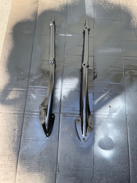

We worked on getting the seat springs painted.

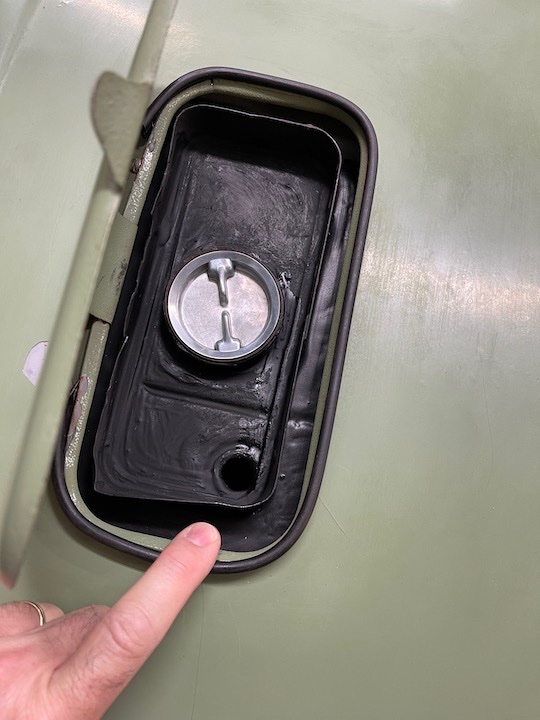

Then we decided to work on getting the gas overflow tube inserted in the tank. Learned something doing this. The early gas tanks had the set screw on the passenger side of the tube and the later ones had it on the engine side. Looking at ours it became obvious that the tank was sitting too far to the drivers side and the tube would not fit. You can see that the tank is not centered.
After some moving and adjusting the tube is back in place. We also started to fit the floor. I'll save my questions for a new post.

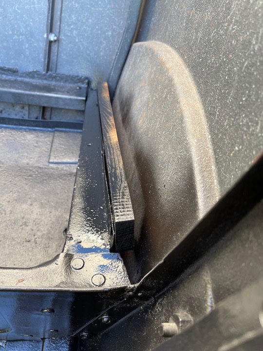

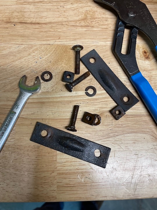

Well we're back at it again. Sorry for the delay My daughter is trying to master the stick shift in the soon to be her Jeep as well as other things. Today we trimmed the floorboards to fit. We had to adjust the hight of the small board in the middle of the rear footwell.
Then we had to cut some rusty bolts off to allow the center wood under the front seat to fit.

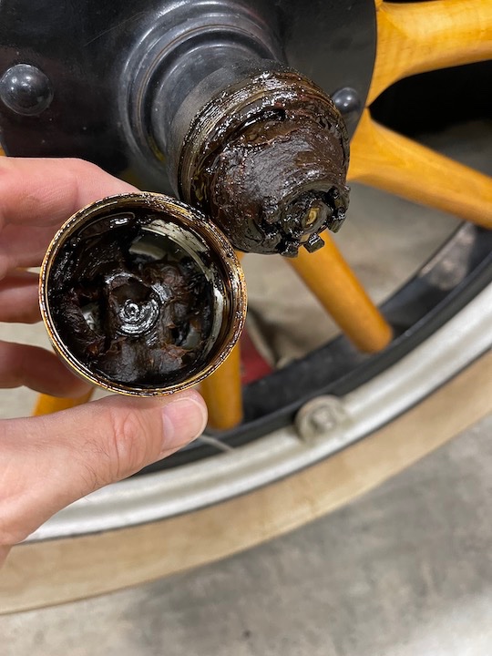

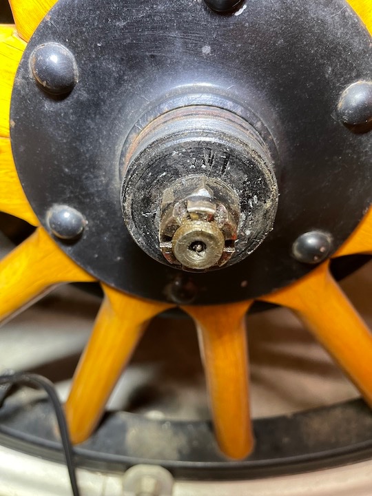

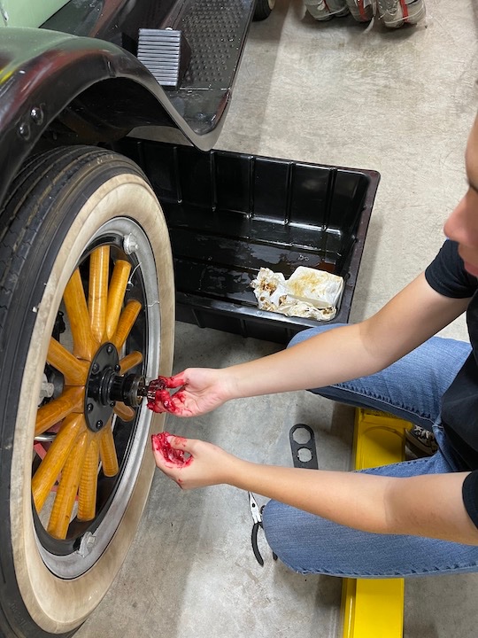

Well we were able to get out and repack the front wheel bearings today.
https://www.youtube.com/shorts/NR1JrIPZaX4
I know they make bearing packers but this is the old way. Ha!!!
https://www.youtube.com/shorts/C75zowRCykg

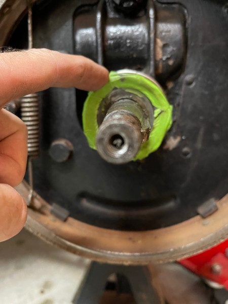

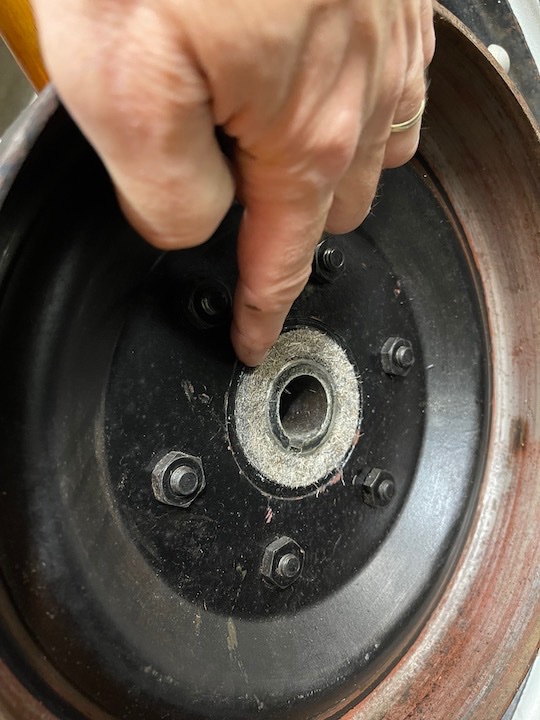

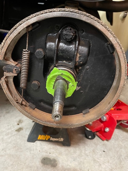

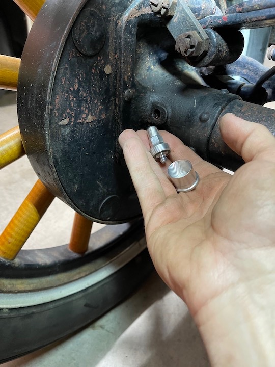

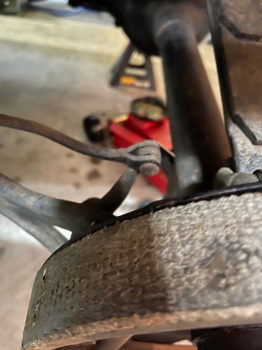

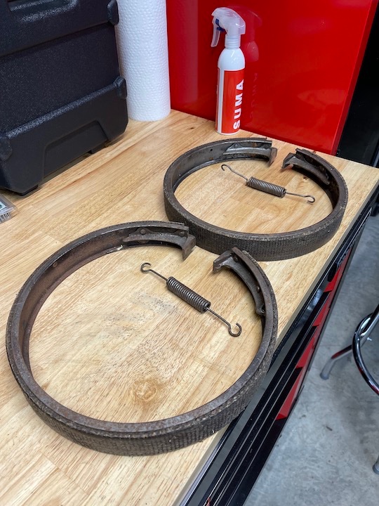

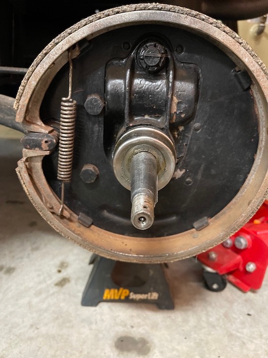

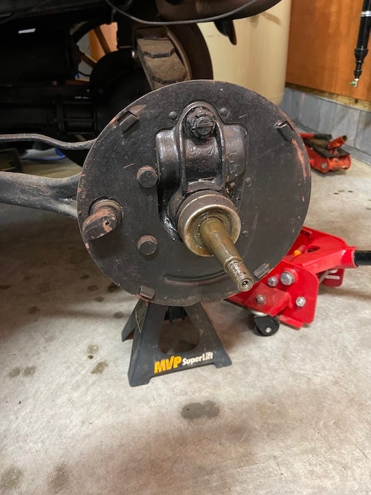

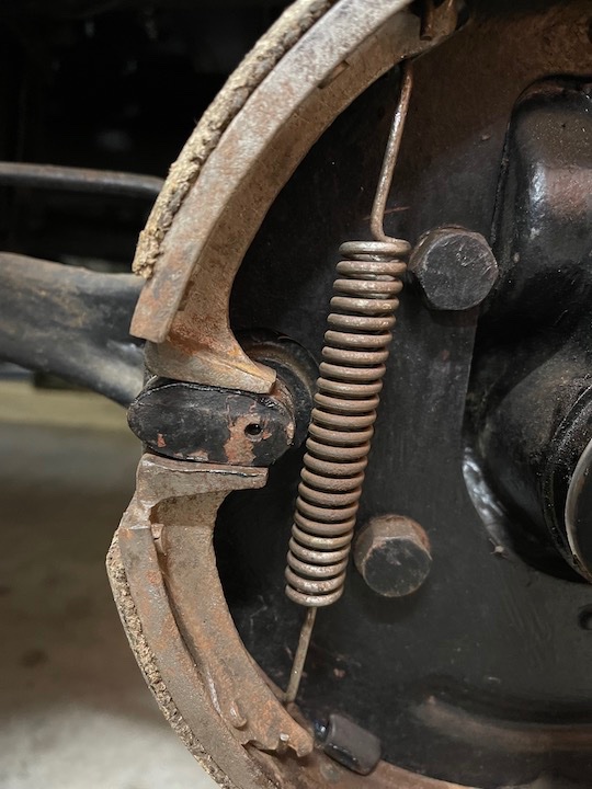

So tonight I decided to take the rear wheel off and see why the parking brake didn't work.
I'm thinking that after finding these in my pile of pars I kind of know why. After taking off the hubcap I discovered something dangerous!!!! No cotter pin and the nut was on finger tight!! Then the wheel just came off!! That's not how that is supposed to happen. Look what I found. No brakes!!
Now for another problem. I got the brakes on and the drum won't fit over them.
- Posts: 5127
Make sure they are round. fit into the drums.
Note the brake cam width compared to the gap when the shoes are in the drum.
Mopar_man

Well I checked by placing the shoe in the drum and measuring the gap. Then measuring the gap when it's installed. sure enough I think I have the issue of the lining being too thick. It looks like the pad was in the car before because you can see that it's used a bit. I've seen people have said to sand the pad down. You would think that they would make one that fits.
- Posts: 6708
Your one band is sprung open and may have to replace it
as for friction material, folks are simply selling what is commercially available and as you've found, it is too thick; it is one of the hobby's best known secrets
your rear wheel is going too far onto the axle and mashing into the dust cover which is a common problem. Vendors sell shims to move the hub out a bit and if the wheel is installed tightly, are perfectly serviceable.
Finally, there is a seal installed on the inside face of the drum which is ALWAYS missing...it is the same felt seal as is used for the front inner bearing...see this: http://www.mtfca.com/discus/messages/82 ... 1541507398
glad your test drive was limited and your clutch was not prone to dragging!
Mark Nunn
- Posts: 1287
- Last Name: Nunn
- Location: Bennington, NE
My '26 Runabout had shoes with pieces of rivets but no lining. I relined them with material from one of our vendors. I used a coarse 2"-wide wood rasp to take down the lining to where I was satisfied with fit. I also had to round over the lining edge on the outboard side to match the rounded corner of the wire wheel drum.
Scott mentioned the shoe that has a wide opening. The cams spread shoes at the openings. The highest stress on shoes with worn out linings is at a point opposite the open ends. Both of mine were bent out at that point, showing a gap there between linings and the drum. (I placed my shoes in a drum on the workbench as a guide to reshape my shoes.) Check, bend a little, repeat. I placed my shoes over the open jaws of a vise and gently tapped between the jaws until shoes fit well. Then I went after the linings with a rasp.
Mopar_man
- Last Name: Govoni
Scott Thanks for all you help! I now see that one band is open more than the other. Does the shim look like a big washer? I'm going to look for it as well as the felt washer.
Mark Thanks for your help as well. I have set the shoe in the drum and it looks like it's ok. I will have to get after the thickness of the band like everyone else.
This gives new meaning to the phrase "Thant's when the wheels came off."

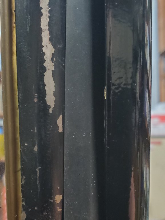

Today I got some more wood in the car and painted my windshield stanchions.
Not sure what all these little holes are for yet. One seems to be filled in.
- Posts: 1678
- Last Name: Seth
Fess up and tell us the truth...Today YOUR DAUGHTER got some more wood in the car and painted the windshield stanchions!Today I got some more wood in the car and painted my windshield stanchions
Mopar_man
- Last Name: Govoni
Ha! Don't worry she'll check my work. LOL
Mark Nunn
- Posts: 1287
- Last Name: Nunn
The little holes are for side curtain fasteners.

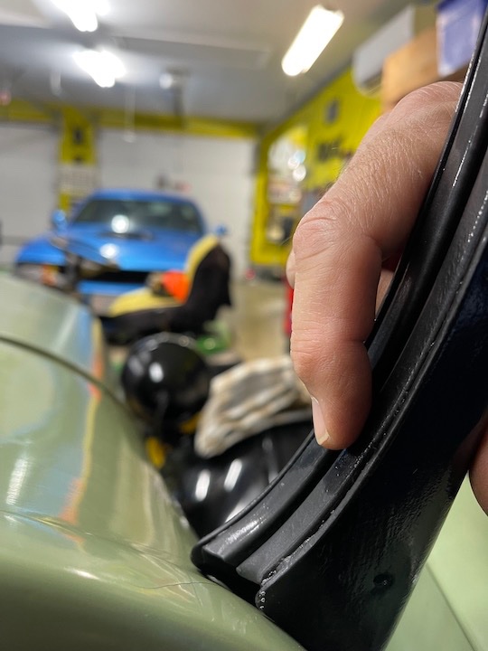

Today's work was first putting on the windshield stanchions. Is this grove for a rubber gasket?
Also what's the best way to get the nut on. My gosh I thought the nut that holds the power brake booster on a MOPAR under the dash was bad. I may have to take apart the dash again.
Today I also got the wheel on. I wanted to see if it was hitting the dust cover so I put some tape on it and tightened the wheel down. Then I spun the wheel and took it off and looked for a mark.
My shims should be coming soon.
RVA23T
- Posts: 849
- Last Name: C
Yep this is what the rubber looks like for that. Readily available from vendors.
I just learned about its availability and also just found my stanchions only have the uppers retainers and not the 2 lower ones on each side of Scarlotte O'Hara. Guess I will be in the market for some new or nice used ' 23 stanchions.
As far as the bolt...I would think small hands would be able to get them on. Must be another great feature of the "improved" car.

More progress tonight! I was able to put the wood in for the front. I hope that it gives me enough wood for the interior. I can't imagine nailing to the wood. I'll have to use a staple gun. Seems like the wood would flex as you were hitting it.
I'm thinking this piece of wood goes at the bottom of the front seat.

The other thing I did tonight was looked at the rear axel. Here is what the shim loos like.
Then on the car.
I also got the felt for the hub.
Here is a video of what the issue is with the axel.
https://www.youtube.com/watch?v=4AqqNuvGjnU&t=37s

Today's adventure Getting the Touring car's windshield weather tight.
Then it was time to put the one bolt in that it almost impossible to get a nut on the other side.
Even my wife gave it a shot!

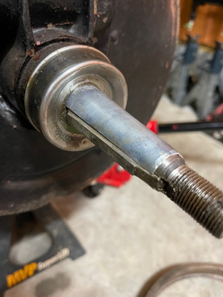

- Posts: 5127
I believe your outer seal cup is not on all the way. It takes brutal force to get them seated all the way down.
There is a low area where the hub rubbed & there is a high area @ the outer edge & I see a lot of tubing behind the cup..
Mopar_man
- Last Name: Govoni
John I'll try it again. I did tap it with a piece of wood and a small hammer. Maybe I should give it a better hit.
- Posts: 5127
- Posts: 6708
Robert
looking at the last picture, I see that your daughter has matured a bit during the build!
Mopar_man
- Last Name: Govoni
John, It worked!! I put a piece of wood on it and hit it a bit harder with a hammer and it moved quite a bit. I don't think it will hit anymore. I also sanded the shoes down. There is still a bit of a drag on them but I don't want to sand off the rivets.
Scott, Ha that's my better half.

Well Tonight I made some adjustments to the Emergency brakes. Here is what I did.
First I made sure that this cam and lever was to the rear.
Made sure the cam was level.
Made sure I torqued it to 120 foot pounds and look cotter pins now!!!
Here is a look at what I did.
https://www.youtube.com/watch?v=3EvEwXlQPRQ

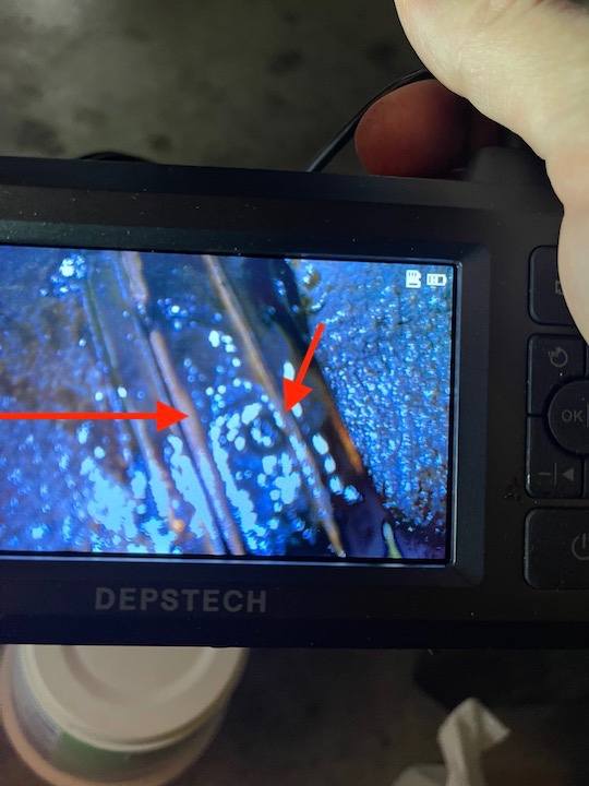

Almost forgot. I was able to scope the rear and I think i got a look at the thrust washers. Are these them? The camera was pointing to the right. I could see the gears when I looked left and I think I'm looking at them. See any Babbitt in there?

I was able to paint the parts in the interior that will show after I put the interior in.

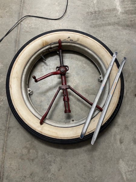

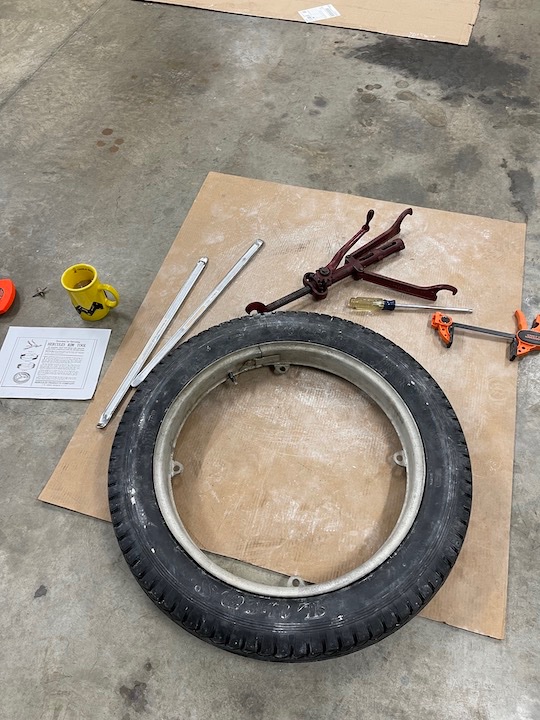

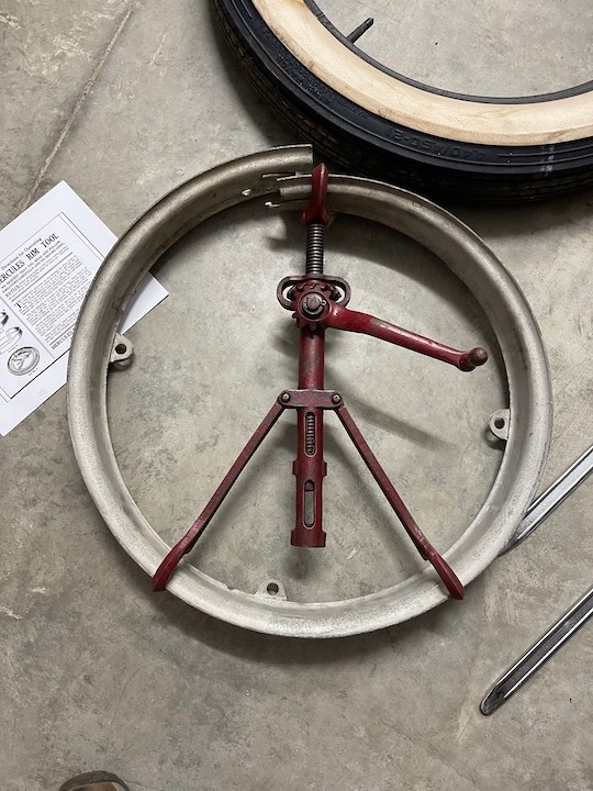

I also printed off the directions on how to use a rim split tool and think I did it correctly and didn't destroy the rim.
How hard can this be? The receipt I have for the tires says that they were put on the car in 1974.
Now all I have to do is put on 5 tires!!!
I also got these from Lang's. They allow me to use a modern valve stem and still have the old look.
Mopar_man
- Last Name: Govoni

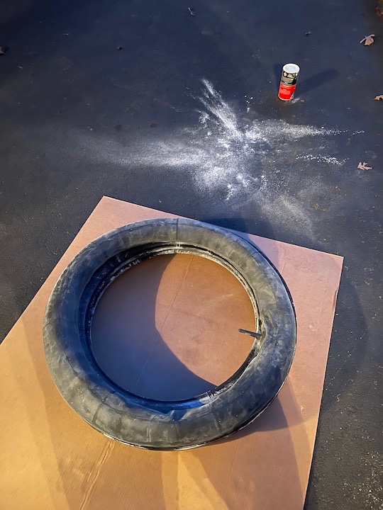

Got some time tonight to powder up the tires and get the tubes in them. I filled the tubes with a bit of air, then I put the tire talc in the tire.
Then I got the tube in.
The next thing I did was filled the tube up with air. this made sure that I didn't have any kinks or twists in the tube.
Next When I have some light. I'll start to take the rest of the rims off and let some air out of the tubes to put the flaps in.

We now have flaps! I decided to buy them new as the ones that were in the tires are hard.
I also picked up some wood from Ford Wood. Great people to deal with.

Next up she worked on the spare tire holder. The threads were terrible so she hit them with the blaster first.
Then she cleaned up the threads.
We powdered them up first and let some of the air out of the tubes. Once they were in I ran my hand on each side to make sure the flap was not pinched or twisted
We now have all five tires with the tubes and flaps in. Next up will be to take the old tires off and instal the split rim.
Angie painted some deck stain on the new wood so (I was told this a while back) the next guy won't have rotten wood.

I you recall a few post ago I had an issue where a slight gas leak. That turned into me finding that some of the sealant from when the gas tank was repaired had gotten into the sediment bulb. Well before I fill it with gas I checked the float bowl. I was nice and clean.
Then as I was looking at the rear axel I noticed that these were missing. I know they are not screwed in all the way but they are tight and I was able to get grease in.

Next up was my first time putting a split rim on. The tool worked as advertised!!! I have to admit I was a bit scared that I would damage things. But it went great!!!
This is what it looked like after I was done.
I put a little bend in the stem and I think getting it to come out straight was the hard part.
Hey! Only four more to go!!!!!!
