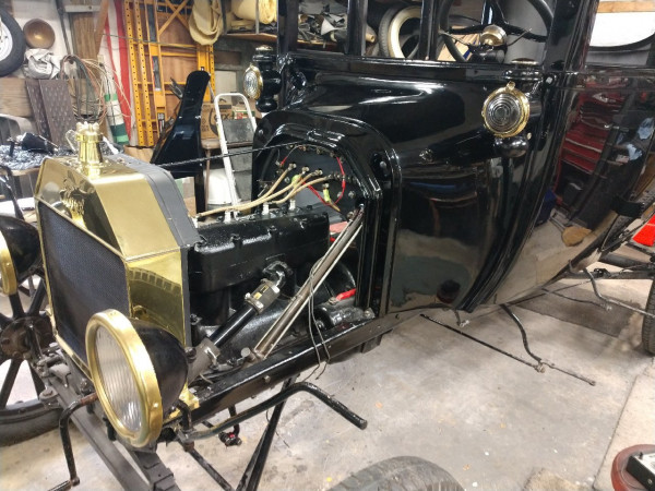

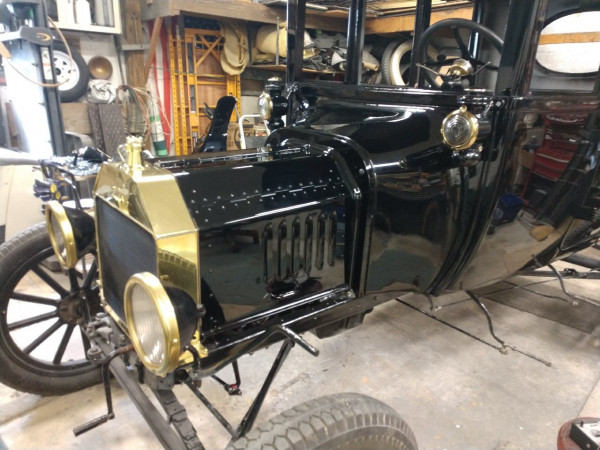

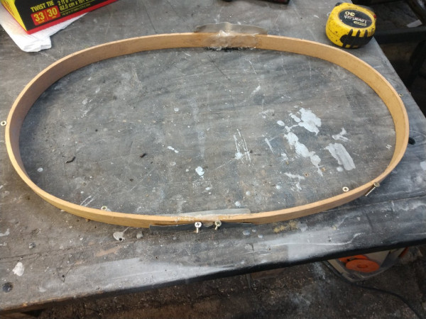

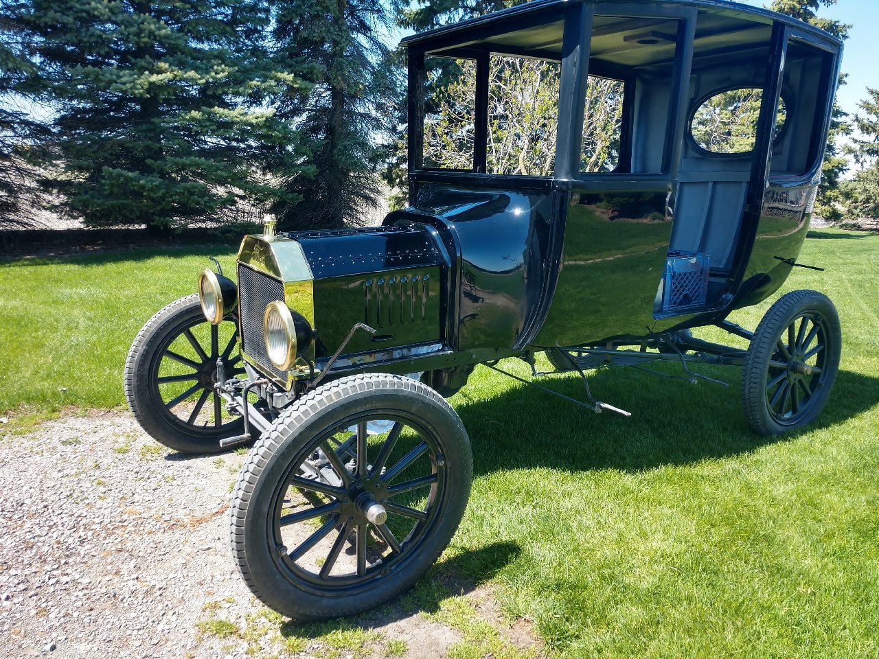

Don, I believe the bolts should be 5/16" coach bolts, with the nuts under the hood former. Here in Australia, coach bolts come with Whitworth nuts. On 5/16" bolts these nuts are bigger than those Henry used. If I make a special order for 5/16" UNC nuts, then I get the correct size, which is 1/2".
I love the way your hood fits.
Hope this helps. Allan from down under.

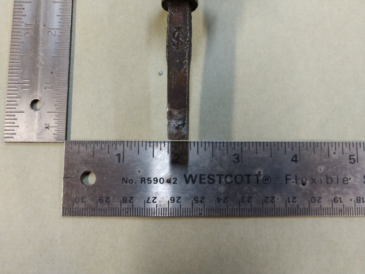

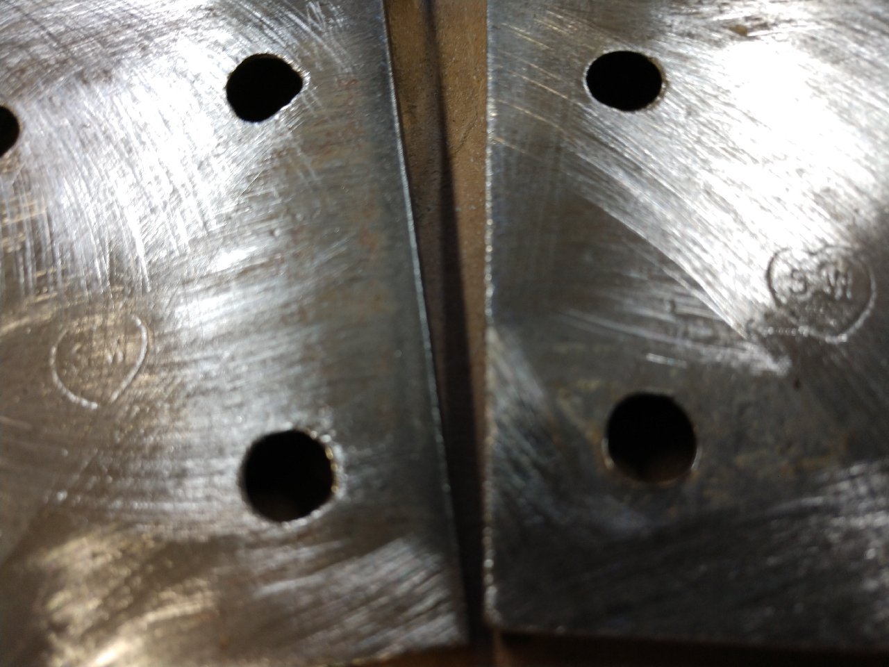

Re: '16 Centerdoor restore...

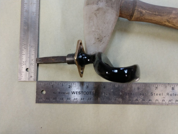

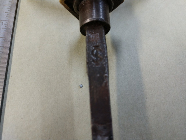

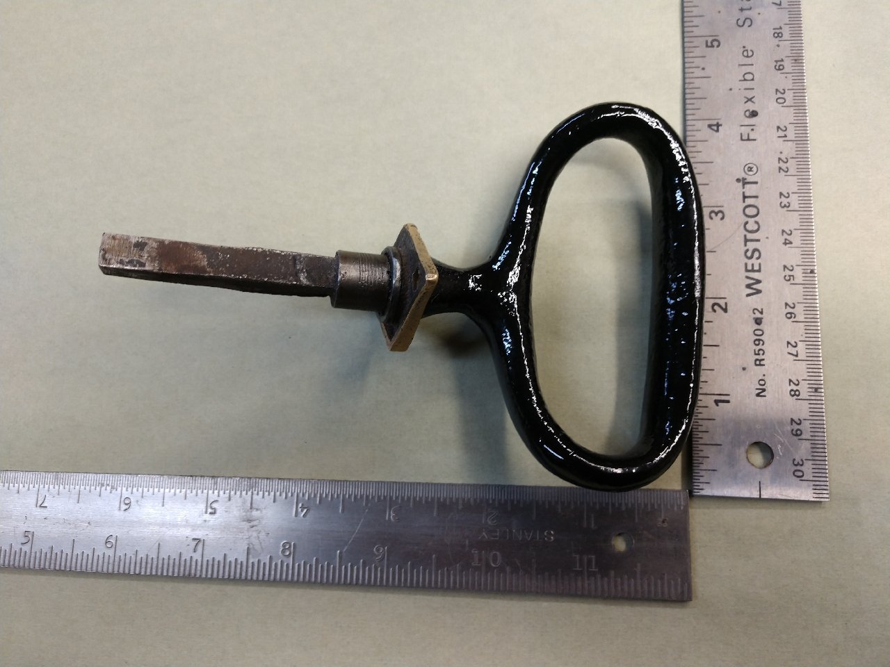

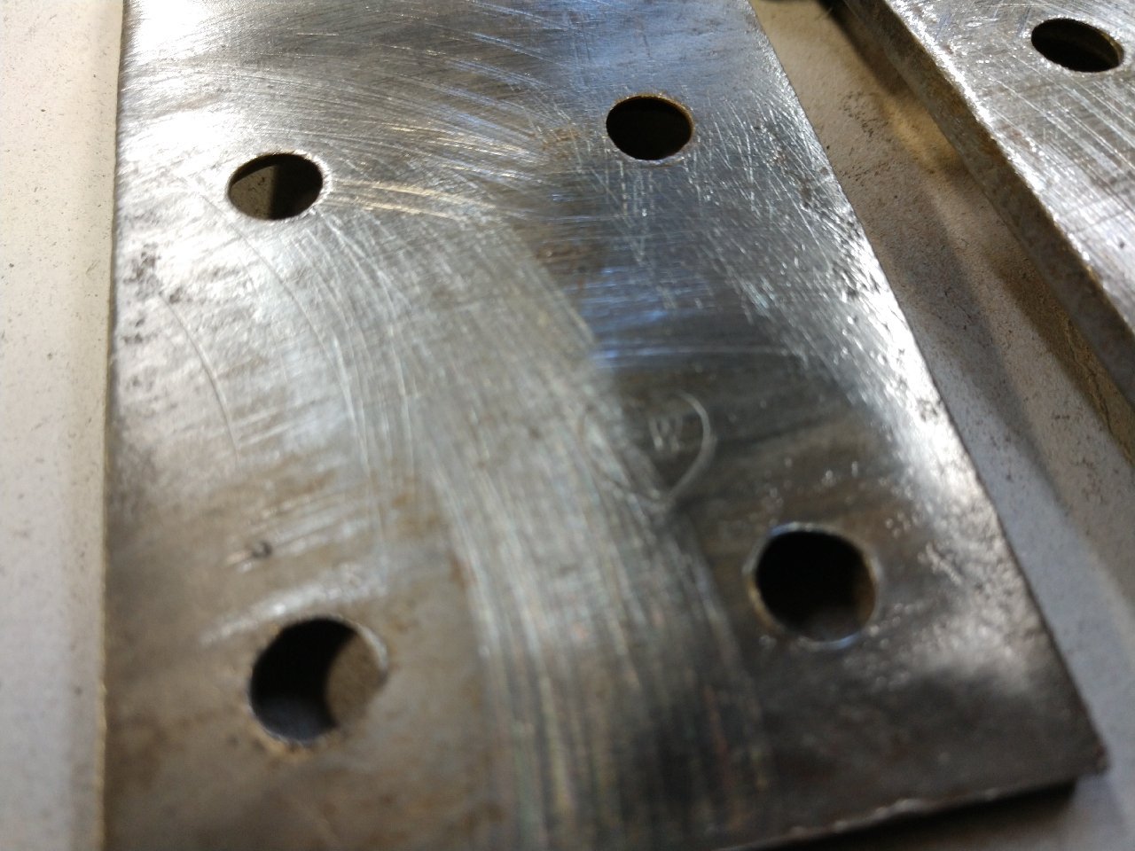

So I'm cleaning up the door hinges on this century old machine and find a "heart" shaped stamping on each hinge. The initials "S W" stamped inside the heart. Anyone know who this could have been? Thanks in advance !!
Don, Something in My memory brain is telling me it is Stanley works. ( Stanley hardware) They were a huge hardware supplier back then, and likely an off the shelf item for the builder. A search of cartouche marks on the interweb may be worthwhile.
Tim you are absolutely right !! The following is from a FaceBook friend.
The S.W. in the heart design appeared "according to my sources", in
various configurations below the notched rectangle STANLEY logo, from c.
1920 to c. 1934. It was preceded by the "V logo" and followed by the
simple notched rectangle.
Before 1920 the Stanley Rule and Level Co. and Stanley Works
existed as two separate companies (it's a long story...) For some time
before the merger of the two firms in 1920, Stanley Works had been using
the heart logo with SW inside, in recognition of company stalwart William
H. Hart, who served the firm for 61 years and was Chairman of the Board
from 1915-18 (when he "retired" at age 84 and died the following year!).
After the merger, tradition has it that employees were invited to suggest a
new logo for the now united operation, and what we now call the Sweetheart
logo on Stanley tools was born. Although the use of the SW in the heart
was formally dropped in favor of the simple notched rectangle in 1934, the
older combination logo still came out of the plant on various product lines
until the old stock was used up over the next several years.
Neat info, Don. Sad that Stanley has gone the way of the really cheap tool market.(got no time for crap tools ) I have some old Stanley stuff that I’ll have and use forever.

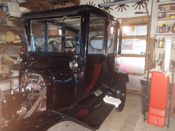

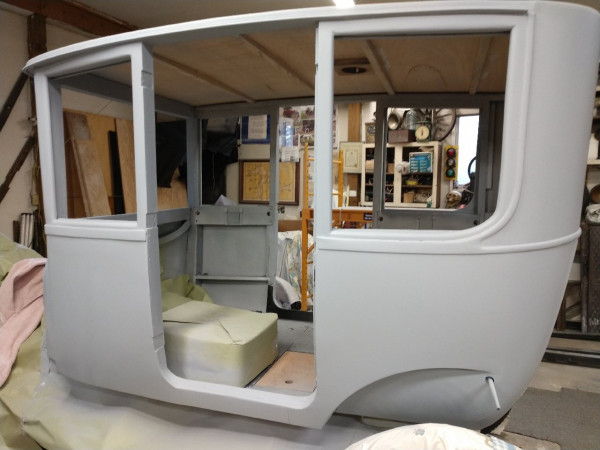

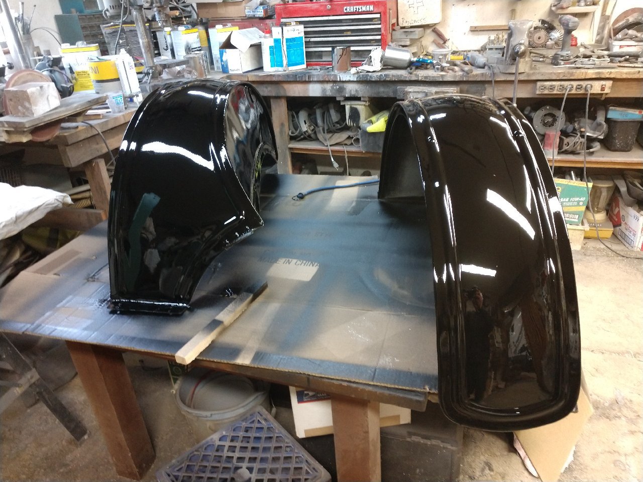

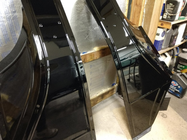

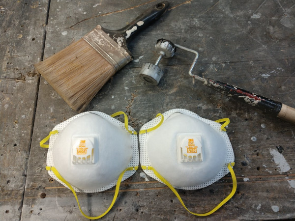

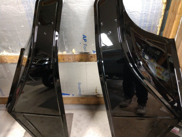

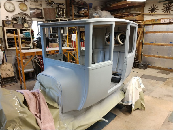

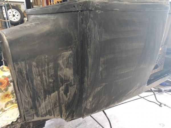

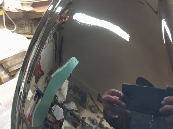

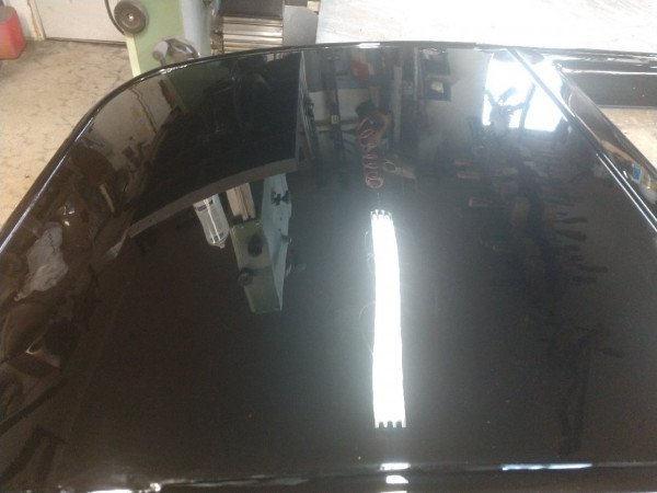

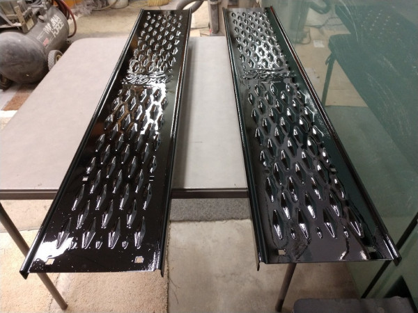

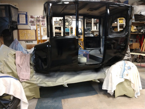

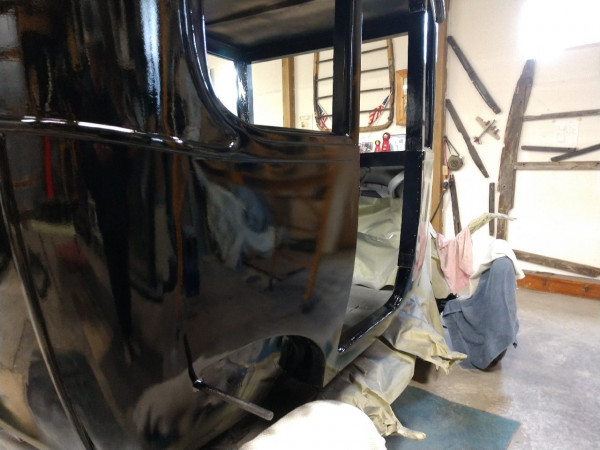

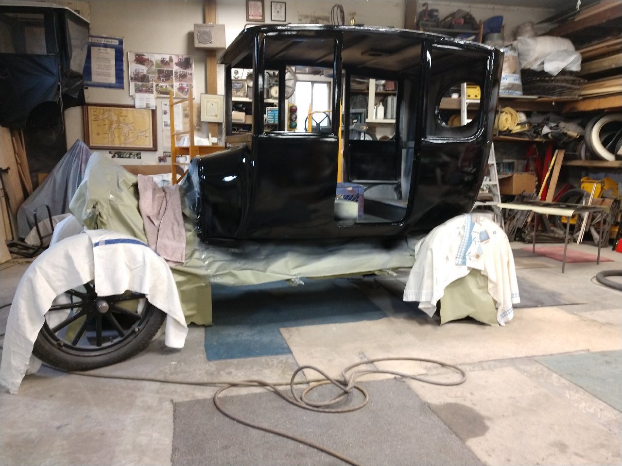

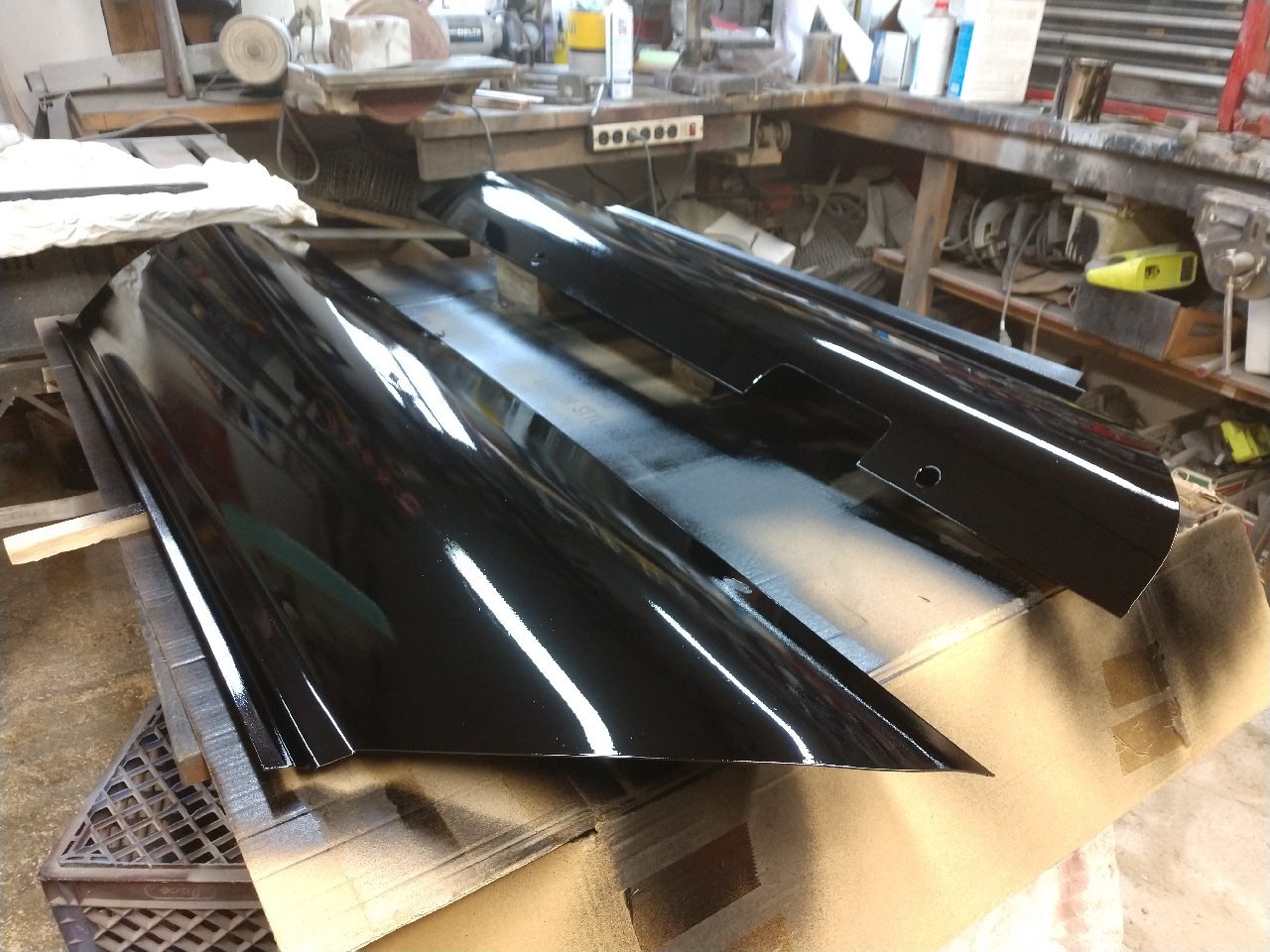

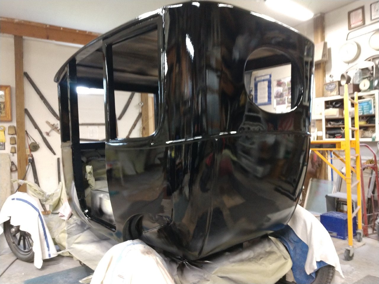

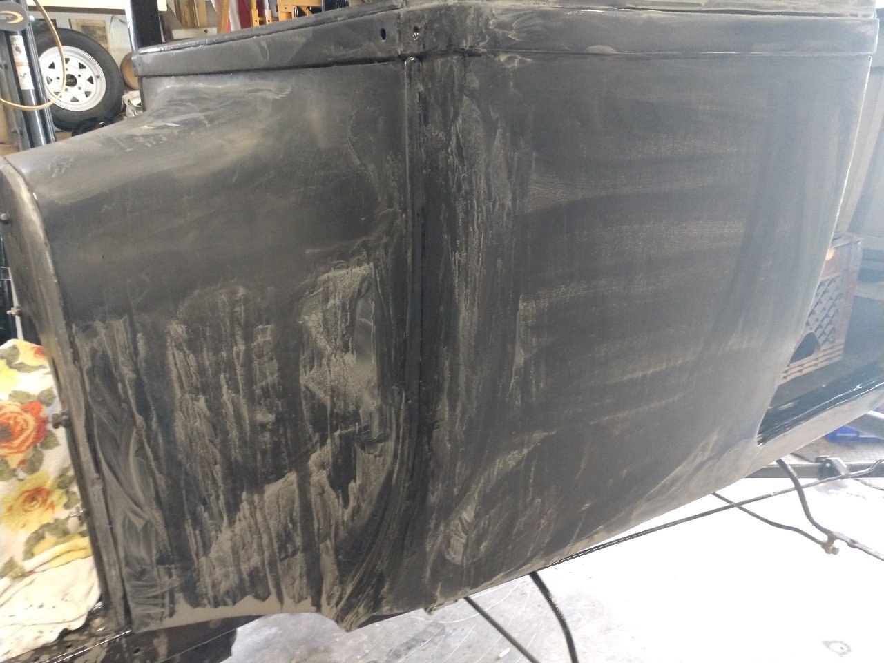

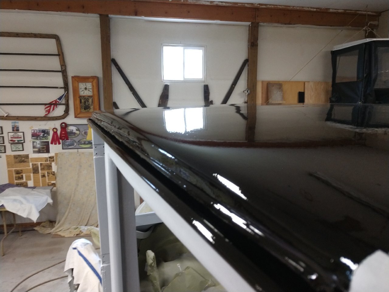

Started to do some painting today on a few smalls. Painting once a year isn't enough, and it shows. Still very wet in these pictures.
mtntee20
- Posts: 708
- First Name: Terry & Sharon
- Last Name: Miller
- Location: Westminster, CO
Don,
If I could paint that good just once a year, I would be ECSTATIC!!!! Geez, those look great in the photos. I realize, close up, you might be able to see some small defects but the photos look outstanding. Good Work!
Cheers,
Terry
Cheers,
Terry
FordorGalore
Topic author - Posts: 430
- Joined: Fri May 03, 2019 8:20 am
- First Name: fore
- Last Name: door
- * REQUIRED* Type and Year of Model Ts owned: 1922 centerdoor 1927 fordor 1916 centerdoor
- Location: Nowhere Michigan

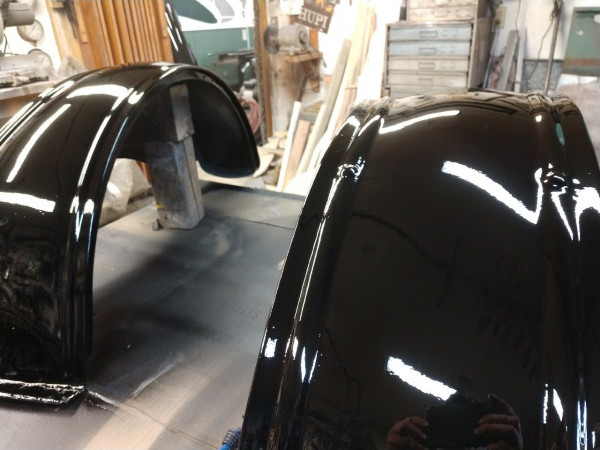

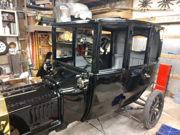

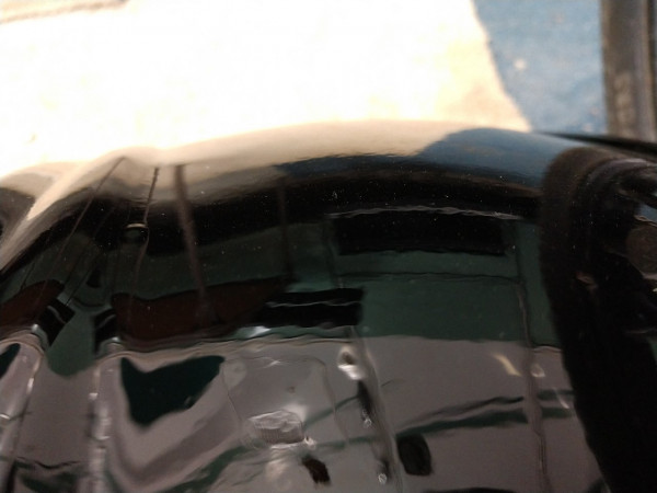

Thank you Terry, I probably should have waited until it laid down and dried before taking pictures. Being that its still wet is shows every little piece of dust in it. I will have to wait until the morning to see what I actually have here. Either way it all gets wet sanded and then either clear coat or cut and polished. Just having fun during the lockdown !! Hope everyone else is too.

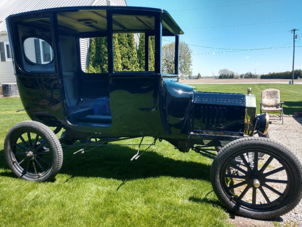

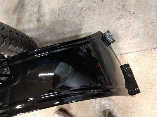

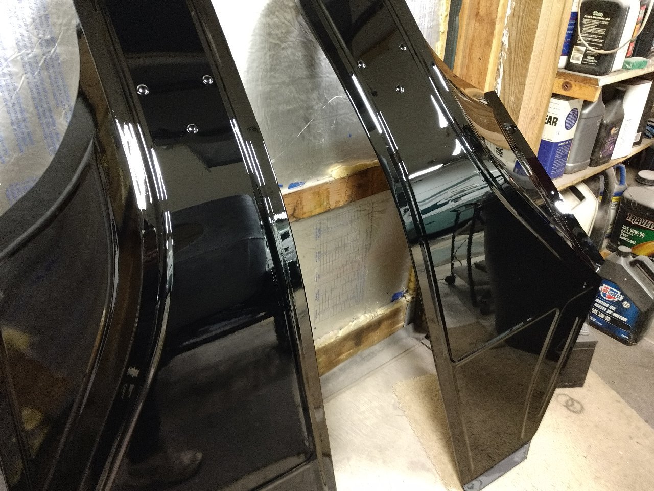

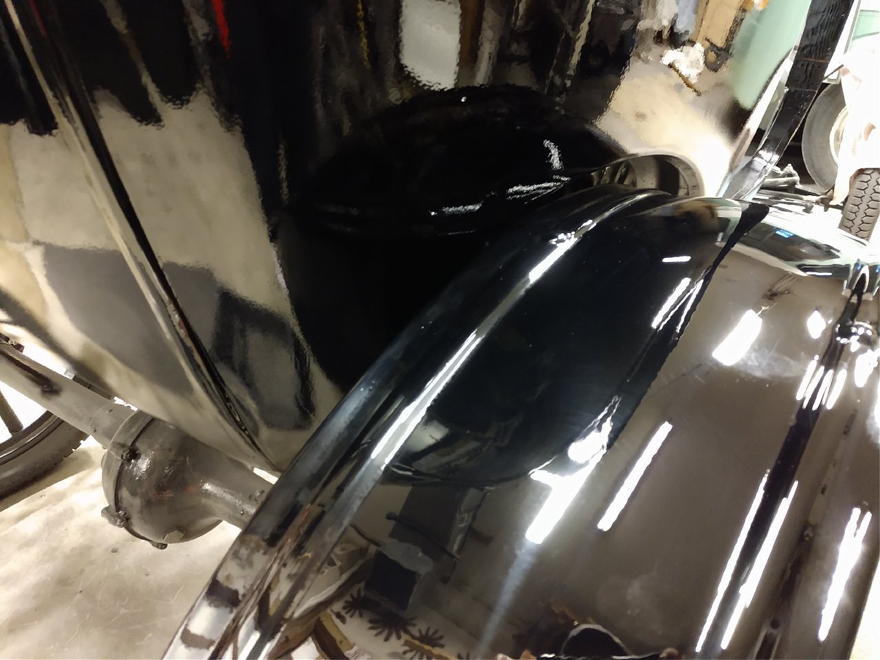

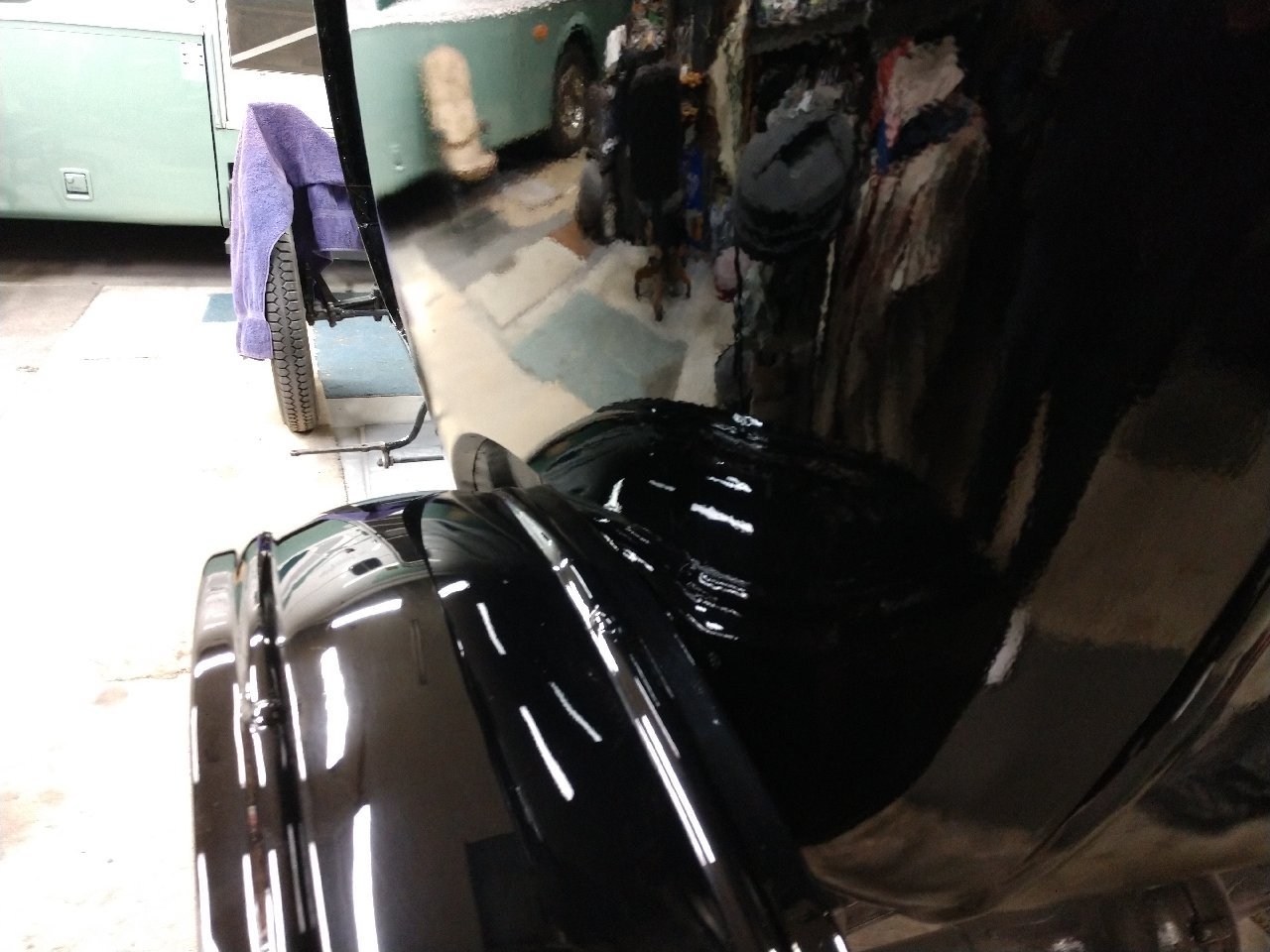

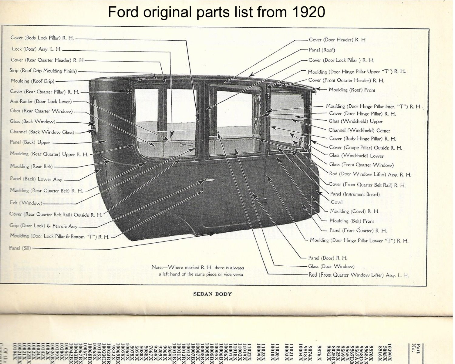

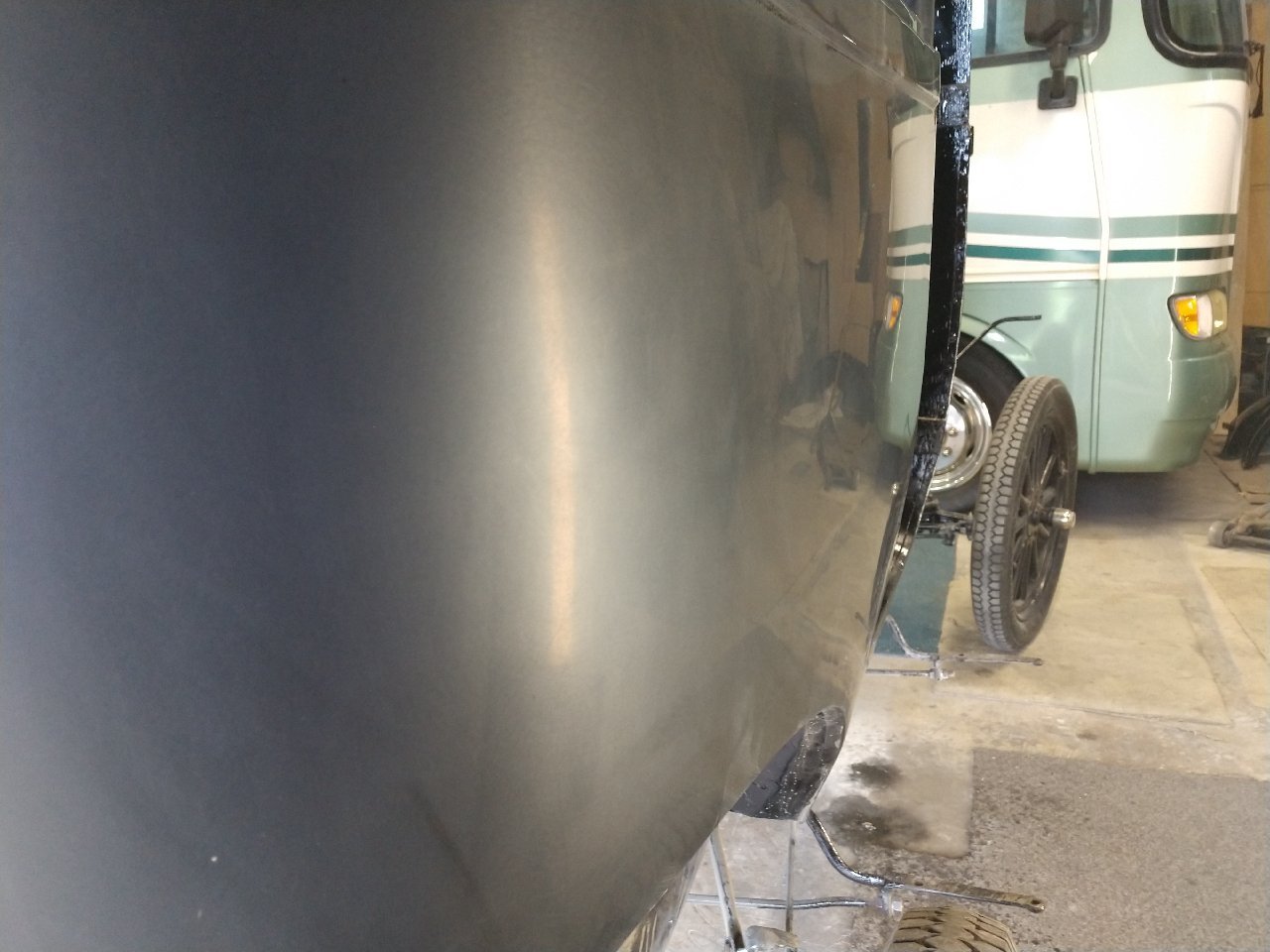

- Posts: 4411
Crowned rear fenders?
FordorGalore
- First Name: fore
- Last Name: door

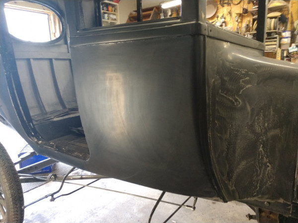

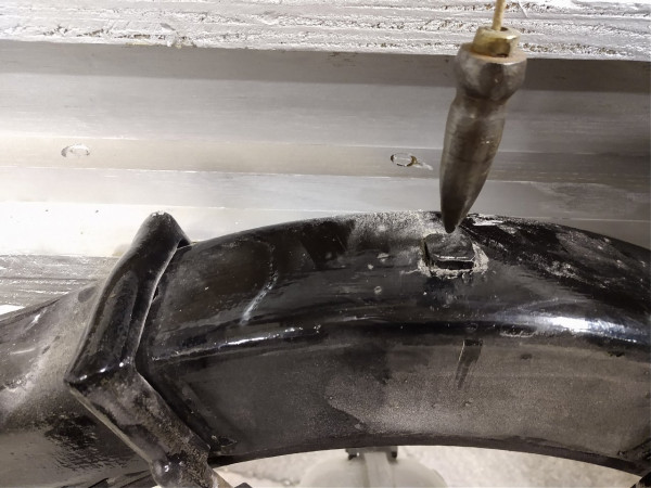

Yeah, I question those fenders also. Mike Husted didn't think they were correct for a early '16 either. The hood, radiator shell and hood shelfs all appeared to be re-pops. They had no surface pitting anywhere and the radiator was newer also. So, more research has to be done on the period before I fork over more money on a maybe. I would also have to have the flat style fenders of the '15's to see if they would properly fit the deep fender wells on this body. The fender wells are just shy of 5" deep in the front where they meet up with the aprons. Talk to me Wayne !
- Posts: 1685
- First Name: Dennis
- Last Name: Seth
- Location: Jefferson Ohio
- Posts: 2550
- Last Name: Strange
- Location: Hillsboro, MO
- Board Member Since: 2013

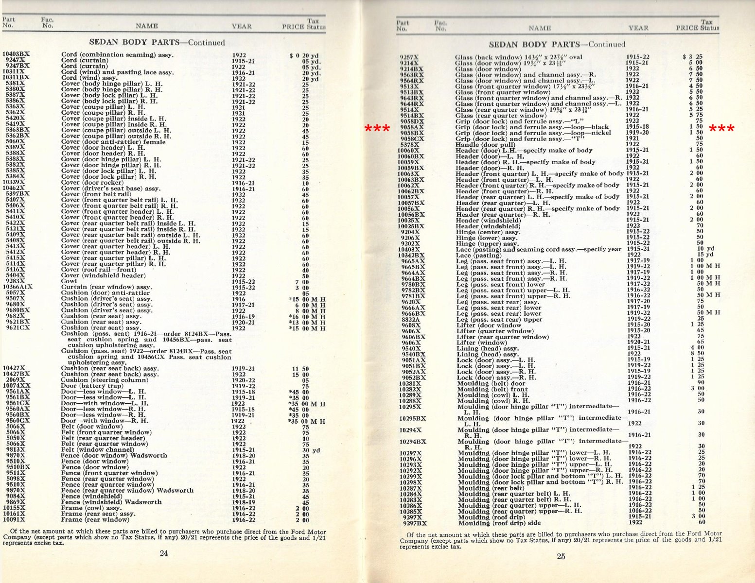

Bruce's book talks about the 1915 -1916 sedans starting on page 201. It mentions that 1915 sedans had an aluminum body and different splash shields and rear fenders from the "other models", but by 1916 it had a steel body and used the same splash shields and rear fenders as the "other models". It mentions that the rear fenders were attached directly to the body rather than using irons. The rear fenders do not appear to be crowned in the pictures in the book.
Bruce's book also has a special section on the entire run of the "Centerdoor" sedans starting on page 287.
FordorGalore
- First Name: fore
- Last Name: door
Yeah Mark, I've had some long discussions on the body and fenders and the entire car in general. The FaceBook groups I belong to have no definite answer. They do agree this car is transitional and may very well be correct OR incorrect. Until I get some solid proof that it's wrong I will go with what I got. Bruce McCalley's book is very much a gray area for this centerdoor time period. I guess he even admitted he couldn't be certain what he wrote was right. It keeps things interesting to say the least.
- Posts: 4411
I had a few discussions with Bruce personally when I was restoring mine. He admitted he didn't know for certain what the '16 model c-d sedans were like, or even IF they were originally built at all. Decent evidence that they were in fact built didn't come to light until after Bruce was gone.
In the first place. It MUST always be remembered that the "true" '15 model c-d sedans and the '16 brass model c-d sedans are two completely different animals. Although they look very similar from a distance (or in most photographs), in details, exact dimensions, materials, and trimming, they are VERY different. There IS reason to believe that a few transitional early '16 model c-d sedans had some carryover pieces. A long-time friend of mine had one that still had its factory installed gasoline tank under the rear seat! However, a previous owner had also installed a later front seat and square gasoline tank because of the fuel flow problems that rear seat tank became famous for. And his car was a Canadian built sedan, so that casts doubt about some differences from USA cars. My car had an identical rear seat structure as did his, and our two were the only c-d sedans I looked at that had that structure. Every other c-d sedan I looked at was different than ours, and I looked at about two dozen of them.
My '16 c-d sedan also had the early '15 sedan fenders on it. Unfortunately, my car had suffered a bad '50s restoration casting doubts on everything about it. There were good reasons to believe it had been the real thing, and a well known San Francisco Bay Area collector that had previously owned the car claimed the rear fenders were what the car had when he got it.
As for the rear fenders. I haven't seen a really definitive date given for when the crowned rear fenders began showing up on cars. Apparently, from past discussions on the subject, the rear crowned fenders started showing up late in 1916 model brass radiator cars. That detail rarely shows in era photographs. Usually, the picture is of some thing or some one else, and we get to hope to see such car details. Rear fenders were rarely ever the subject of era photographs. From many common angles photos are taken from, the crown does not show. Many times, one can "think" they can see the crown or not, but often it is as much illusion as it is a clear view. I have seen a few era photos that clearly did have the crowned rear fender on a brass touring car. But not many. And I have spent a fair amount of time studying multiple photographs of a single car just to study how both crowned and flat curved rear fenders look from different angles. In some of those past discussions, a few people having nice original late '16 model Ts, with good reason to believe the rear fenders were original to the car, have found the crowned rear fenders as early as late June of 1916, and several from July and August. I doubt that any T had the crowned rear fenders before late June of '16.
And as usual for me, that is my opinion from my memories of past discussions.

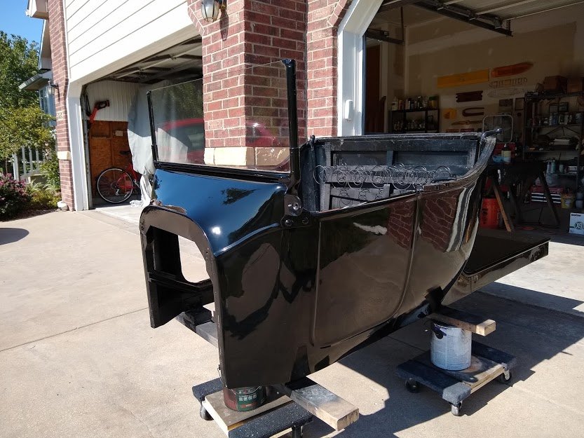

FordorGalore
- First Name: fore
- Last Name: door

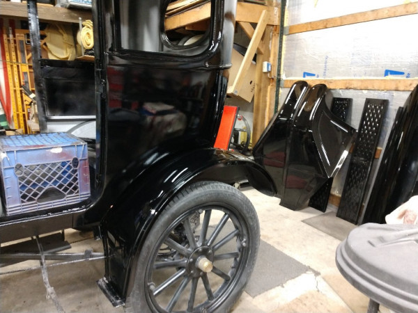

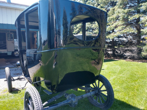

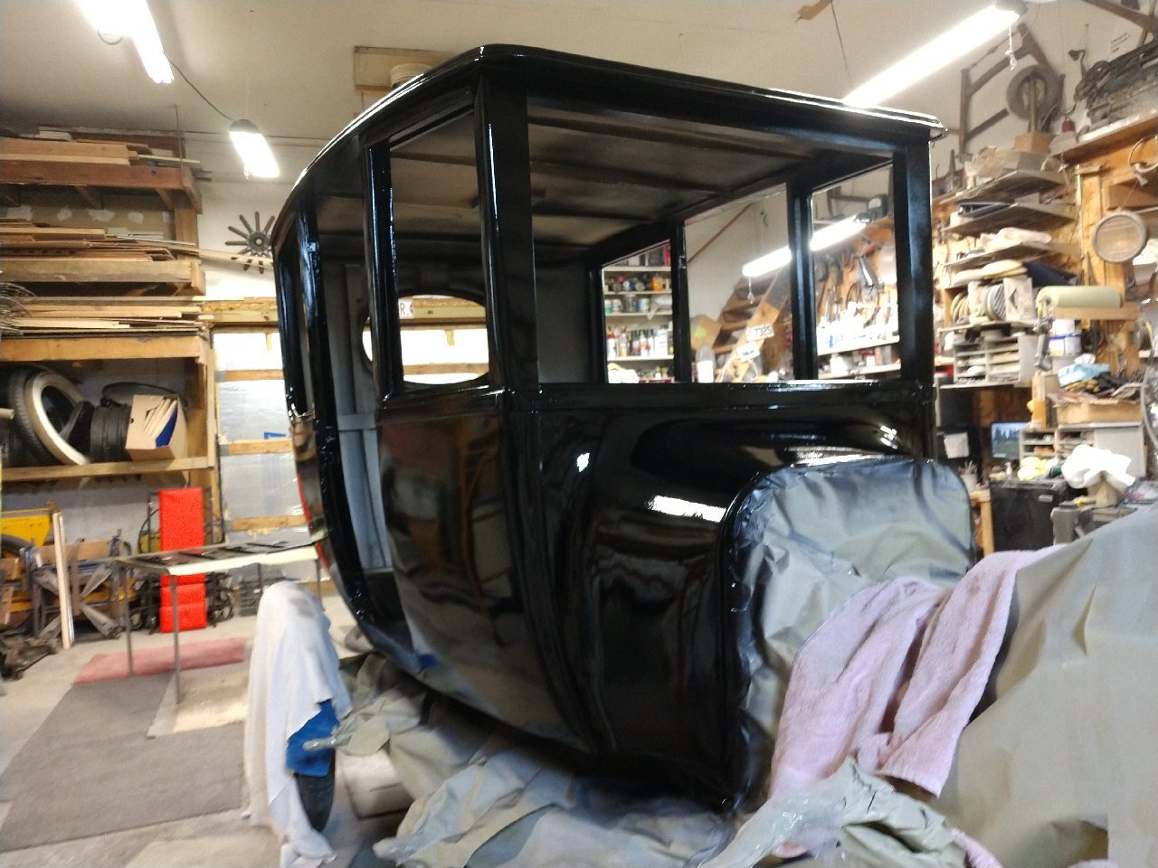

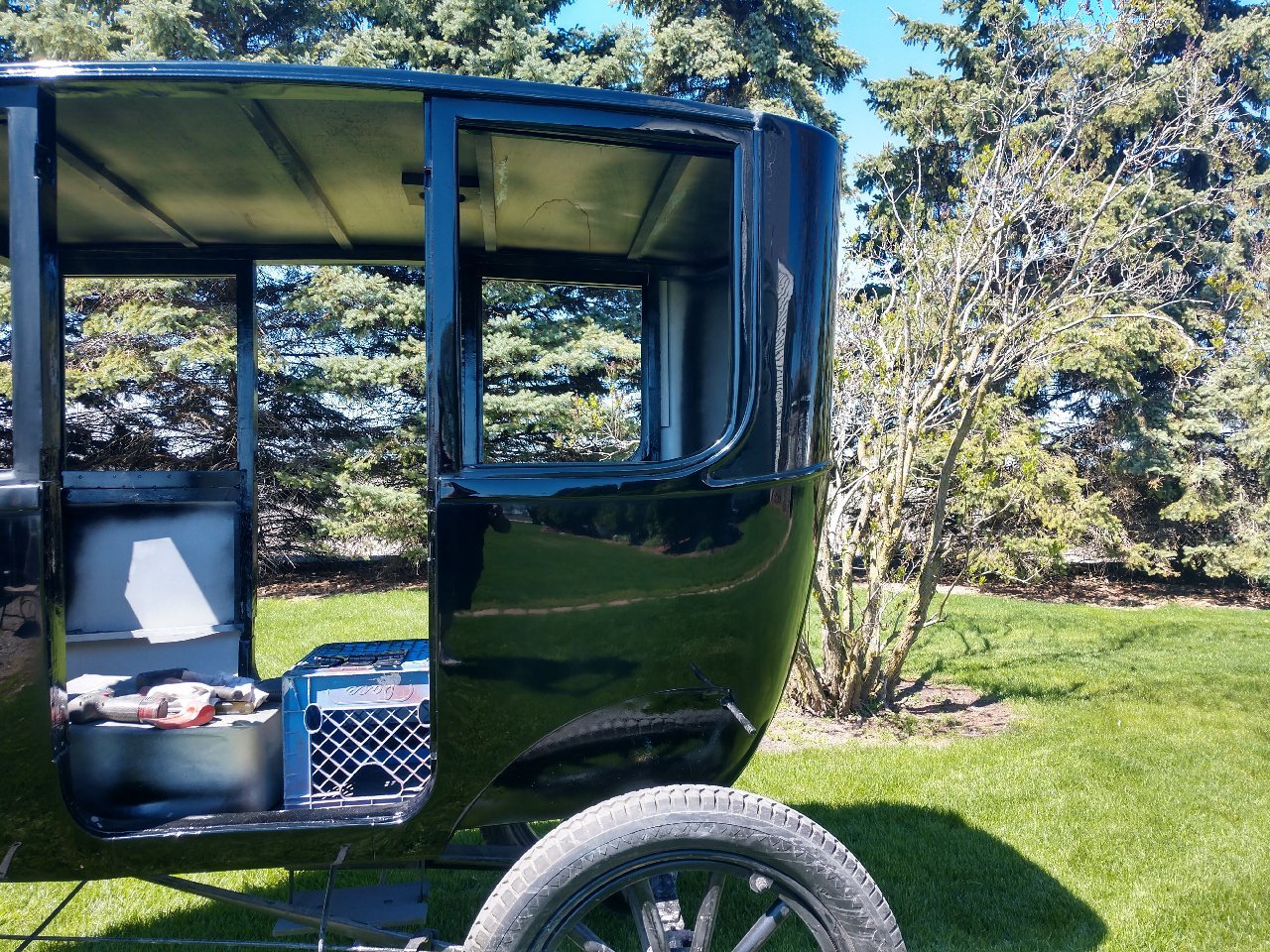

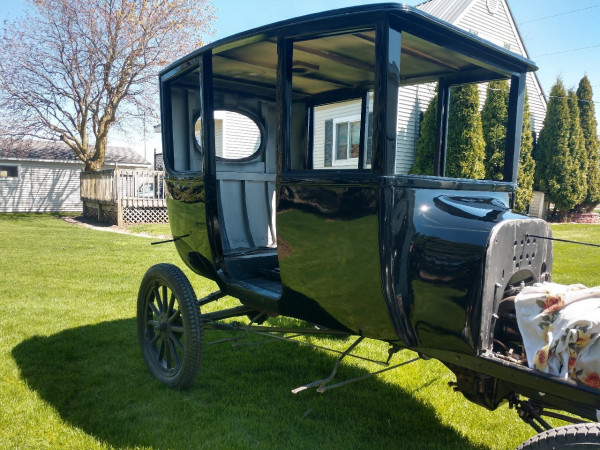

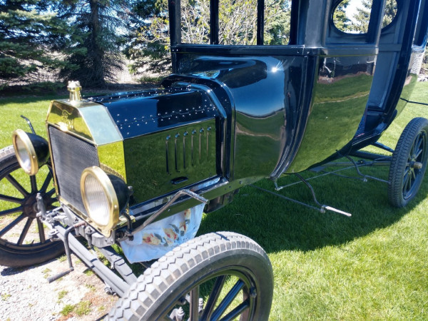

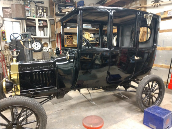

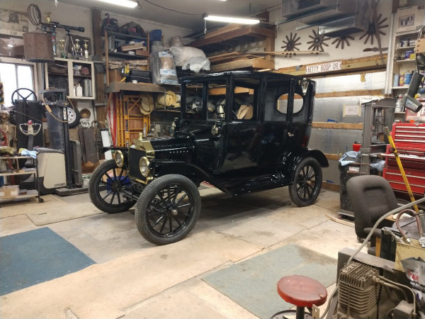

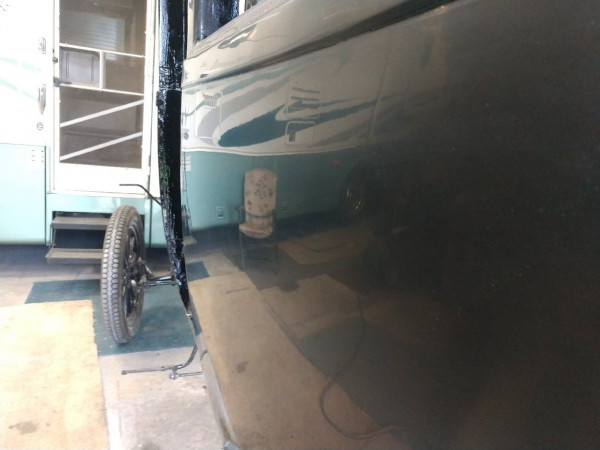

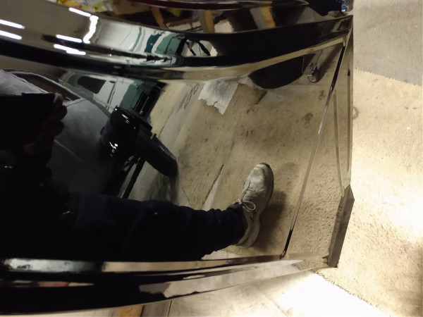

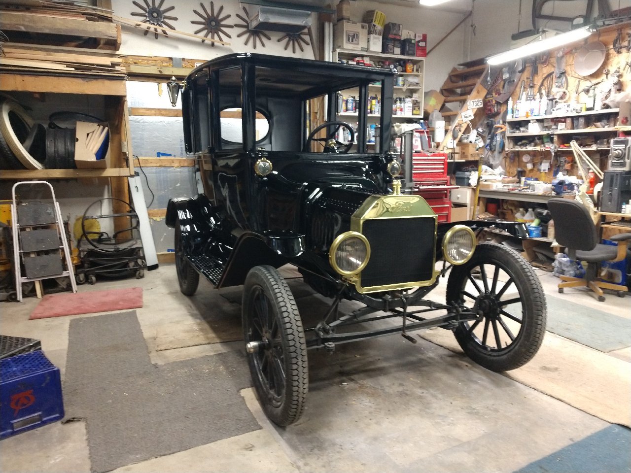

Ohhh BABY!! It laid down real nicely. The morning after results. Love that paint !
Joseph A Stearns
- Posts: 13
- Joined: Sun Jan 06, 2019 8:59 pm
- First Name: Joseph
- Last Name: Stearns
- * REQUIRED* Type and Year of Model Ts owned: 1915 Speedster, 1915 Touring, 1926 Roadster
- Location: Michigan
Wow, that is nice nice!! Is this the super paint like the red paint $$$ you used on the Sedan? Good job Buddy.
FordorGalore
- First Name: fore
- Last Name: door
Basically the same... Thanks Joe.
- Posts: 4411
You do very nice work!
FordorGalore
- First Name: fore
- Last Name: door
Thanks Wayne...I follow the 50ft rule.
FordorGalore
- First Name: fore
- Last Name: door

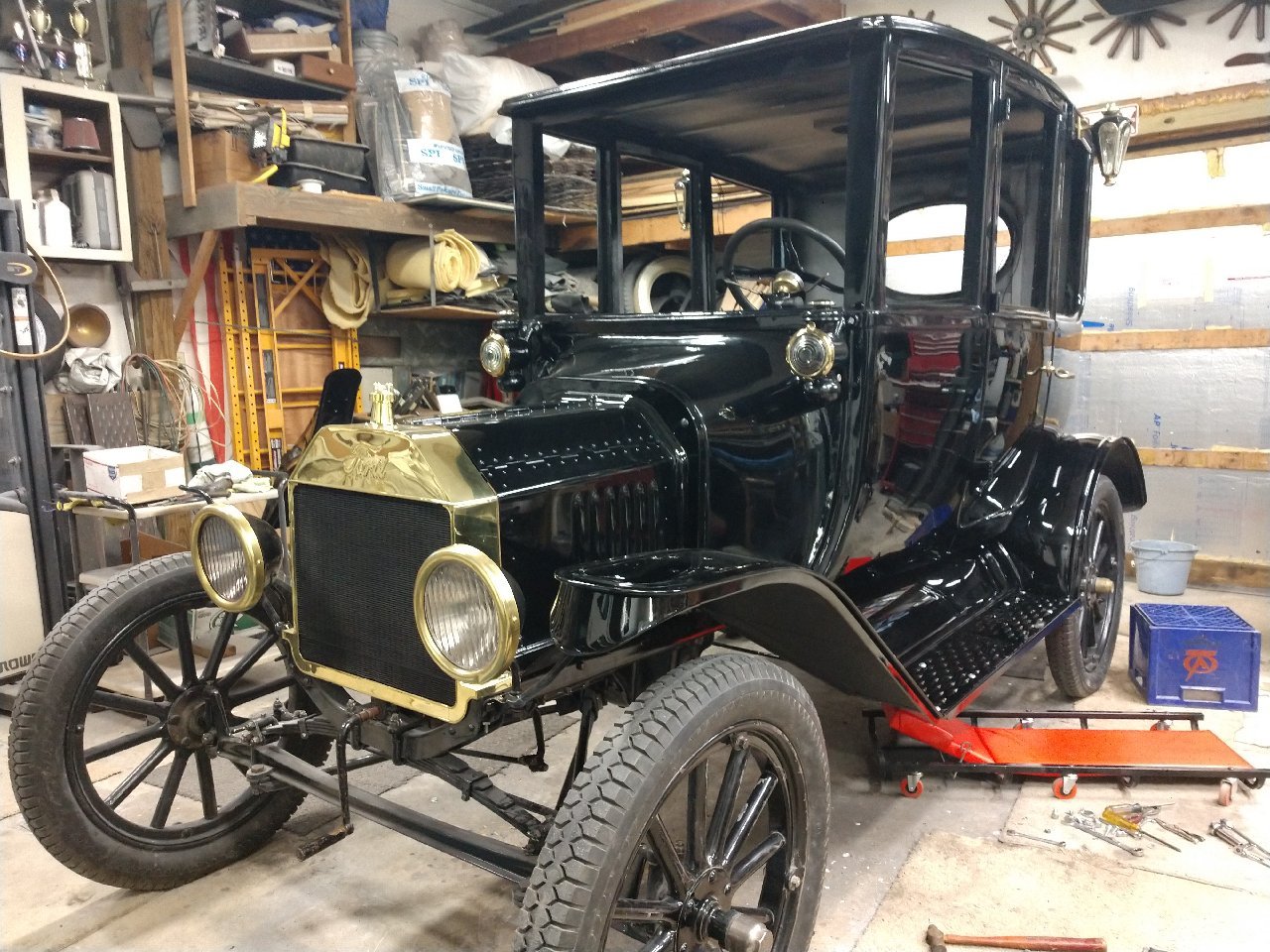

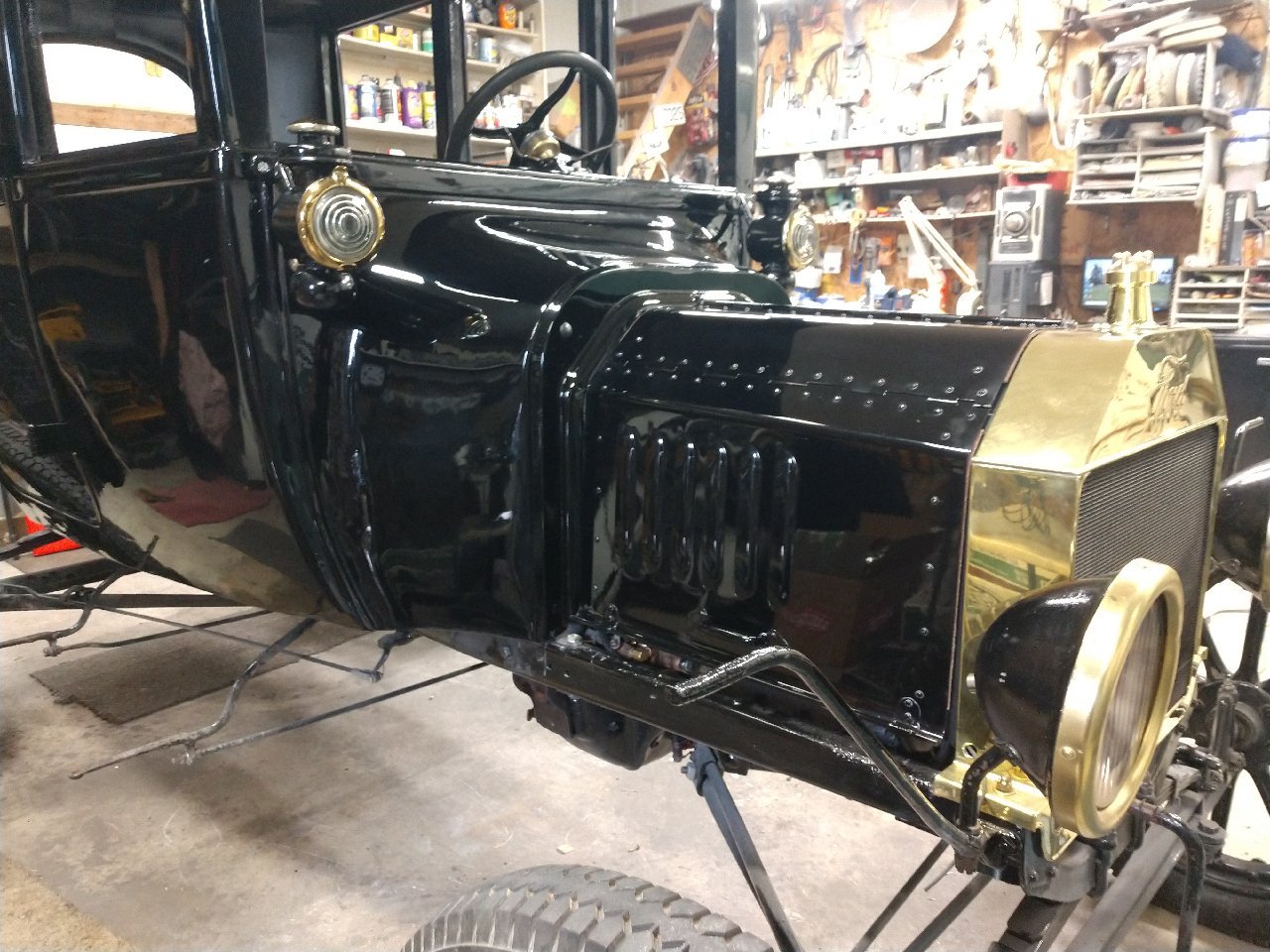

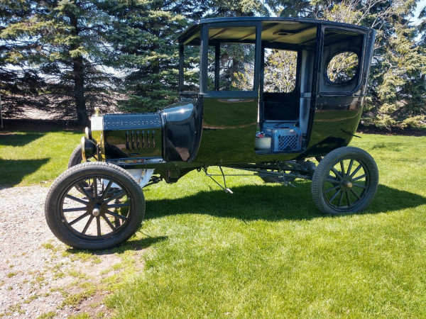

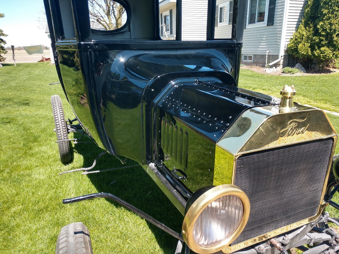

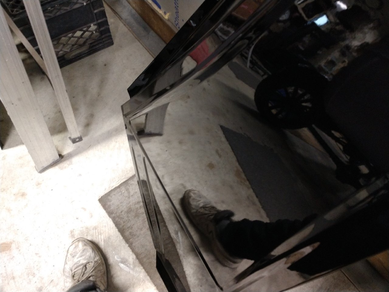

Mirror mirror on the T, the reflection looks like a fatter me....
Mikes 1912
- Posts: 125
- Joined: Sun Jan 06, 2019 6:05 pm
- First Name: Lester
- Last Name: Husted
- * REQUIRED* Type and Year of Model Ts owned: 20

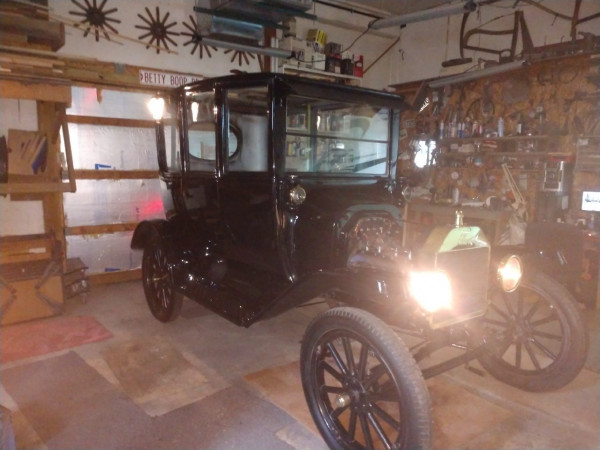

It is nice to see someone follows Henrys way of applying paint using a paint brush, garden hose and dipping. Points should be taken off if they shine to much, we cannot have that. Mike
- Posts: 1685
- Last Name: Seth
That is a BEAUTIFUL paint finish. I can't wait to see the car all together.
FordorGalore
- First Name: fore
- Last Name: door
Oh yeah thanks Mike !! I used a hair brush and tree sprayer ! LOL...
Mr Pete Kerry thank you !!
Tough crowd here on this forum...

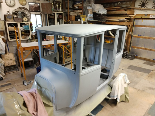

Nice Paintwork!! Thought you might enjoy seeing this photo, I would guess it has been posted here before.

I would not have thought of the hair brush as I have very little, very appropriate, the only thing missing is the hair dryer, that would count as
oven baked.
oven baked.
Excellent job and beautiful paint work to say the least! When finished, will this car be a true representation of what the factory produced in 1916 or will it be something more grand and beyond what mass production would look like?
FordorGalore
- First Name: fore
- Last Name: door

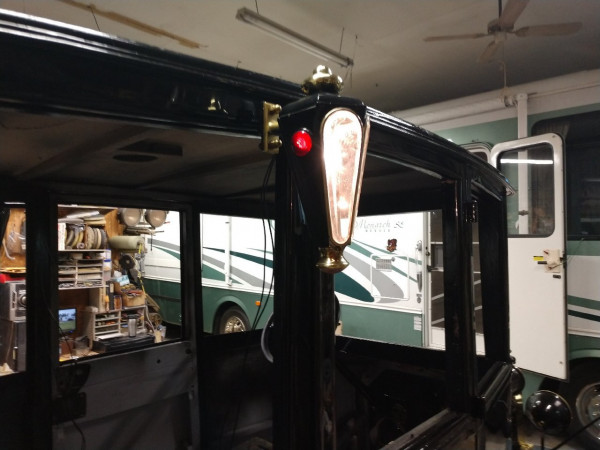

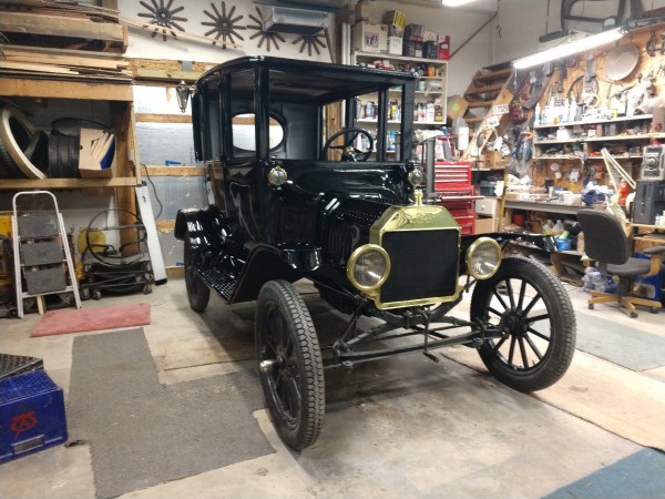

Tim it should look like the picture, except I will be adding the carriage lights. Thanks for asking...

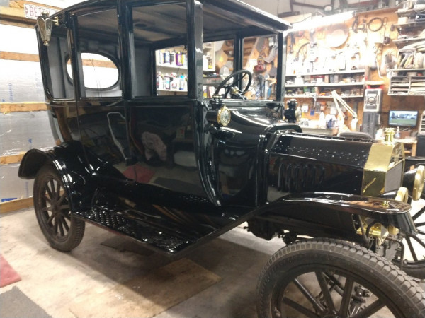

Outstanding job! Looks great
FordorGalore
- First Name: fore
- Last Name: door
Thank you Bill, this is the result of 5 hrs of spraying this morning. The paint is still wet and hasn't laid down. Fingers are crossed and prayers for the sprayer !
A Black Beauty - hope to be lucky enough see it in person one day.
Looks great Don! Good choice on the color.

Your body paint should be well hard enough for close inspection now. Are you happy with the result ? Sure looks good from here !

Dick, I should have waited another month for the temps to come up. But being the impatient, quickly bored and forge ahead dummy that I am...I painted it anyway. So, the truth is each day it looks better and its because of the cooler temperatures of everything from the paint itself to the compressor air. I am going to wait a full week before wet sanding and cut and polishing but I'm pretty happy with it. This week I will be wet sanding the fenders and smalls I had already painted. I doubt anybody wants to look at pictures of that tho. Thanks for asking !

I also should have added that Mike Husted and I talked about the effects of the borderline temperatures. The conversation lasted about an hour and although most of the conversation was garbled at Mr. Husted's end I picked up what I could. But be warned if you call Mr. Husted and you hear a continuous crinkling and I mean very loud crinkling it's actually caused by numerous Twinkies being devoured. And don't be surprised if a sudden burst of frustration comes very clearly across the phone. It's caused by the bottom cake of the Twinkie sticking to the paper wrapper. The ole Twinkie eater !!!
4 days later and each day shows improvement on the paint. I will wait 7 days before working on it...

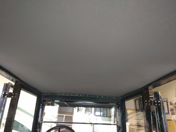

When are you going to upholster that blue seat with that pink material? If you do not have enough I can look at the Goodwill store. That is about as cheep as it gets. You can get the padding out of old mattresses they will give them to you to haul them away.

Are you talking about the plunge saw Mike? Here's what I did this morning, Steve Culp said he would cut and polish his cars until he could read the label on the overhead lights. Steve is renown for designing and building the "Culp Special" acrobatic bi-planes. He now builds and designs modern speedsters. His work is beyond words.

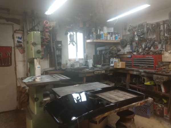

Ahhh you've needed a shave since day two of the lockdown Mr. Ketepary !! So I am cleaning up the dual socket headlight and ran across this.. FORD VICTOR. Does anyone know the story behind this? Just curious. Thanks in advance !

Day 4 of wet sanding....you have to live it to appreciate it. Uhgggg !!!
- Posts: 1685
- Last Name: Seth
I'm just sitting here eating M&M's watching you wet sand
Mikes 1912
- Posts: 125
- Last Name: Husted
Now I know why the steeps to the motor home are down. Sand once rest for an hour, sand twice rest for an hour, sand three times sleep for the rest
Almost done with cut/polish process. Taking the afternoon off and letting it get a tan.

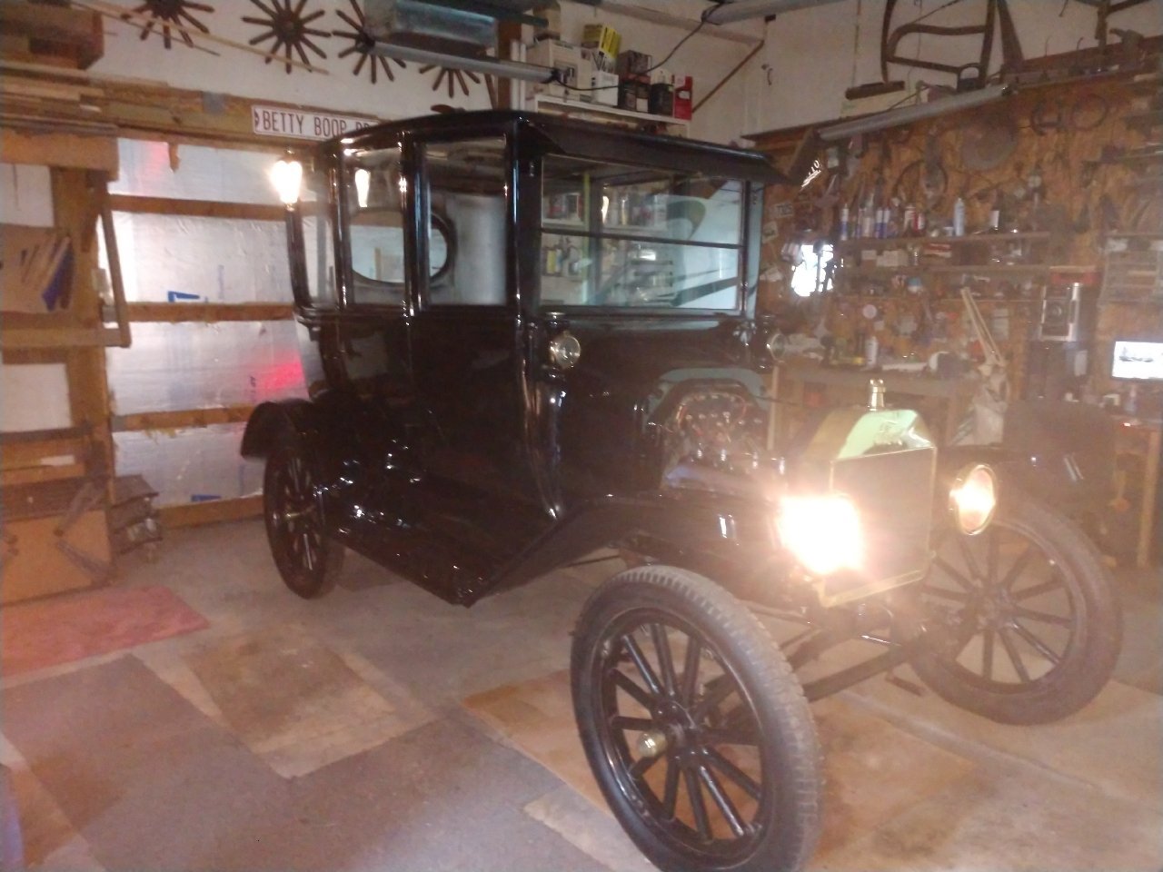

It is nice to see the table is set with a nice looking table cloth in the Engine compartment. Are you cooking Sunday dinner on the exhaust manifold?
Next you will have the good silver out.
Don,
Your paint work is gorgeous!! Take it from one who did that last year on my centerdoor!
Dave
Dave

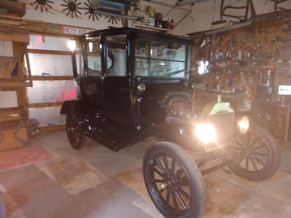

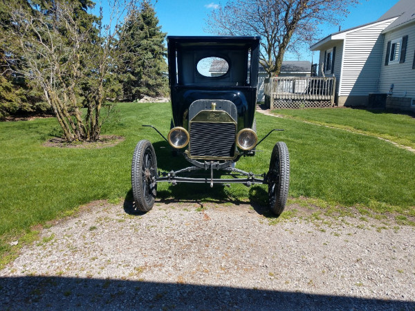

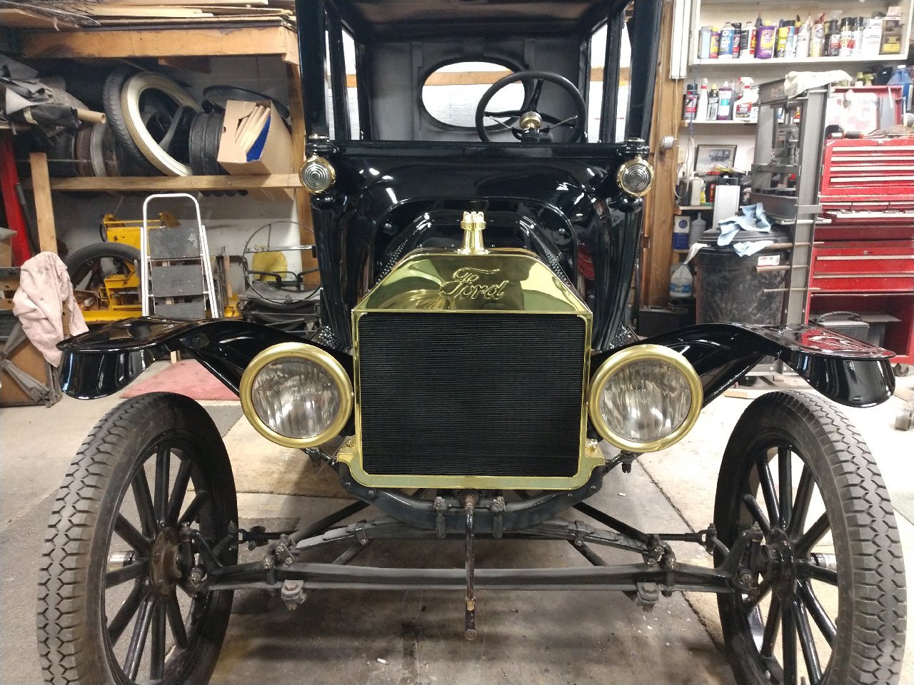

Got the wiring installed, set the timing, installed the low beams and aligned the hood for this 200th time.
- Posts: 1685
- Last Name: Seth
WOW! That is some car I'll bet you're proud of that baby.
- Posts: 2550
Beautiful!
Please post a link to a Youtube video of its first startup and run.

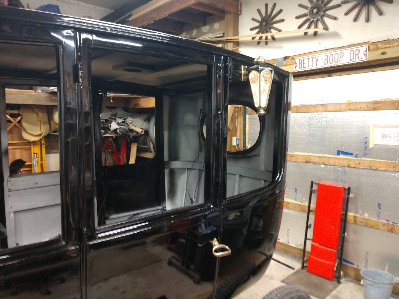

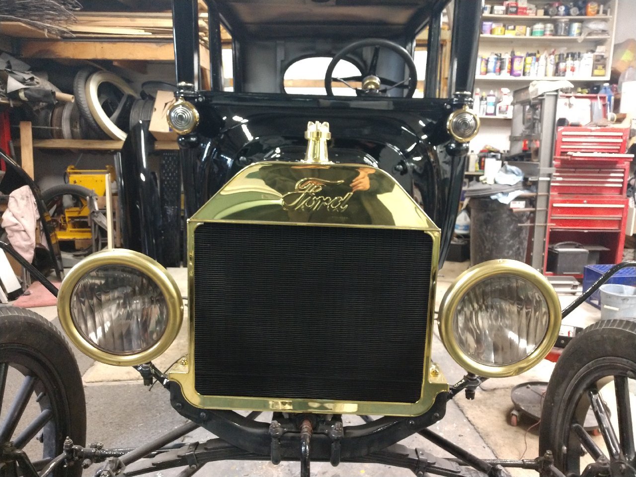

Thanks Mark, I will give him a try. So today after a century or so the carriage lights brighten the day once again. My special thanks to Jim Perry for trusting me as the caretaker of these jewels. Thank you Jim !!

As of noon today Henry's little lady is finally fully dressed !!
Russ T Fender
- Posts: 476
- First Name: Val
- Last Name: Soupios
- Location: Jupiter Florida
How did you get that done so fast? I'm three years in on a restoration and half as far along as you are! Don't you ever sleep?
Bob McDaniel
- Posts: 466
- First Name: Bob
- Last Name: McDaniel
- Location: Smithville TN.
Time to get out your milk crate and go for a ride!
- Posts: 1685
- Last Name: Seth
Those carriage lamps make the perfect pigtails on Henry's little lady. Boy everything's beautiful. You better get some pictures submitted to the club magazine. She'll make the perfect "Centerfold Girl"
Marty Bufalini
- Posts: 193
- Joined: Mon Jan 07, 2019 9:17 pm
- First Name: Marty
- Last Name: Bufalini
Don, if there is an OldCar Festival, I had better see this car there- and get a ride!

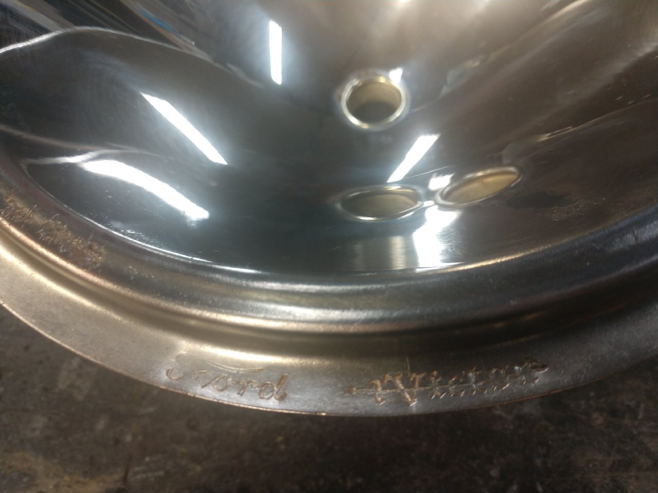

Cleaning up the bale handle and I found this marked on the shaft. It appears to be a $. Does anyone know what trademark this is?

The Ford parts list from the 1920's. Clearly shows that the grip loop handles were painted originally. The body illustration shows many differences from the 15-16's including the door handles, window latches and more. Interesting stuff !

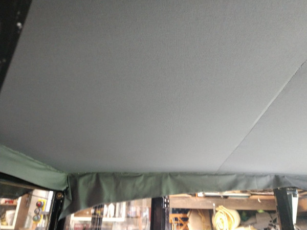

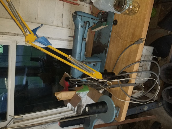

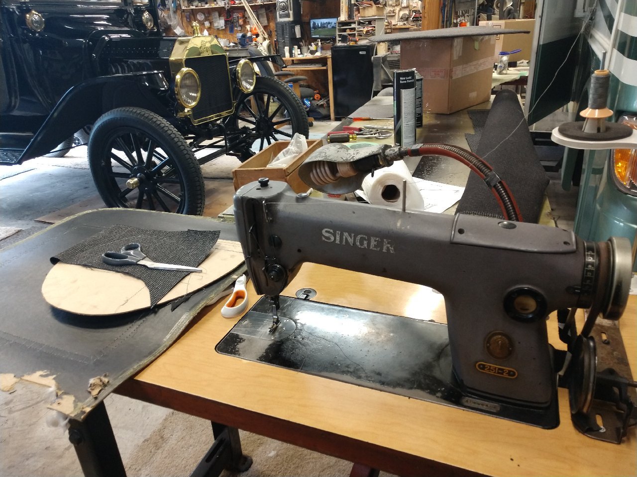

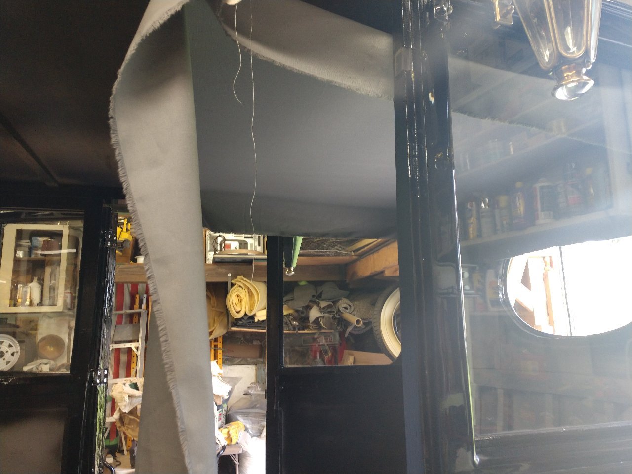

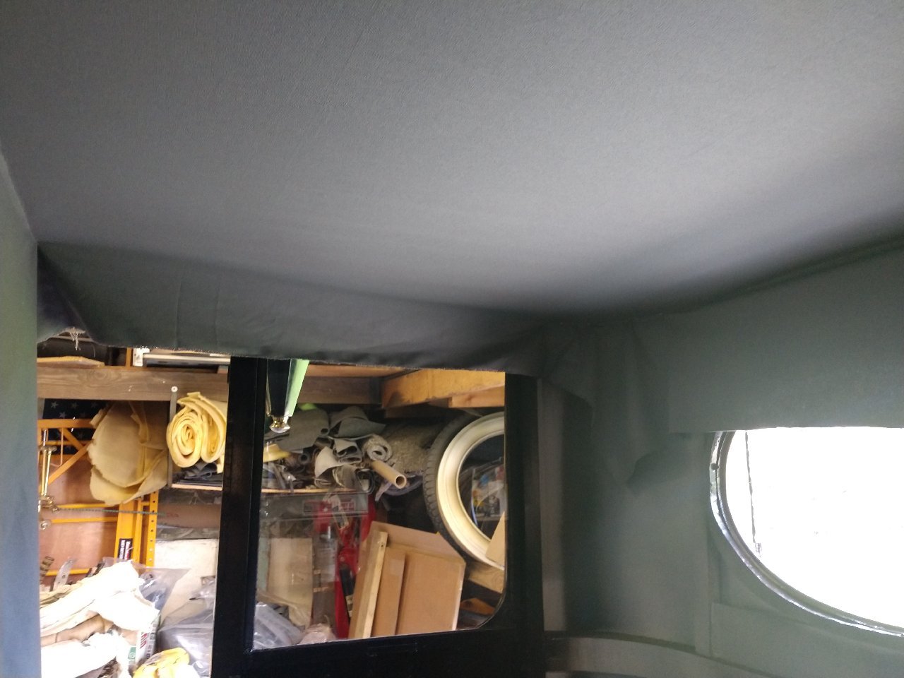

I did not know that duck tape came in green. Is that better than sewing.
FordorGalore
- First Name: fore
- Last Name: door

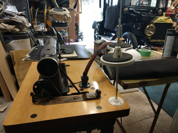

That's masking tape, it allows ole farts to sew a straight line ! (or somewhat straight line. Sorta) Picked this up today. Industrial sewing machine that handles those door panels like its a Twinkie on Mr. Husted's desk !!
- Posts: 2844
- First Name: Dallas
- Last Name: Landers
- Location: N.E. Indiana
Looks alot like mine Don. My foot feed is so fast, I cant get used to it. They will sew about anything that will fit under the foot.

If twinkies came in that color green I would be in deep trouble. What's with that thread hanging down? must be a chain thread do not pull.
Dallas, same here. It will take much practice before I take a chance on the panels. But I am excited to get to it.
MISTER HUSTED, as far as getting your clamps back....well I'm afraid you're screwed !! LOL
- Posts: 2550
I need to get a good used industrial walking foot machine. My 1946 Singer 15-91 doesn't have a walking foot and it struggles to sew through more than two layers of vinyl. They make walking foot attachements, but the ones I have seen are made of cheap plastic and don't look like they would be up to the job.
