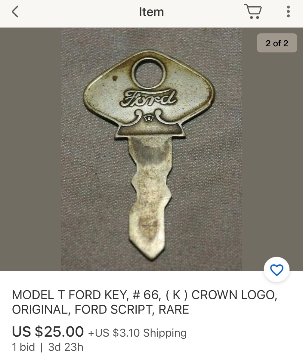

Looking at all the ignition keys for the Model T I was wondering why the ones with the Crown marking are selling for so much, I also found a few with the letter B, are they worth any more? Bob

If you don’t mind my asking, how much is “so much”?

Guess that eBay link answered that question.
All I can say is, I’d be running like a thief in the night - but am in a different boat.
WOW.

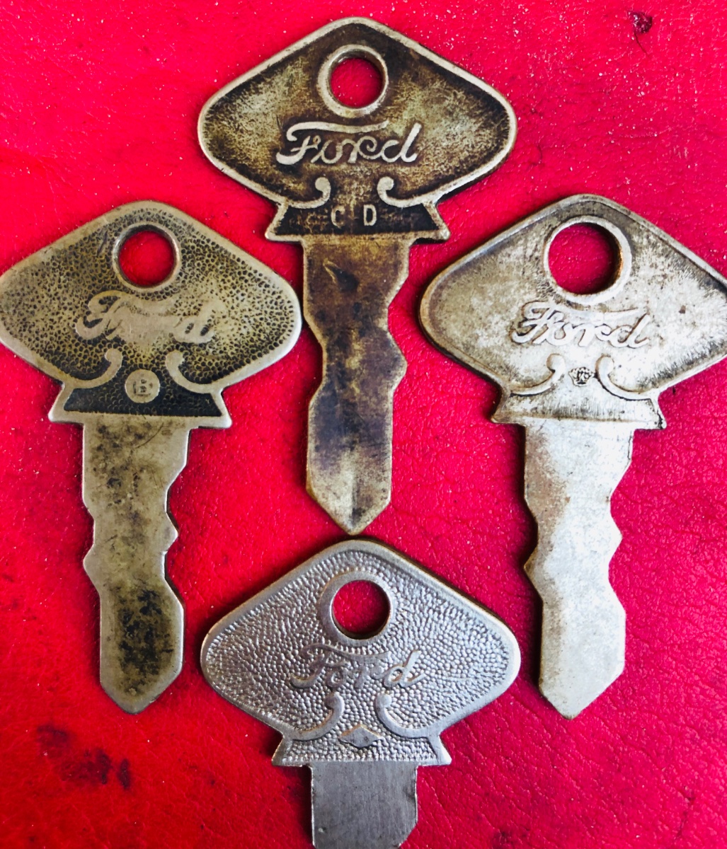

Grouped a few keys. On right is King brand with crown, click image and zoom to see the K inside the crown and others B for Briggs and C-D Capkey-Dupree and more common Diamond mark.
[attachment=1]
Here are two cute ones, owner initialed his well worn Ford key :shock: and odd aftermarket key, marked around the hole ‘Francis Keil and Son New York
