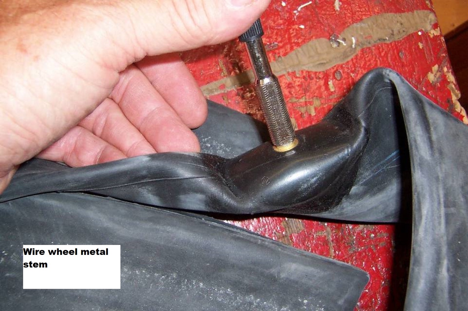

Thanks, Stephen, but I wasn't so worried about the Schroeder number as I was the actual stem length. I have two brand new Universal Tire Co. nickle plated metal stem tubes that have 2" stems. I was just wondering if they were correct.

The 2" stem tubes you have are ok for Ford welded wire wheel, or for disc wheels for that matter. The shorter stem supplied on reproduction tubes and stems needed as there is no thick felloe. A longer metal stem is supplied on clincher reproduction tubes of today.
Just use the reproduction rim nut and the dust cap will thread onto it.

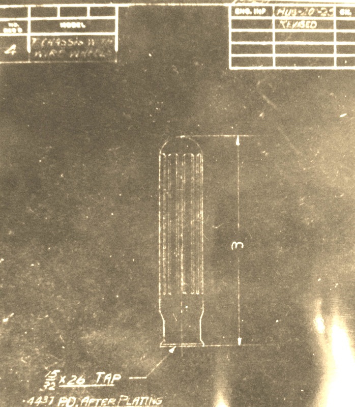

Longer 3" dust cap used for only wire wheel T's, because the stem stood taller in the thin wire wheel rim:
