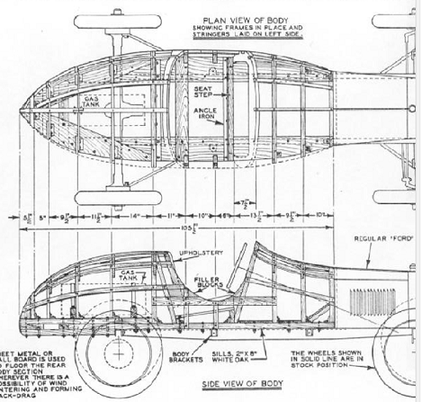

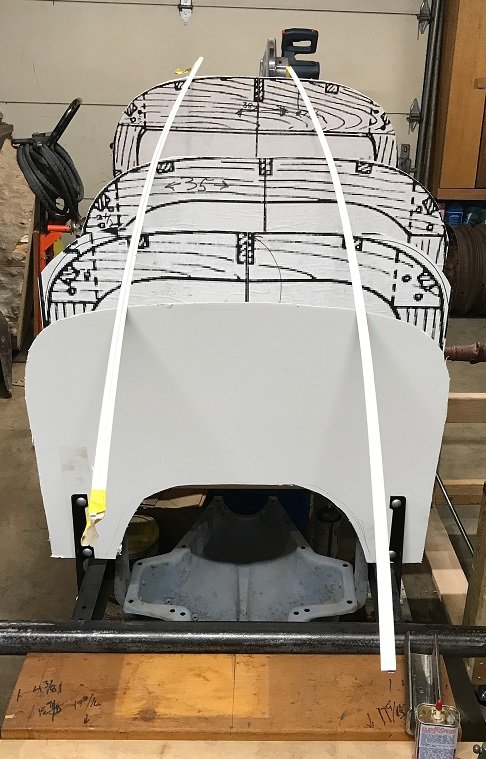

That is my intent. More for fun than go. Engine will not be stock externally - making it look more "speedy" - but using period correct items. Using a plan I found on the internet as a guide. Got a ways to go

Hank, Point well taken. Lets face it people were much smaller in stature back then and "we" need a bit more elbow room. So I'm intending to have off-set seats, passenger slightly behind drive as in a PACO. I have purchased seats, retro Mini-Cooper, because of my target body width (it also has guide rails to slide forward or backward a bit and extra thigh support). I made a mock-up using foam board using the blueprint of the plans I found on the internet (previous photos). The next step is to determine the drivers seat position (combination for steering wheel, pedal reach and seat tilt). Then the passenger position to fit within desired car body contours. The to redo all the foam board shapes and positions before cutting wood. and then.......

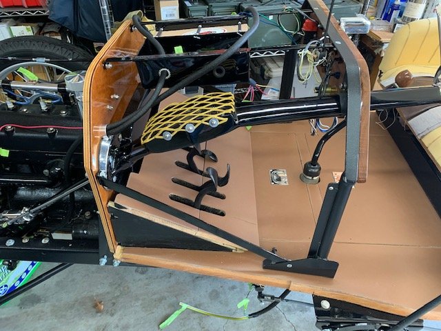

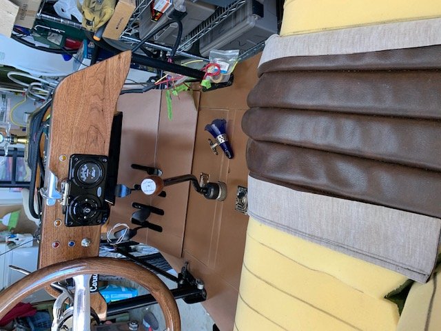

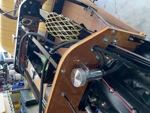

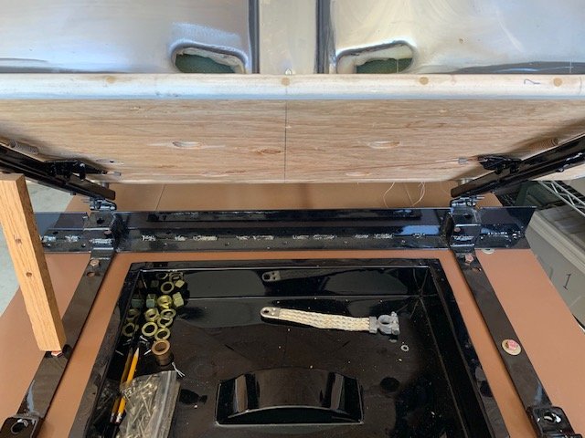

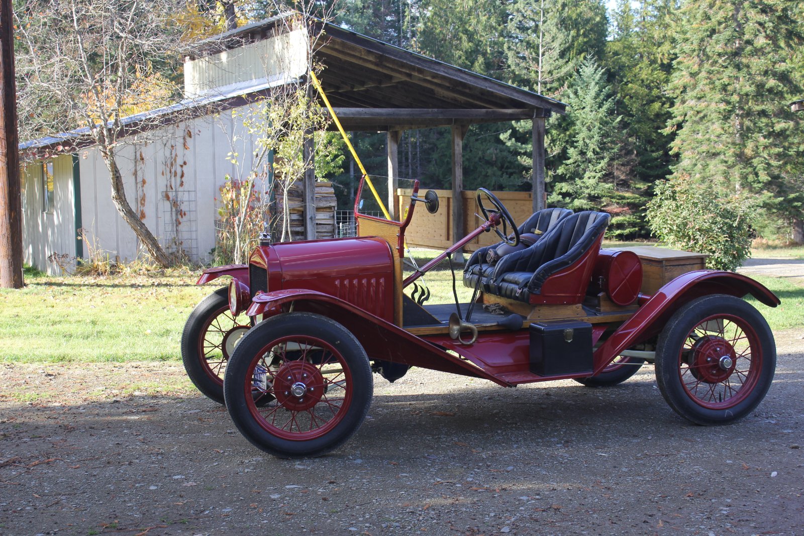

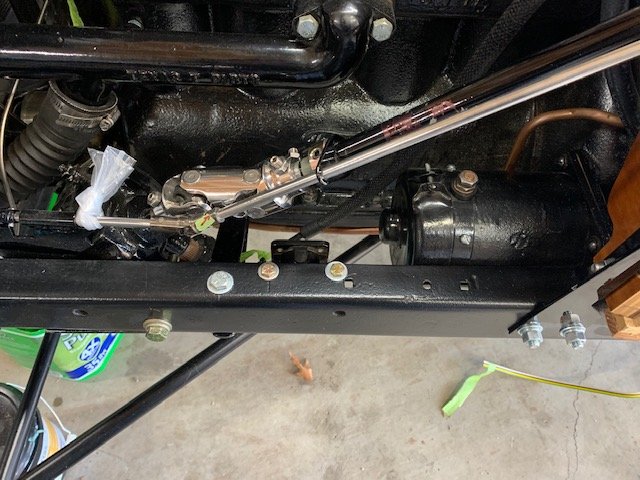

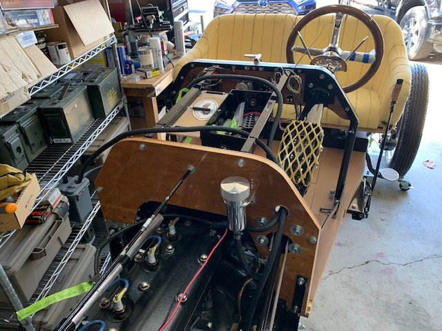

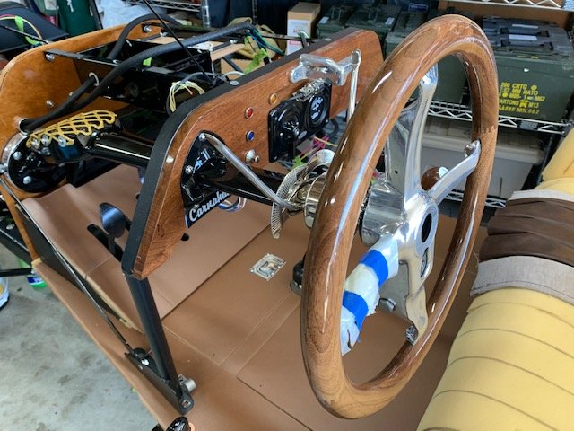

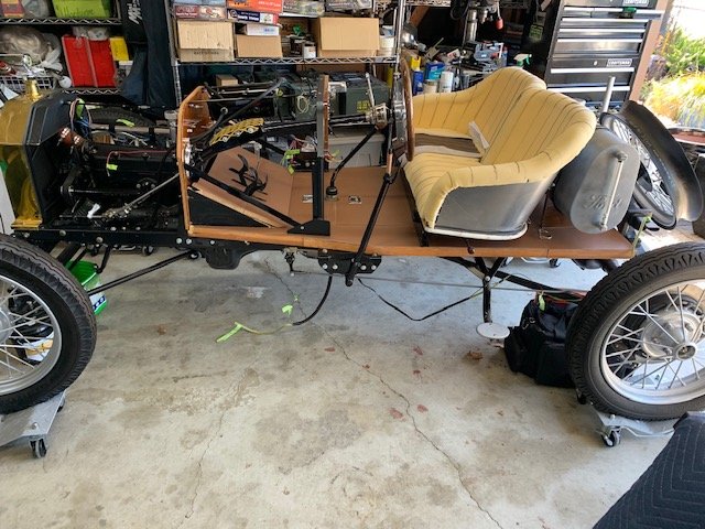

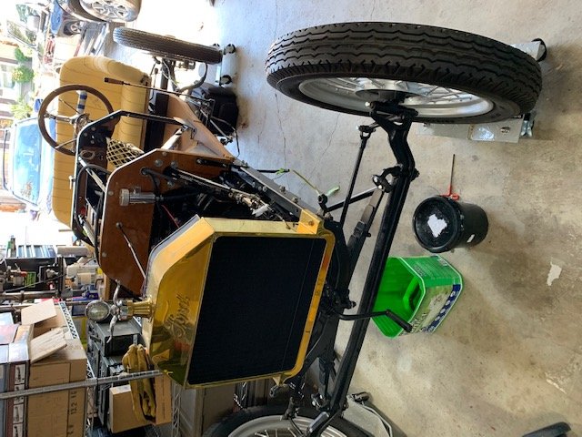

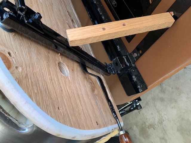

In line with Hank and Frank's comments on ergonomics, I'm building a modified Currier speedster....I am 6'2" - 275lbs and MaryAnn is a slender 5'11", so as you can see, there is a fit issue. The Currier Speedster has a very long hood and that requires lowering the steering column significantly, otherwise the steering wheel will be over your head. Things became even more complicated with the addition of a Vega steering box. At this point I threw up my hands and appealed to Hank Lee for ideas.....he had a solution within minutes. Please see the attached photos. Hank also brought up the idea of ergonomics and suggested tilting the seat back and installing tracks for adjusting the seat position. These tracks came out of a Ford F-150 and were modified the fit the width on my seat. The seat is hinged at the front to allow access to a custom tool box. The last order of business was the modification of a Spencer Fat Man steering wheel as once it was installed the bottom of the rim touched the seat cushion. Hank cut down the spider and had a 14" rim built to replace the 17" rim....et viola! I fit. Also, note the carriage steps...these were attached to a modified running board bracket and use the same frame holes for mounting.
Give me a shout if you have any questions, suggestions or need clarifications.
Apparently I can only attach 5 pictures to a message.....will make a 2nd posting with more photos.

Further photos:

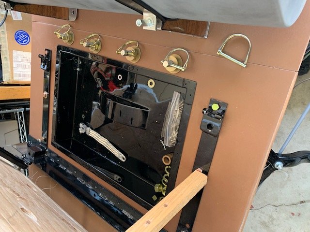

....and a few more

...and apologies for the sideways pictures.
-dc
