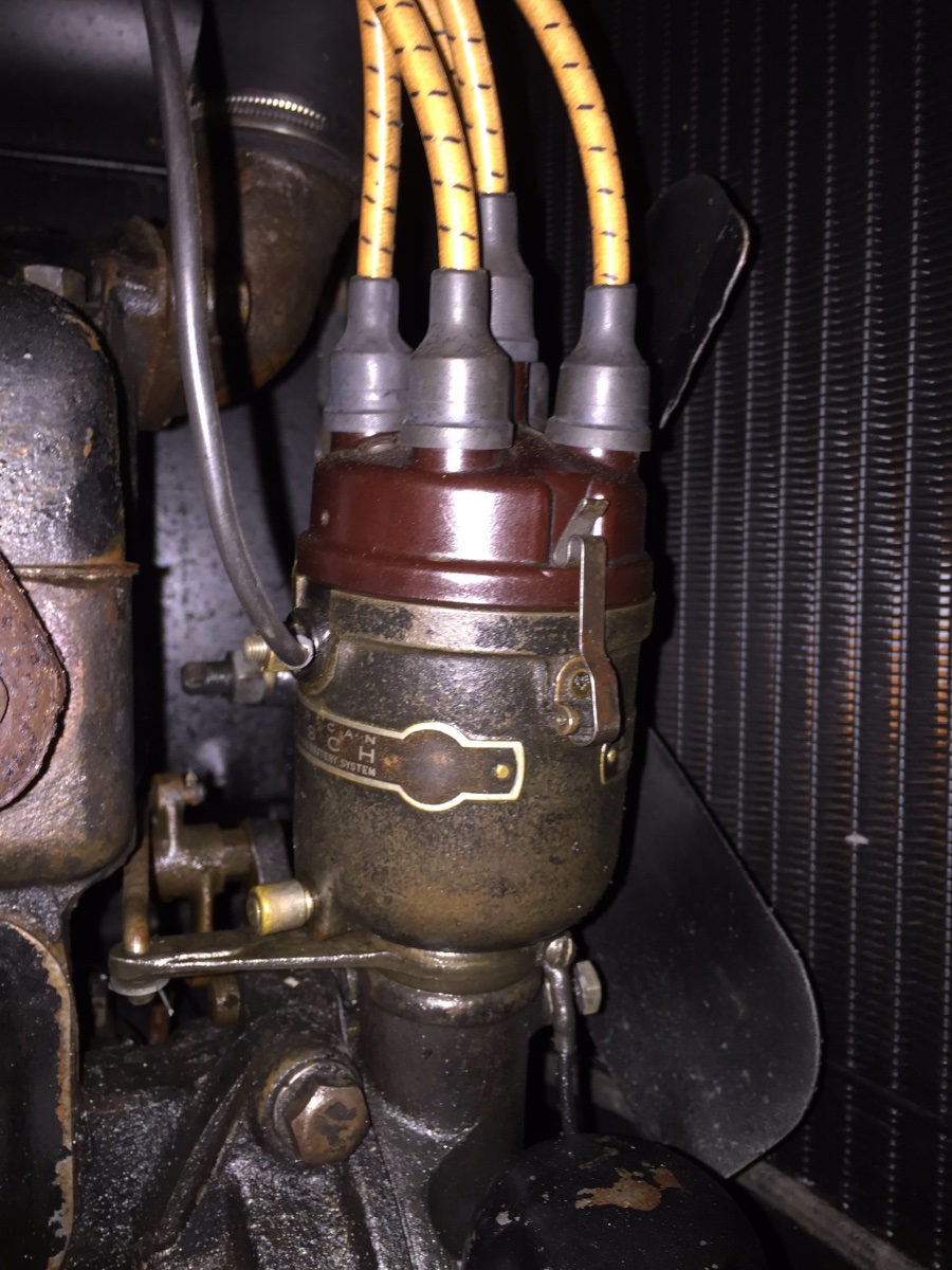

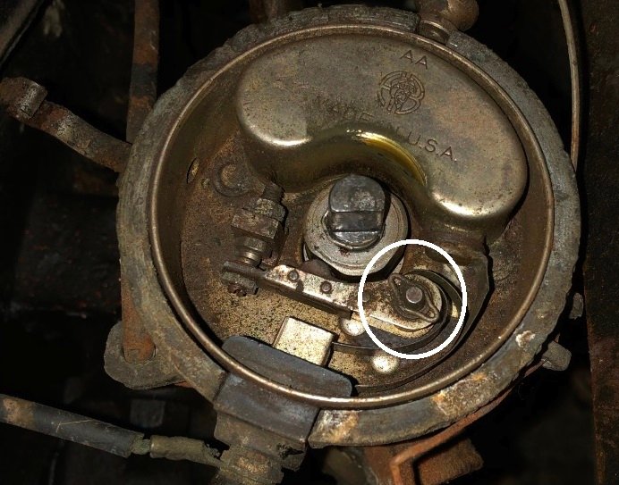

Just brought home another one. Same story. Someone passed and need to clean out garage, but this one has a distributor. Haven’t tried to do anything with it. What Model is this thing? Are there parts available? Thanks Mike

It is an American Bosch, hence the "AB". The race driver face wearing goggles was their logo for a few decades. I don't know what model, there were a bunch of them. Some had automatic advance, many did not. Most clamped in front of the standard timing gear cover. The best ones came built into a special timing gear cover. I cannot tell from your picture what you have.
They made and sold a lot of them (wouldn't surprise me if they made a million of them?). Used parts are somewhat available, however most surviving units are pretty well worn out. One of the reasons so many used parts are available. NOS replacement parts can often be gotten from people that have collected them for years. A few parts, including the drive gear, are made new still (I think still?).
Very good units if in good condition.
Of course, some of us still prefer a proper T timer and four coil setup.

I have a spark plug with that guy on it! :D Can you show how the Distributar is fitted to the block?

From what I can see from the pictures It looks like a Model 600.

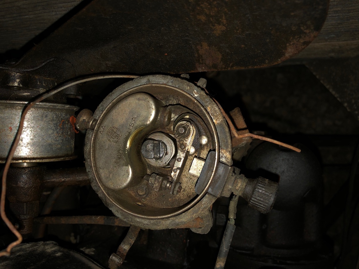

Some prior owner removed the mag pickup and replaced with an oil line. I would prefer coils, but likley need to stick with this for now. I’ll will see if I can get spark, if not I may need to find parts. It is All part of the T learning experience. Much like the experience of telling the wife I have brought yet another one home. :D

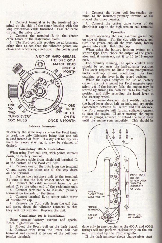

It is an American Bosch 600 distributor. At the onset of WWI the US Government took over Bosch operations in the US- which then became American Bosch. Since then it has no relationship, or parts, to the current Robert Bosch products. This is a popular model has centrifugal advance. If the kidney shaped condenser inside the housing is no longer functional a compatible condenser is often used and mounted externally. These instructions explain how it can be hooked up to buzz coils or conventional single coil. Need to add a second post for last page +

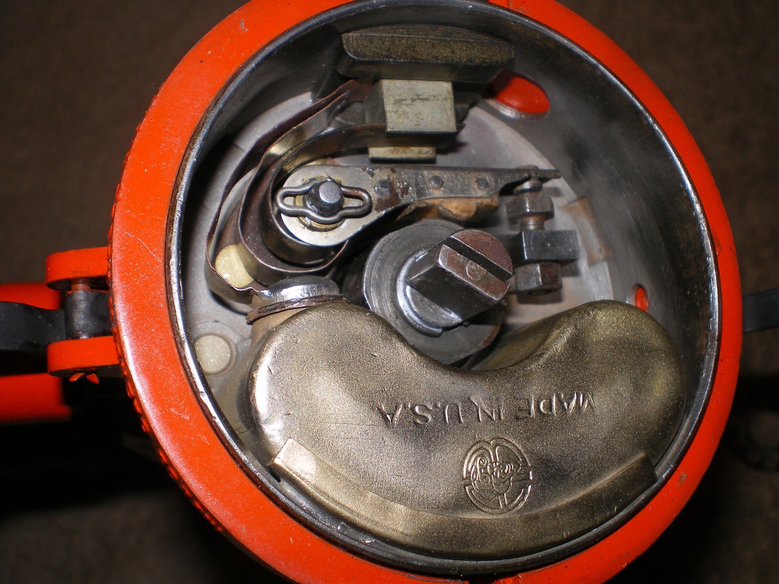

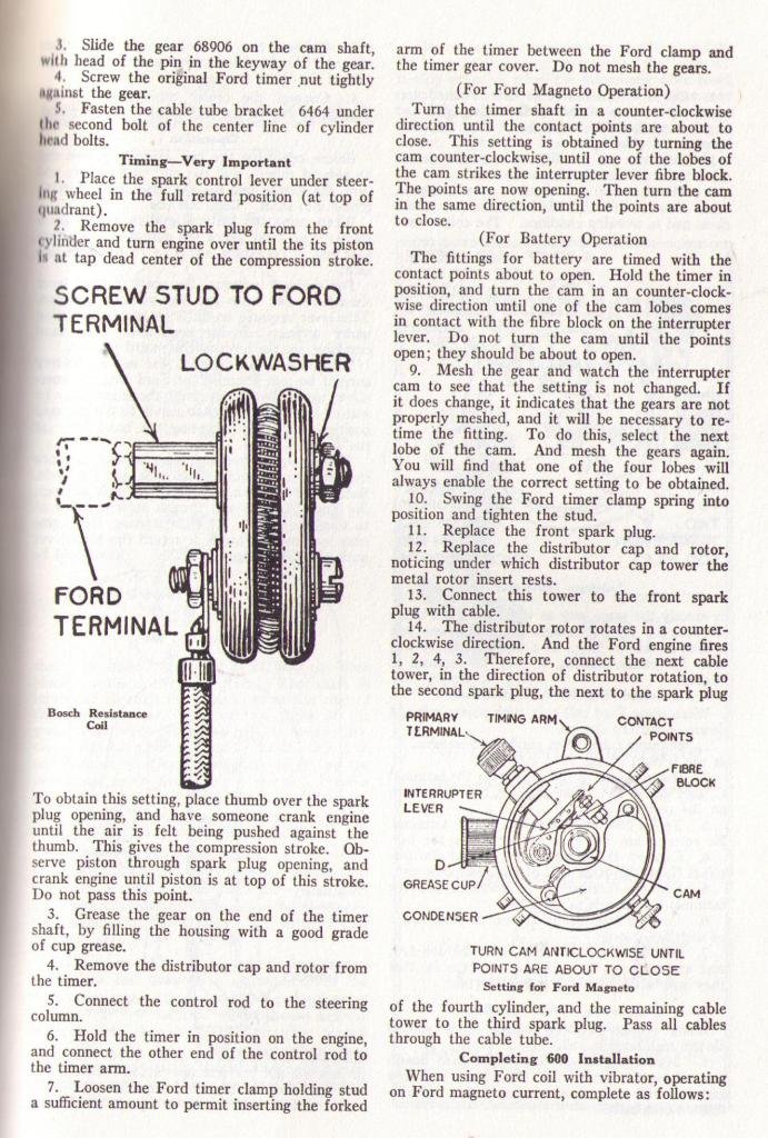

More American Bosch 600 Orange color was what the original head was painted That photo is for a different Model AB

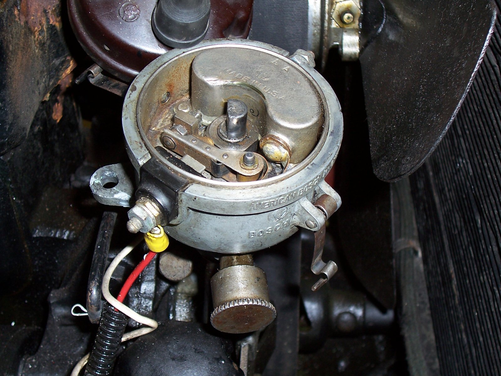

Works good. You can sometimes find parts on Ebay. The ground wire is good advice.Got one on my TT.

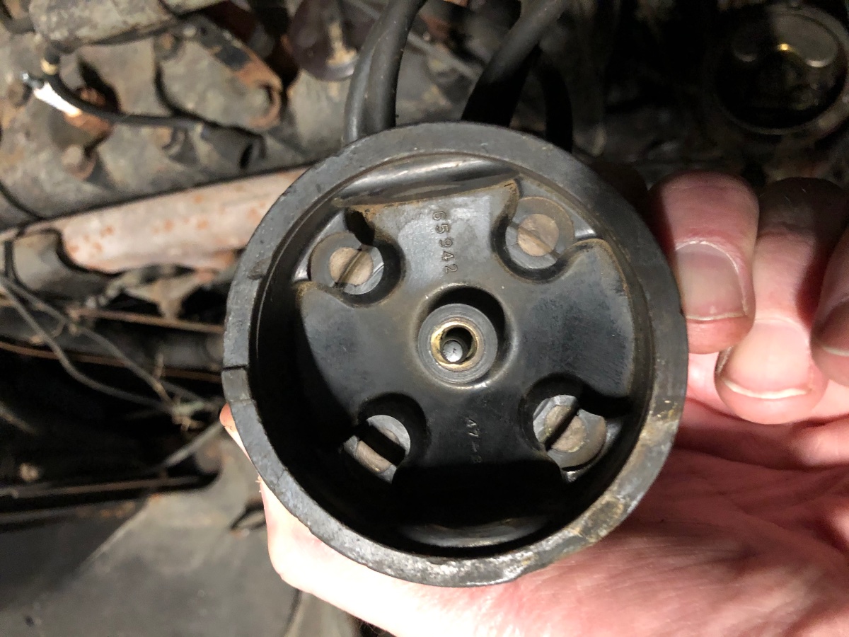

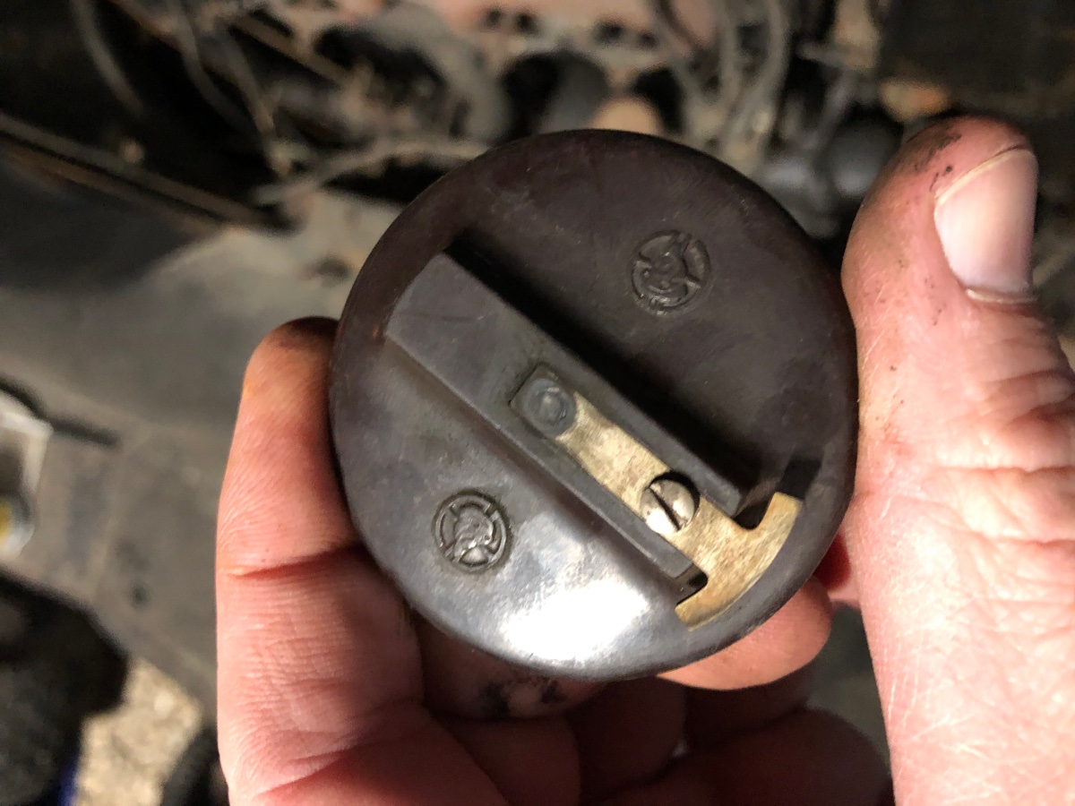

I am not able to get enough gap with adjustment. I’m sure the wiper is worn. My plan is to file enough to get enough gap. What is the proper gap 15-18? My goal is to use this to start the car to see how well it runs and check mag output as I would like to go back to coils.
Posts: 6607
Re: Distributor??
Post by TRDxB2 » Fri Feb 28, 2020 10:27 pm
Don't file the wiper. If you can't make a gap then the wiper is worn down or you don't have the cam and wiper in the highest position. And don't forget to put the clip back on.

This is for T type A B distributors:
4 & 6 cylinder distributor .020".
8 cylinder .014-.016".
I say do it. File the points to get some gap. :)

Post by Modeltmike » Sat Feb 29, 2020 5:55 pm
I did file a little and got enough gap. Started and ran! The head of the distributor has some wear. It could be moved and the gap would widen. I checked mag output. I will likely remove the Bosch and go back to coils. Thanks for the advise!
