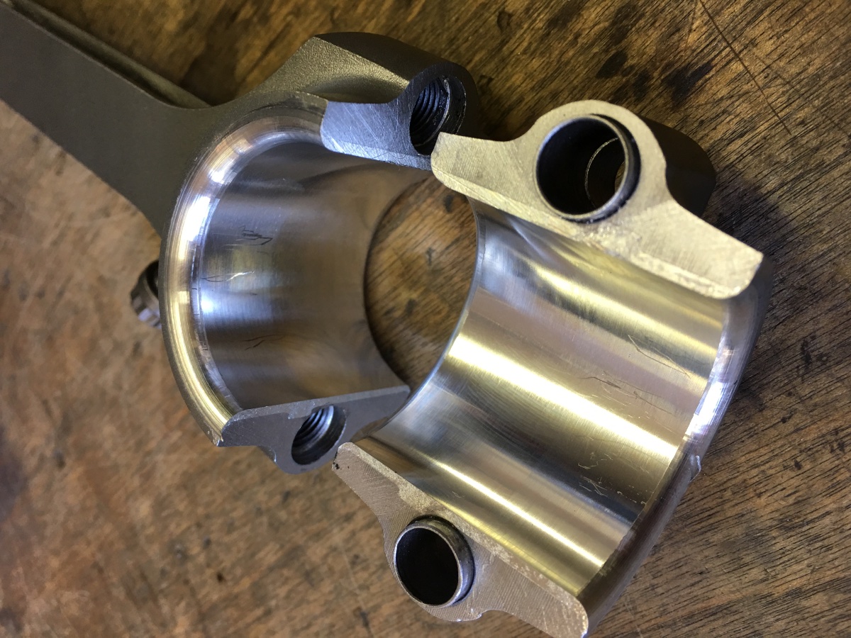

You can babbitt them too. I babbitted these for a customer last year. They are now in a OHC Fronty.
