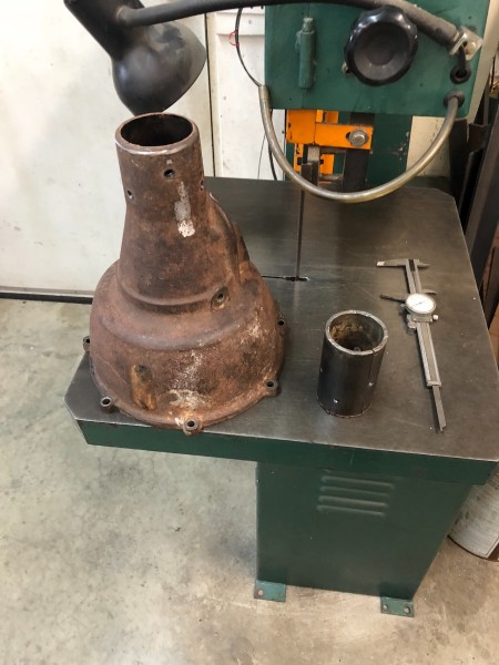

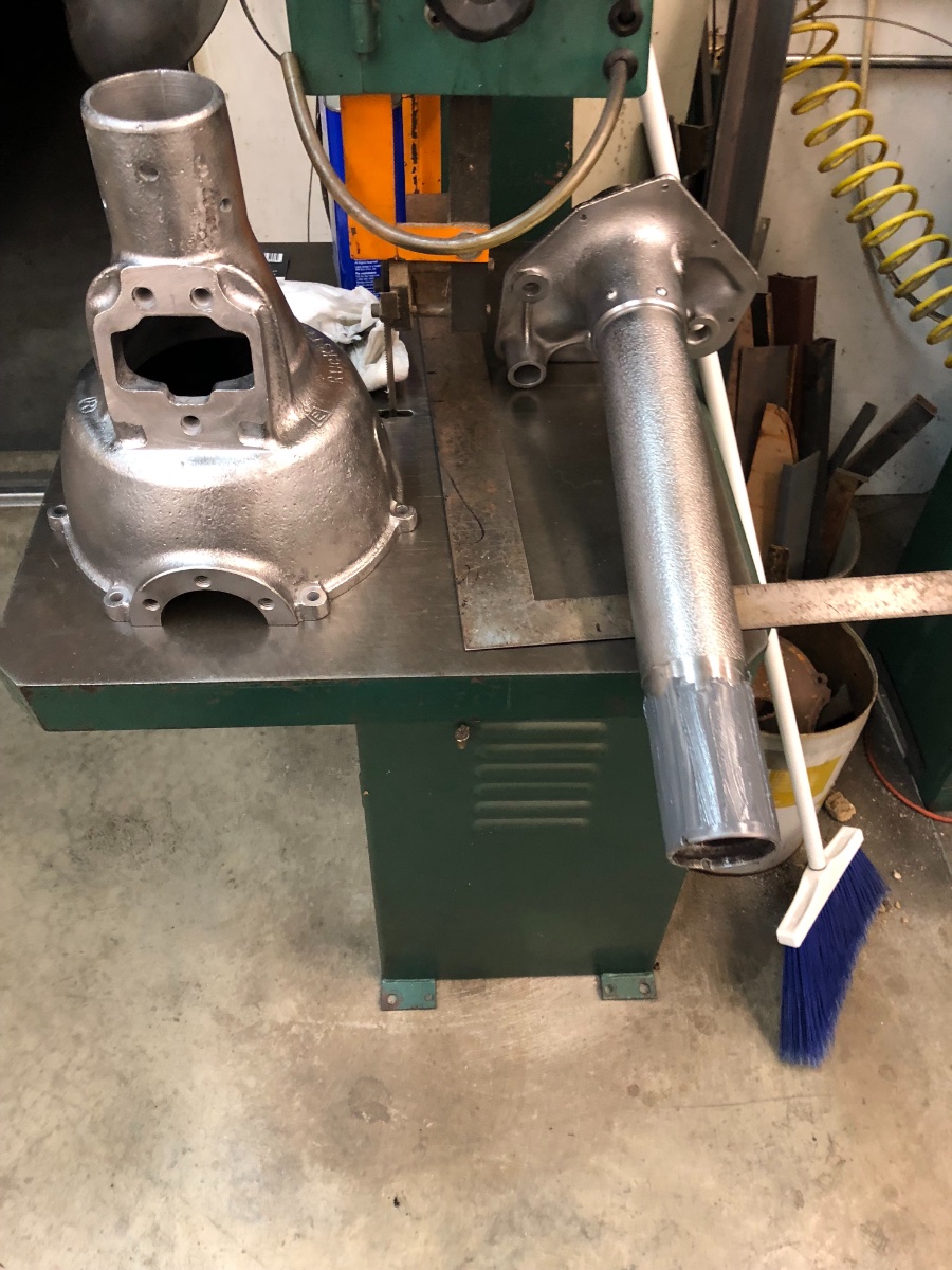

For the number of rear ends I have pulled apart never payed attention to the ring on the inside center section end. My question is; When installing the tube into a Ruckstell housing, is it there just to limit the movement of the bearing so would not be needed?

What is the tube you are referring to? Is it the torque tube? If is, it's the same procedure as a standard rear end. The early bearing spools have a lip, and the later ones don't.
Topic author - Posts: 5549
Re: Intalling axle tube in Ruckstell?
Axle tube into housing.
- Posts: 5619
- First Name: Henry
- Last Name: Lee
That is a bearing sleeve stop ring and nothing else. Not needed for the Ruckstell.

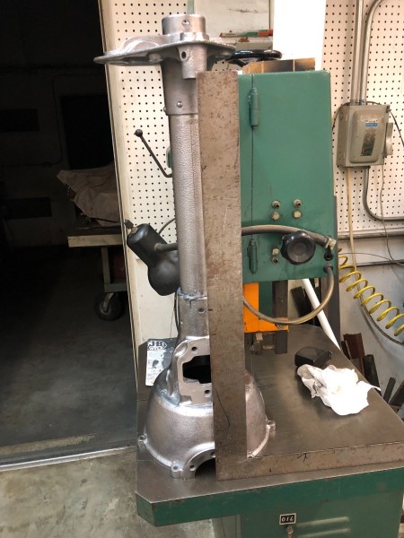

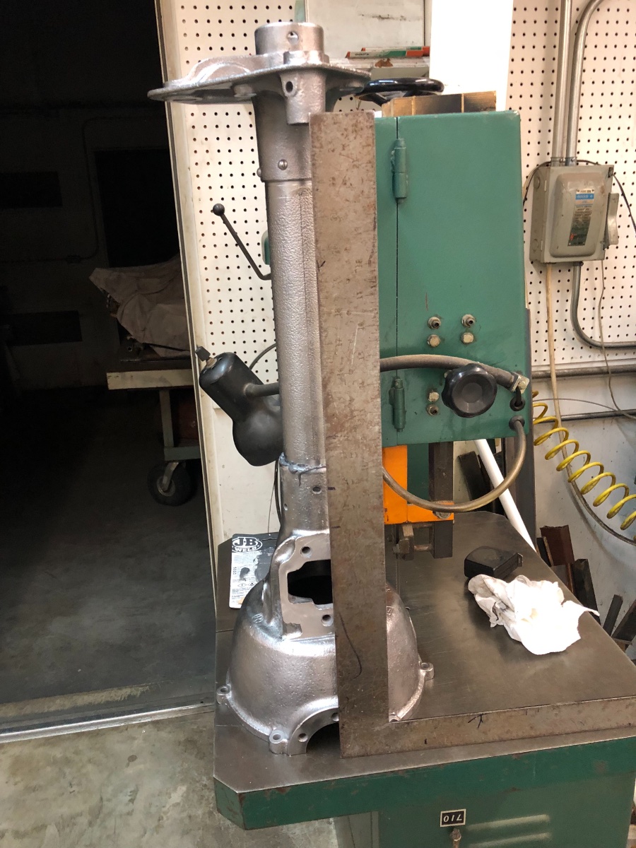

Nice looking job, well done

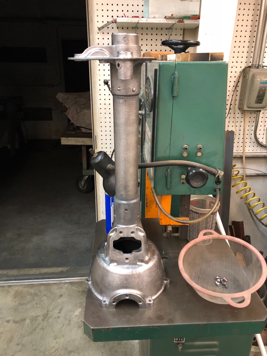

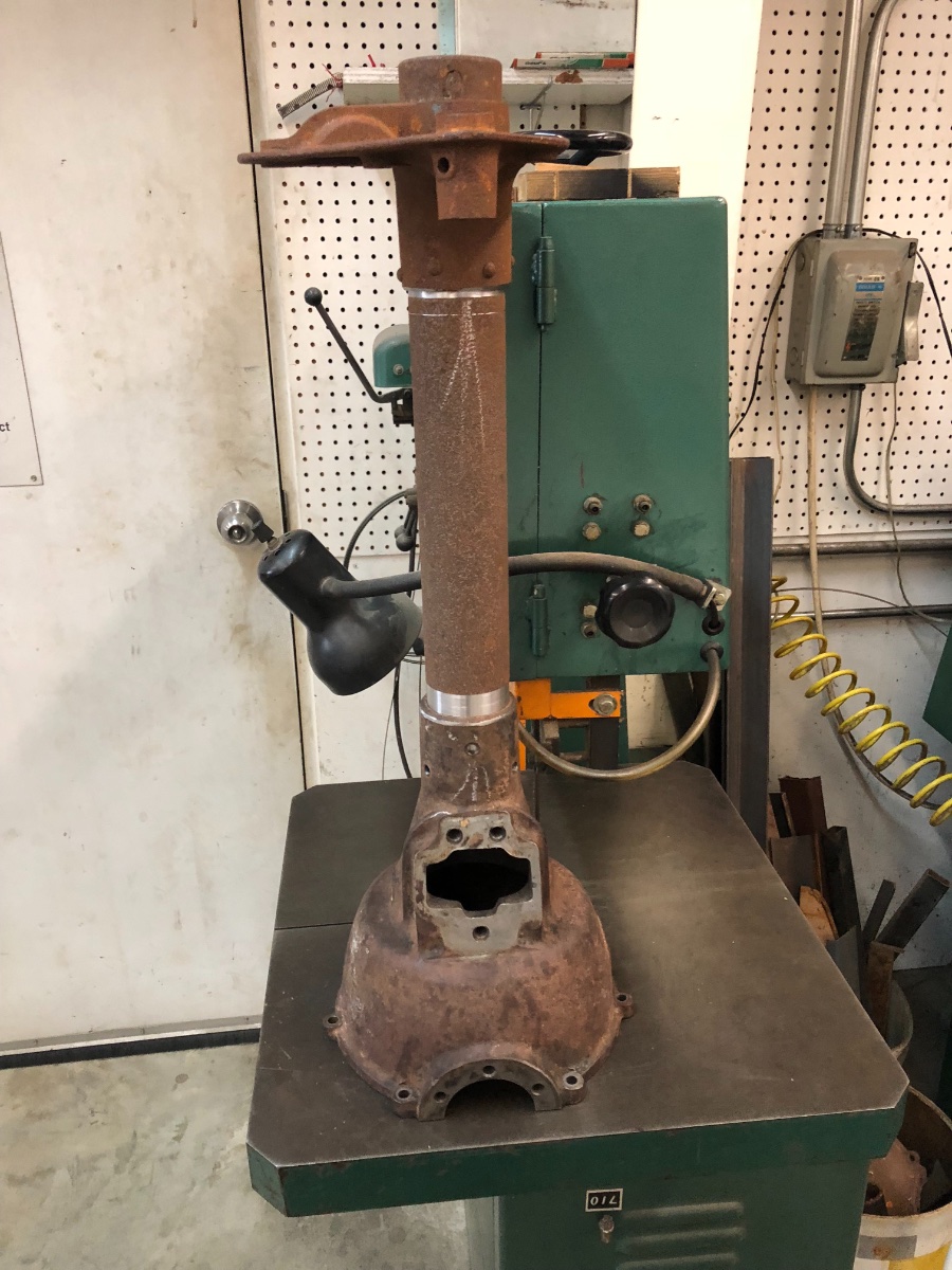

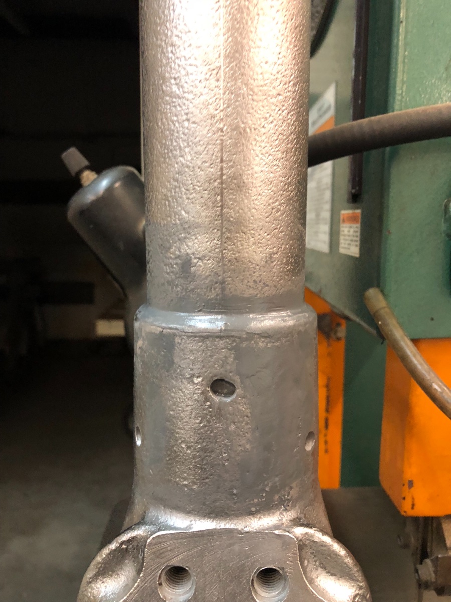

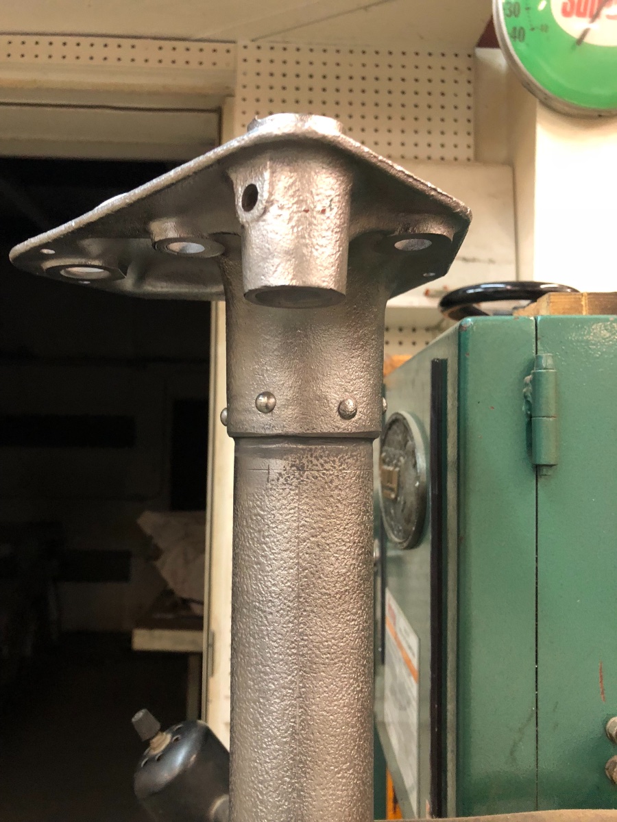

Very useful posting Henry.
What glue are you using please?
- Posts: 5619
- First Name: Henry
- Last Name: Lee

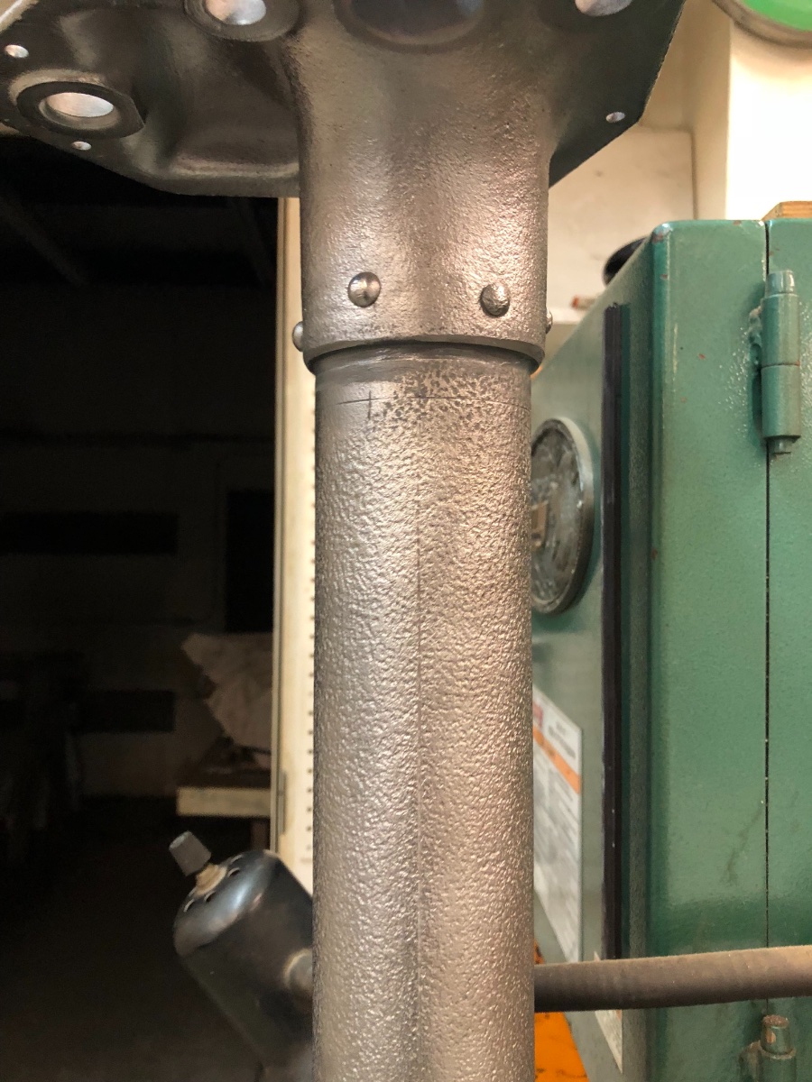

Les, I set mine with about a .0015 clearance, JB Weld reduced with acetone, nice coat then it presses in with a mallet impact to set the length on the money. Let set overnight, drill and tap 1/4" X 20 grade 5 Phillips head machine screws with epoxy on the threads, after installation, fill heads with epoxy. Works excellent.
Great that helps quite a bit. Thank you for the info and photos.

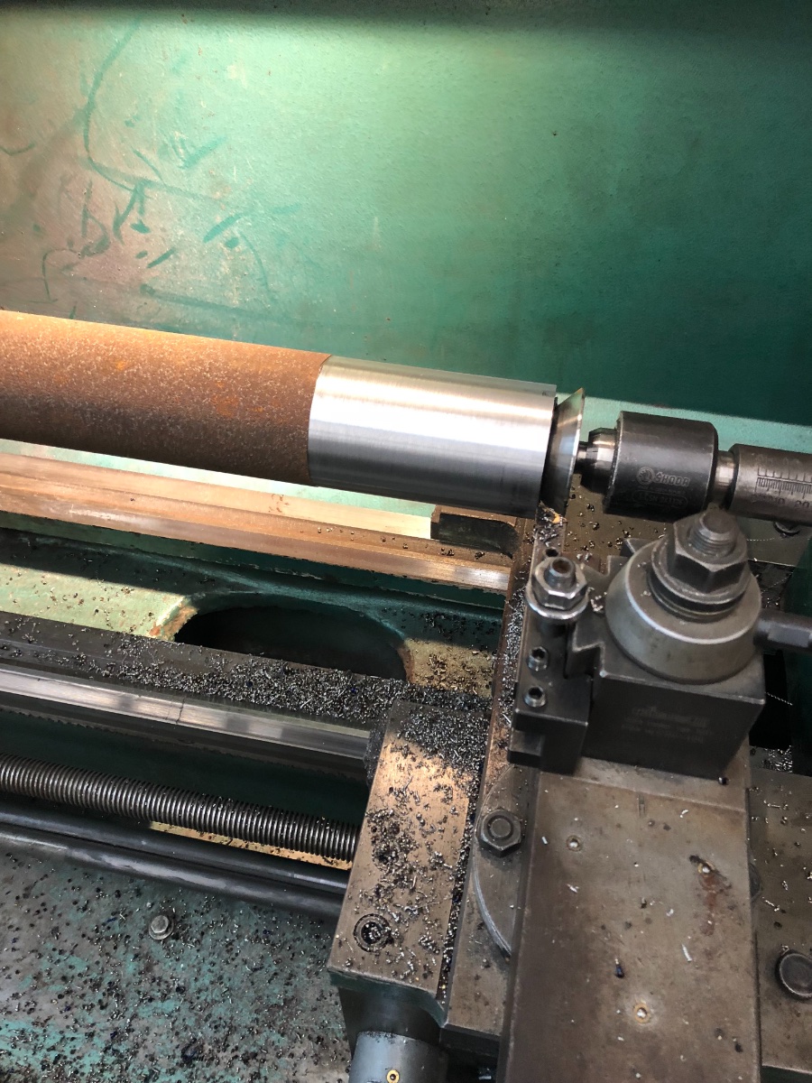

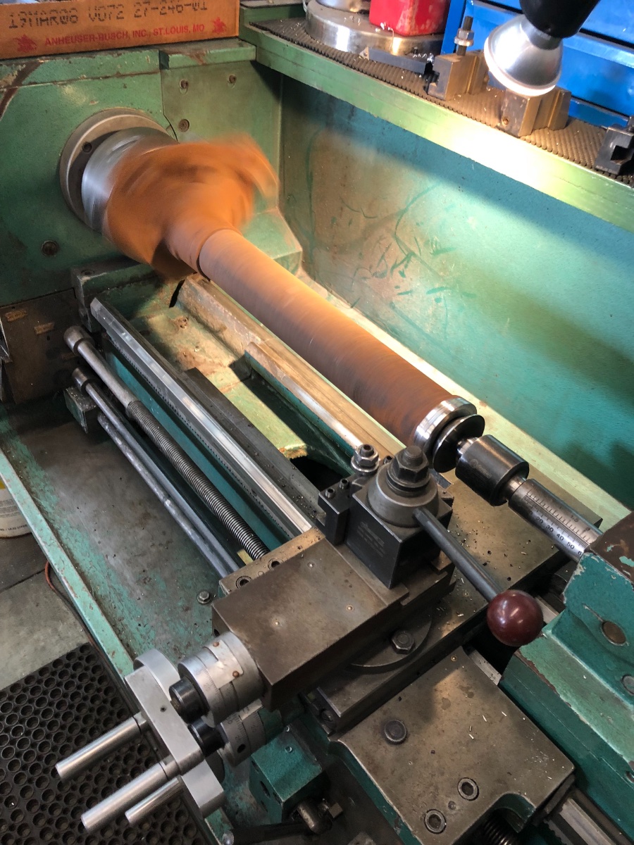

Since the donor tube needs to be machined to fit the Ruckstell housing anyway, centering from the brake cam shaft well. I use my tool post on the lathe and go in and out as required following a linear path on axis. That is what the scribe mark is in the photos. Overall length from flat plain of housing to the very outmost of the end of tube at seal end is 26 7/8”.
