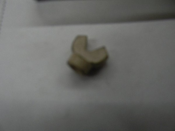

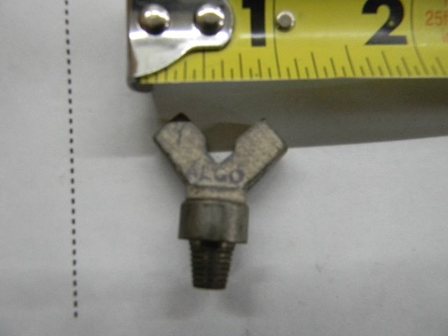

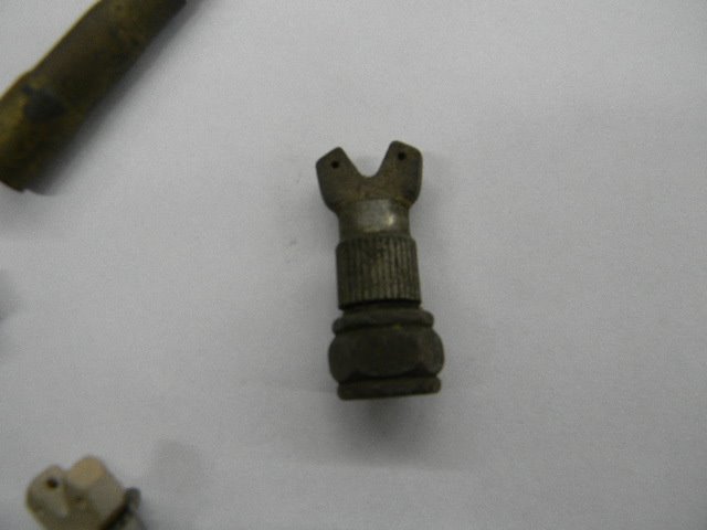

Cleaning up my shop and found some unique carbide burners
no idea what the fit, anyone got any ideas? Bob

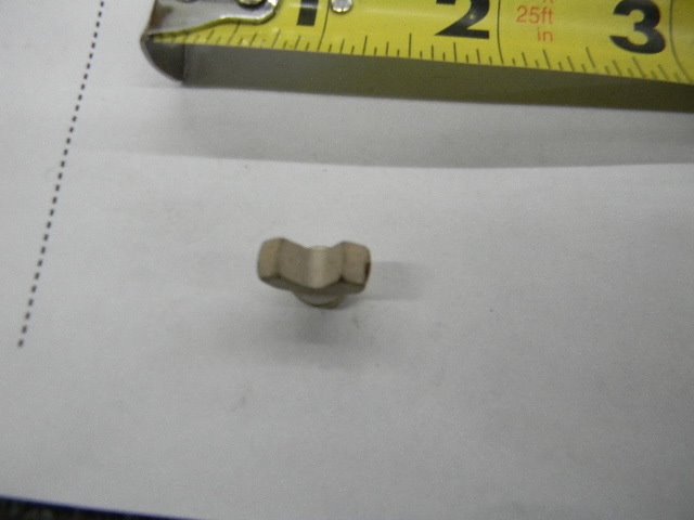

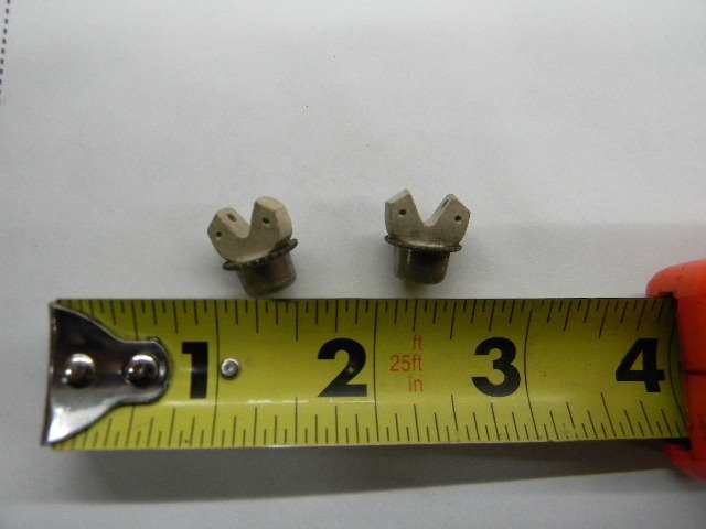

a few more

Any ideas? Bob
Re: Carbide burner tips can anyone tell what these are for?
Post by Rich Eagle » Wed Feb 06, 2019 2:11 pm
How about a minor's lamp tip? Similar?

Looks like one style, any idea of what year they were used? Bob

My father brought a similar miners lamp home and later gave it to me, from when he was a prisoner of war for five years in Siberia in world war two. The tip you are showing is missing off of mine but most likely still could be made to function. Frank

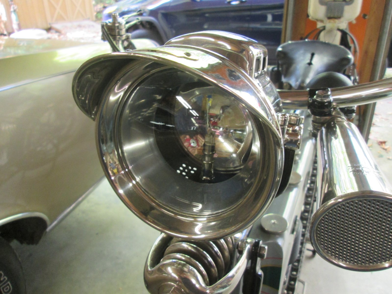

Bicycle or early motorcycle lamps are another use for these types of burners.
This is the headlamp on my 1912 Triumph Motorcycle, sorry the burner isn't too clear, but if you squint you'll see it's one of the small ones.
Terry

Could the one with the really odd taper be household gas lamp type, before things like tapers were standardized. I have a spigot that has a similar taper.

Except for the ALCO tip, those seem to be like the Bray carbide gas burners.
Bray is British and you can see them offered on ebay all the time.

There were also gas tail lamps.
