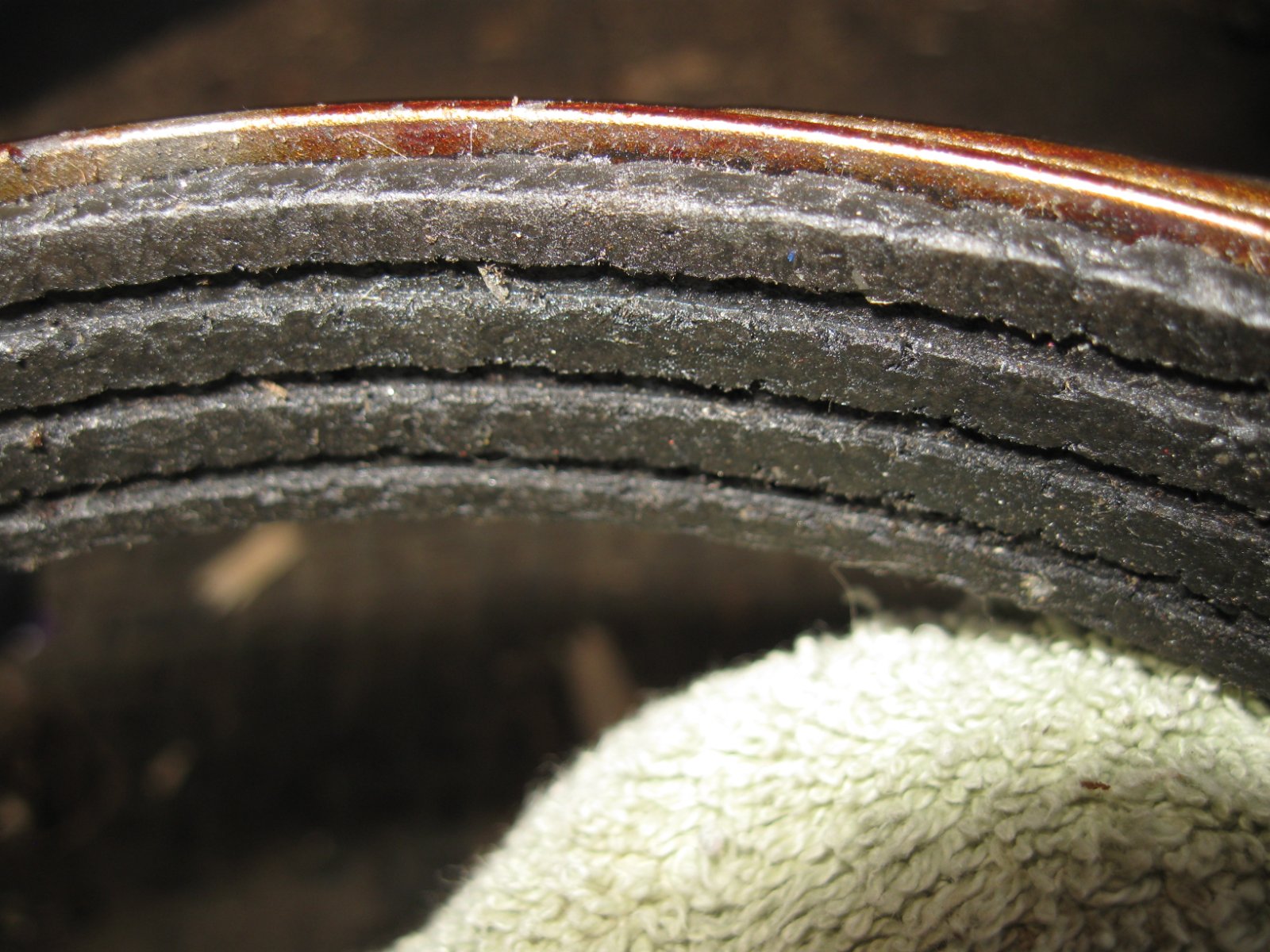

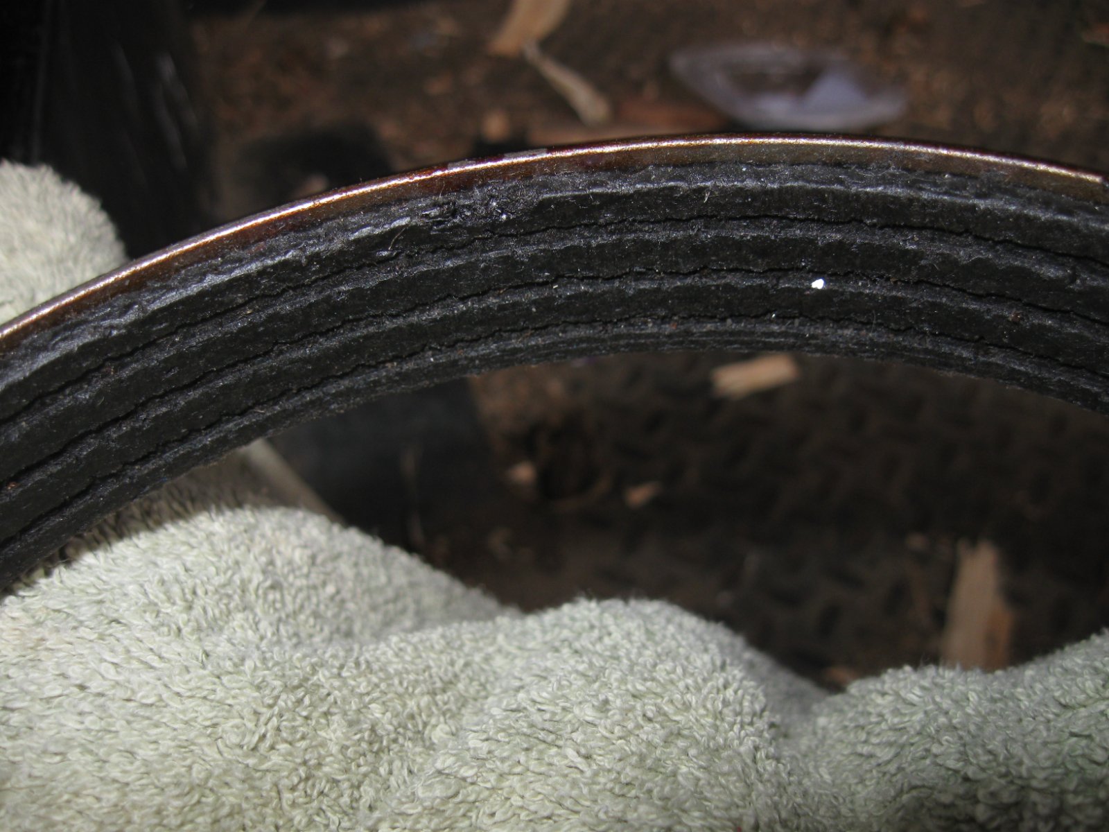

CAN ANY ONE IN T LAND TELL ME, WHAT TYPE BANDS ARE THESE, THEY LOOK TO BE BONDED TO THE STEEL, THERE ARE RIVET HOLES IN THE STEEL BAND BUT NO RIVETS, THEY ARE IN NICE CONDITION, I WANT TO USE THEM IN MY SAW RIG ENGINE, [DON'T FORGET] TO PULL THE PLUG IN THE FAN PULLEY AND GIVE IT A DROP OR TWO BEFORE THAT FIRST RUN..THANK YOU-- STAY WELL.

I was a maintenance mechanic for many years and among other things I worked on was high rpm water pumps. The band looks to me exactly like the square asbestos pump packing that those kind of pumps use. It looks like the 4 square packing strips(if that’s what it is) is bonded or attached to the steel band. Looks like it’s either 1/4 or 5/16” square packing.
If it’s not pump packing it’s made of the same asbestos type material.

I have run into these. There were a bunch made years ago. I think it’s Caterpillar brake lining. Hard on drums and prone to chatter.

There was several brands of bonded linings sold in the 70s, some made from automatic transmission linings. Some wore well, others were really hard on the drums. I think there was some earlier ones made too, called Ferrodo or something like that.

THANK YOU , THE PART ABOUT BEING TOUGH ON DRUMS I AGREE, BUT HAVING DRIVEN TRUCK OVER THIRTY YEARS I KNOW WHAT DAMAGE THE LEFT FOOT CAN DO IF NOT USED PROPER ON THE CLUTCH PEDAL, BEING THEY WILL BE USED IN THE POWER UNIT THEY WONT BE A PROBLEM, I THOUGHT THE LINING LOOKED A BIT LIKE AUTOMATIC CLUTCH, BUT ITS MUCH THICKER. I LIKE THE CAT CLUTCH IDEA, THAT WOULD MEAN ITS TOUGH..SOMETHING IVE NEVER SEEN BEFORE I'M HAPPY WITH ALL YOUR ANSWERS ,

I don't want to hijack your thread but I have run asbestos brake lining on tranny bands without any problem ...stuff never did wear out...that was before anyone knew it was bad for ya...

One of my cars has bonded linings. I don't have any idea when they were installed, but the car was built in the mid 1950's and was driven extensively and I have driven it thousands of miles in the nearly 15 years I have owned it. I hardly ever have to make any adjustments.They do chatter some, but so do the wood bands in my other car.

This was common back in the early 60's. They chattered a lot and ruined some transmissions too. That is why no one uses them any more.

Funny how “updated retrofit” solutions have come and gone, the solutions having become even more obsolete than the Model Ts they were applied to. I first became aware of the bonded band lining idea in the late 60s. At that time, one supposedly “easy” application was to utilize the bands from the 1950-52 Buick “Dyna-Flow” transmission. Nowadays, I’d guess it well may be far more difficult to find those parts than almost anything for a T. “Stock” bands and lining materials have remained consistently pretty easy to find through the years. :D
