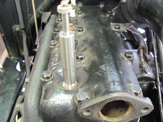

I like to use the handy tool for measuring, it has a hole at the base so you can hear air hissing out on that stoke on # 1. So you know you are on the right stroke. Then crank over a bit more to get 15 degrees ATDC.

Here is pic from forum a while ago, the next to the last crank on the right is a EE, the far right is the diamond throw crank, note the pin holes are identical .
As for the crank pin hole, all T cranks are the same. If that pin hole is horizontal, two of the pistons are at TDC. But you set timing on the compression stroke.

Dan, Question- What is, looks like brass, on top off the knurled piece?

- Posts: 3961
Re: Timing degrees after top dead center ??
John
That's the round head brass screw top of the screw used to move the marker sleeve up and down. The end of that screw is right angled to rest on the piston, the wing end tells you that it is in position, since you have to screw the tool into plug hole, so the piston drives the marker up and down as you hand crank over the engine.
TW Timer Tool
And use it with indicator lamp wired to # 1 coil post, (not the plug wire post!) and that lamp lites just as you reach the timing mark 15 degrees, since the rotor in the timer is just contacting # 1 timer terminal. Helps you really dial in the ATDC spot by using piston travel.
For showing too that the clock face look of your crank pulley pin works, you can see it rests at the proper spot.
Hint: If you use Dan M.'s alum flanged split pulley, the slit is right dead center of the horizontal crank pulley pin.
You may see my black ink marker spot on the slit and the timing cover parting line, I marked black ink on that too. When they were lined up, the timing tool showed exactly TDC! So you can see where another ink mark on the pulley is made at the correct 15 degrees ATDC.
Have always checked my timer and timer rod setting (bends) with timing tool indicator and lamp, confirming too the useful 9:15am and 3:15pm clock face method.
TW Timer Tool

   How much tork is recommended for the head bolt on the top of the engine?Super Mario Bross

Snug those head bolts.   Torque measures weren't around in Model T days.
So be sure bolt holes are clean all the way to the bottom. Be sure to check hole depth to have proper length bolts for the style of cylinder head.
Then really important to snug down bolts, then torque if you must use a torque wrench, but do that with the center bolts first, in a line.
Then alternate to the other bolts as you work out and up and down. If rare early block, 45 lb/ft. You can go 50-55 lb/ft if all holes are nice thread and new head bolts. Factory wrench is always safe if you checked out the cleaned holes and bolt threads too. Anti-seize on the bolt threads helps a bunch.
A busted head bolt or one spinning in a hole due to poor threads or dirt at the bottom of hole makes for a bad day.

There are a few variations of the sequence. I use this one.
As Dan says, they didn't use torque wrenches in Model T days. The Ford head bolt wrench #2335 is the right length to get it about right if you go as tight as you can with muscle power.

Last night I was in fire and decided to clean up all the bolt holes all the way to the bottom. I also check hole depth to have proper length bolts for the style of cylinder head.  All my bolts are very tired, so I decided to order new one's at Lang's this morning.  Also the Magneto is really tired so I decided to remove  the pan and start to remove the Magneto in the goal to restore it too.  I will remove the Magneto this week-end and recharge the magnet.  I will post how I will do in another post... Thank you Steve for the sequence, I will follow it for sure.
Make a short story, it's like an open hearth surgery in the goal to survive another 100 years.

From reading in the past, on the early blocks keep the torque in the 45FP range.
