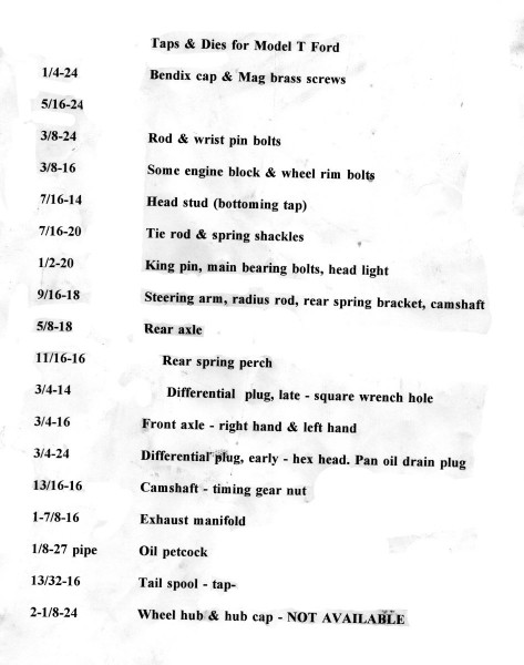

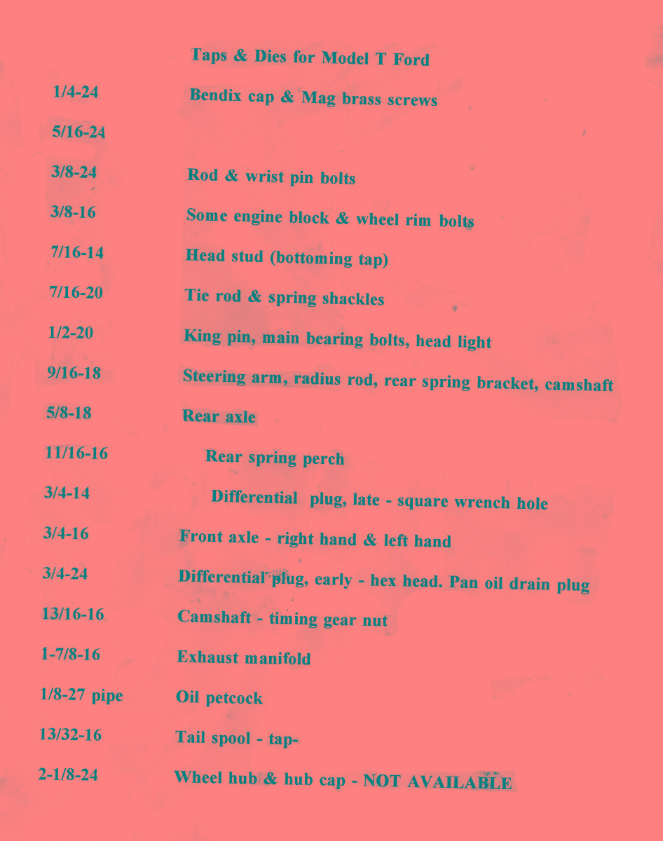

The thread sizes can be shrunk down to a small list of the sizes.

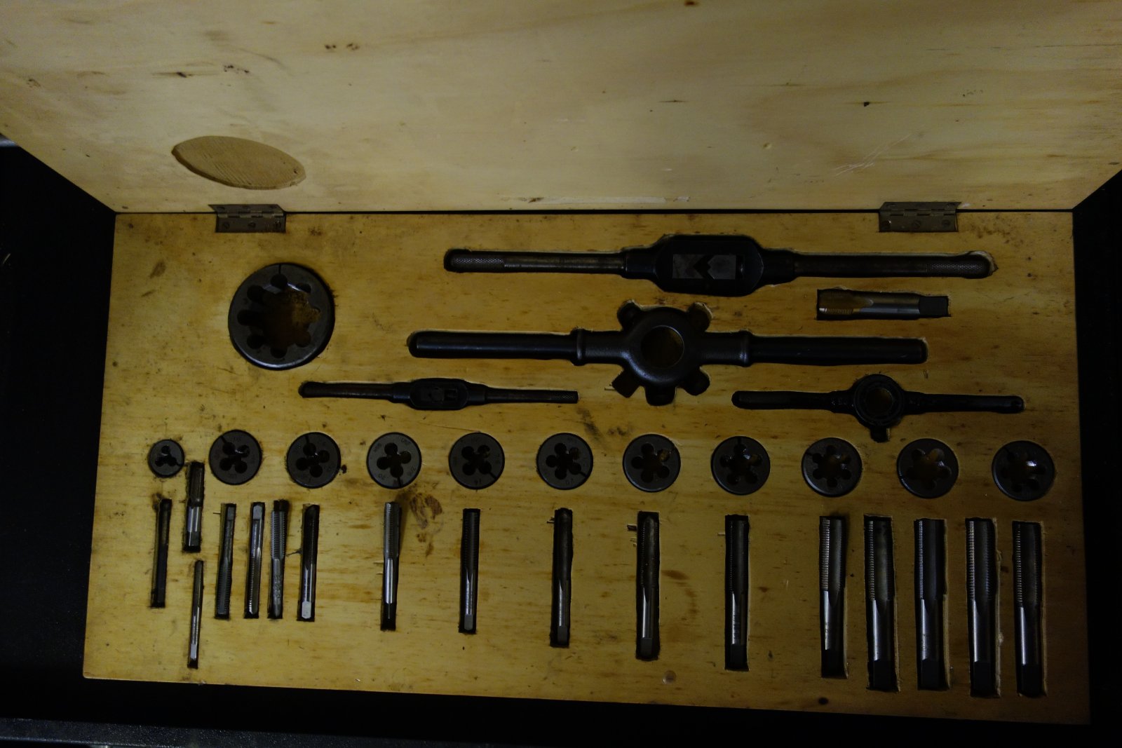

Years ago I was given a set of taps and dies by some Model T guys while I was in the USA after they had stayed with my wife and myself when they visited Australia. I had planned to buy a set when there from a large engineering company but they got there first. Attached was a list of what they were for.
May be there are more but so far I have always had the one needed to clean up any poor threads. I made a box which they now live in.
No hub cap thread tap or die was available, though now it is possible to get a die to clean up the hub. Never have found oneof the tools available at the time for the Model T.

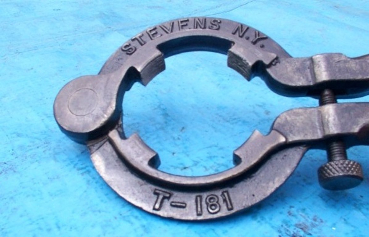

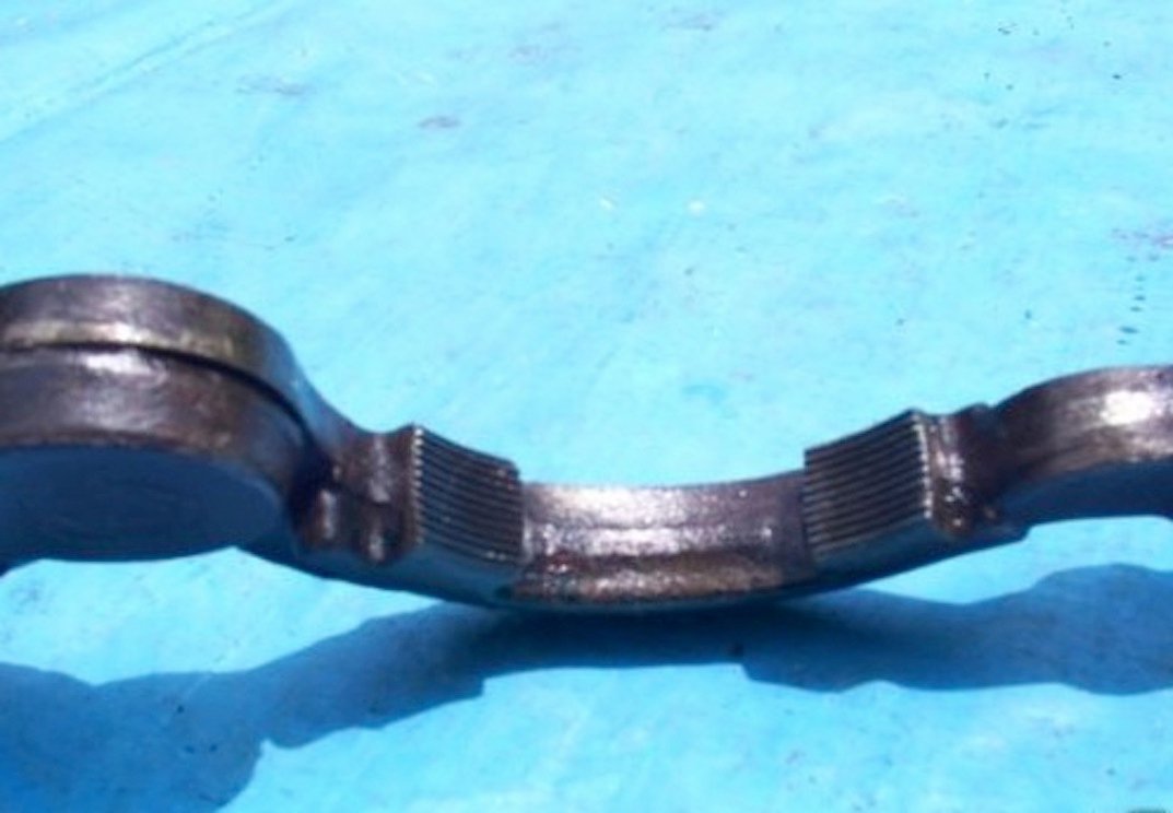

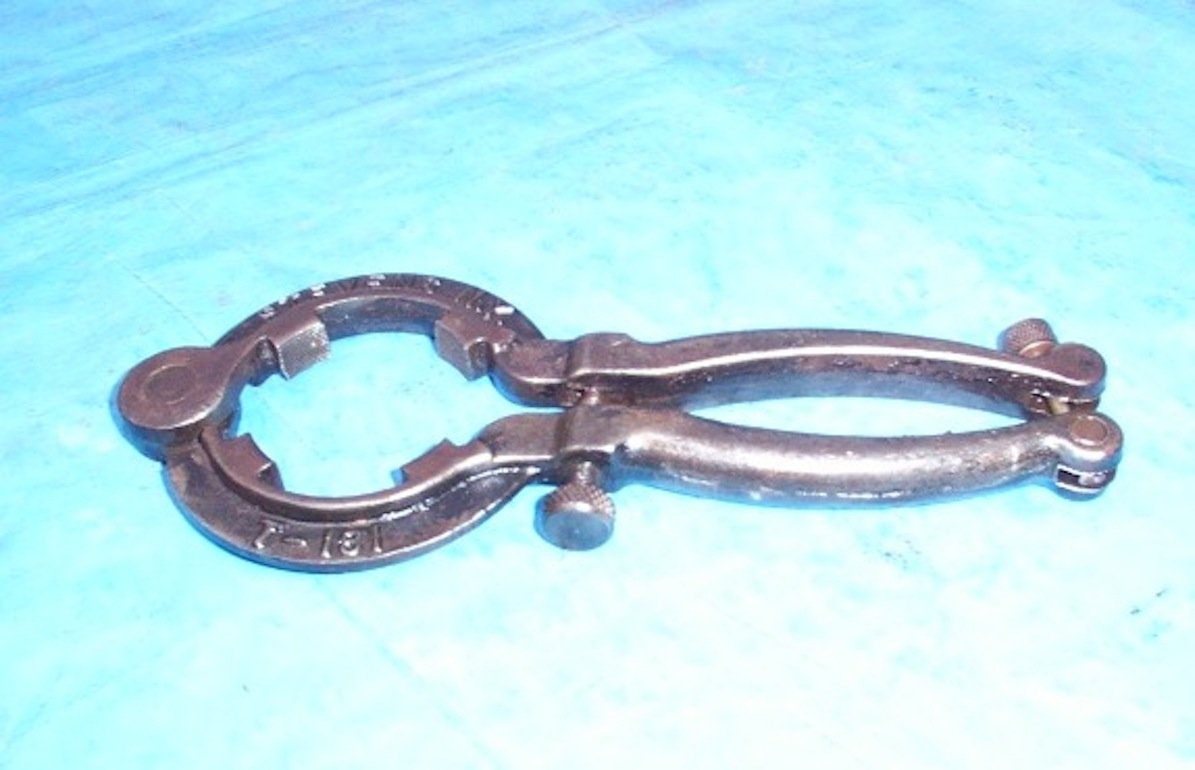

I believe the best tool for hub threads is the Stevens 181. Currently available thread chasers have to be screwed on from the outside, which is typically where the threads are most boogered up. With the Stevens tool you can start where the threads are good and work your way out. I don't know of a reproduction commercially available, but Andre Valkenaers posted pictures of a very nice one he made himself.
Here's an original that was on eBay.

This type of commercially available thread chasing tool can clean threads without having to be screwed in from the top, and it has several different dies to allow chasing of a variety of thread sizes. I have one and it works well. :)

Peter's comment regarding Bendix cap screws p/n 5059, and FH brass magnet clamp machine screws p/n 3278 being 1/4-24 should have a footnote. Originally, 3278 was 14-24, new ring gears are 1/4-24, vendors offer both bolt types, they are not interchangeable.
Bendix cap screws are 14-24, unless hogshead threads have been 'modified/re-taped' to 1/4-24. Respectfully, jb

I believe Jack Putnam reproduced some Stevens T 181 tools. Still not cheap, but far better than the prices paid on Ebay for a couple of them. I bought my original on spec going on the T181 number and the Stevens branding. I thought it had to be something to do with T's.

FYI, I spoke with Jack yesterday about another subject. He mentioned he sold all of these tools and was not going to make more due to the extensive process required to do them right and the loss he took on them. His wife is having health issues so I wanted to save him from the need to reply to multiple inquiries looking for them at this time. Please keep Marilyn and Jack in your prayers.

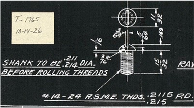

Question - what is the difference between 14-24 and 1/4" 24 bolts (size wise)? That was raised regarding Bendix cover and magneto bolts.
They are not the same, but close. #14 gauge works our at 15/64" while 1/4 is 16/64"

The Bendix cover machine screw is an obsoleted thread size. ASME #14 - 24 thread.
Here is the Ford print. The vendors do still get these made today, and are a must have to do the job right. Some use a metric size screw but the correct thread is best. Would hate to re-thread a hogshead, unless the old holes are so messed up. Even this would think of some way to mark the hogshead or at least the Bendix cover of the size threads made in the hogshead at the starter opening.
The magnet screws are made in modern 1/4" size thread ONLY because of the mistake made years ago with reproduction ring gears of today, the ring gears are made of the wrong size threads by mistake, so a new ring gear needs modern 1/4" dia. brass screws.
