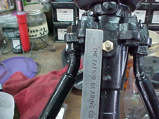

Can anyone show me a photo and/or supply dimensions of the locations of where the rivets that secure the front casting to the torque tube? I’m putting together a replica using the components that Lang’s sells but the new front casting has no rivet holes. Thanking anyone who can assist me in advance! 😊

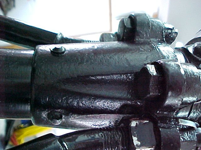

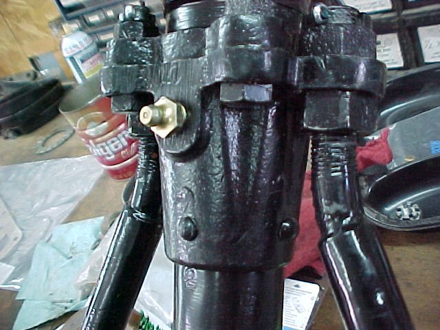

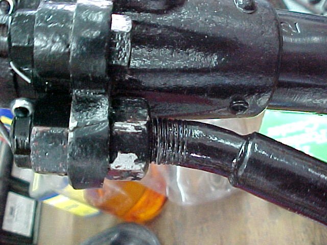

There are 4 rivets as show.

Thank you John so much for your quick response and the photos. This is perfect!!

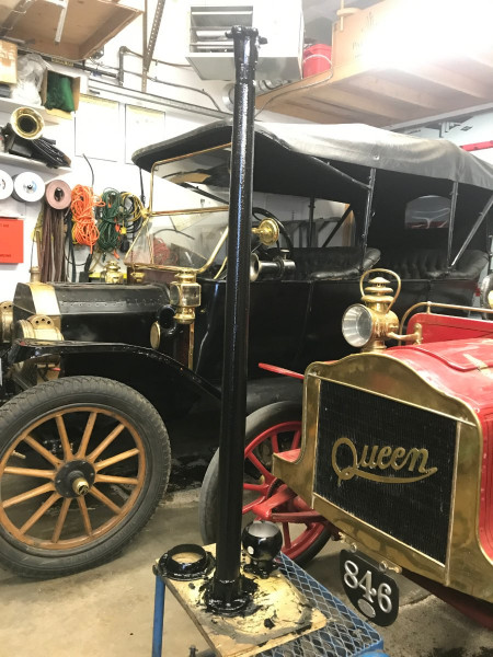

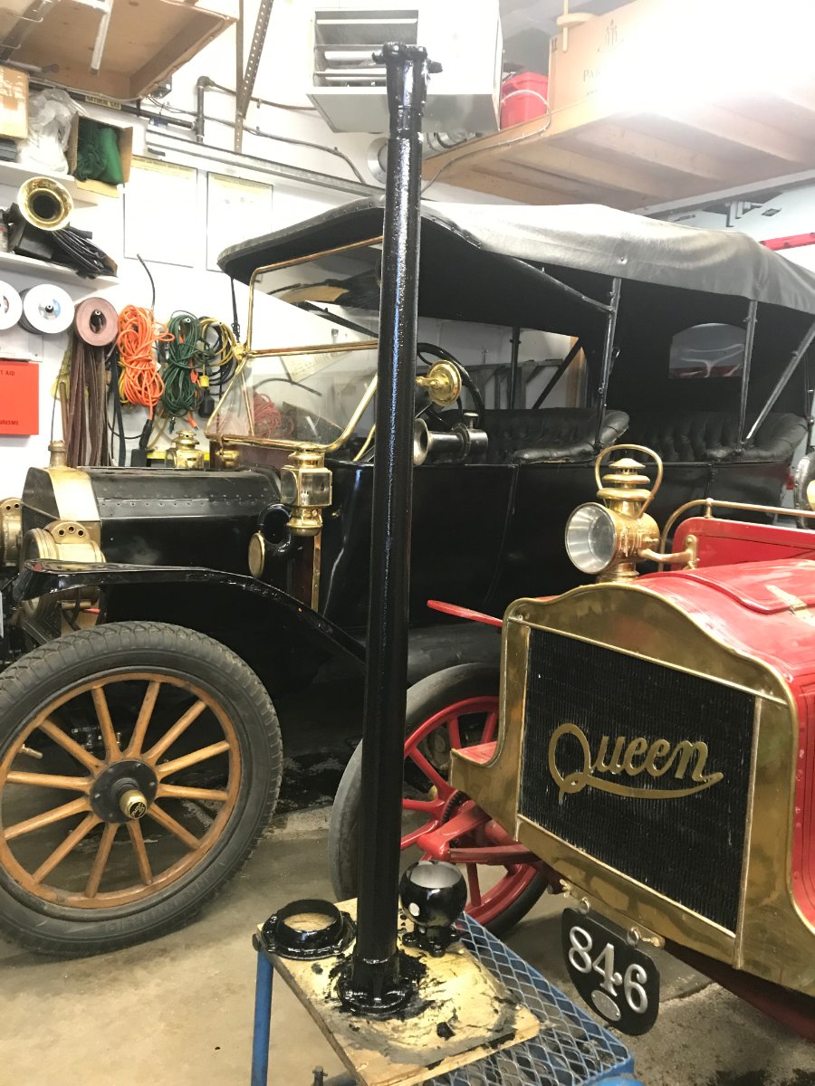

Thanks again guys! I did notice I had to weld in two of the holes, so I did. It's all painted and ready to go! I had to make a riveting jig, and the rivets in the lathe. Everything worked out great! I did have an original one to take measurements off of that the owner didn't want to sell.
