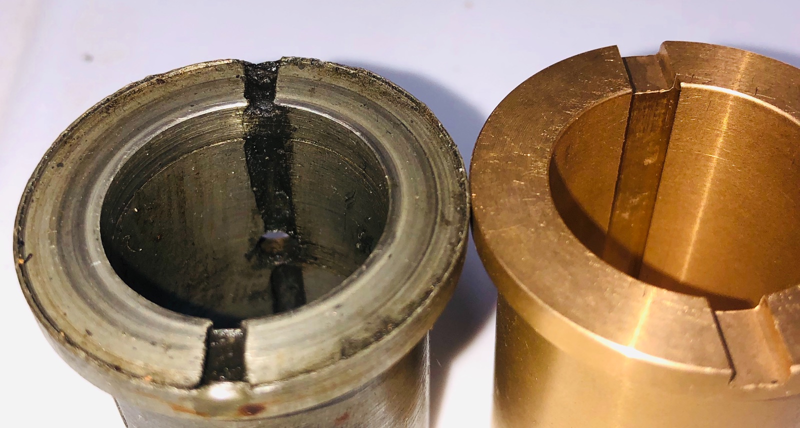

I found a problem with the reproductions , but used it to my advantage. I’ve done two in the past couple of years. The bushing was supposed to be a light press fit, but both just dropped in. This made it easier to take in and out to face until I got the perfect fit, then I installed it with bearing lock glue. This didn’t really answer your question , and I don’t have a loose one to measure.

New repro measured o.d. 1.313" Flange thickness .170"
Grease groove on flange and down one side (where you drill your hole for the dope cup) .180" wide
Old worn Babbitt measured o.d. 1.312". Flange .180" and grease groove .155" wide
Yet to have any trouble with repro's, they need a bushing driver to place, you don't want the bushing to rotate or move forward.

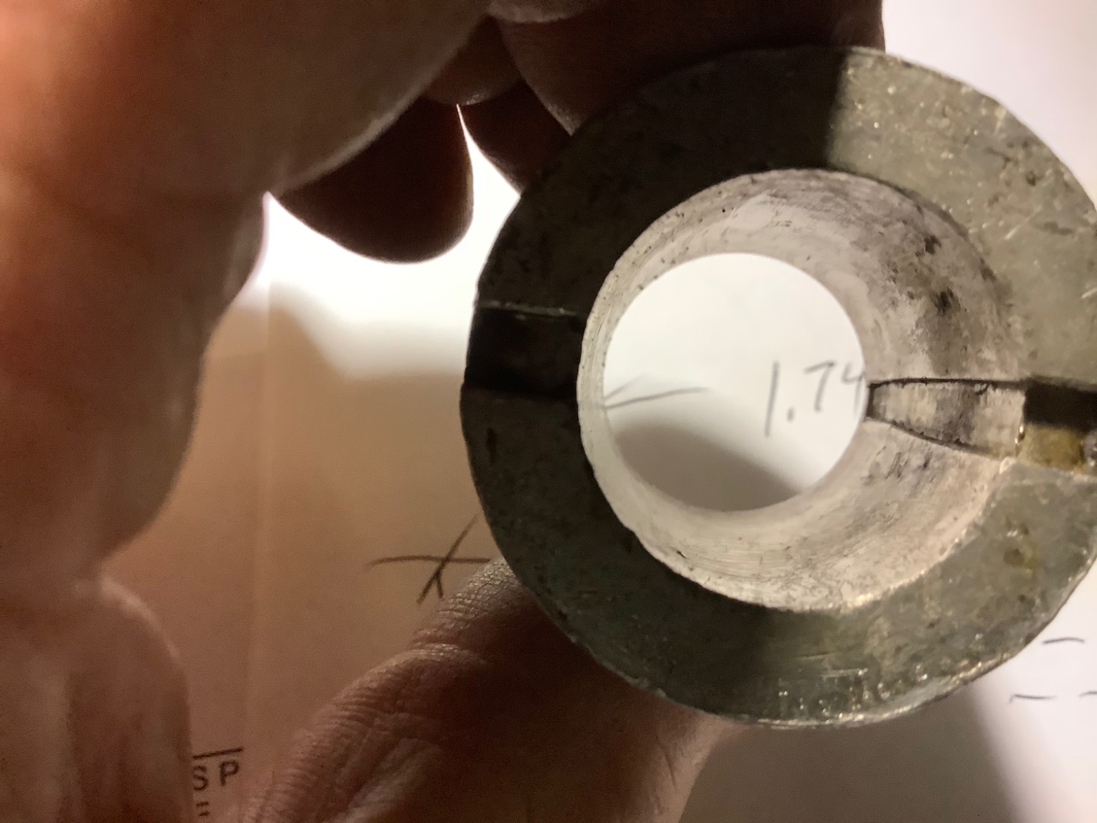

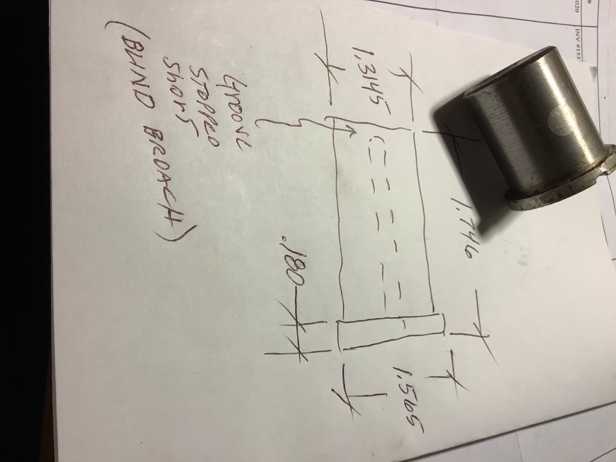

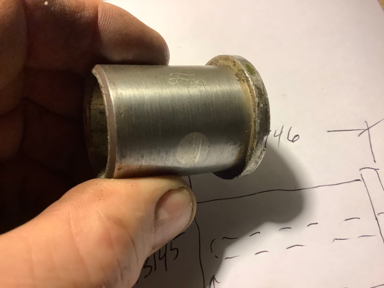

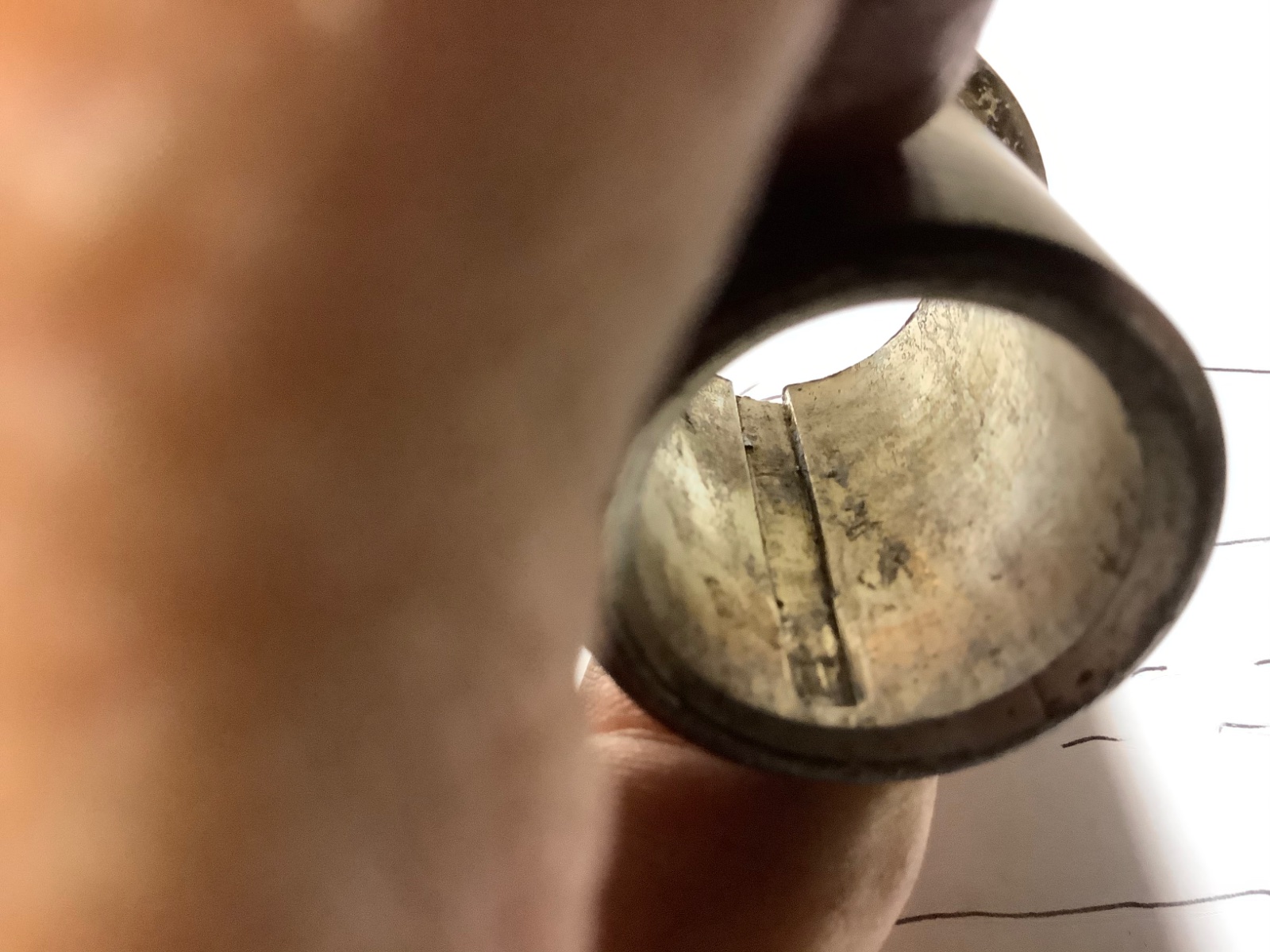

TMI .....Can anyone help with some drive shaft bushing measurements?
Ok, probably TMI but here goes. How many have plucked these babies out of a driveshaft and just threw them in the scrap? I looked at my cosmolined NOS one today, and had to degrease it. This is ford script. A steel shell, with a babbit rim and lining. What I found interesting is the single grease groove stopped short from the end. Also, the spot for the grease hole is in the steel shell, which would make it easy for the mechanic to install correctly, right side up. Grease groove and grease hole up. An easy drill for the mechanic through the babbit for the grease hole. Best of all, this original style would limit oil travel8mg back to the rear axle. Ok , TMI but I thought pretty neat.
