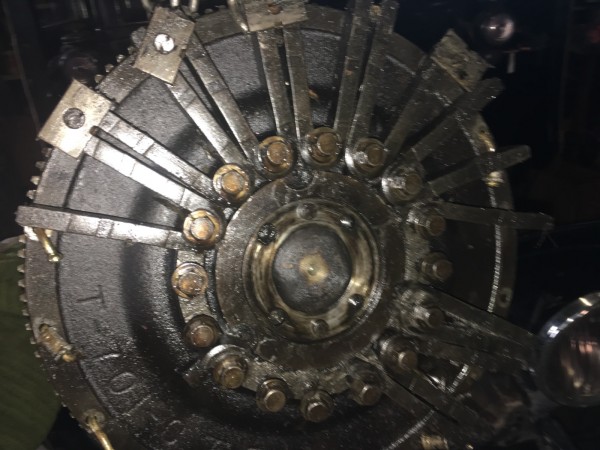

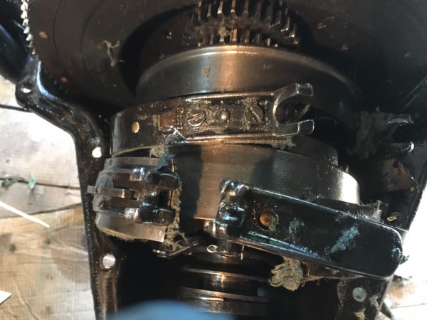

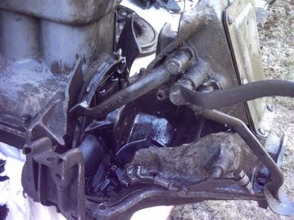

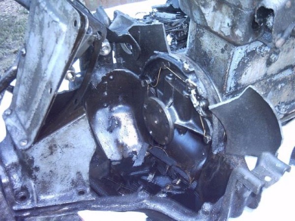

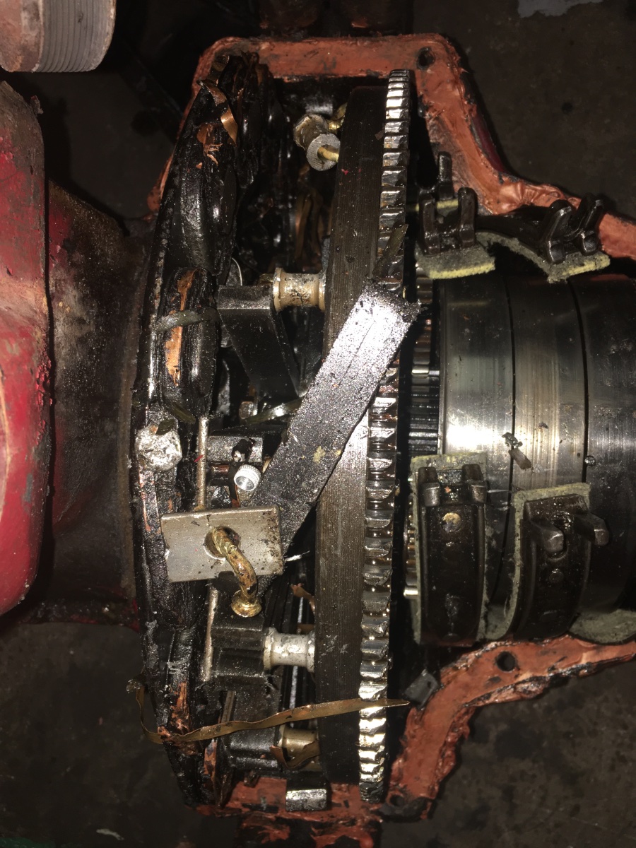

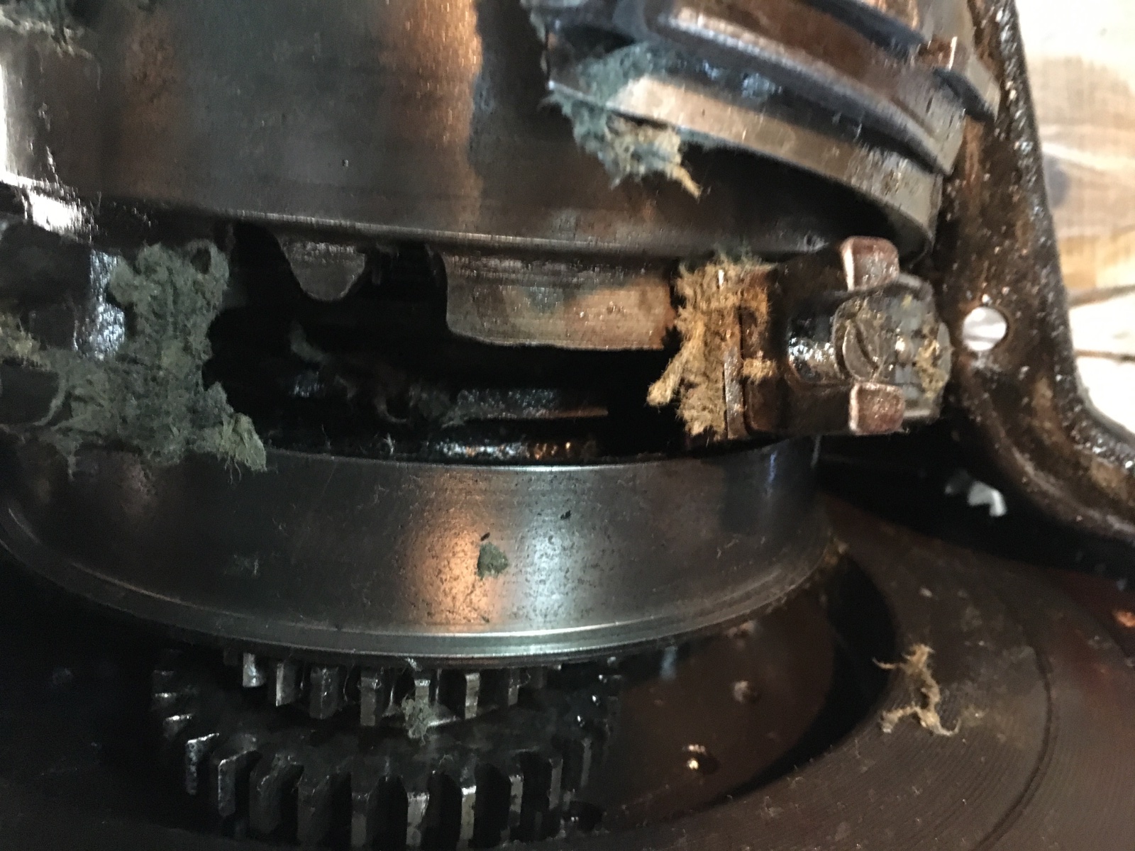

A Model T came into the workshop a week or so ago. The novice owner had dropped a washer while changing bands, couldn’t find it so ran the motor. It lasted about 30 minutes then stopped with a Big Bang.
Today I managed to get the hogshead off, made more difficult as something was stopping the starter from coming out.
The other damage was quite extensive as the hogs head is cracked and the pan has holes.
This is what I found when I removed the hoghead
Sorry about the wrong order, I have not yet mastered getting the pictures where I want ☹️☹️

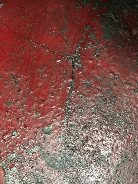

There is a star crack

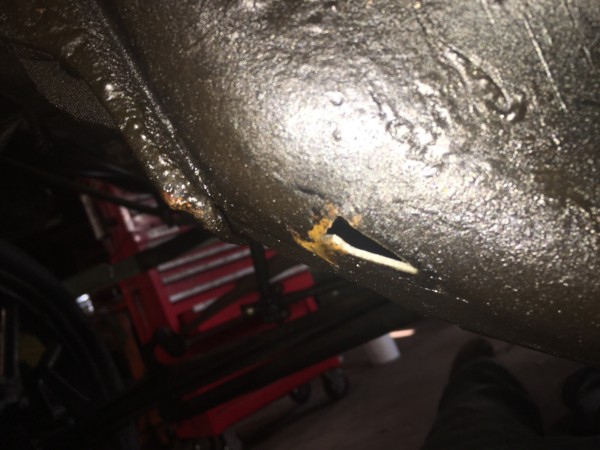

Hole is the pan
Hole is the pan

Re: When a novice drops a washer.......
Post by Steve Jelf » Fri Feb 08, 2019 12:23 am
Tommy Lee Jones in The Fugitive: "My, my, my, my my. What A Mess!"

Must have been a fairly large washer.

Ouch! Time for a complete rebuild of transmission, flywheel, starter and magneto! My grandma said something which applied to sewing, but also could be applied to a T. "A stitch in time saves nine". Even if he had to pull the hogs head to get the washer, he would have saved much time and money. Better check the crankshaft too. Such an abrupt stop could put quite a strain on it.

Really? All that from one dropped Washer?

That's just ugly !!
I wager he won't forget that lesson...EVER !! :cry:

One little washer is like one little domino. Drop it, and a whole long line of them can topple over!

Wow...when I think how far from home, and how fast he could've been driving in those 30 minutes makes me shiver. Lucky
nothing worse, nor no one apparently hurt. These things can be like a bomb exploding sometimes. I've always wondered about the benefit of "lining" the underside of the floorboards with sheet metal to maybe offer a bit more occupant protection in the event of a catastrophic failure of this sort.

I'm not saying that a washer did not cause this, but...
isn't that damage consistent with part of the magneto breaking free and the chain reaction of destruction that can follow?

. Well the guy was changing bands, so I'd imagine it was a band washer. They're big and stout.
. A momentary wedging of that washer and a magnet breaks, a keeper comes off the brass screw, and the whole thing will come to pieces with impressive results.

When a piece of iron or steel is dropped into the transmission, if it should happen to contact one of the magnets on the magneto, it will be forced around the magneto at the speed of the flywheel. Should it come in contact with the plate which is attached with a brass screw to the poles of the magnet and tear off that plate and eventually touch something else such as the poles on the magneto coil or the starter shaft and it happens that the magnet breaks at the weak point of the V. The magnet will come off with force and hit whatever is in line with it.
Yes it could happen to any magnet without a washer, but the washer is most likely what caused it in that case. I once had the funnel of my oil line come in contact with the magnet and it tore off the funnel and immediately cut the magneto coil. I didn't know what had happened for about 10 years, because I drove on battery for those years and since I had an outside oiler, i had no problem with the engine bearings. Later when I was restoring another T , I rewound an extra magneto coil and decided to install it in the first Model T. When I pulled things down, I found what had happened to the magneto. Fortunately the funnel was laying down in the bottom of the crankcase and caused no further damage.

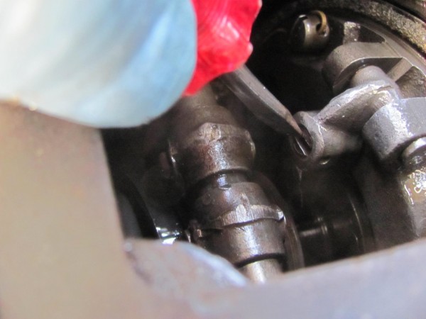

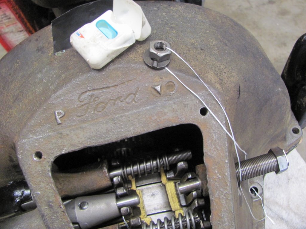

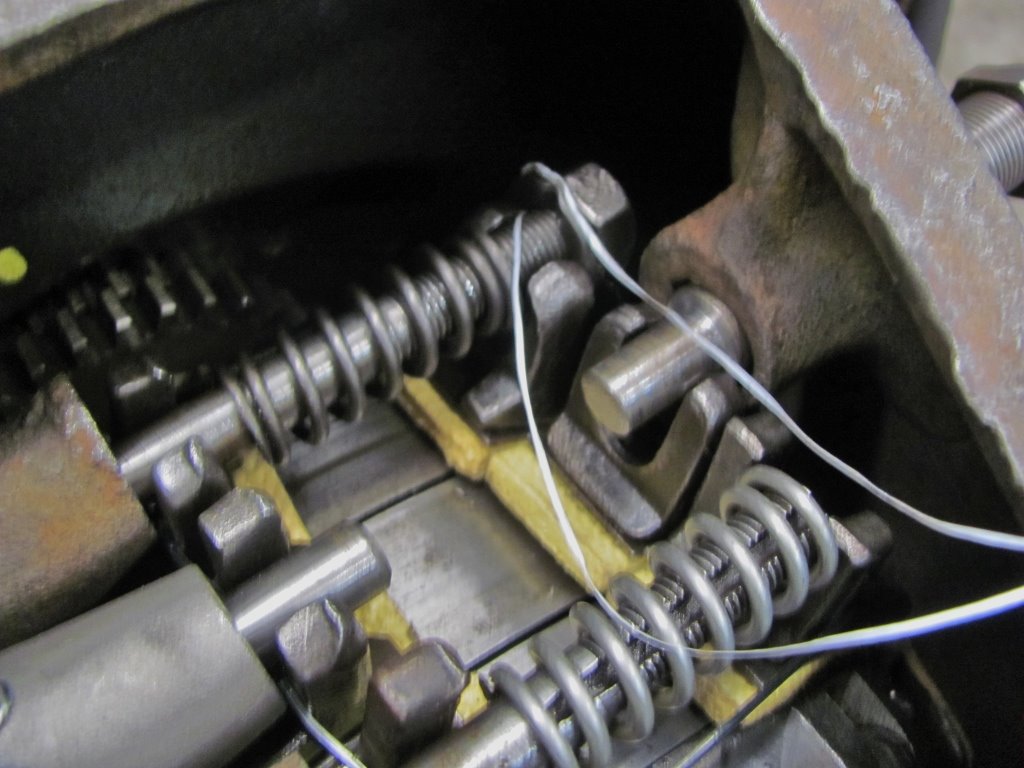

I
Good deed stating that a new owner had this happen. Many before likely too. Do feel pain in his happening, but the issue of ignorance of the new owner was never posted. For many its a good lesson in the dynamics of the spinning Ford flywheel magneto and plantary transmission.
Suspect that many new T owners don't have the Owners Manual or the Service Manual at first, and the warnings in the Ford Owner's manual are there.
Early manuals give a Caution, the later manual for the demountable bands gives that caution in BOLD face!

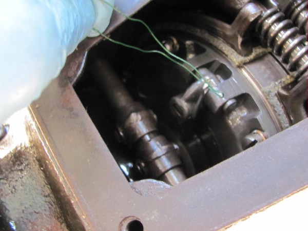

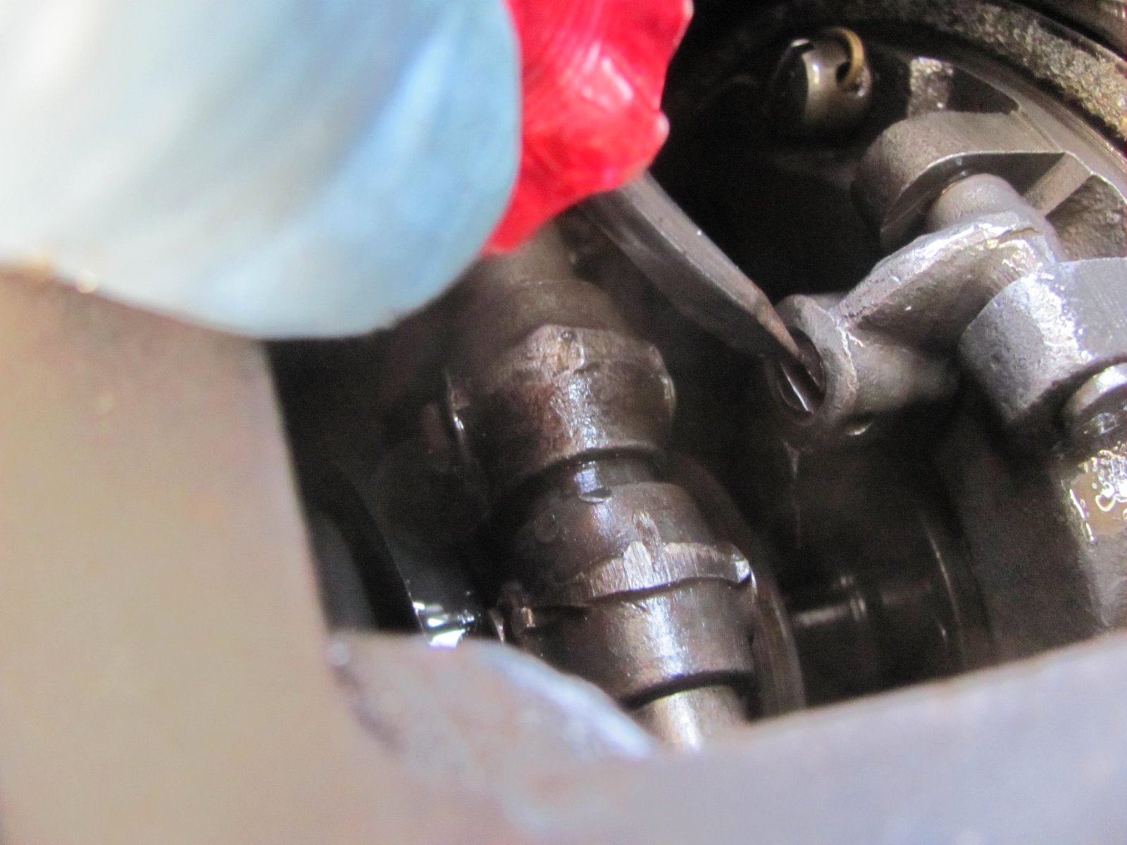

For that caution in the manual , "good wire or cord attached" my buddy when the inspection door is off, is a tough dental floss. Wrapped on all the little pieces....
Lace the nut and washer and after placing, the floss can be busted away with ease.
But do heed the Ford Service Manual @ paragraph 519. When placing the hogshead on engine assembly "good plan to install the door on the trans. cover temporarily" One time forgot that, and had a handful of caps screws and lock washers for the hogshead fastening and out of the palm fell a lock washer
:shock:
The hogshead was already sealed down, and was facing removing it, but very lucky that lock washer could be seen on the clutch spring gaps and retrieved it :?
So....careful when that trans. door is off. Have learned from another on this forum to also remove the ignition key when that door is off! The abyss below is a hazard for loose pieces.

Dan,
Great advice about the dental floss! These type of tips are why I now read the forum religiously. I am just about to change my bands and have lots of rags for stuffing per Milt Webb and now floss, which really makes me less tentative. Love all you experienced and knowledgable guys sharing!!

Dental floss has many uses, that's a new one. Duly noted. Thankyouverymuch!

You are welcome. I learned early using the rags, but one time a nut fell into the rag folds, and could not be found.
Can guess what then occurred as the rag was being most carefully pulled up to expose that nut :oops:
So learned of the floss wrap and now no worrying. Only one time, was pulling the cotter pins from the clutch screws and my single loop floss came apart, from the clamping of the needle nose pliers, just barely saving that cotter pin from falling in.
Now when doing real pulling on parts or for extra 'safe satisfaction', am using two strands of dental floss, doubling the strength of my 'cord' :)
And use floss on those cotter pins for install and removal, but now the tool is a miniature locking vise grip needle nose on the cotter pin!

Yep. Safe than Sorry ;) Sometimes a length of small stiff wire can be a good 'cord' too. :D

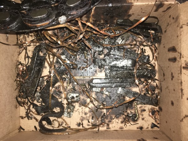

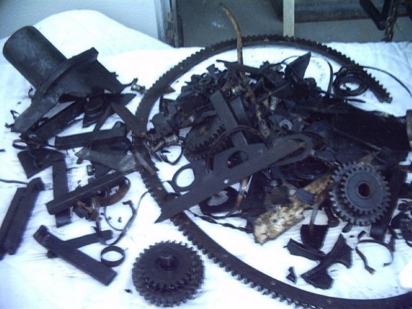

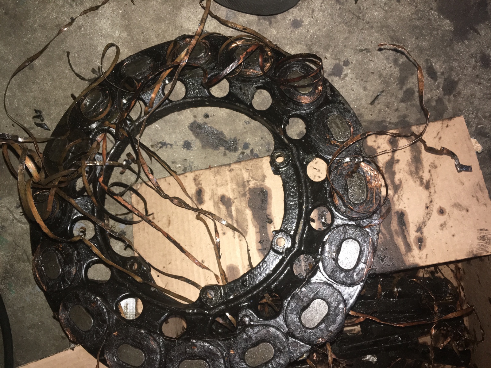

I remember many years ago working on the Coupe with the transmission door off and the key in the ignition. Yes the inevitable happened and the damn key fell into the bowl of the transmission. I had to pull the motor, expensive lesson.
I posted this as a caution note to novices and no disrespect to the novice owner. Another expensive lesson.
This is what I pulled out of the bottom of the pan
Theis the remains of the coil ring
Remains of the magnets
View when I removed the hogs head

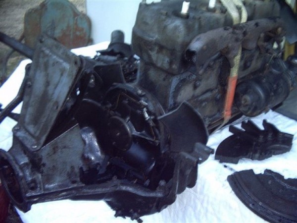

Posts: 4249
Post by Wayne Sheldon » Sat Feb 09, 2019 5:19 pm
Hey Tony! Wow, that one IS a mess! However, it is not nearly the worst I have ever seen. I think it was Erik Barrett posted one a couple years ago that was worse. And almost fifty years ago, I went to the Turlock swap meet where a fellow had a model T engine he had found in a barn. It had been sitting for decades, removed from its car and not touched. The engine was not for sale, he took it as a display item only because he was so amazed by it. It had splayed out the hogshead, blew a hole in the pan large enough to drop a whole magnet through it, and broke at least two transmission drums into pieces.

Here is another one to look at. It was being towed when it came apart. It destroyed the firewall, floor boards, coil box, and broke the starter snout off, as well as breaking the exhaust manifold off. . It was in a TT truck and the entire inside of the cab was covered in oil. Even the ceiling. This was a customers truck from sometime about 1990. I have posted these before and yes the owner knew I was posting them.

I did not tell the "rest of the story". The TT was a nice original body, wood cab truck. The new owner could not get it running because it was in the winter time and very cold. He lived less than five miles away so they decided to tow it home. (the previous owner was out of state at the time, so he had no input into the event) The new owner was in the truck when it exploded. The only thing that saved him was he had on full winter clothing. Carhart coveralls, ski mask, heavy gloves and boots. he also wore glasses. He said when the transmission exploded, it felt like his knees went behind his ears. He said it almost turned him upside down. Him and every square inch of the inside of the cab was covered in hot oil. The pictures show the engine as I removed it, It looked worse before I removed the engine because all the floorboards and wood firewall were splintered to shreds, The entire transmission assembly was in the seat beside where the owner was sitting. When the flywheel broke it allowed the entire transmission assembly to come out as one piece. One of the triple gears went completely thru the driver side door. How it missed the guys legs is a miracle. The moral of this story is "do not tow a model T" They made it about 2 miles. I was able to salvage the motor, and the transmission drums were all still useable. I replaced the hogs head, oil pan, starter, flywheel and magneto, exhaust manifold, and a few other things. They steam cleaned the inside of the cab, replaced the firewall, coil box, floor boards, and fixed the hole in the door. The truck is still running today...

as far as the truck transmission coming apart, i am new to the game and have heard that you do not tow a T, but what made the trans fly apart like it did if the engine was not running? and how would the oil be hot? Just a little confused. Also, would it be feasible to make a light weight tow dolly to place under the rear wheels if there was need to pull the vehicle, just a thought.
No, you cannot in any way pull a T backward on a dolly under the rear wheels. The T can only go in very very slow reverse, as the steering geometry can't be controlled.
To move a dead T, push it on a flatbed tow truck and haul away, or push up on a trailer and tow the trailer with T on it.
Towing a dead T on all fours makes the rear end turn the drive line, since there is no neutral in the trans. Any tow 'in neutral' at a speed will overheat oil and lockup trans discs. If a dead T is towed in high gear, the engine turns, creating some oil splash, but even with spark plugs out, to relieve compression strain, its just too much load, heat, and wear at any speed other than a crawl. If you like your T, don't tow it on all fours.

Dan is correct. The trans clutch disc were warped and very blue, almost welded together. The three thrust washers were welded together. When towing any distance, disc's are turning inside the clutch till they finally get so hot they lock up and then they start turning the engine. I am guessing, but I think when the engine started turning is when something came loose. The guy said they did not get over 30 miles an hour, but at that speed how many rpms would a TT rear end be turning the engine. ?? At the time I did not do a CSI investigation into the mishap, but I always felt like the clutch disc's locked up and the rpms then destroyed the engine. As to the owner knowing if I used the pictures. He was there when I took the pictures, I told him I wanted the pictures to show others "what not to do" and he had no problems with it. This had nothing to do with a dropped washer. I posted these as another example of "what could happen" Seems like every time something gets posted, someone jumps in with something negative to say. :(

The clutch pack dries out very quickly without the flywheel churning the oil around.
Then everything goes wrong.

I have no explanation on what happened here. I was driving along and I heard click,click and then BANG !! Towed it home opened the transmission cover and wow! It even broke the pinion gear.

George. I figured that the engine explosion was probably caused by the excessive RPMs The thing that I have always wondered about is, what did it sound like in that truck cab before the engine exploded. . Most of us have trained ourselves to "listen, and hear" what is going on with the engine. It must have sounded terrible just from the rpms of the engine.
