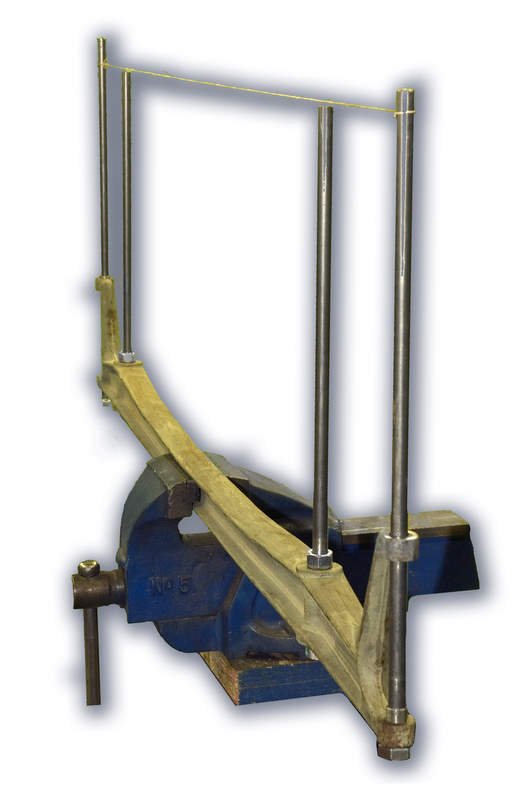

Re: Front Axle Alignment Tools
Need o search  the old forums to see where I got these photos

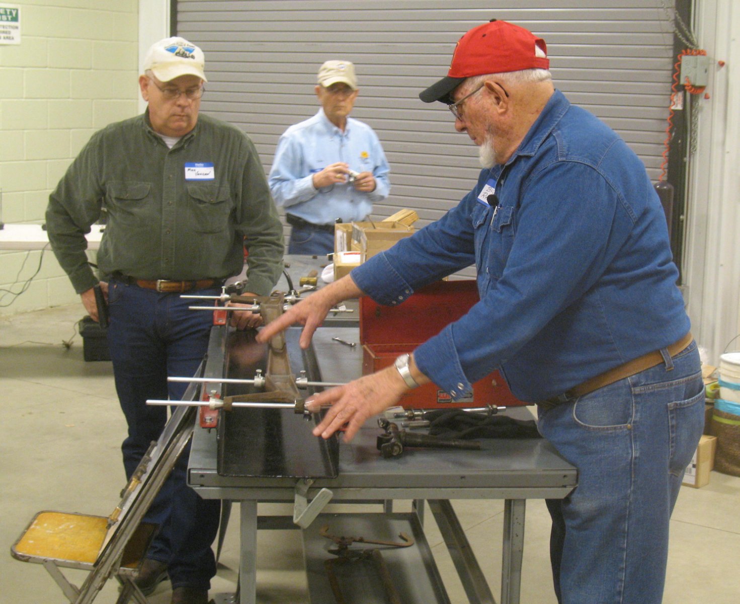

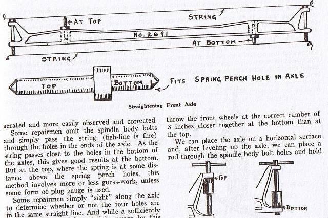

- Posts: 7359
Here's the rig Bud Redding uses. Rods through tapered plugs that center in the holes.
I have used twin tapered  collars with thumbscrews on 3/8 rods for many years. Very similar to the picture above.
You can tell immediately if the axle is twisted. Very easy and quick to turn out on your lathe.
Harry

- Posts: 6946
My rods are at least 18" long. The shorter you make them, the more difficult to ascertain differences in alignment.
