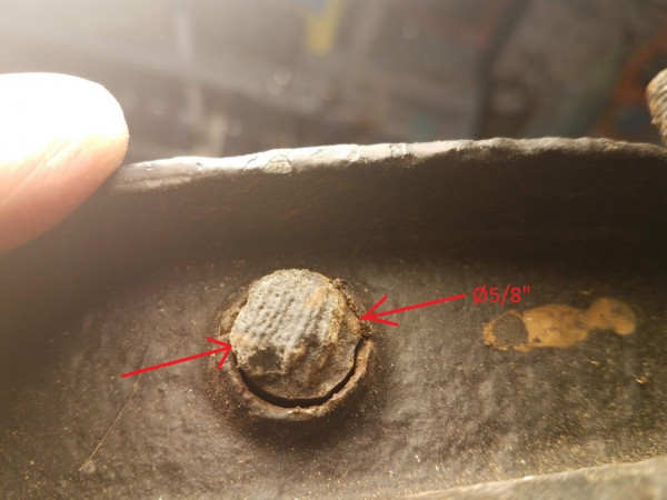

I have had the back wheels off of my '27 for a while while I rebuild the drive line. While handling the wheels (with no weight on them) I realized how loose some of the spokes are. On the car it looked like one or two were a little loose and maybe could be shimmed. While the car is laid up anyway I want to re-poke all the wheels. After looking at the parts catalogs, I see that there are two different length spokes. How do you accurately measure the felloe to determine which spokes are required. It would be a pain to order 48 of the wrong length spokes. The measurement appears to have to be within 1/16". I'm not sure how to get that accuracy. Any help would be appreciated. (I'm still waiting for a back ordered adjustable Timken pinion bearing kit).

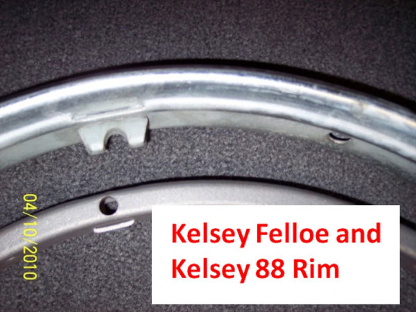

Re: Re-spoking wood wheels

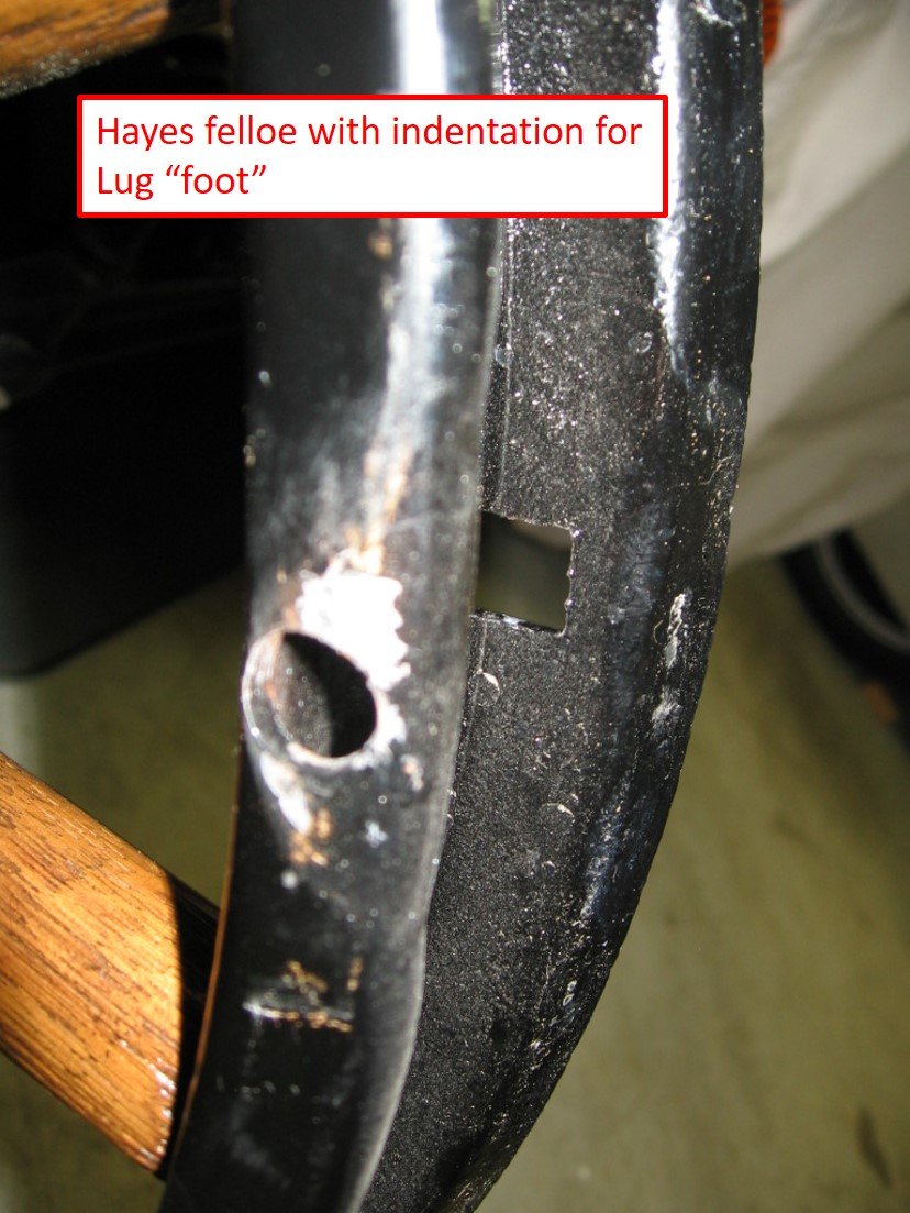

Hayes felloes also use the slightly longer spokes (Kelsey and Hayes were separate companies in the days of the Model T). If you have Kelsey felloes, they will have four slots punched into them for the separate lugs to bear against.
If you have Hayes felloes, they may be stamped "Hayes" somewhere one them. Hayes felloes also have four indentations around the perimeter to allow clearance for the "feet" of each lug.

It's a little bit of a mystery why this '27 (April) has 3-1/2" x 30" wooden wheels, but it does. Also has older style water outlet / fan setup. That aside I still need to re-spoke the wheels. The tenons are Ø5/8", but I still don't know how to verify the fellow diameter to determine 'short' or 'long' spokes.

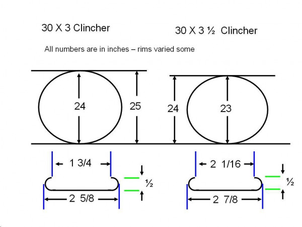

- Posts: 4110

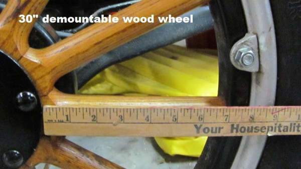

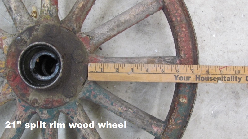

Your spoke length would be typical for any 30" x 3 /12" tire demountable rim wood wheel.
The actual rim diameter is larger than the rim diameter of the split-rim demountable balloon tires, which are 21" tires.
Your 30" diameter for clincher tires.
Spoke length is shorter for balloon tires.
Ref. for both sizes of clincher rims:
