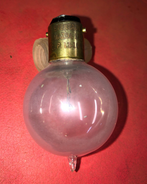

And here's one of those original Mazda 2 contact terminal magneto bulbs. These are single CP, this one 16 c.p. , 12-16v.

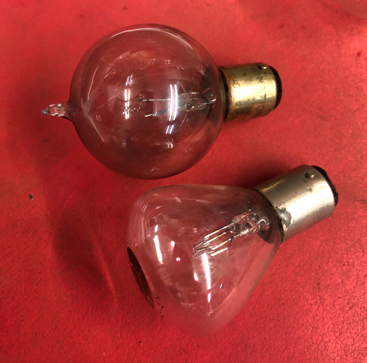

And comparison with typical electric 2 contact terminal bulb, these are usually dual filament, so CP on the lower one is 21c.p and 2c.p.
The electric DC bulbs are normally sporting a solder point at the top of the brass base, indicating the base is the ground.
As John posted, most of the magneto bulbs got too much AC from the magneto, and look browned out and blown, just like the one in top of photo
