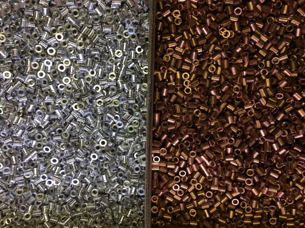

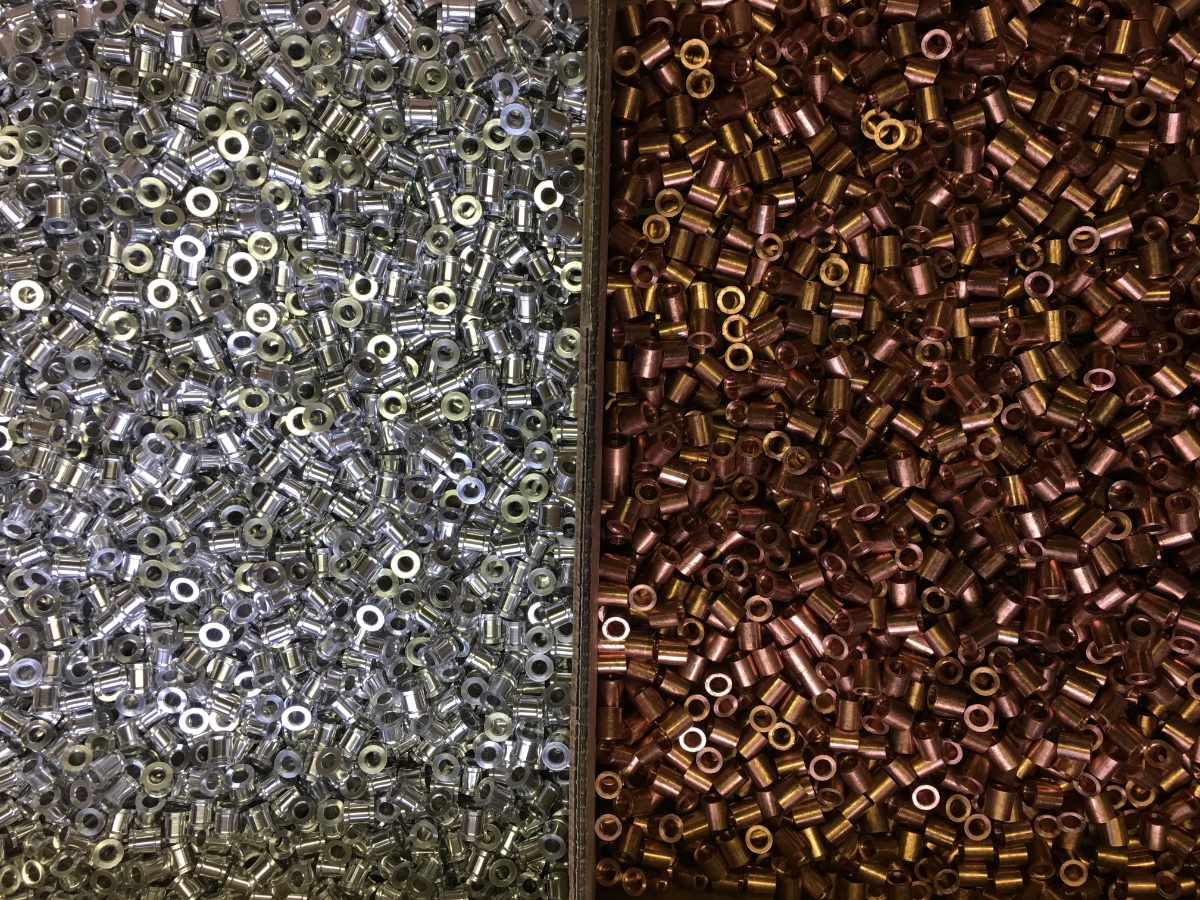

Well... Because they are maybe $0.03 each and a perfect fit. But maybe I’m just a stickler for details... I also had these made up to add a little “bling” to the coils. (But seriously, there is nothing wrong with making the “homemade” shims from old points. It works too.)

Very nice, Adam. I've been temped to paint the old bridge risers with copper colored spray paint...
