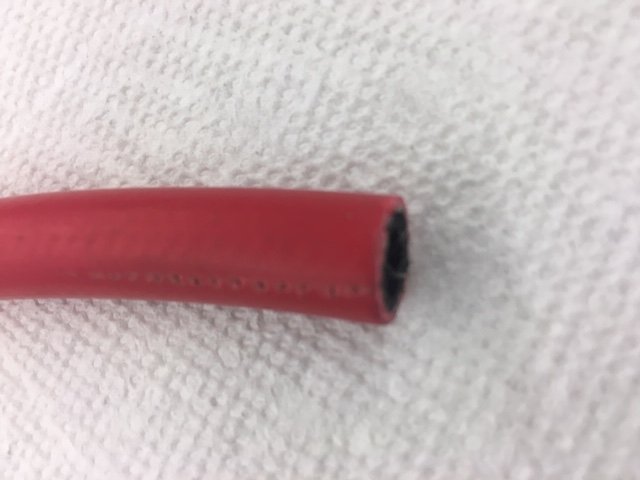

Horrible Freight sells red airline hose. 5' for $5.69. It's their item # 98944. 1/4 inch ID. and 1/2" OD. You can remove the ink lettering with acetone. The package is called Swivel Whip Hose. Used it on my Torpedo and it looks great.

I bought some of the red hose, y'all suggested, from Harbor Freight yesterday. Looks good to me and the printed letters came right off.
