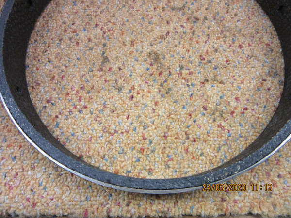

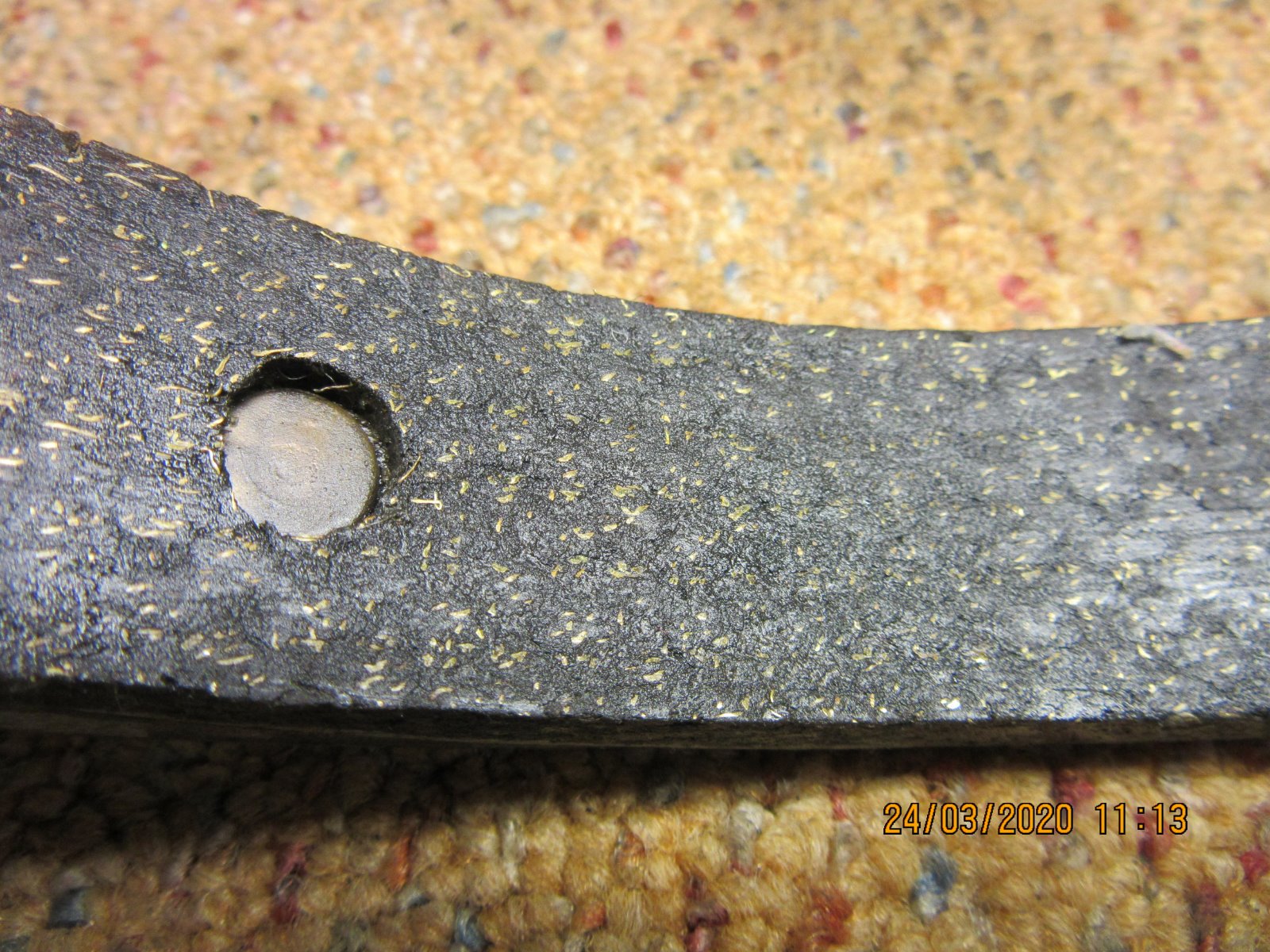

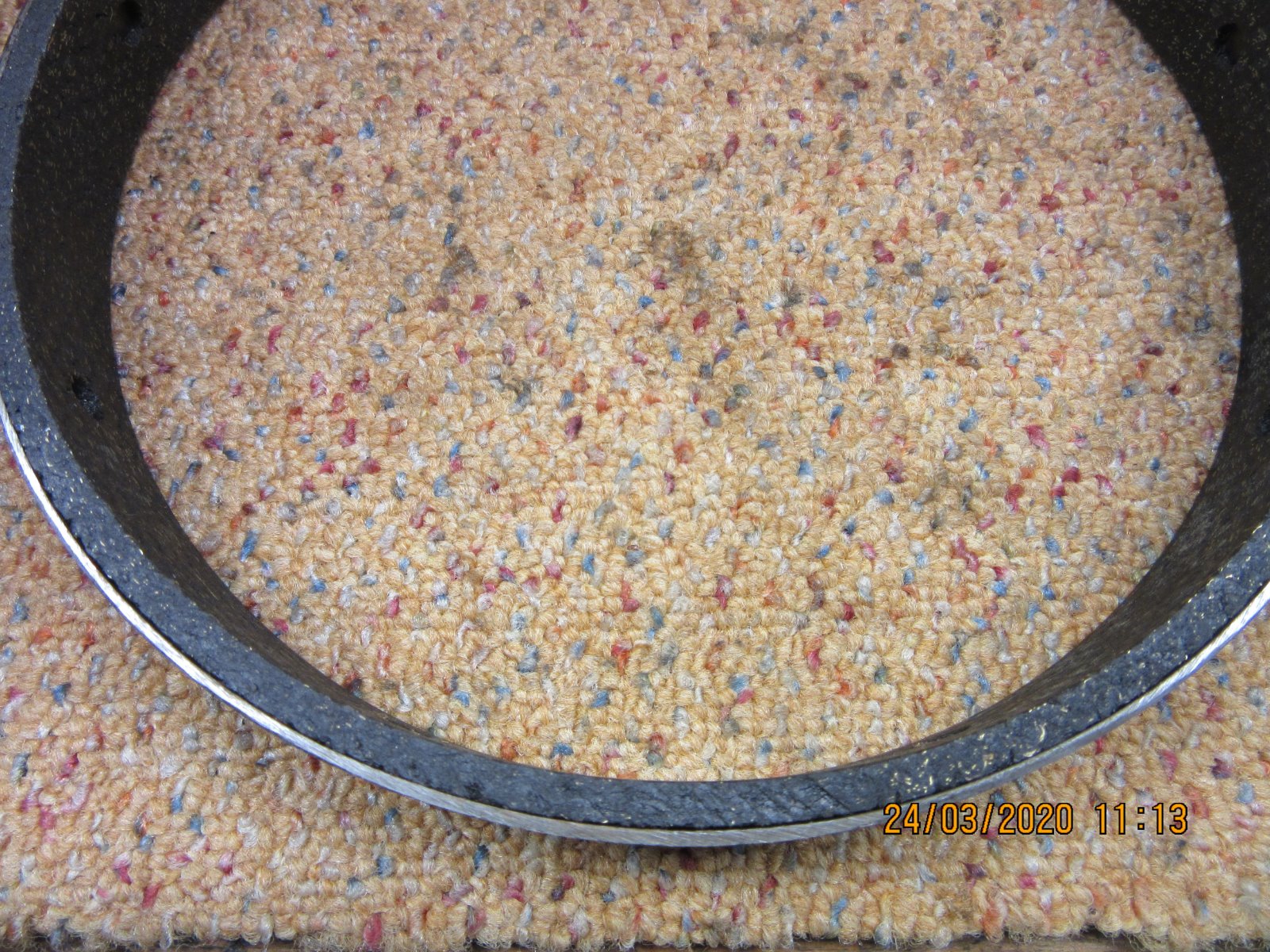

Some weeks ago , I opened a 1911 engine and found these Trans. brake bands .
What do you think about these ????
Toon
Joe Bell
Posts: 1205
First Name: Joe
Last Name: Bell
Location: Tiffin Ohio
Re: unconventional transmission brake bands
Post by Joe Bell » Wed Apr 29, 2020 6:59 am
Toon,
I have tore engines down with them in it, the brass that is imbedded in the material comes off and goes into the babbitt and then you would know what that looks like. They do work and hold well but pre engine failure from it.

I opened a 27 transmission and found a similar band to the one you posted a photo of. I also found the transmission full of the brass looking material woven in the band. I never found a manufacturer who made them but the ones on this T looked almost new when I took them out. I didn't put them back in because of the material coming off them and settling in the transmission.

They look to be brake band material sold by some company's. For applications such as car/truck etc service brakes or brakes used in power transmission boxes for industrial applications. The brass wire help keep the lining cool dissipating the heat.

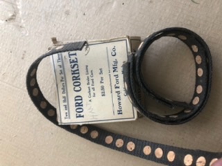

Here you go Les ! NOS :lol:
I would have used them but they smell funky and I think have damp rot. There were several brands marketed with cork inserts “back in the day”.

Thank you Rich for the posting. I was sure I had seen a picture of them!

Rich, Les, I have pulled many down with the cork in them, always wondered how the held up? What ever was between the cork crumbled but the cork was still good.

Like Joe, I’ve found old cork insert linings in my parts stash. They didn’t look very much worn at all.
