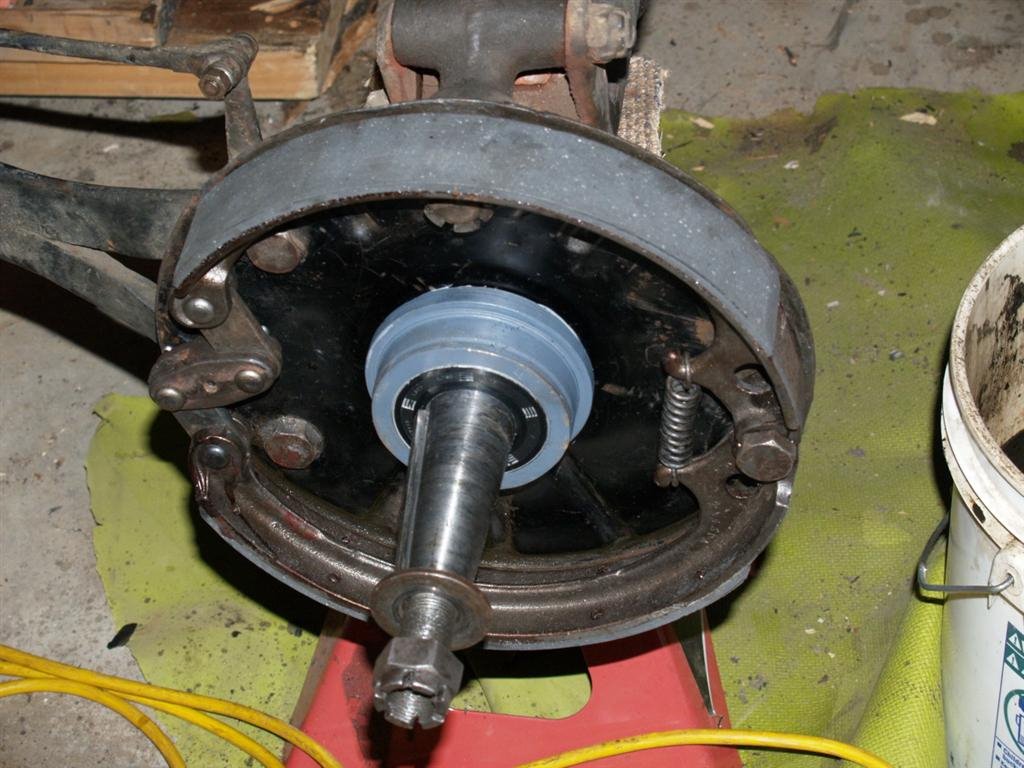

I use 140W oil in my Ruckstell TT rear. MAKE SURE IT IS "NON-EP" additive oil. The EP additive corrodes the bronze gear and that can get very expensive fast!!
All the best - and make sure you get the latest version of the MTFA Ruckstell rebuild manual. That helps a lot in the process (there is a section on the TT at the end of the manual).

Home made carrier for modern oil seals - there is enough clearance if you measure carefully :-)

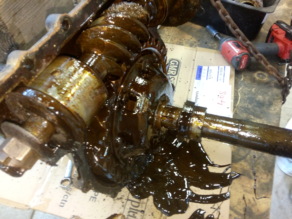

Another good reason to strip it down is you never know what sludge you may find that built up in there, so a nice clean out in itself is a good idea (friends TT diff:)
