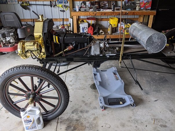

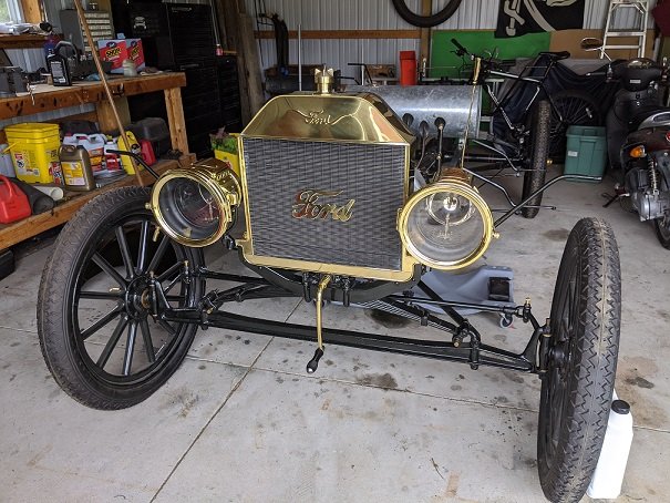

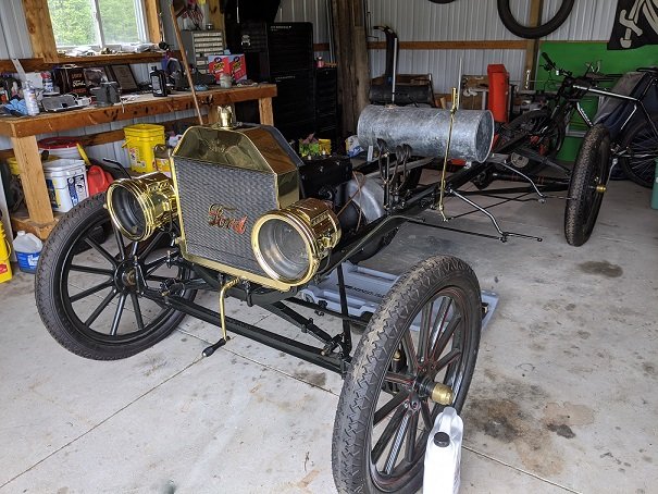

Well, I'm finished with what I can do here at home on my project; now I await delivery of my repaired touring body by Ray Wells with a brand new leather interior by Ernie Romano. I sure can't wait to start the assembly!

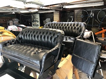

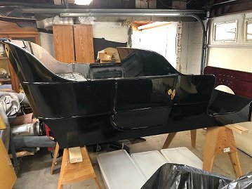

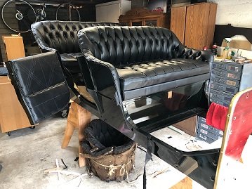

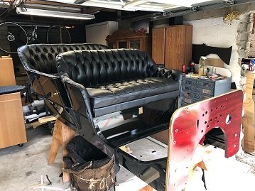

Jerry, I did have the original body, but there was significant rot at both rear corners as well as both wooden side rails. I tried to mend it, but in the end I decided the damage was too far gone and at critical points (directly beneath the rear seat - not good for passengers) so I took the body part and sent both seats and doors to Ray Wells and he fabricated a new lower platform and married it to my original parts. I sent him all my original door hardware as well as all body brackets, etc. I also gave him the Brewster Green color code from a place in California that I think is pretty darn close to the original all-but-black dark green. Then Ray convinced me to have a new leather interior installed by his friend Ernie Romero. I was toying with the idea of installing the interior myself, but leather isn't cheap and with an early brass car like this I didn't trust my limited skills so I bit the bullet - and I'm sure glad I did! From the photos Ernie has sent me, the car looks absolutely magnificent! The man truly is a master in his craft, as is Ray Wells. I really, REALLY didn't want or plan to do another frame off restoration but it is what it is, and I'll be glad when it's finished. I'll try to get those interior pics from Ernie downloaded to my computer and post them as well.

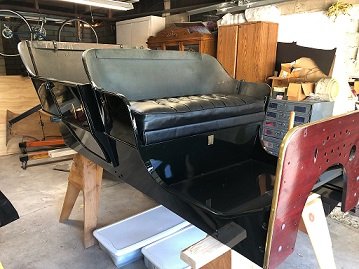

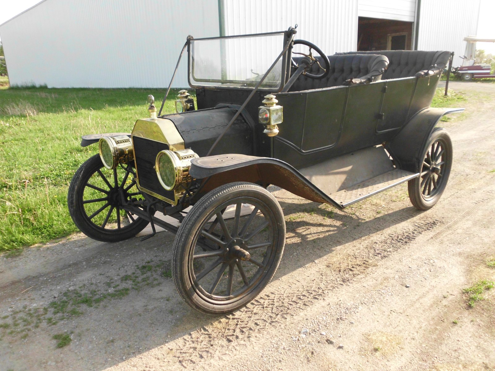

Here are some body pics from Ray and some from Ernie.
