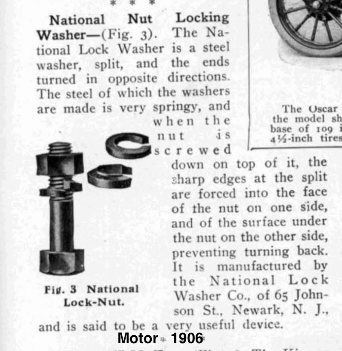

John
That patent in 1922 may only have been an improvement on existing art of past mechanical locking means.
But as the earlier post, lock washers have been around for over a 100 years, found one ref in 1904, this offering in Motor 1906 shows pretty much today's lock washers. Ford used them in many places early on.
