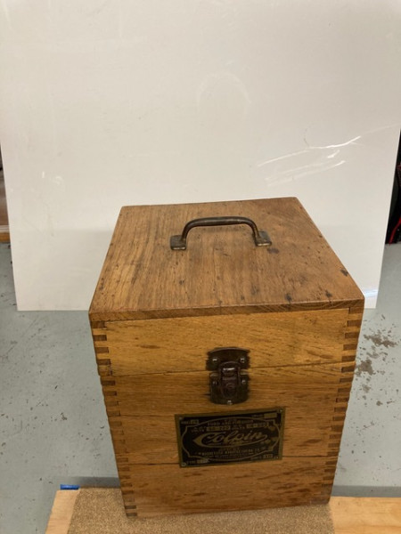

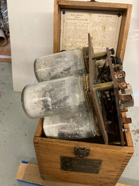

I put this in a closet in the garage when we moved into this house 30 years ago and forgot about it. What kind of chemical mixture did it use?

I don't think those things can be anything other than lead/acid batteries.

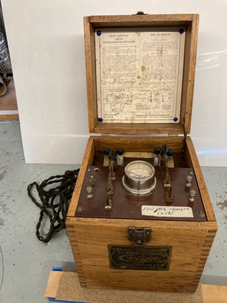

The jars might have salt or such added to water to reduce line voltage, like a bank of light bulbs to recharge magnetos. As noted on the label, only works with DC line voltage. There is an illustration of using salt water on page 237 and description on page 240 in "The Model T Ford Owner" chapter on recharging the magnets.

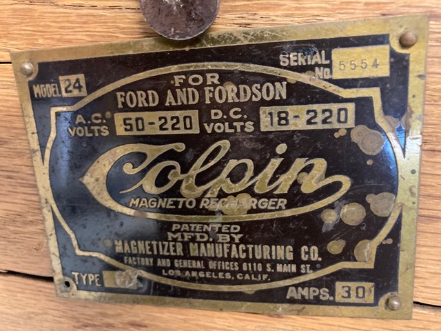

The brass label does say AC or DC. Are the terminals under the meter for AC? Or they may have used the same brass label for both the AC and DC units and the buyer would be smart enough to know the difference.

If you read much of the early info on electrical stuff, you will find that a jar with salt water in it was used as a resistance for different electrical applications. Sometimes many jars, depending on what the electrical guy was trying to accomplish.
If you are going to use it, try salt. If no results, you can just pour it out and rinse everything. No harm done. The warning about using battery acid is the tipoff for me.
