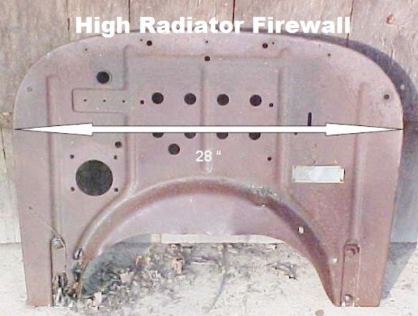

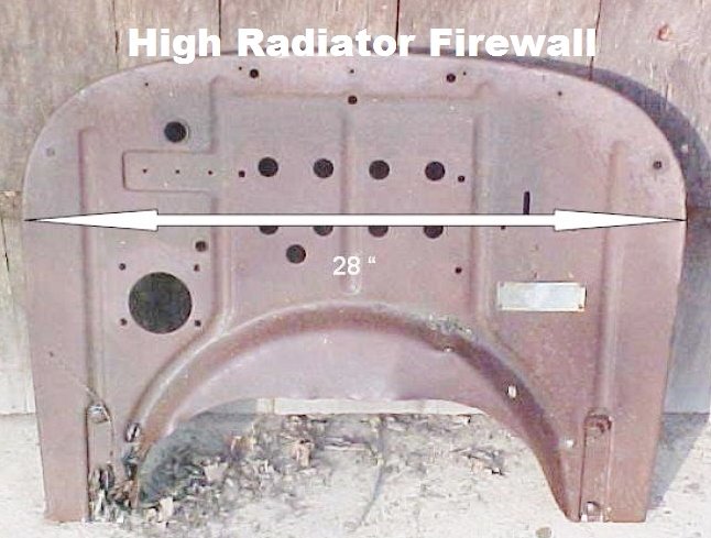

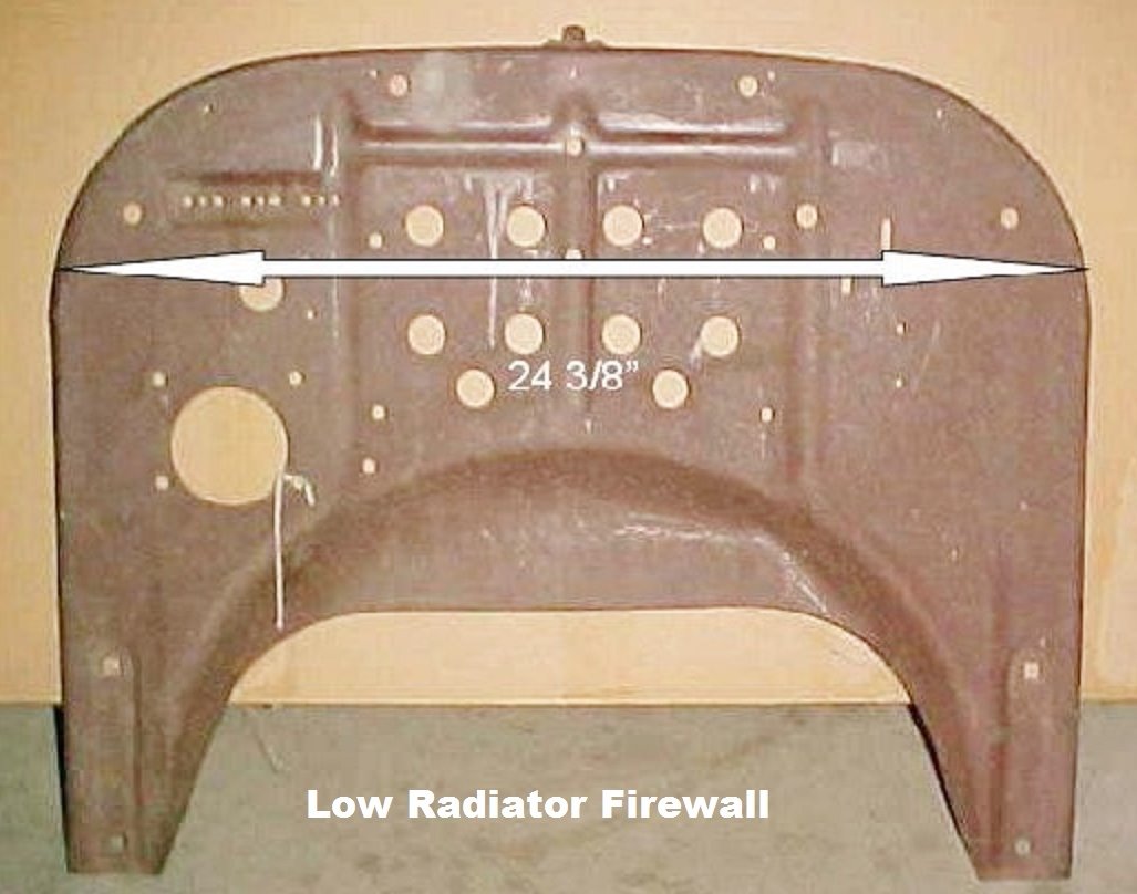

First off I'm new to Model Ts. Totally ignorant. I have the remains of a roadster body that I was told is a 23. The firewall is missing and in trying to do some research I find two width firewalls. One 23 and three eights wide and one 28 wide. When I measure across the body opening I get 27 inches. How does this work? Thanks.

If the body you have is missing the firewall, and any significant amount of wood structure, the sheet metal usually sort of "spreads" without some support. That could likely explain the in-between width.

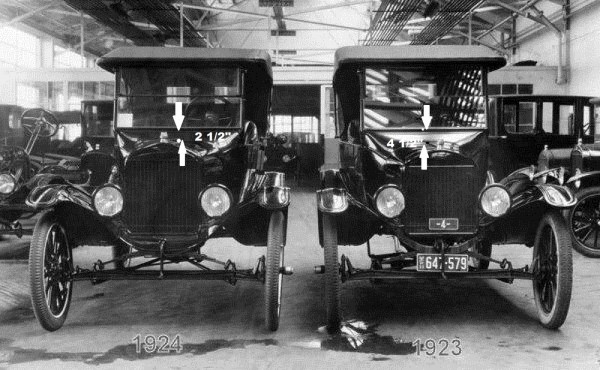

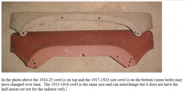

During the 1923 Calendar year Ford produced a 1923 model year car that had a "low cowl." That body with variations was produced from 1915-1923. And during the later part of 1923 Ford introduced the "High Cowl" cars that were continued into the 1925 model year again with some changes to the body.
The cowl of the bodies look generally like the ones shown below (some small differences depending one which of the 5 or so body makers produced the 1915-1923 body and also when either of the boides were produced). But the key thing is the 1915-1923 has a large flat panel at the front of the cowl while the 1924-25 style has a much smaller lip that runs only an inch or so at the front of the cowl as shown below:
