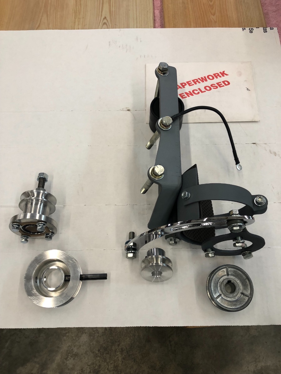

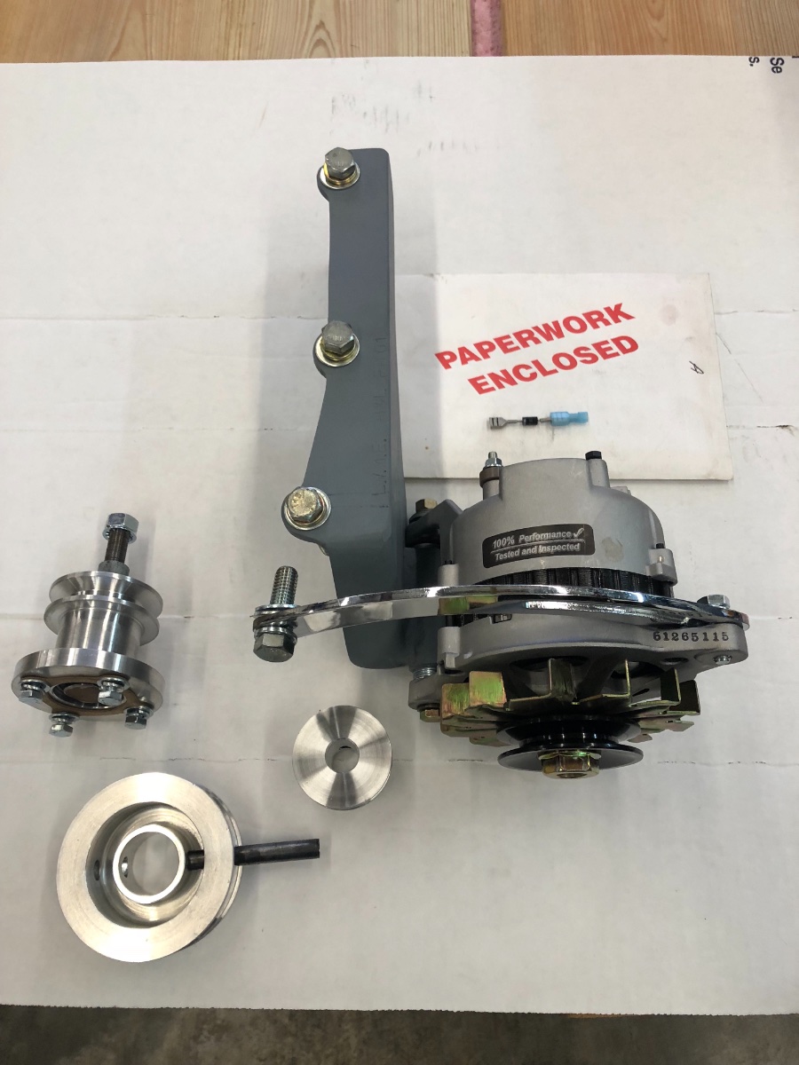

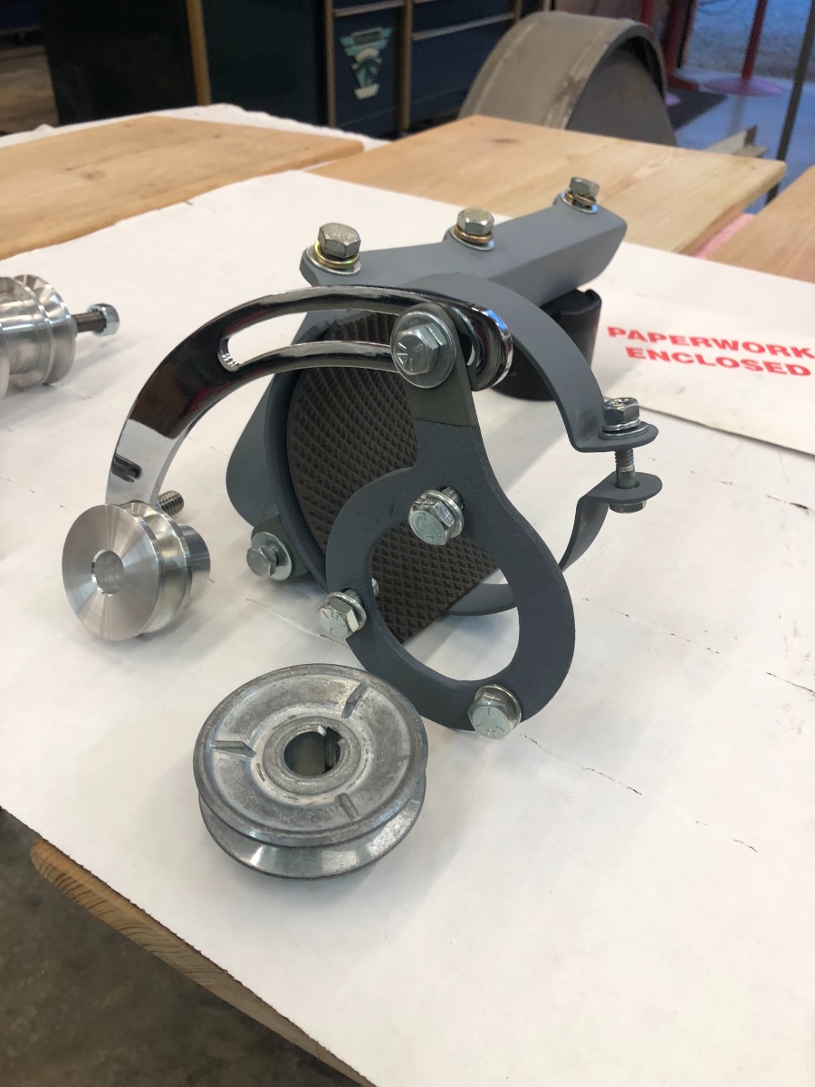

These are some I offer.
12 volt alternator, can be used with a water pump as well. Kit $390.00 with shipping.
Or install a 6 volt original generator by removing the gear and installing the supplied pulley.
Kit (no Generator) $290.00 with shipping.
Hope this Helps,
Hank
Hope this Helps,
Hank

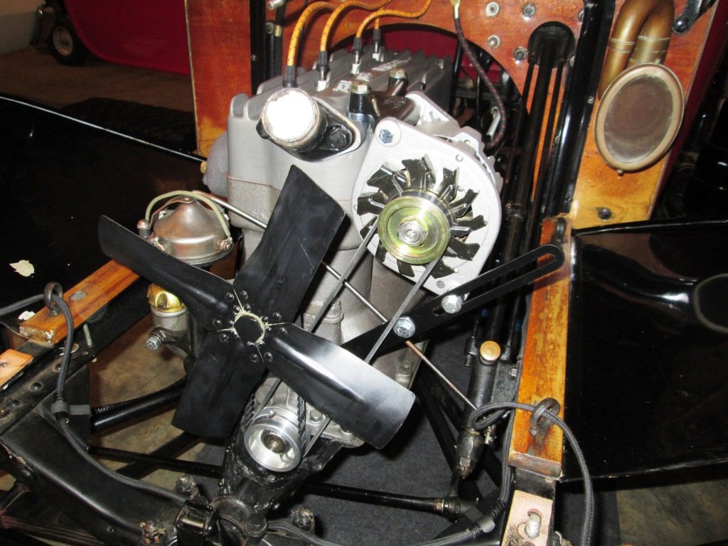

Re: Adding alternator to 1917 T
Here's one in operation!
Kerry

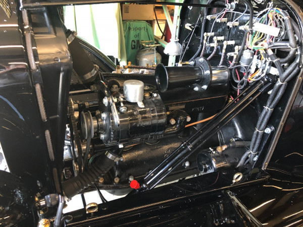

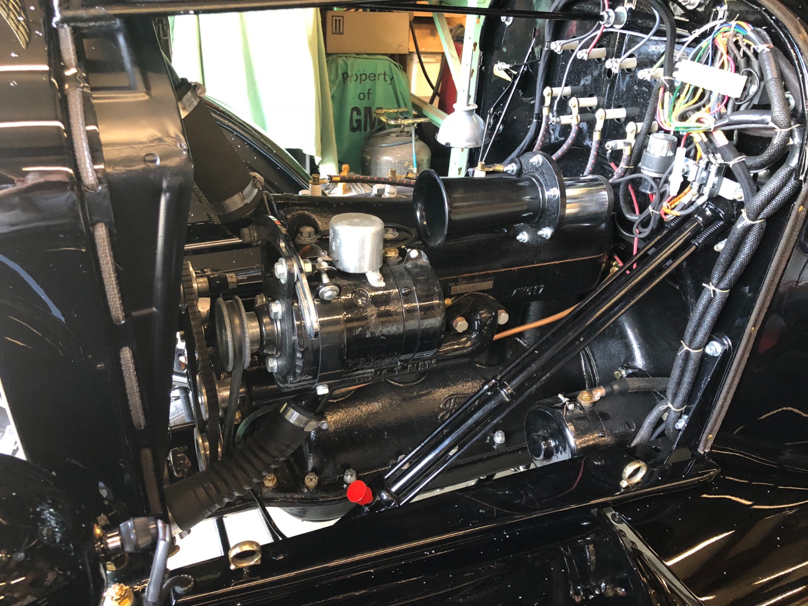

- Posts: 5594
This is one of T.T.P.'s kits - simple install - although I replaced the "hokey" belt adjuster !

- Posts: 5594
I installed Halogen lights so I needed the output.
