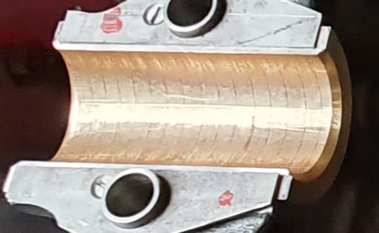

Saw this on MTFCFB. What do you engine rebuilders think of it?
Posts: 4084
Re: Instead of pouring Babbitt...
Post by DanTreace » Thu Jun 18, 2020 1:00 pm
Looks like a bronze liner? Held with screwed down plates. One cap with liner shown in foreground with the crank. Don’t know if that’s good or bad.
More concern is no radius to the turned crankshaft journals.

If the caps are babbited, it'd be very similar to a very early engine, which I believe, had cast iron bored-in-place bearing surfaces in the block. Not the longest lasting design.
On close inspection of the first picture, it looks as if the caps have bronze, too. If the caps are bronze, I don't think much of it at all, and without super-duper oil filtration, the crank is going to score pretty badly pretty quickly. The babbit digests all sort of junk, allowing it to embed harmlessly out of the way...not so with bronze. Bad idea.

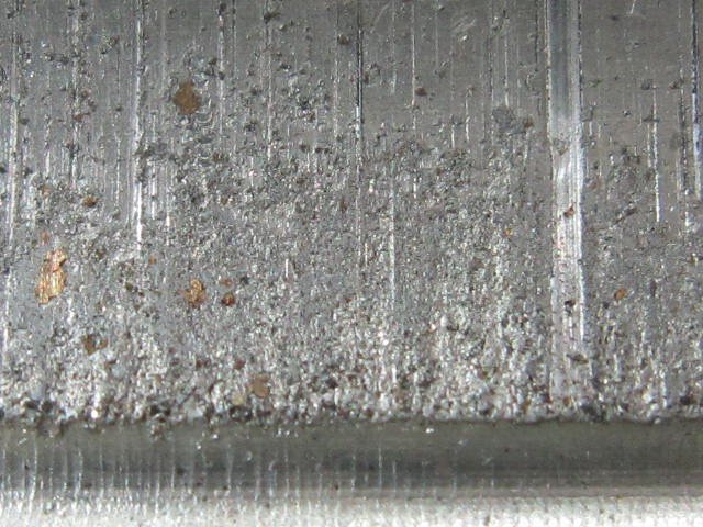

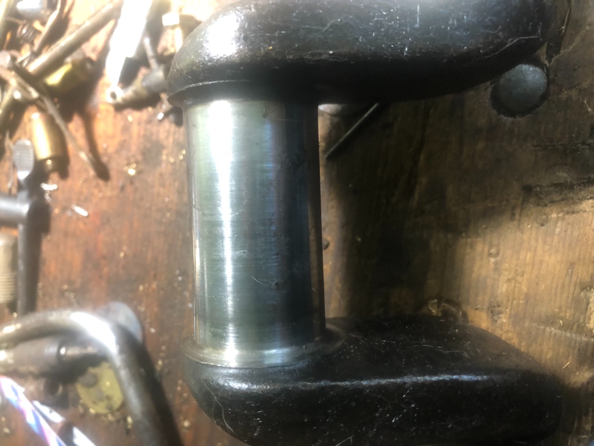

The bronze insert against the Model T Crank will be too hard and quick failure will result.
Where it's a splash rather than high pressure system the bearings and crank will not survive in the atmosphere of a Model T.
They chose babbitt because it's a softer material than bronze and it has ability to eat the dirt so as not to destroy the crank journal surface.
Modern insert bearings have micro layer of babbitt and have high pressure to wash debris away so that the crank rides on film of oil constantly.
In same situation if there were high pressure using a bronze bearing it still wouldn't have the ability to digest the fine debris that is always present in an engine. Note the picture; this is a rear main of a Model T that had been done by others and according to customer only had 10k miles on it.
See the amount of debris stuck in babbit, You can identify each piece, bronze, rust, glass beads. This engine had a Dubats crank in it and other than polishing crank would of been fine.
This is a testament of babbitt considering a poor engine rebuild the crank survived.

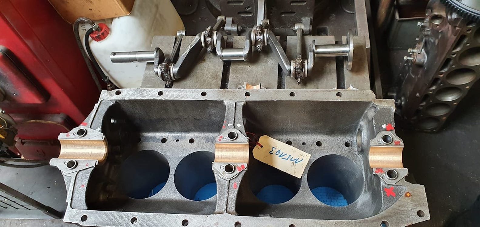

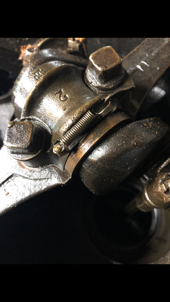

Here are some pictures of a motor I bought that had a bronze 1/2 bearing on the center main as part of a device to take up end play.
