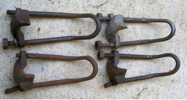

There made an accessory to stabilize a loose perch/wishbone. Steve Jelf was given one for a loose perch last summer at an auction in Indiana.
- Attachments
- Perch - wishbone support.jpg (63.1 KiB) Viewed 8092 times

Thanks for the input Wayne. I am doing the chassis repair myself . Eric says his body and fender man can paint the new fender and splash apron when I receive them from Rootlieb. I'm doing fine after the accident, still struggling with the insurance company. It's a nice car, I'd like to get back on the road. It would be fun to come for a visit sometime after this virus thing subsides.
Frank, that's an interesting accessory. Indicates loose perches have been an issue for some time. Puzzling to me why the manufacturing tolerances were so great.

If the perch to axle clearance was intended to be a precision fit... the perches would have had a ground shank diameter, and the axle would have had a smooth reamed bore. But instead, the axles are drilled and the perches are turned. I don’t suspect that this was ever intended to be more than a “close” fit.
And IIRC, the accessory “support clamps” pictured above were intended to prevent the wishbone from falling off should the perch nut ever come loose or be lost. These clamps could not have corrected any clearance issues between perch and axle. But would be good insurance if you had stripped threads, or didn’t believe in cotter pins or tie wire

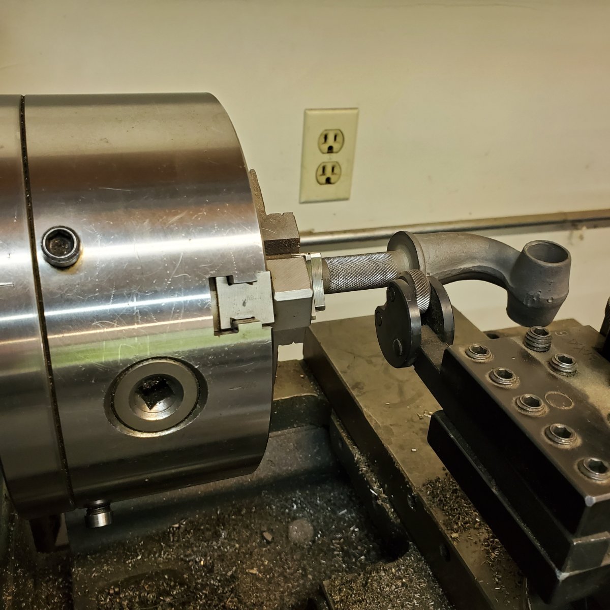

Update. I always enjoy someone telling me how their posted problem turned out, so here goes.
I first tried to shim the loose perches in the axle. No luck. The shims refused to stay put, in one instance they tore. I decided to knurl the shafts with a knurling tool on my lathe. It turned out good and the perches fit with a light press fit . No movement. I didn't care if the knurling made a tight fit because the high spots would compress under pressure.

Thanks Richard for the update. Your knurl method seems practical and it worked. Good job.
Once got a used set of spindles from a vendor, and the inner bearing surface was lightly knurled. Probably as the used ones had the inner bearing cone spun on it for a while. The knurl did help the new bearing seat as it should. Plus it is still able to pull that large bearing for grease on occasion.
That large inner tapered roller bearing should only spin between the spindle shaft and the hub inner race, so that the bearing cone doesn't spin on the spindle shaft, nor the large inner race spin in the hub.

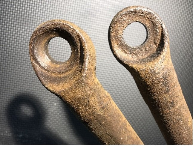

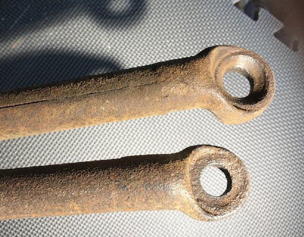

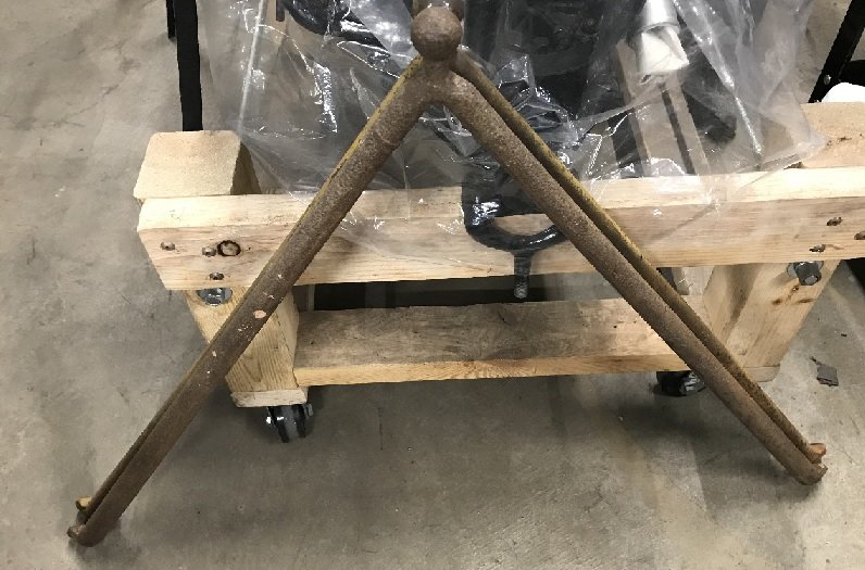

I have to wishbones with different attachment lugs and tube construction. see photos. They also appear to be the same size etc. The picture of the gray attachment lug is one that is so worn that the coned nut couldn't tighten against it resulting in a loose perch

Frank B, et al, I believe that odd one may be a very early version of the under-axle wishbone. Mostly late 1918 on TTs and early 1919, the first under-axle wishbones used a flat bottomed nut, and may have been used mostly on the early TT trucks. They developed looseness issues early, and were replaced by the common coned type after only a few months. I have read of these, but never had one myself
- Posts: 6599
Re: Question re front spring perches
Wayne Thanks for the input. Also the need for a good cone to nut match to tighten down the perch.

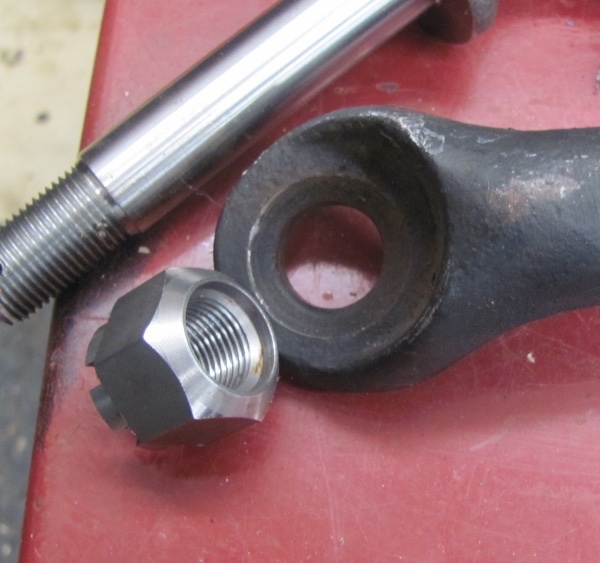

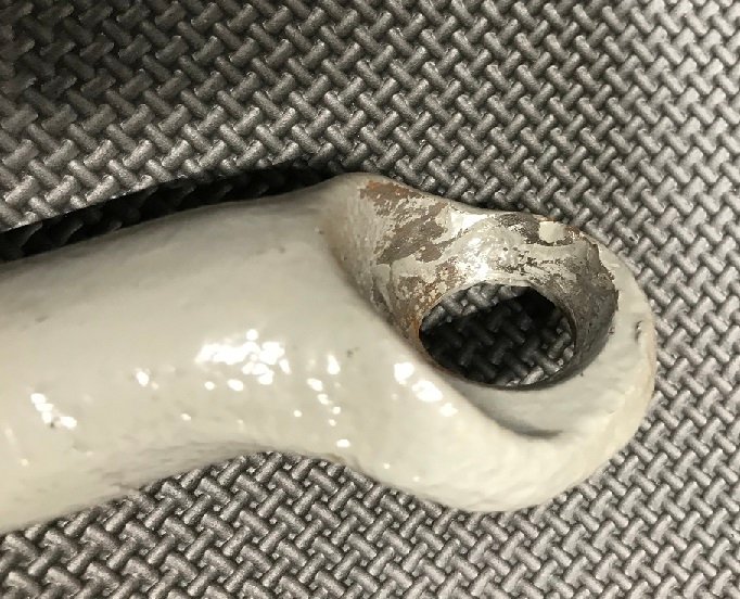

On many wishbones I examined before choosing the one I have for replacement, I saw the imprint of a hex nut from wear on the bottom of each arm where the perch nut rides.
From prior experience I discovered one way to smooth out the contact with the cone shaped nut is to make a copper washer to be placed between the bottom of the perch arms where the hex wear is present and the cone of the nut. The washer compresses into the arm recess and keeps the cone nut from bottoming out on the hex recess before fully tightening the perch. I initially tried a brass washer but it tended to disintegrate . The copper I used was better suited
